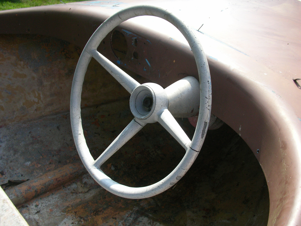

Does anyone know where i can get a older steering wheel?? MInes cracked and unrepareable i believe :'(

Scour eBay for a steering wheel if you truly think it is unrepairable. Although I have always had great success with Eastwood's kit.
www.eastwood.com/catalog/product/view/id/3993
I have used this kit on dozens of wheels but mostly 1958,'59','60 Chevy Impala steering wheels.If it just has cracks and not missing large pieces it can be repaired. Post and pic or two. You have nice boat to begin your addiction :lol: Good luck!

That steering wheel should be an EASY fix... I jut finished mine, and it started out far worse than that... The cracks will be easy to fill with the previously mentioned product from Eastwood (they've got a great tutorial on their site), paint it up, and it'll be as good as new (or better!)

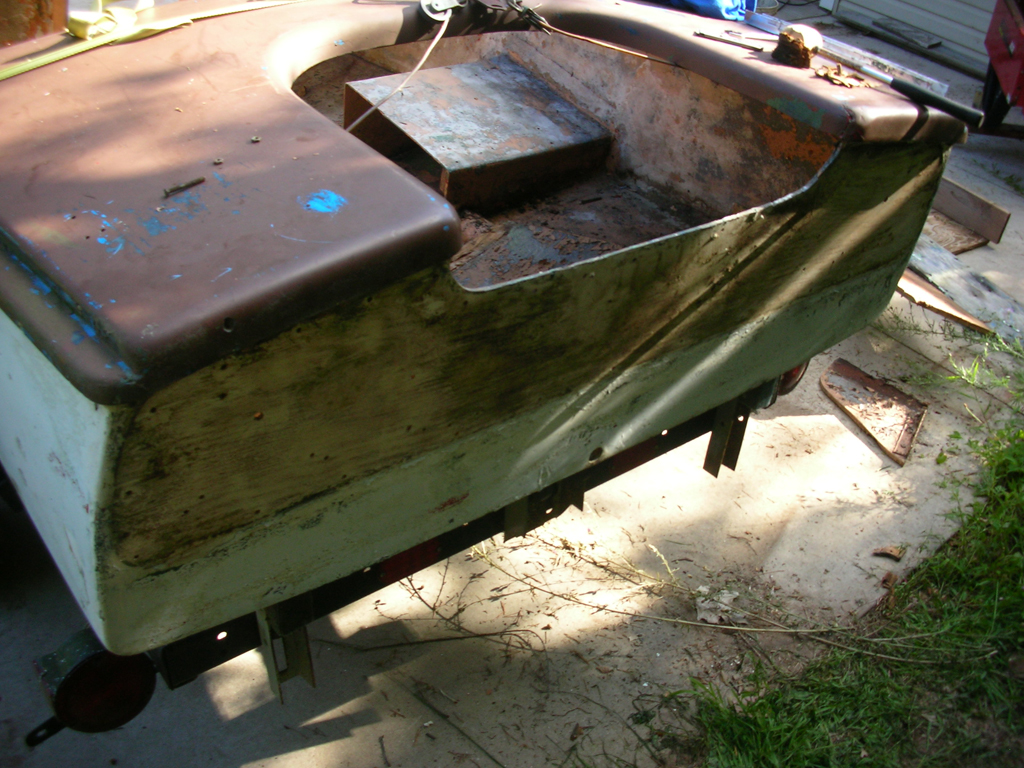

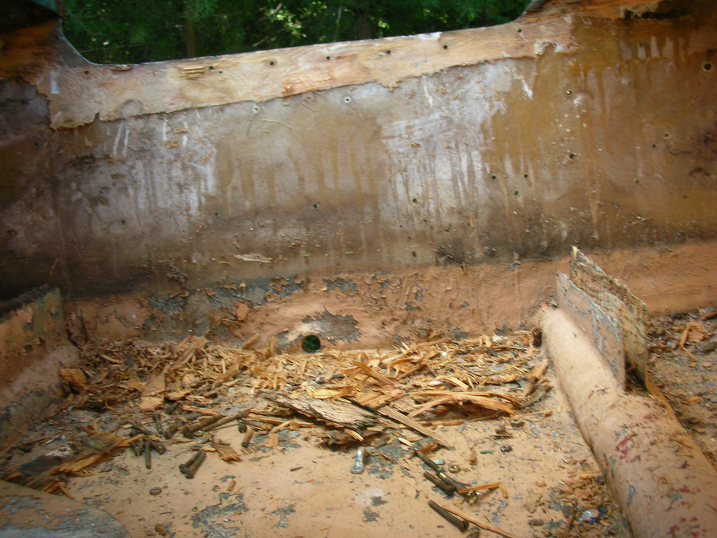

Are you removing the transom wood from the inside or outside? I can't tell from the photos! One looks like it's the outside, on the inside...
Do you know what condition the stringers, and any other wood, under the floor are in?? One thing i've learned is if you find rot in one place, you're likely to find it elsewhere!

You can use most any paint to top coat the steering wheel once repaired and primed properly. As the Eastwood instructions state do not use epoxy as it has a tendency to chip easily. Especially from rings on fingers.As to painting the entire boat many of the marine paint manufacturers will have plenty of info and if you do a search on this site I am sure you will find older threads that address painting and most anything else that crops up in your restoration ahead.I have learned quite a bit by going through some of the older threads. Also I have seen some excellent Youtube videos on the subject.

"Are you removing the transom wood from the inside or outside? I can't tell from the photos! One looks like it's the outside, on the inside"... Andrew
Andrew from what I see it looks as though there was a piece of plywood attached to the outside of the transom and it left an imprint on the fiberglass. Young Starcraft has a few holes to fill but can also use some of those holes to help bond the new wood to the inner transom using screws with washers to ensure good contact.

there was the fiberglass sandwhiched between 2 pieces of wood on the transom I took both pieces off. so there was inside and outside the when you can see the back is the back and the other one is inside with the pile of wood chips on it
Re:Need help finding parts 15 years 7 months ago #22749
There was a bolt in every single one of those holes.

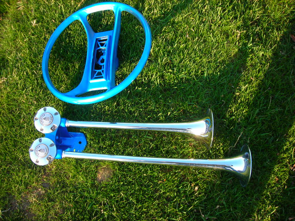

starcraft,if you think you cant fix the steering wheel send it to me and ill do it for you for free,im doing a set of horns for one of our members and a set of horns and steering wheel for another member for free,whats one more,ill just do them all the same day.
i have metal anodized paint in blue,yellow(gold),red and purple.
you have alot of enthusiasm already ill be glad to help you out.i can also paint it white, john gibson

starcraft,yep,i do it for any member here,i put my address in the last post,i do it for free becuse so many members have helped me here,im paying it forward,so dont feel bad,just pay it forward someday,john

John does amazing work. I am sending him a wheel and horns to refinish.
