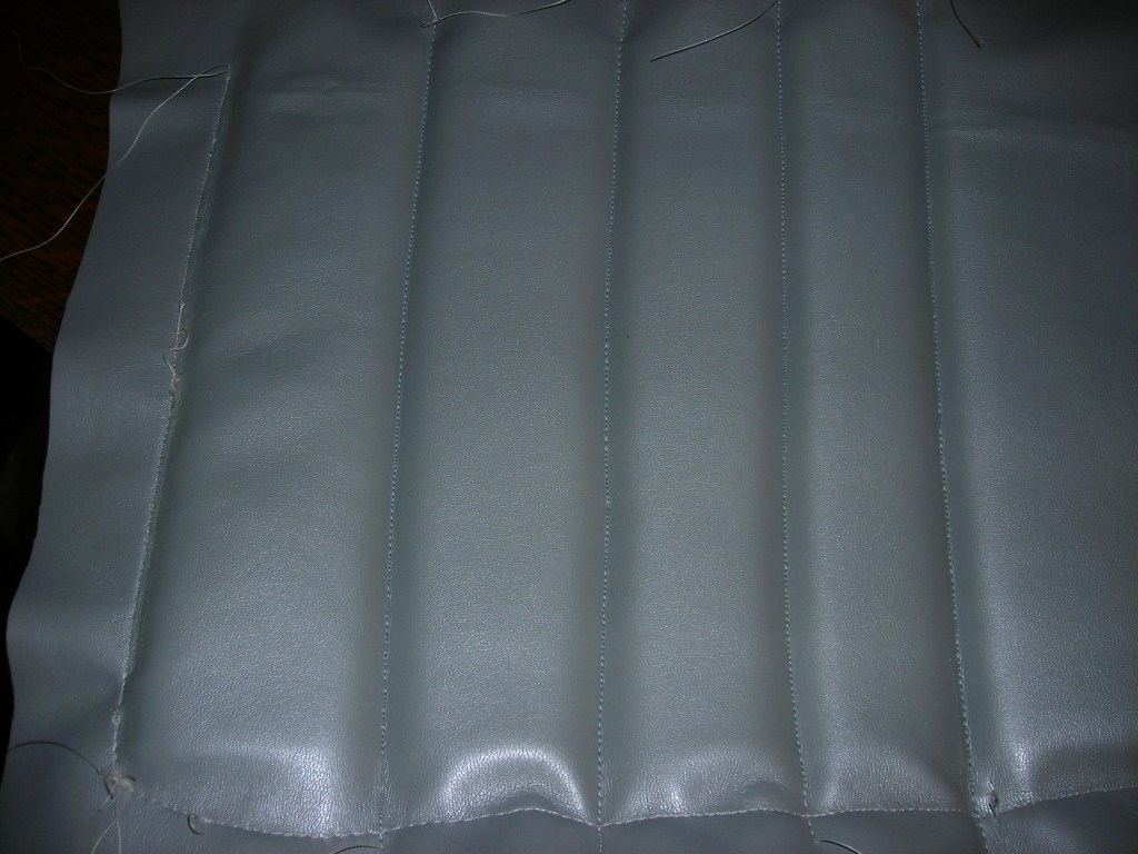

This is the front seat back. All the seats will be similar.
They'll look a bit better once the foam is inside of them. I'm pretty happy with the design, though. I think it'll look good. I borrowed the 'design' from the foredeck-
Using the red stripe down the middle, with the white on the sides.
I made the seats from Marine Vinyl- First I made the welting, then stitched all the panels together-

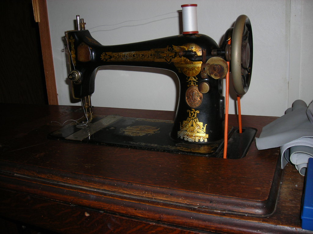

I'm doing all this on my trusty vintage machine, which is about the same age as the boat-

John the round knob beneath the bobbin winder should lengthen the stich travel ;-)

John, That machine will do an excellent job, for sure... There are times that I need to run mine using just the hand wheel, I WISH it had a foot pedal...
My machine is quite a beast, though, it goes through 6 layers of vinyl without the slightest hesitation, and will do more if I am careful. They DO make 'em like this still, BUT they cost big bucks. The old machines can't be beat...

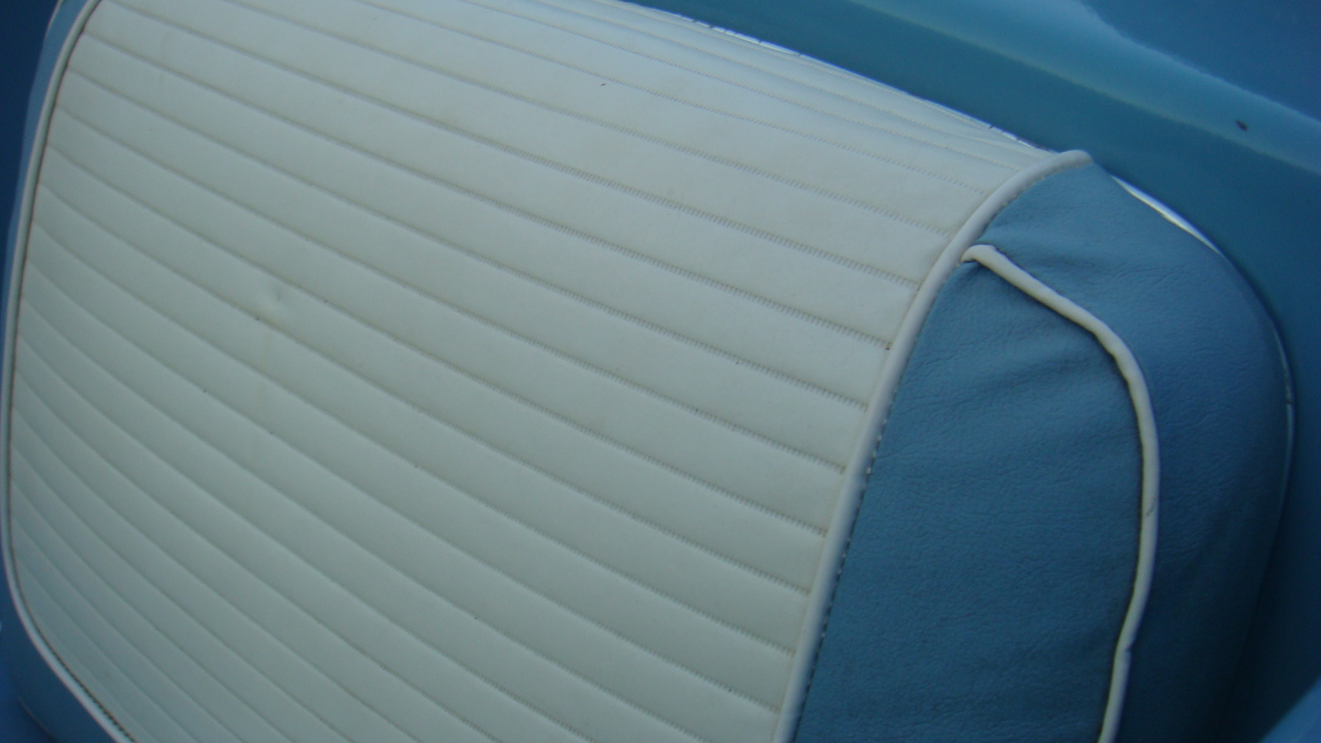

Very impressive. I like the sewn lines in my 61 Kind of Corvette looking. The white stays very cool.

That '61 looks pretty sharp- I like the pleated look, too. I was going to use that as well, in fact, they have a 'pre pleated' vinyl that looks nice-
www.garysupholstery.com/foamback.html
But I decided that for the first project I'd keep things a little simpler.
The 'donor boat' that I bought for seat parts had very similar seats to those, although they were kind of a teal color. I had them for patterning, but after sketching out some options, I liked the red strip down the middle of the seats.

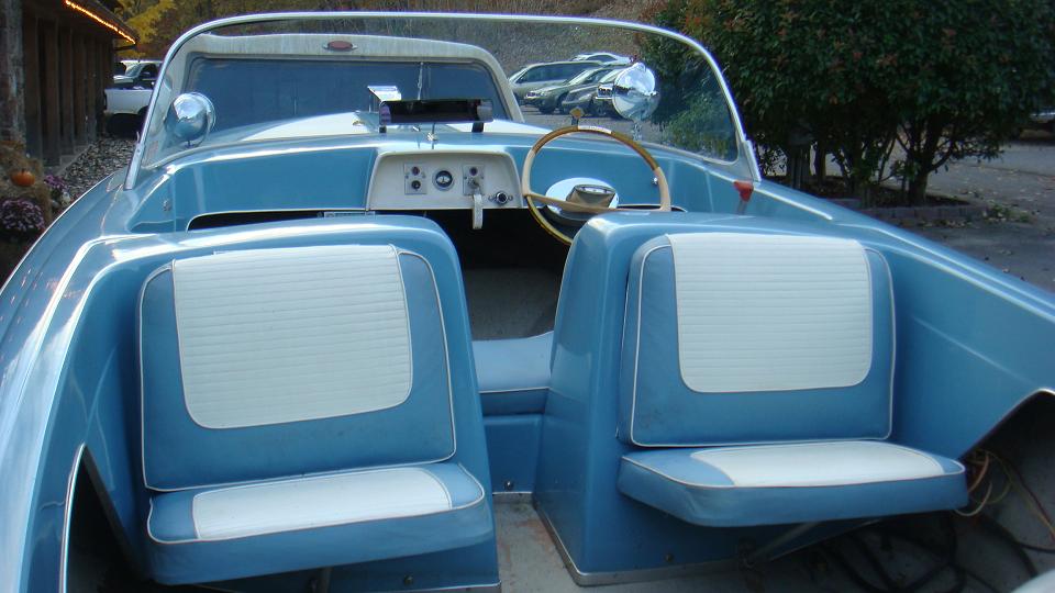

Almost all the seats are done now, and stapled to their bases. I installed 1/4 20 stainless t nuts in the plywood bases prior to stapling the vinyl to them to facilitate installation. I won't put them in permanently yet, until I get the mechanical and electrical work done. I don't want to mess them up!
I put one of the stern seats in the boat just to see how it would look-
I like how they look.
