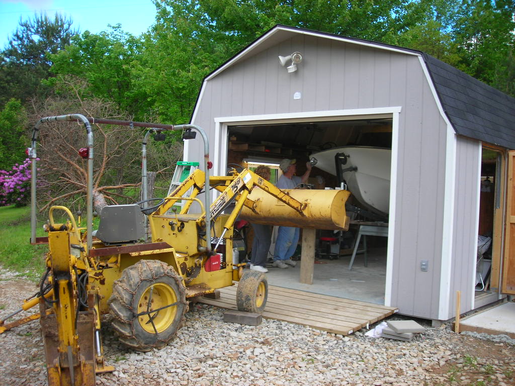

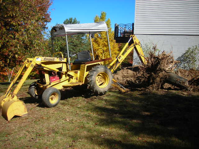

thanks guys here is the mini back hoe,its a 1988 terremite,with a 20 hp kohlor,gas motor,i have had this backhoe for over 12 years,i put my septic ,driveway ,foundation,etc with this little thing.for a mini hoe it has alot of power for such a small motor,its the exact same motor that was in my cub cadet lawn tractor.it is a kohlar 20 hp magnum twin.

Looks like a good candidate for a portable garage, but if you go the heater route, don't forget the hydraulic system. Hydraulics work slowly until the oil warms up. One of the magnetic oil pan style heaters at the bottom of the hyd. reservoir works great.

by the way,the bars are not roll bars ,they are light bars,the lights that are in the he originally are blocked by the front bucket,so i put these on to use the hoe at night.
when i was digging for my foundation,i was working during the day and digging at night.
another problem im going to fix is the rear tire chains you can see in the bottom pc that they fall into the groves of the itres and are worthless,so i am thinking of taking a peice of chain and wraping it under the the tire chains and spot welding it there to keep them from going back down in the treads.john

kerry,nice to meet ya by the way,and good idea,but before i had this garage i had a portable one,and the winds here just chewed it up,plus the cold.
i like the idea of the heater,and yeah i know the hydrulics take a little time to warm up,i dont plan on heating the garge all winter i cant afford that,but if i know in going to use the hoe the next morning i will get it up to temerature,with propane heater then try to keep it above freezing with oil filled heaters.john
