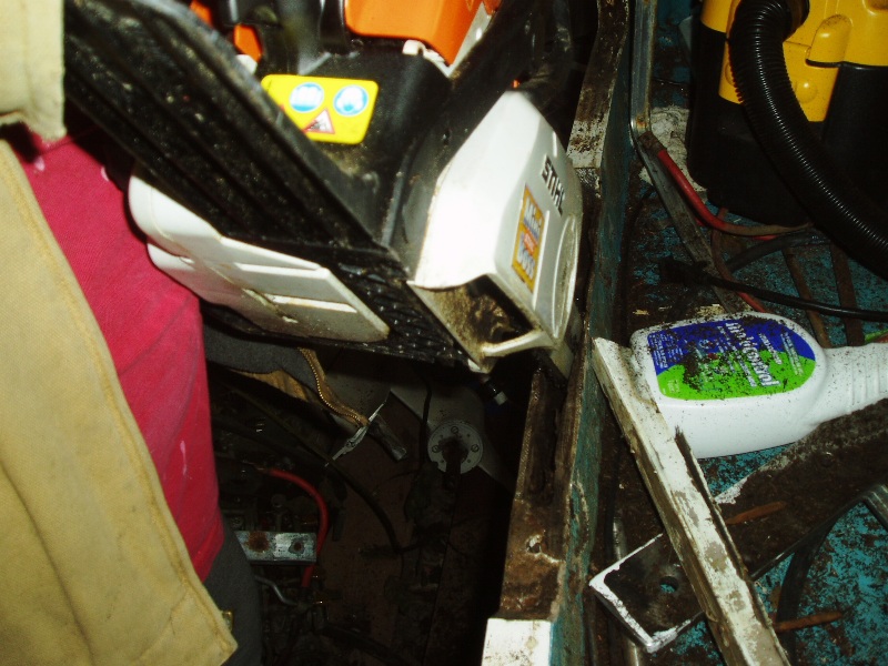

After watching the Seacrest video, I have started to chainsaw the transom of my Skagit. Sure is a quick way to get rid of wood. Will use Seacrest or Nida-core pourable material if everything goes well. Hopefully I will be able to get all the bad wood and get everythin clean without damaging the inner or outer fiberglass skin

I realize it needs to be clean. The transom is not completely gone. I still may remove the inner skin. Depends on how clean I can get it. If nothing else I have removed a lot of bad wood easily.
