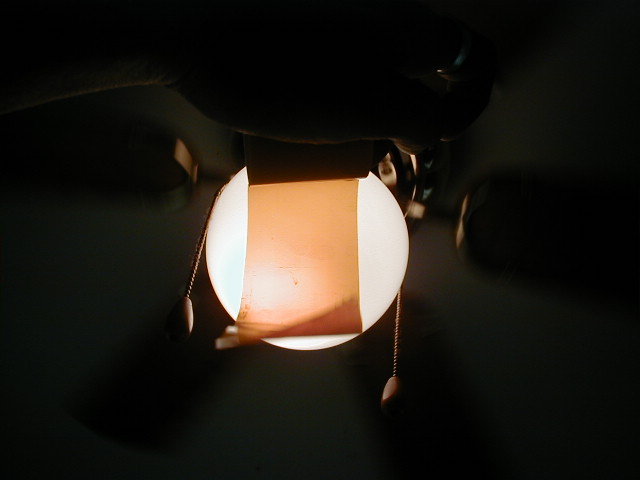

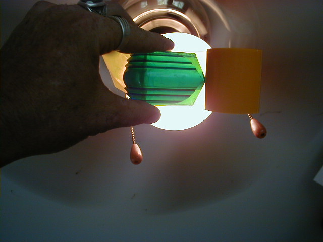

Not a dumb question and there is an easy fix.
get a yellow lens repair kit at your auto store. Take the bow light apart and install the yellow tape to the back of your blue lens and reinstall.
yellow and blue make...green
when the light is off the lens will still look blue but that does not matter, it only matters what color it is when it is ON according to the CG inspection guild lines.

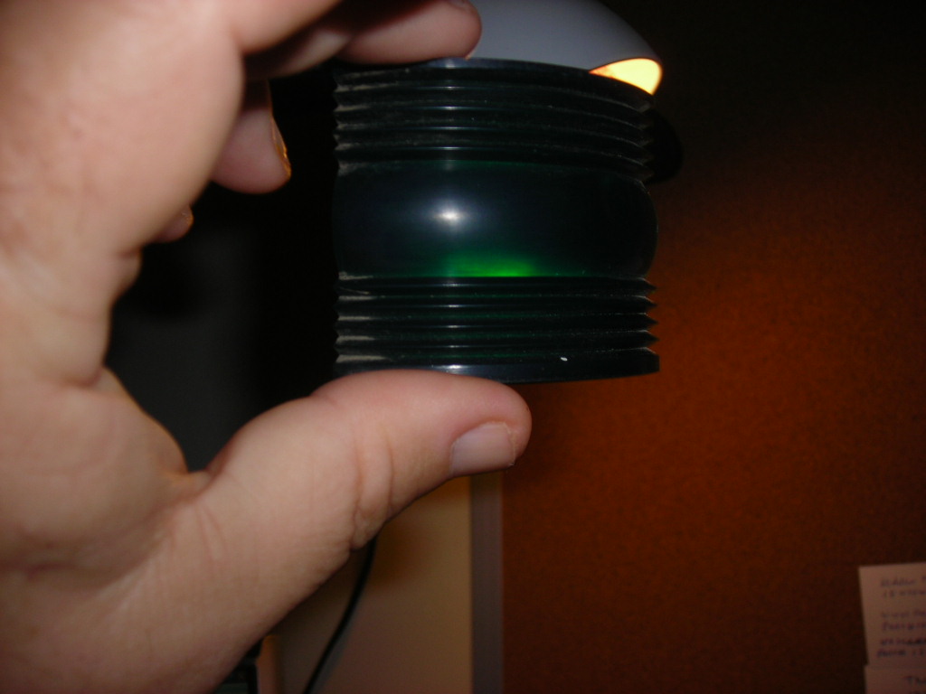

Re:A dumb question? 15 years 7 months ago #20647

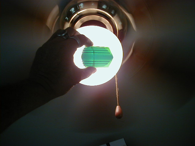

hmmm,it just so happens i have a faded blue lens right here on my desk,so i put it up against the light and presto,it looks green,i just learned something today,lol,check your blue looking lens with the light on 1st,lol,cool,john
Re:A dumb question? 15 years 7 months ago #20650

Re:A dumb question? 15 years 7 months ago #20652
by the way if anyone needs these lenses,they can have them,the blue/green one has a little buldge in it from the bulb touching it,but other then that they are good shape,and welcome back mark,john

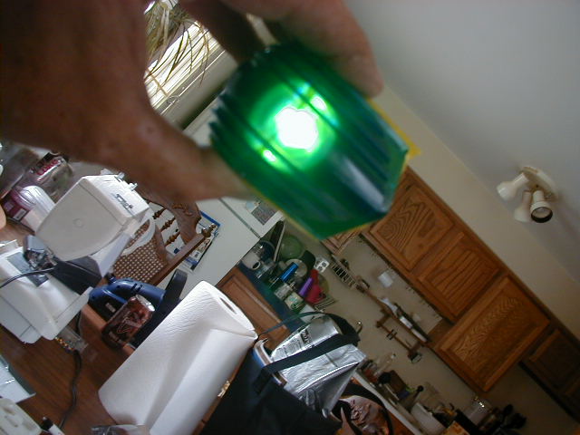

Re:A dumb question? 15 years 7 months ago #20653

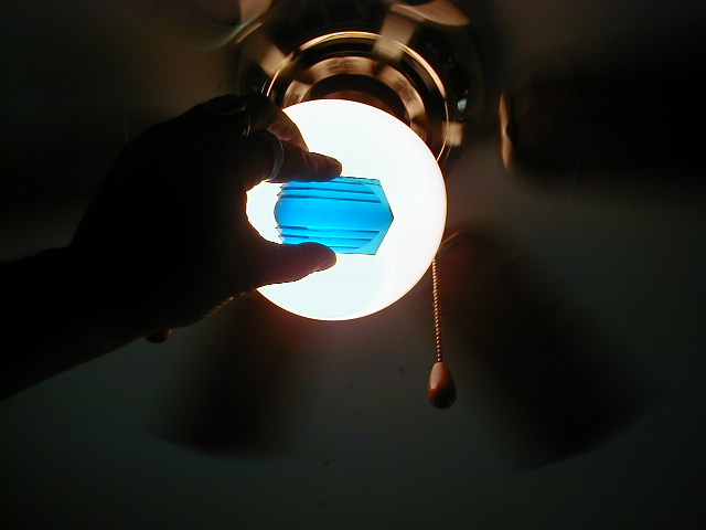

blue lense...needs to be green
yellow Auto lens repair tape
test view before application
After applying tape to the back of the lens.
Test with an LED flash light
Test after being reinstalled into bow light.

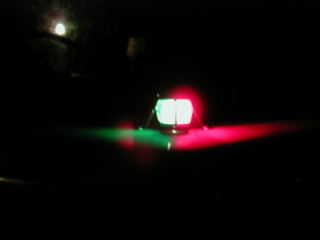

need to note about the bow shot, yes the bulb inside the bow-lite on the funliner was not "normal", I upgrade the 12 volt bulb with an LED bulb conversion, thats why it looks a little BRIGHTER than normal.

yup thats the site to go to for the LED conversion, changed the bulb and the socket it plug into in order to make it water proof and more shock resistant. what it had was good for 1962, but putting a little something something inside the bowlite brought it up in to the 2000 and something era and you would not have know otherwise.

Wow, lots of response from that question. The yellow inside of the lens, should be easy enough to do. Thanks to all for the replies. Didn't know about plastic turning blue after years of sun. Crazy stuff. Will take a look at the lens with light in it. Maybe it is already green, just needs light. Thanks. JT
