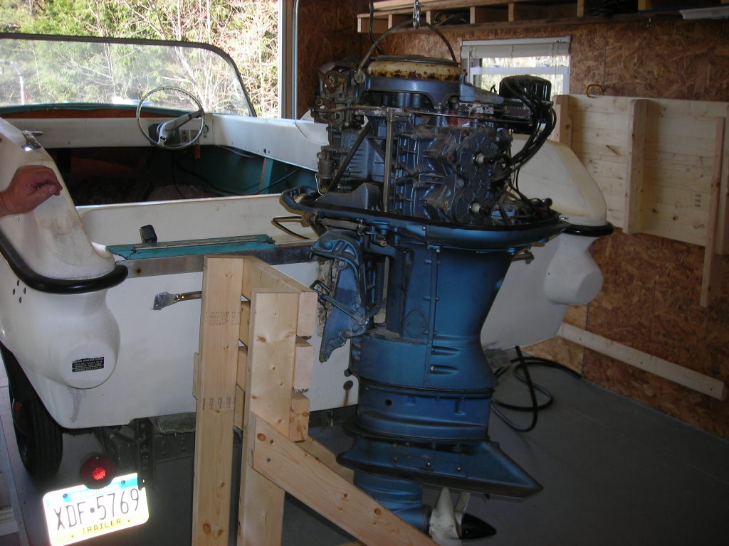

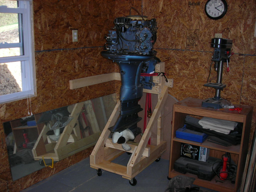

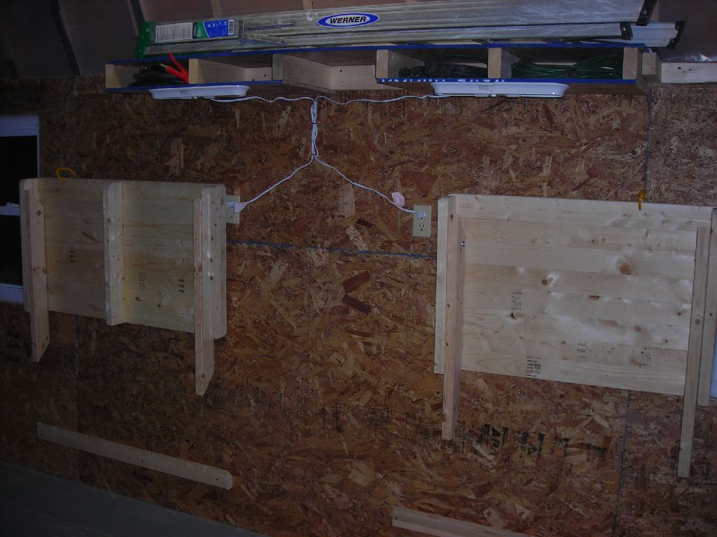

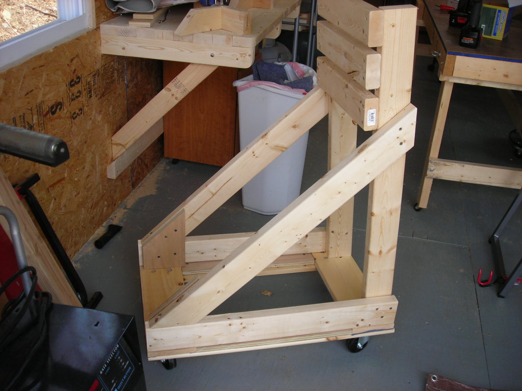

all the folks that have been here awhile have already seen these,but for those that havent,here is a motor stand made from a 20 dollar furniture dolly,it has a 5 degree rake to it,also the fold up tables i designed,i hope they can help someone new here,john

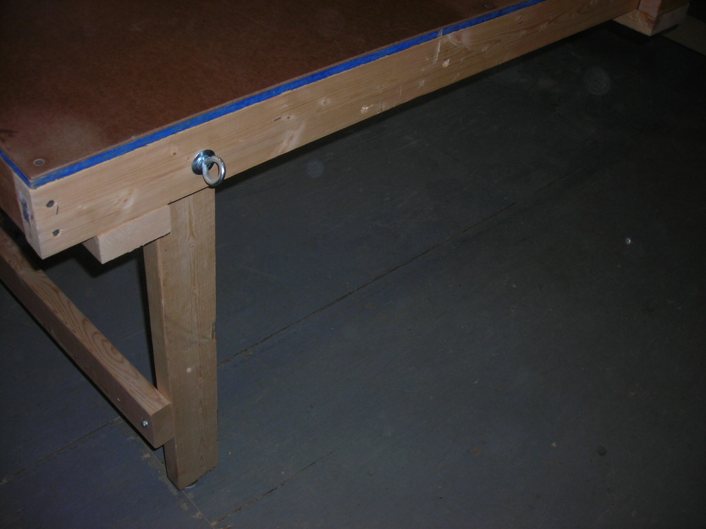

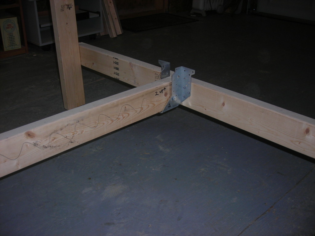

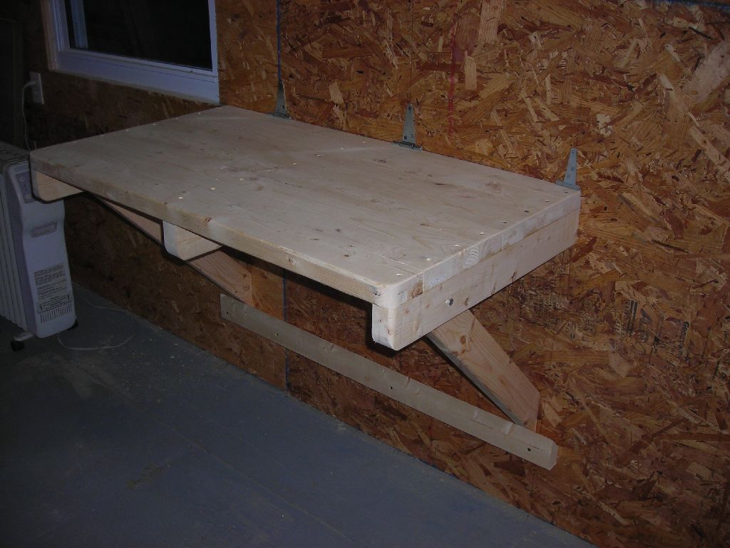

these are the fold away tables,my garage is only 14x24 so i need all the room i can get,heck everything i could put castors on it,i did.

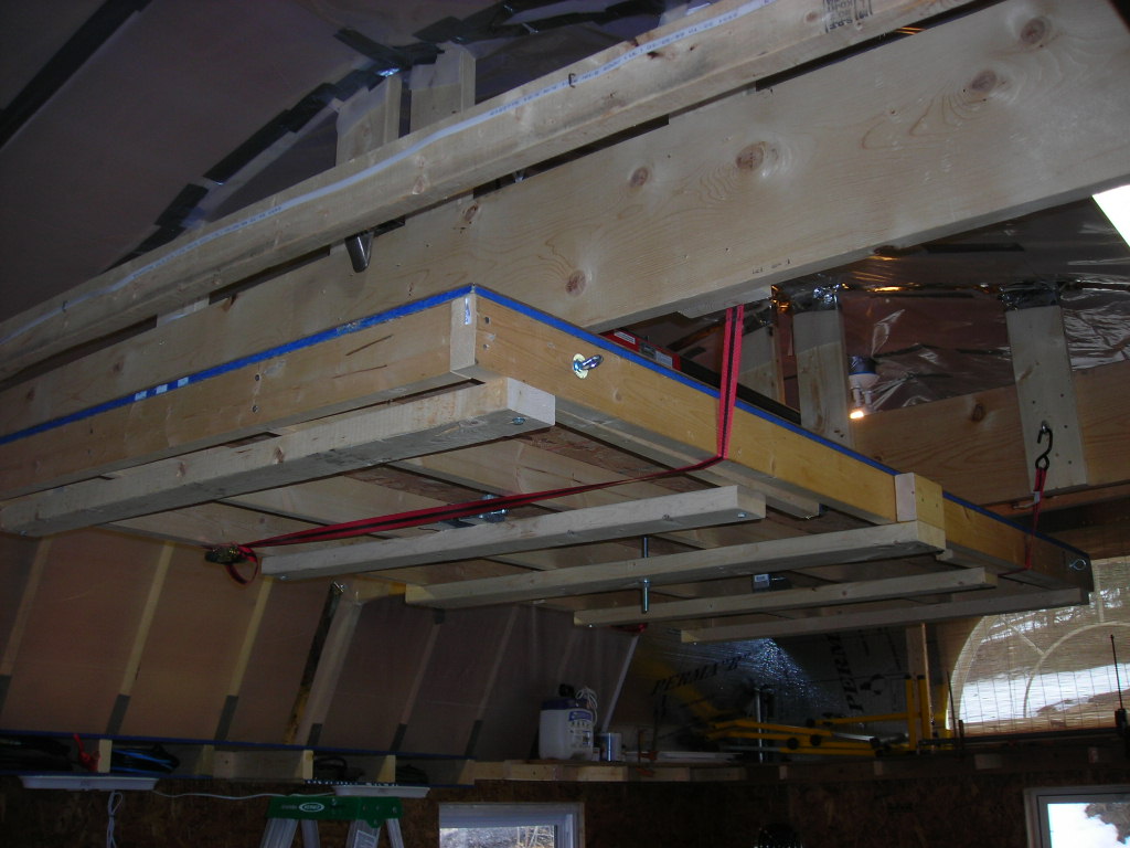

i also have a 4x8 homemade table the the legs fold up inside its self and then i can hoist it into the rafters. every angle on these tables are at a 45 degree angle,and the bottom support board is ripped at 45 degrees and screwed into as many studs as i could.
Re:time for motor stands and garage set ups 15 years 4 months ago #20511
Very nice John.
Re:time for motor stands and garage set ups 15 years 4 months ago #20515
Hi John,
Great idea, these look really nice. Ralph

thanks chris and birch,i think i have pics of the 4x8 table too.here it is up in the rafters ,on a electric hoist ,plus rachet straps for extra safety,its also on castors

Each to their own, but I don't like pine or fir for the transom on an engine stand. I use plywood there, usually two pieces of 3/4" fastened together.

I have motor stand made of 2x4s and 2x6 across the back for motors to sit on and have a 75V4 and a 75 Stinger on it and it hasn't bent out of shape yet and been there for a year. It is all put togather with long screws.

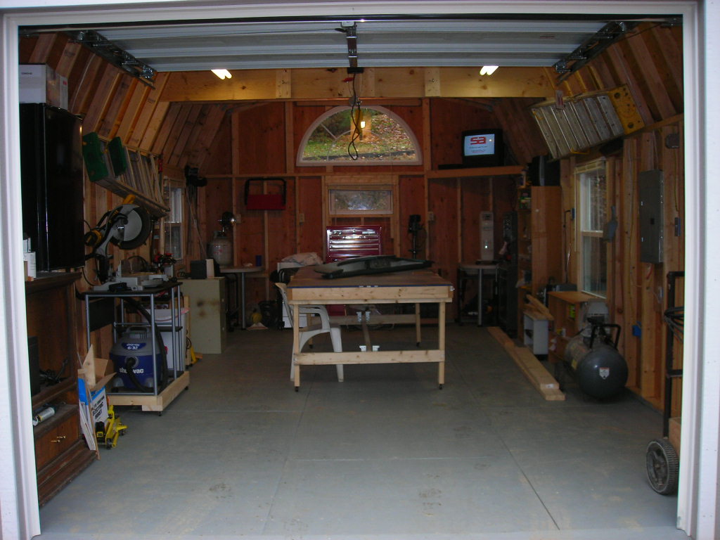

Excellent set up. I know what you mean about the space. Everything I have is on casters so I can wheel it out when I need to work. Ideally I would like a 20'x30' workshop but can't do that so I have to cram it all in a 2 car garage and still keep one car in it! I built a 12'x28' shed for the boat and garden stuff and still don't have enough room! That's why the wife says "no way" every time I look at another boat! LOL
Frank know what you mean. I did what Mike did though. I had some leftover 2"x4"s and a piece of 2"x12" and used it for the mounting board. Worked fine for the tear down of the Fat Fifty.

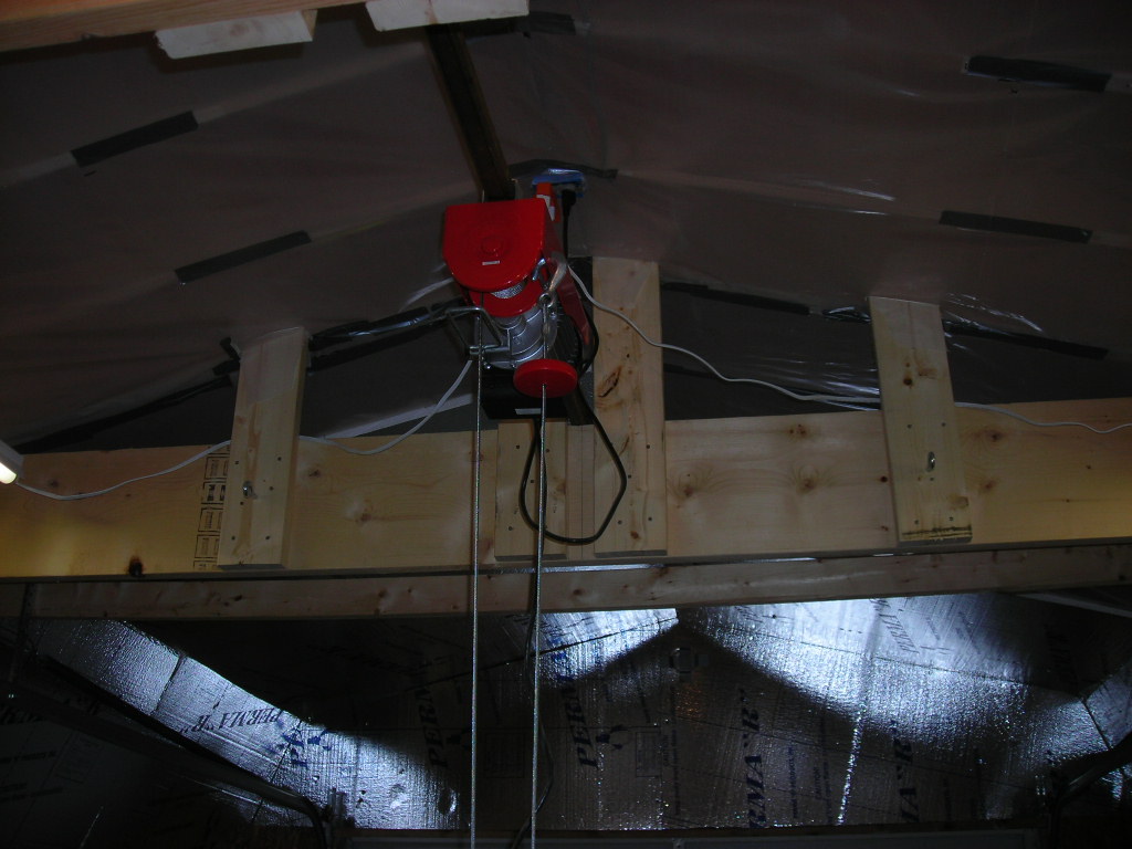

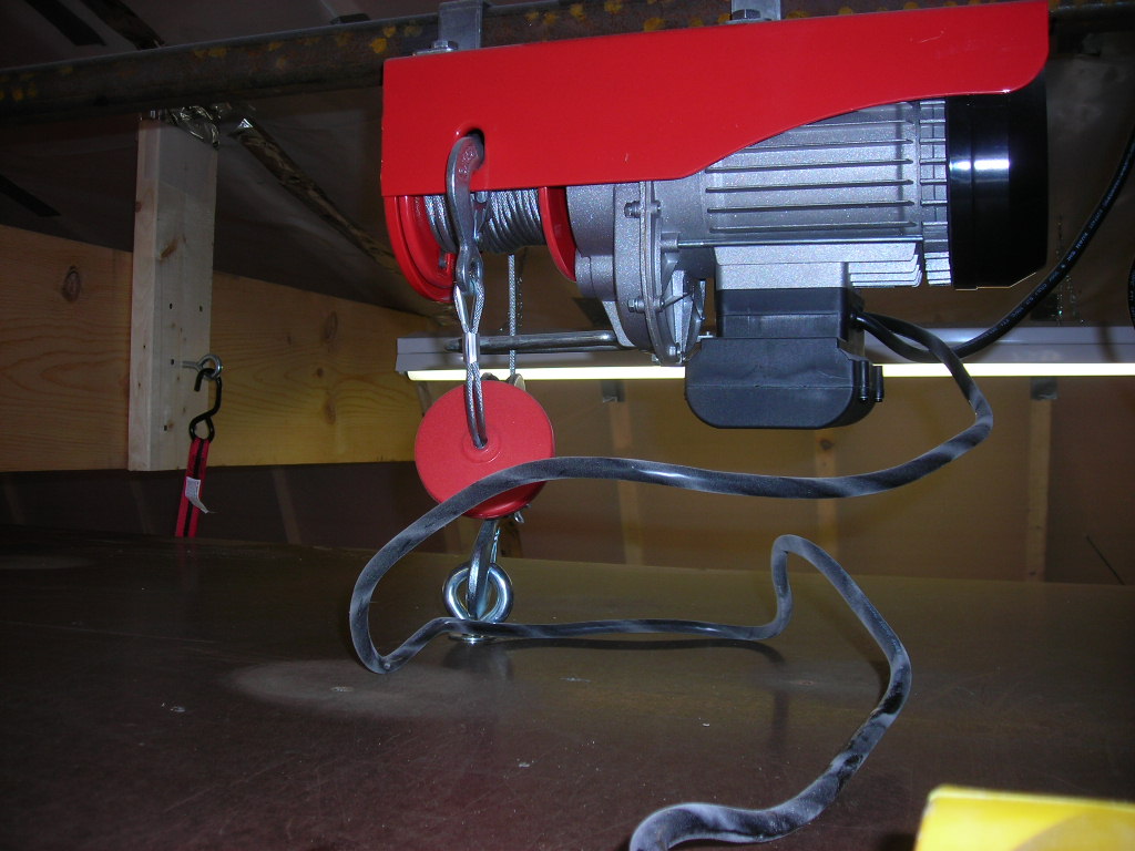

was curious that winch you have to you use to split the deck off boats?....how is mounted in the rafters and what is its lbs. rating?

thanks guys the plywood is also a good idea,i built it in 20 minutes just before ed got here with the boat and motor,2x4s were all i had,its been over a year now andno problems,that is a 63 starflight 75 hp on it too.
thanks path ,i have a wider one in my basement so i can put a cut off plastic barrel under the motor.
,thanks mike,yeah me too the bigger one in the basement has a leftover 2x12 for the motor to sit on.
matt yes i used it to split the deck from the hull in the lido,i also used it to hold up the front of the sunray while i took the trailer out from under it.plus it takes big heavy motors off with ease.
its mounted on 2 2x12s going across the rafters with supports above and below them.
then there is a 2"x2" square steel tube,1/4 inch thick steel,with old back hoe teeth on them,at the ends so it doesnt slide off the 2x12s.
the 1100 lb hoist is attached to that.in the 2nd pic the 2x4 under the 2x12 is not a part of it,its a brace that the builders put across from wall to wall,i didnt make it that crooked.
in the last pic it shows a little of the shelves i built with storage underneath for things like extension cords,air hoses etc.

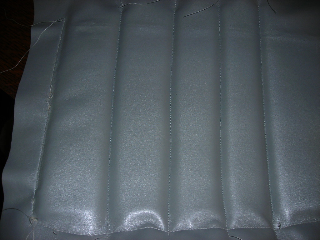

bob i know what you mean,i put my 4x8 table in the basement,just so i could do the up holstery on my boats,im just now learning ,and figuring out how to use my grams 1917 treadle sewing machine,to do upholstery,i had to put a new belt on it,and thread it and the bobbin,i dont have any manual for it so it took a little time but i got it figured out and started to play with it,heres a practice peice its my 1st time sewing so i wasnt concerned yet with straightness as much as was with running the machine.

Glad to see you got the machine going! looks like its sewing well from what I can see!

Glad you got the machine running. Looks good so far, can't wait to see the finished product.

thanks jesse and bob,but dont get your hopes up,lol,this is all new to me when i did the sunray there wasnt a stitch in it,lol,john
