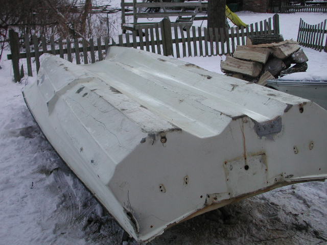

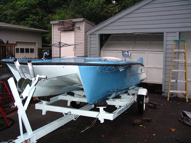

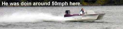

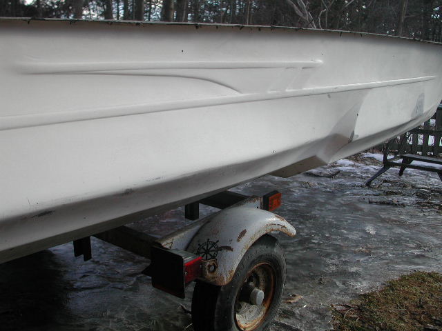

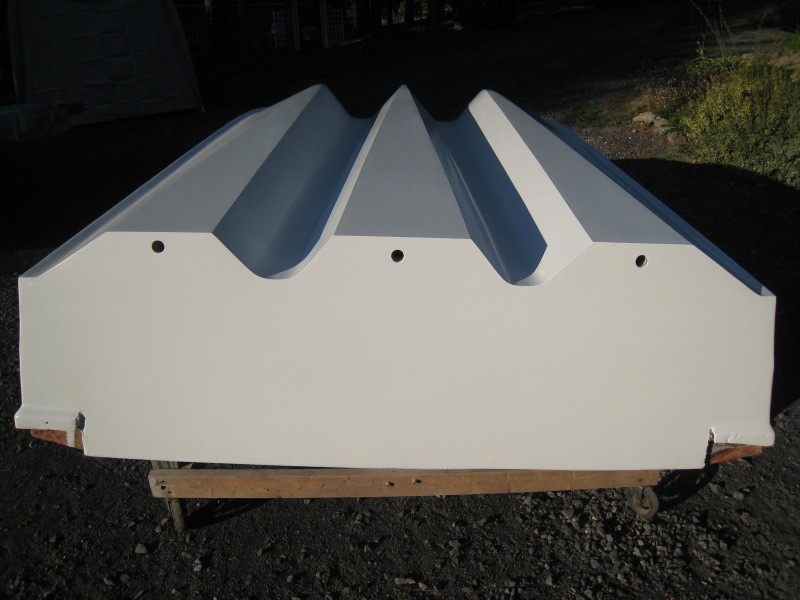

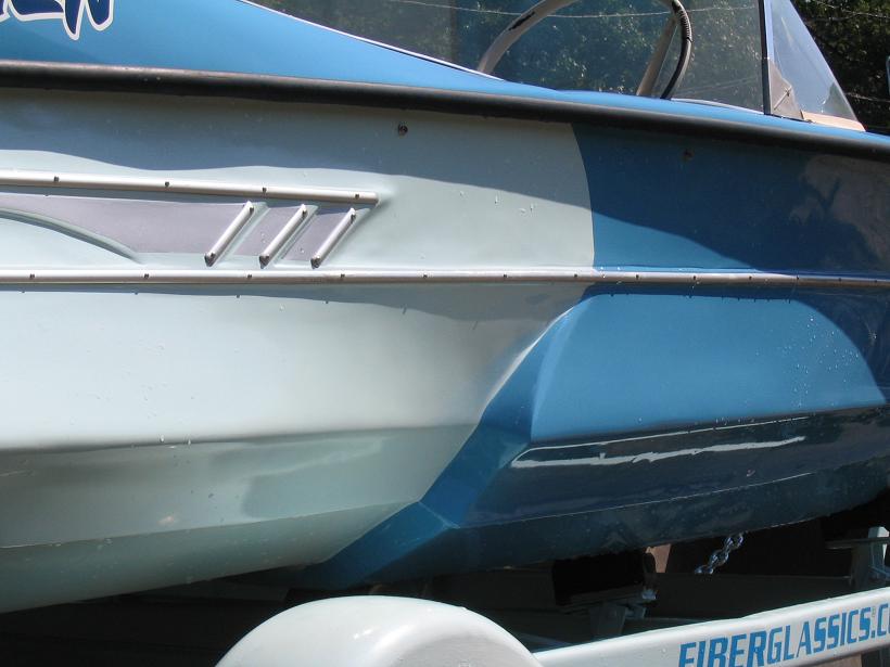

I may agree that the Rays aren't cats, they're tunnel hull 4 point hydros more likely. The Manta Rays raise up the forward sponsons and ride on the back of them and the rear of the boat. The Power Cat I consider a true cat as the design has two distinct sides to the hull. Probably splitting hairs here if you look at the photos below. Hard to tell the design difference between a 61 Manta (that would be exactly like the 62 without the center pod) and the 61 Power Cat. Both have similar design features, absent the step in the sponson on the Manta. This is the bottom of the 62 Manta, the 61 Manta under way, the stbd sponson of the 62 Manta, and the bottom of the Power Cat 18DC.

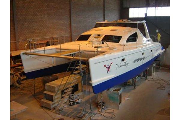

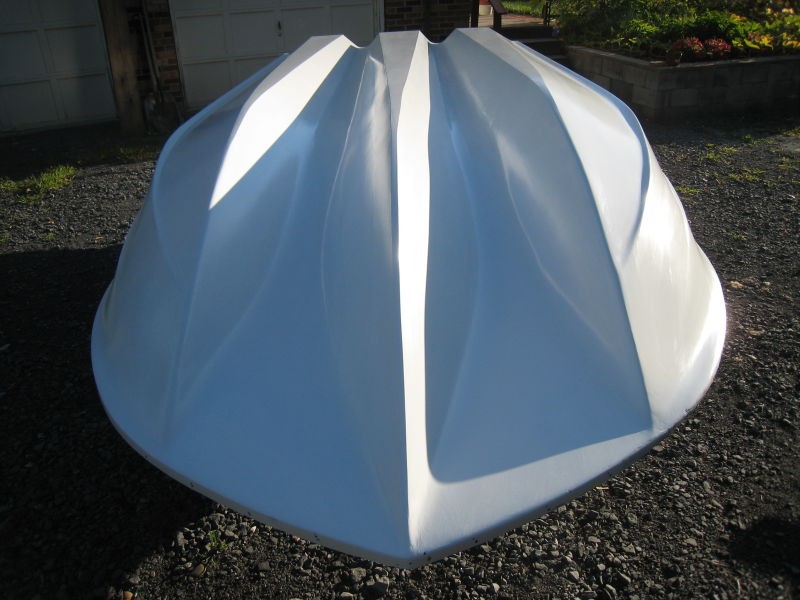

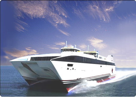

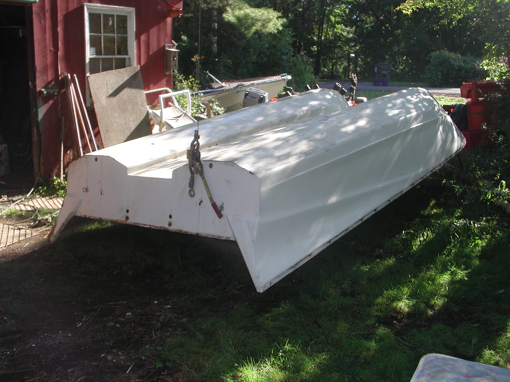

try telling donald canazzi that. lol the center pod mantarays i would agree they are not cats. a 60 or 61 mantaray without the center pod is barely a cat. powercats that have the middle sponson aren't cat's. this is what a real cat looks like....bottom pics...thats my understanding anyway. ok..bring on the heat... think this last one is bill anderson's. hehe

hehe..would love to hear Canazzi's reply. too bad he is not with us anymore. i called my devilray a cat also when i was younger. the pic brian posted of the hull bottom, i believe is his powercat. now that hull has no step to break it up and is a true catamaran. the mantaray however with the stepped hull i guess you can make an arguement over. john wanted to see if i had any gander left. thats how he judges my health.:laugh: ron

frank this is the ist time i really saw the underside of your cat,very very cool.
