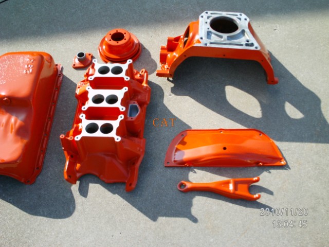

I have two powder-coated motors (powder-coating done by prior owner). The thickness of the powder coat is a challenge when reassembling- parts don't mate together like they should/fasteners don't seat as well. Wouldn't be my choice. Sandblasting, zinc phosphate / zinc chromate bare aluminum primer, and a good automotive paint work for most everyone. Clearcoat helps as well- apply over the new paint and decals.

Yea, unfortunately, some coaters don't take the time to mask off mating surfaces. Bad karma. I make a point to mask off all mating surfaces. At least ask the owner of the parts. Powder shouldn't be any thicker then paint. Anyway, Thanks for the input. It's always valued.

Glad you're a pro- on my motors the fellow who did the work wasn't: he powder-coated right over a stripped bolt and filled some important screw holes (2 '57 Evinrude Larks)

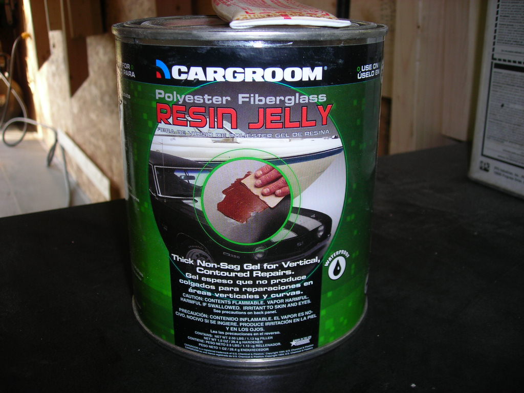

jt,i use fiberglass resin jelly,its a little stiffer then bondo,but it works the same,i think it sands nicer to,its good stuff in my opinion,john

I used the resin Jelly on acouple scratches on My hull and its held up really well in most spots also, there is one crack I need to address better because the resin jelly cracked again and there is a slow seeping leak there. So I think if the star crack is too deep it may need fiberglass patching then the resin Jelly.

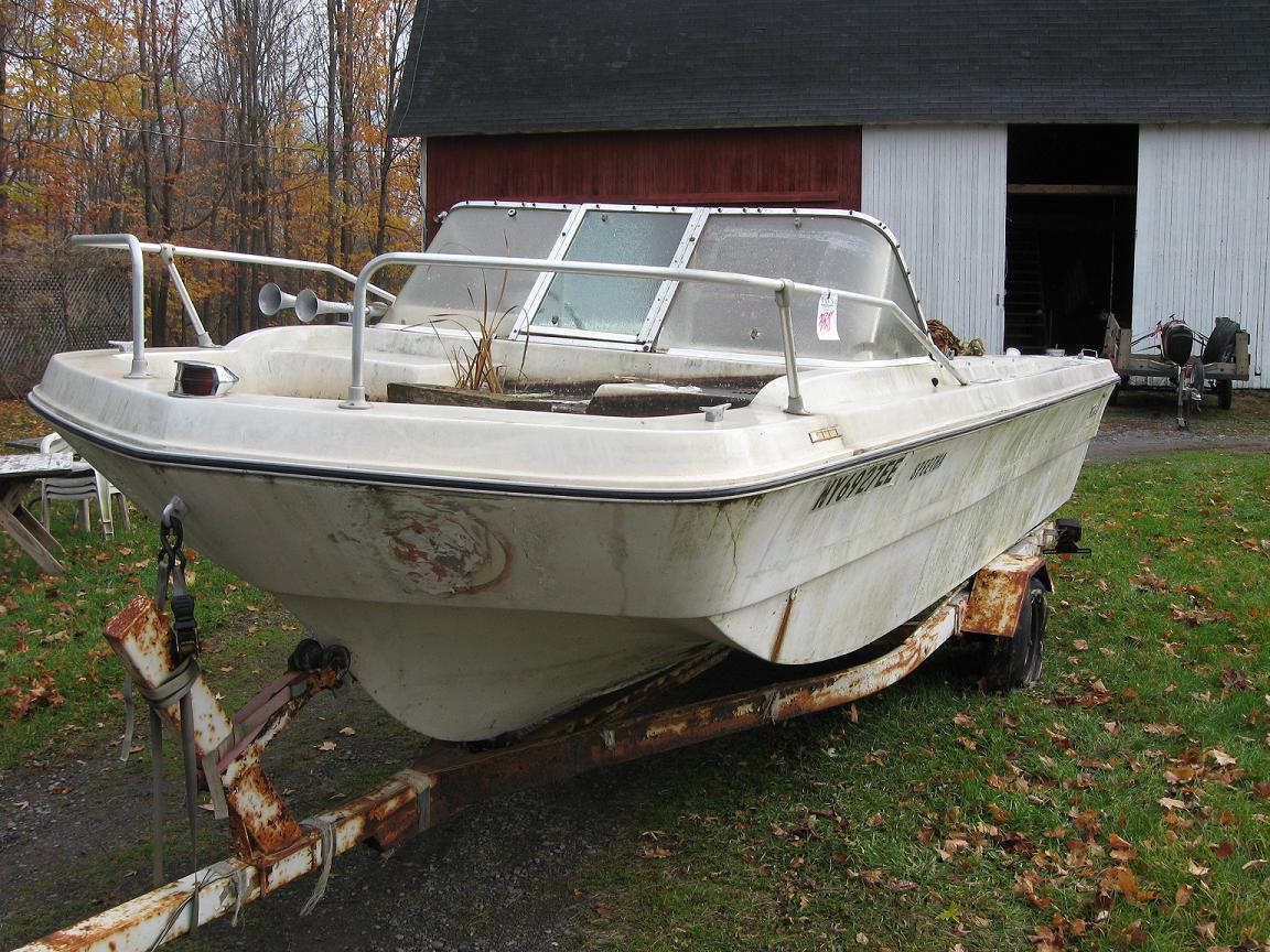

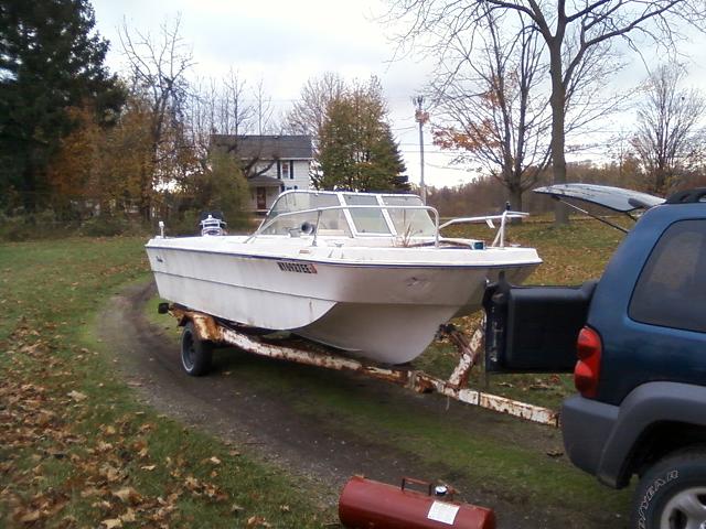

I wonder if that boat is really from that vintage. Tri-hulls like that were not round in that time frame that I recall. Looks more like a 60-70's design that a 50's to me, but I am not familiar with the builder. Looks similar to Thunderbird boats which were 60's-70's.

I have to agree to a point. The only physical evidence that I found on the manufacture is an article from a boating magazine dated 1969. But it did not have the curved windshield that was popular in the late 50's and early 60's. And since I posted, I found (thru a cop friend of mine) that the boat was registered as a 62. Now if the boat manufacturer's followed the automotive styles, as it appears they did, that could be the case with this one. So, I guess I have to say that it is a 1962 for the sake of an argument. Which is fine with me, as it is still vintage, like me. B)
The Thunderbird boat is a very similar design and I thought that maybe the Cathedral Yacht Corp may have been bought by them. But I think the boat companies back then were a lot like the RV companies of the time period and went in business and out as fast as they were bought up. But probably not. My boat company seems to be lost in history somewhere not to be found. :(

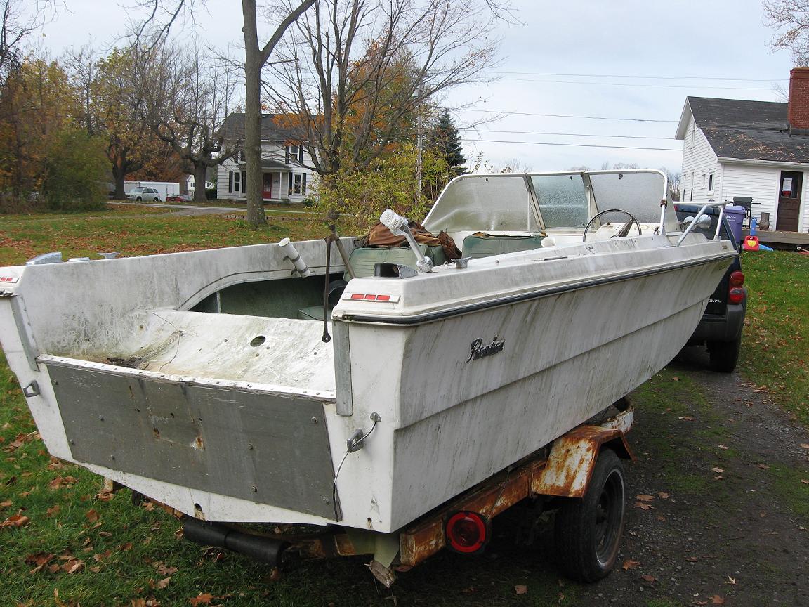

Probably not Helpfull but My Renken 18 looks alot like yours style wise and is a 1969 just for style reference.
I would think these two boats would be from the same time period. Just my thaughts.

Looks real close to mine. I have seen the Renken's. Not a big issue with me really. Mine is registered as a 1962, so guess I'll go with that. At least for the time being. I just want to get it back in the water. Had it in a couple of times before I put it up for repairs. I'm excited to have what I have and looking forward to using it. Thanks, everyone for the input. If anybody comes across anything about the boat company or my boat in general, please post it.
