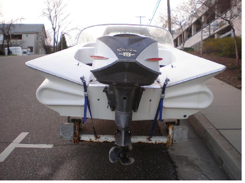

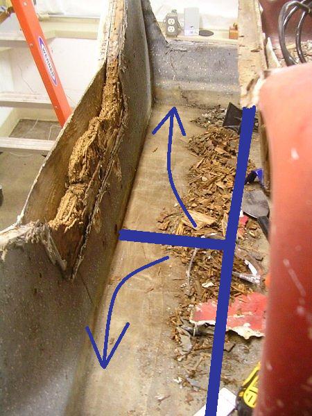

So, I have finally got the time tonight to head out and work on the Lake N Sea, but I find myself at a fork in the road so to speak... I want to take my transom out, and have removed the fiber glass cap and the dried resin around the top of the transom, and was hoping to pull out the old transom to use as a patern... my hope is then to inspect the cavity, see how things are and most likely cut out withe the inside (what i am leaning towards) or outside fiberglass transom skin so as to replace the transom properly... my problem is, the transom just won't budge.. you can see that the central portion is completly rotten and has the consistancy of a wasp nest... but the outer two thirds of the transom is rock solid..
My assumption is that the transom must be attached to some sort of stringers or floor inner structure. Is this so? HAs anyone ever had a Lake N Sea completely apart and may you have photos or be able to draw a diagram of what a lake n sea inner-structure is like?
I know that for the more experienced, I may be way too cautious... but I will be learning fiber glass repair on this project, and am a big fan of inspecting fully, and cutting once. I also want to make sure I do not effect the heavy resin and fiberglass gussets on either side of the transom, as I believe this is where the transom gets its strength...
I really feel like I should be sutting out the complete inner skin of the transom, and taking the plywood out that way.. but do not want to cut too little or too much...
Anyways.. this is where I am at... any good guidance, or photos, experience would be much appreciated so that I will be confident moving forward. Thank you in advance for photos, comments, advice, etc.
Cheers
Andy
I tried to pull out the transom by using ratched straps, a joist, and the boat's weight.. nothing budged!

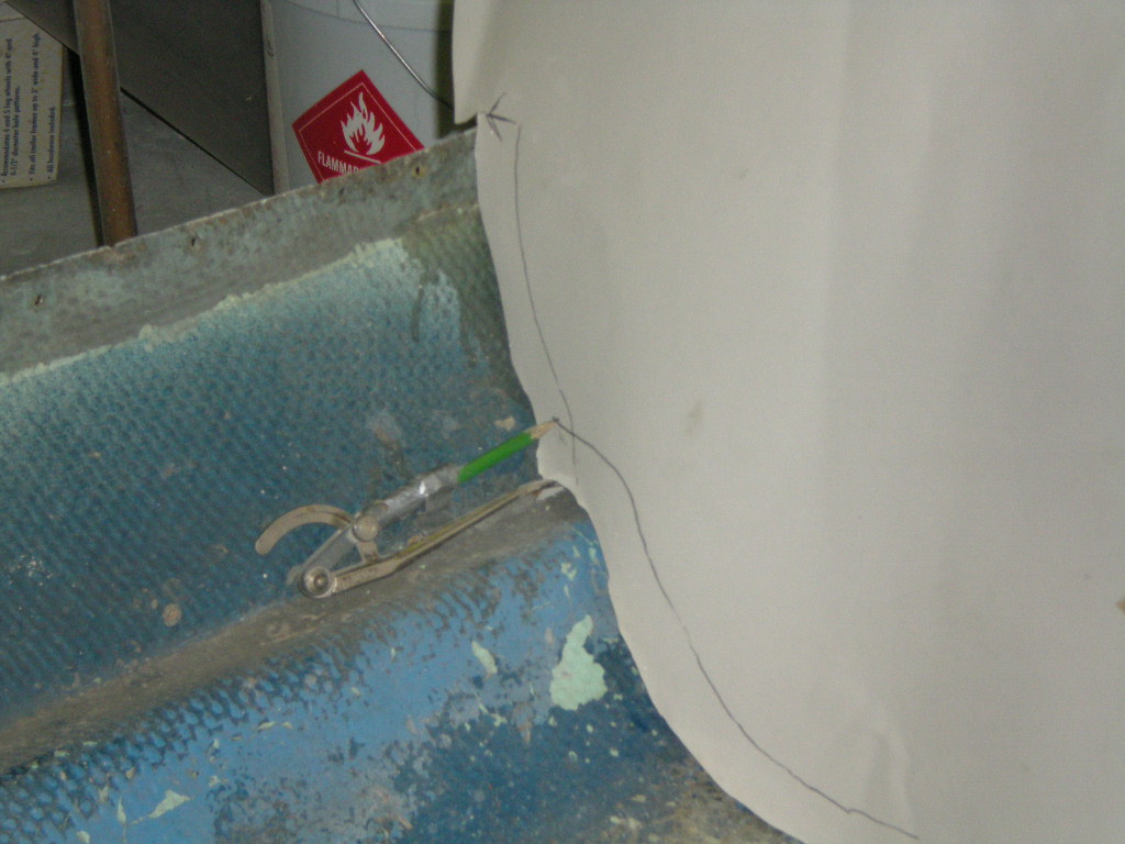

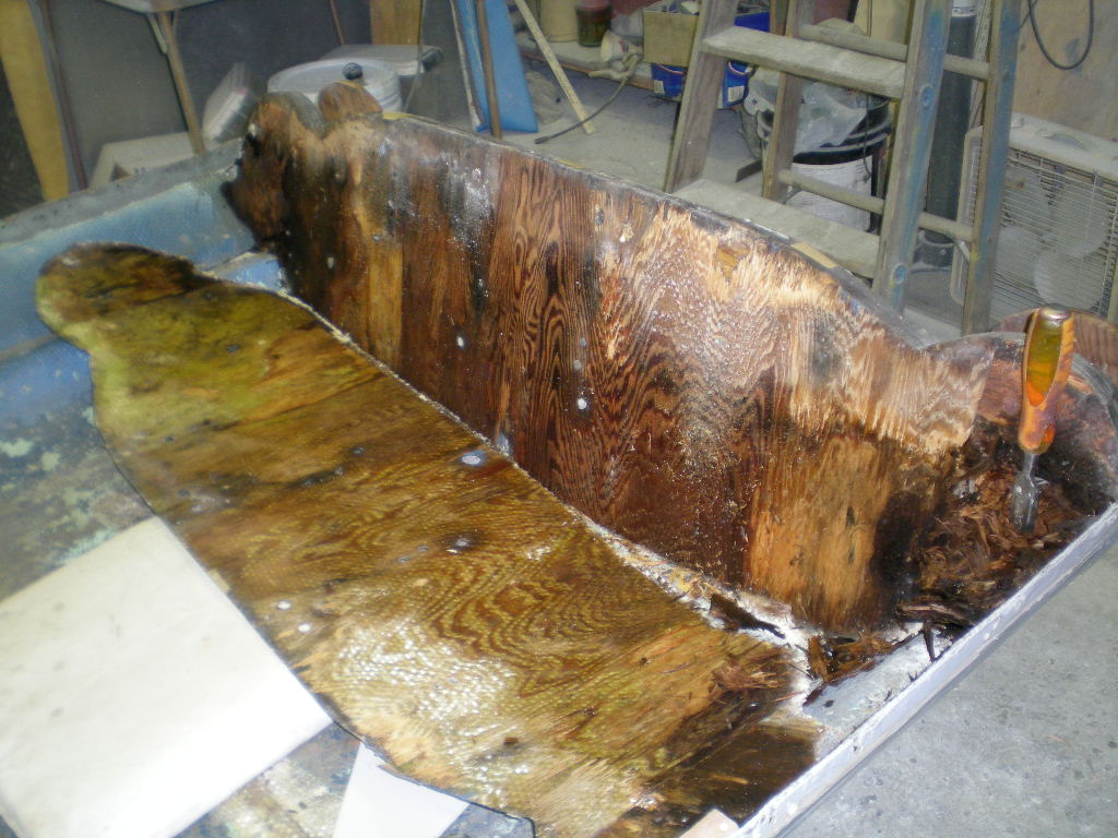

Re:Transom inner structure Lake N Sea 15 years 8 months ago #20033
Doug has nailed it ya just have to keep at it until you have all the old wood out. A couple things that may make it a lot easier. Take a skill saw and set it to cut thru most of the wood. Measure your transom it will be about an inch and a half. Set the saw at one inch cut some lines in the old trasnsom. Then use a wood chisel to remove what will come. You must remove all the old wood. Couple other tools that work are a sawsall, air chisel.

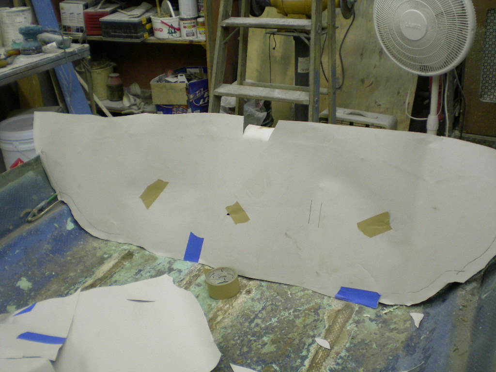

Do not worry about the pattern cut some cardboard and tape it in where the old transom was scribe the out line you want on the paper or cardboard then transfer that to you new wood.
D
Couple pictures.

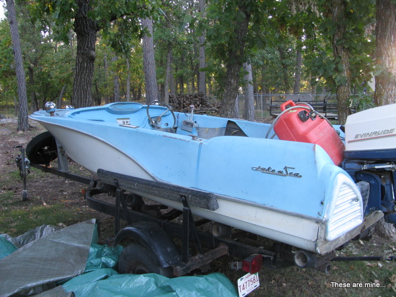

THANK YOU GUYS FOR THE QUICK Responses! I did not add to the post, as it was late when I posted as well.. haha.. I do have the plywood separated from the inner and outer skins using a combination of flat-bars and a good hand-saw... that is why I thought I might be able to pop it out...
This is why I now think that the transom must be attached to some kind of inner floor/hull structure.. so we shall see..
OHH and big revelation I had a few weeks ago... THE LAKE N SEA louveers in the rear... they are hollow! as in, the louvers waffle in and out on the inside of the transom, just like they do on the outside.. leaving horizontal voids between the louvers and the transom wood... pretty interesting! I would have thought that the louvers were solid resin pieces... NOT SO!

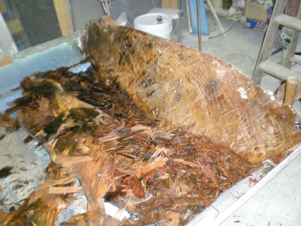

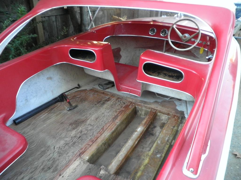

So..... I uncovered the transom!
Measure twice.. cut once?
pneumatic cut-of wheel, circular saw, and regular handsaw were used to make the cuts!
The inner skin is broken free..what will we find?
6 stringers! fiberglassed into the hull... 5/16" to 3/8" thick fiberglass deck over top... it appears the decking is fastened to the stringers via a few small nails, whose heads were then glassed over..
more to come...

stringers are roughly 7 inches on center... and 2 inches wide...
Note the 1-by piece of blocking spaning three stringers on each side, between the transom core and the stringers..this is atached to the stringers via only one nail, through the 1-by and into the stringer end... not attached to the transom by any mechanical means..
this image shows the two 1-by spacers at the end of the stringers.. the open space is right above the keel...
showing the depth of the stringer... yes, most of the fiberglass encapsolating the stringers are cracked at this end... will just seal it back up the best I can..
photo of one of the complete stringer spacers removed...

spacers removed and everything vaccumed out.. I still need to remove the plywood transom next.
view of side of transom where inner hull meets the deck.. the white lines are from slight scuff marks left by my handsaw... no damage.. much easier to use the handsaw here than to risk cutting through the outer hull with a power saw.
up NEXT... removing the transom core... comming up this week.

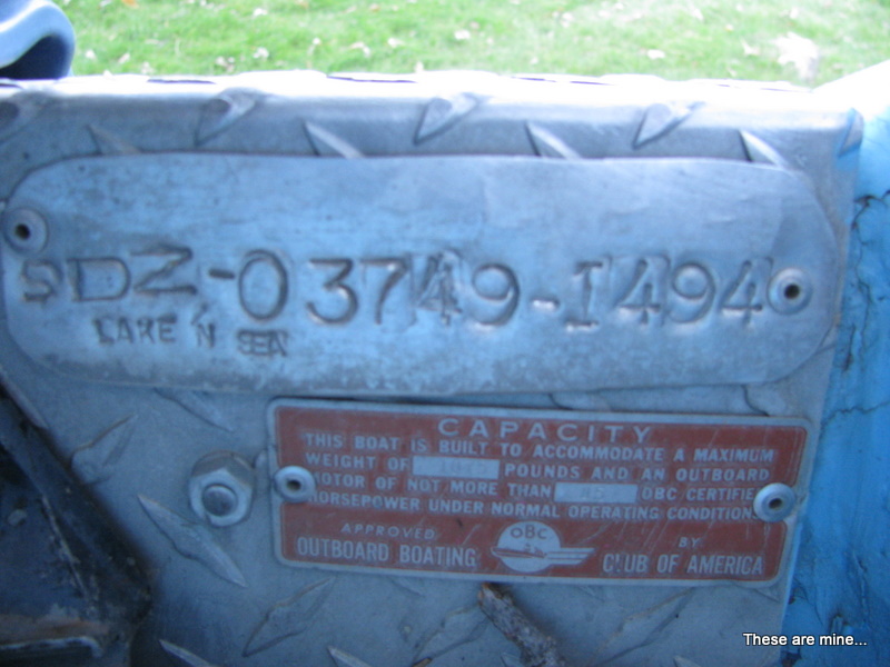

Re:**UPDATE** Transom inner structure Lake N Sea 15 years 4 months ago #27977
Thank you for the very detailed pictures of underneath the floor. I have recently acuired a 59' Lake n' Sea Caribean, it sank. It has a crack all the way along the bottom back corner of the boat. I'm 16 and this is my first project and I need help! Any suggestions? I also know very little about this boat, I am only guessing it is a 59' but it could be a 60' so any info on it would be great. provided the pictures deside to show up...
Re:**UPDATE** Transom inner structure Lake N Sea 15 years 4 months ago #27979
  • retro54
  • retro54's Avatar Topic Author
  • Senior Boarder
  • Senior Boarder
  • Posts: 222
  • Karma: 6
Strat.. looks great man! I'm only about 10 year older than you.. this is my first project as well, so no worries, there are lots of good guys on this board who will be happy to help you out. If you would like to figure out the exact year of manufacture, you need the hull number which is located on a plate with the 'Parsons Corperation' name on it, this is located on the left side of the front seat, hopefully it is there.. then e-mail the guy who runs this website.
www.lakensea.org/IdentifyingaLakenSea.html
and actally, check out this page shown above, this will show you the plate location... and give you some history on the boat, if you e-mail the gentleman who runs the website, he will give you the exact year.. good luck and feel free to e-mail me. This email address is being protected from spambots. You need JavaScript enabled to view it. cheers!
Andy
Re:**UPDATE** Transom inner structure Lake N Sea 15 years 4 months ago #27982
Thanks!, I've looked for that plate but could not find it, I do however know it is under Parsons Corporation. I found another kind of plate on the back of the boat, took a picture of it and sent it to the man at the website and he said that he has never seen a plate like it before...and one more question, how would I tell if the transom plywood need to be replaced like on yours?
Clay
Re:**UPDATE** Transom inner structure Lake N Sea 15 years 4 months ago #27994
  • retro54
  • Senior Boarder
  • Senior Boarder
  • Posts: 222
  • Karma: 6
My transom, the fiberglass was completly cracked on the top, with a butcher job transom extension. ONce the fiberglass was removed, the center of the transom had the consistancy of a wasp's nest. not very good! If you look and search for other posts on this board, I beleive most of the guys tell ya to hang on the transom, put your full weight on it and bounce it, and if it flexes, it might need replaced... mine also had cracks down at the bottom of the hull where freeze and thaw had pushed it... this is how I know that I needed it replaced. so... take those suggestions for what they are, I would not take the boat appart to do this, unless there is clear cracking in the fiberglass (from the transom flexing) or if you ahve other reasons to believe the transom is no good.. I would enjoy the boat, if you can, before doing all of this... haha...
I believe what you see there is a state ID plate and capacity plate, has nothing to do with the manufacture of the boat, but most likely corresponds with your registration number and boat liscensing for the state the boat was registered in, I have a similar "Pennsylvania" tag on the driver's side of my boat, keeping me to a capacity and no more than I bieve 65 hp. on the boat, although this is just PA rules.. haha
hope that helps.. I would start a new thread and post your transom question there... although I would really steer clear of taking this thing apart, unless you absolutly have to.. as a new guy in the hobby, having a boat apart, that doesn't float, can really kill your enthusiasm quickly.. use it, imporove it, enjoy it, those are my suggestions!
Andy
