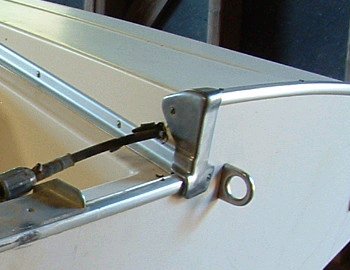

I am restoring a 1959 Glasspar G3. I am missing a few trim pieces around the motor well, specifically the corner pieces in the middle of the photo. I know a number of owners raise their transoms when they replace the wood, in which case they wouldnt be using this trim... Does anyone have these pieces that I could purchase, or at least borrow to send to the local foundry for reproduction?

Dr. Frankenmerc came through for me, and lent me the pieces off his '59. A local foundry (Tacoma, WA) Custom Castings is reproducing his parts. During the sand cast process, they will clean up the part surface/edges and removed the previous holes, so I can redrill them. Part shrinkage was an initial concern of mine. The foundry said that it would shrink 3/16" over a foot of length. The only critical dimension is between the transom and the top of the deck. Over this short length, I should see only about 3/64" shrinkage. This isnt a big deal, as I'm re-doing the transom now, so I will just add 3/64" of height to accomodate for the trim shrinkage.
The guys at Creative Castings were great to work with, using email and phone... I mailed them the parts, they promptly called with an estimate (only cost $16 each!). I will post a photo of the new parts, I expect they will arrive back to me by mail any day now.
