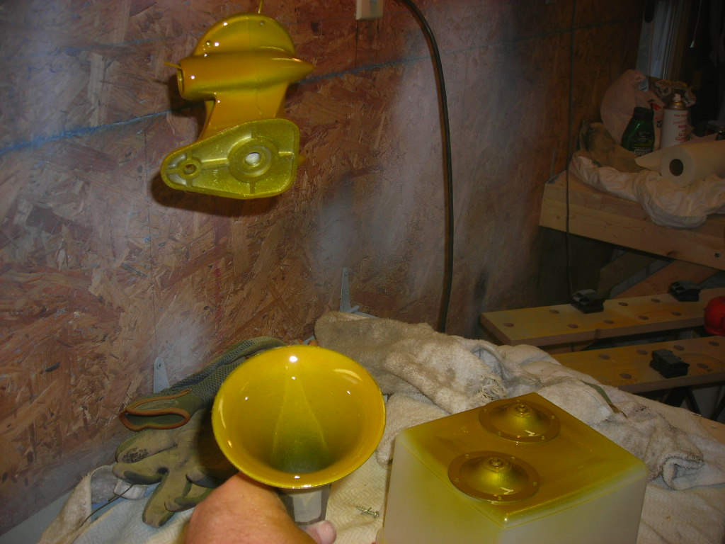

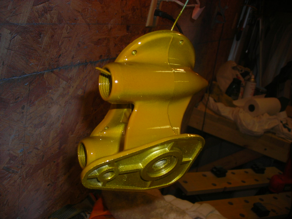

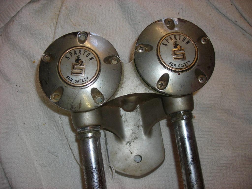

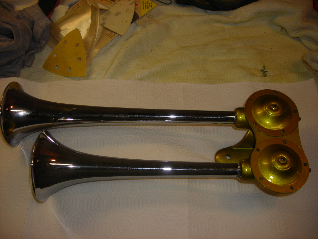

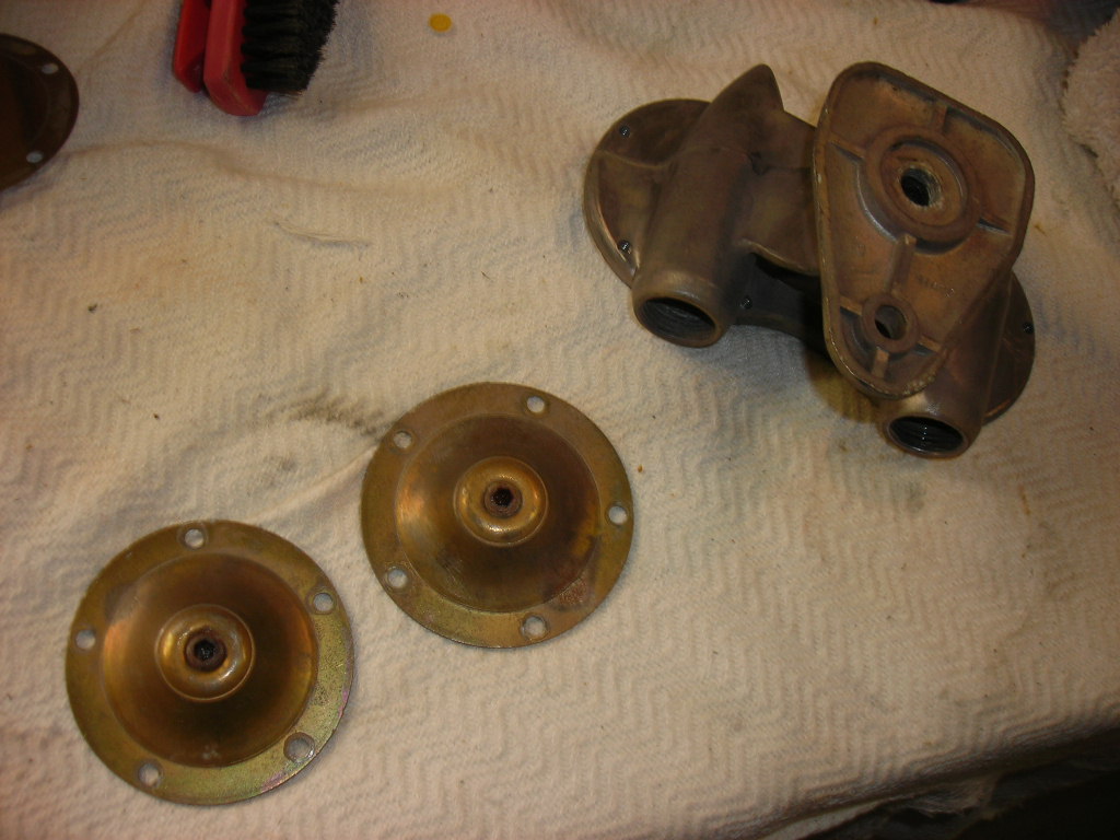

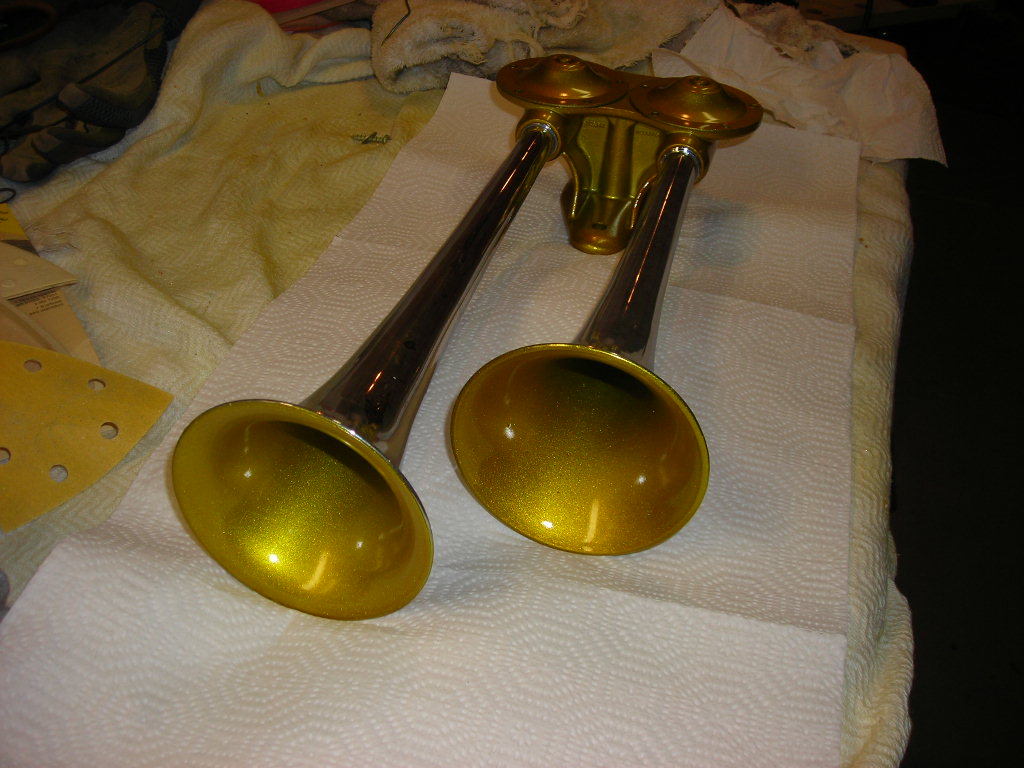

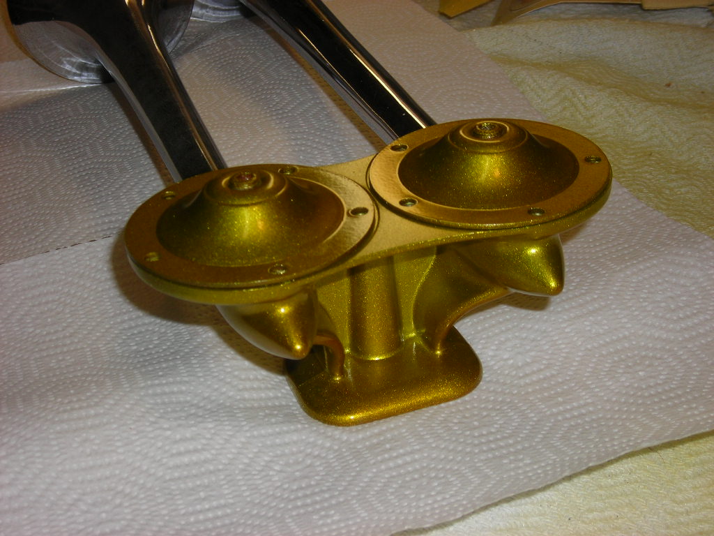

mark,here are your airhorns so far,i will put them together in about an hour and post that pic too.
these horns were worse then the picture on ebay showed,so they arent perfect ,but not bad for old vintage horns.
whoever owned them before had painted them with silver paint,so all of that had to come off,i soaked them in paint thinner for awhile then sanded the heck out of them.
the inside of the trumpets were pretty bad,but lots of sanding fixed that then clear primer,then ground coat,then paint.
so heres what i have so far,there are 5 pics,im on dial up.then after they are together ill post that pic later.
mark im not going to put the hex screws back in im going to get stainless screws to replace them.
the pictures dont show the color right but i think they will match your boat pretty good,i hope,lol,they have a metal flake finish.john

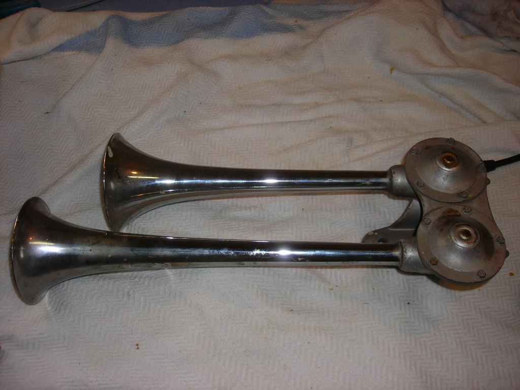

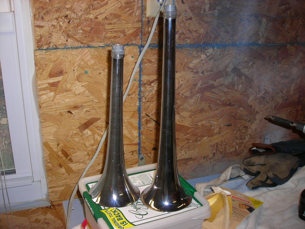

the trumpets after removing paint splatter and then buffing.

Nothing more satisfying to me than Bringing something most people would throw out back to life and looking better than new! Great work! I love fixing old kitchen equipment and machinery like this!

stashm,yep,me too,i just wish there was some sunshine to how the metalflake better,and the chrome is not perfect by any means,but i think they are better then when i got them,i was the only one to bid on them so i got them really cheap,postage was twice what i paid for them,lol,john

They're looking great John, I'm sure the color will be just fine. I don't know why some digital cameras do that with colors, mine does the same thing sometimes. May have something to do with the light, I have noticed the pics sometimes make the same thing look different between indoor and outdoor photos. I'll be proud of them regardless, 'cause YOU did them! Thanks buddy, your check goes in the mail Friday. ;)

mark,no dont do that,like i said they are free,i dont want anything for them,im happy to have done them,and here they are finished,4 pictures of them,they are not perfect ,but its the best i could with them,john,p.s.ill do the same for anyone on here. at least you can kind of see the metalflake. they will look better once the stainless steel screws are put in.
Re:mark's air horns are finished 15 years 8 months ago #19960
Those are going to look great on my Glastron, nice work John. The newer pics look more like gold, and the flake really sparkles!

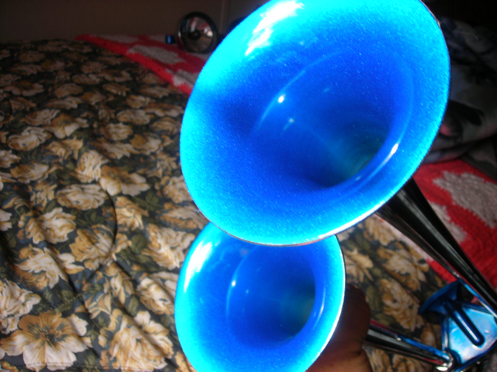

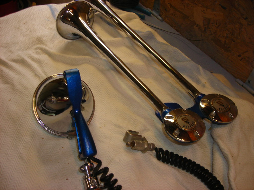

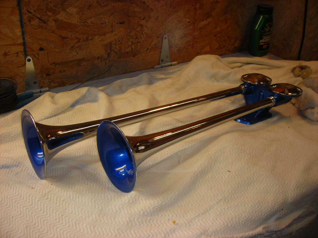

bobo thank you,i already thoght of that,lol,heve people send me thier horns and ill restore them,heres pics of the huge air horns i restored in blue for my boat,heck when i pulled them out of the box i thought it might be a lost cause,but they cleaned up pretty nice,lol.john

I saw those on your other post ..Very Nice ..I wonder how that paint will hold up ?? Is it Enamel ??

bobo,tahnks and yes its anodized enamel,its made to go over chrome,and is heat resistant up to 500 degrees acording to the company,so it can be used on engines.

mark i went every where looking for stainless screws for around the top,and i do mean every where,lol,the horns take 10 by 24x 3/8s long screws,im going to have to send them to you like they are,and you will have to probaby order them online,ill ship them with just a couple of screws holding it all together until you can get others,john

mark your air horns shipped today,sorry it took a little longer then i had thought,they arent perfect but the chrome was really bad and inside the trumpets were badly pitted,but they came out ok.
remember to get stainless screws for the tops,i didnt tighten down the few regular screws i put in,i didnt want to scratch the finish,the horns original screws were 10x 24 x 3/8 they stuck down a little ,10x 24 x 1/4 MIGHT work,you will have to see when you get them,john
