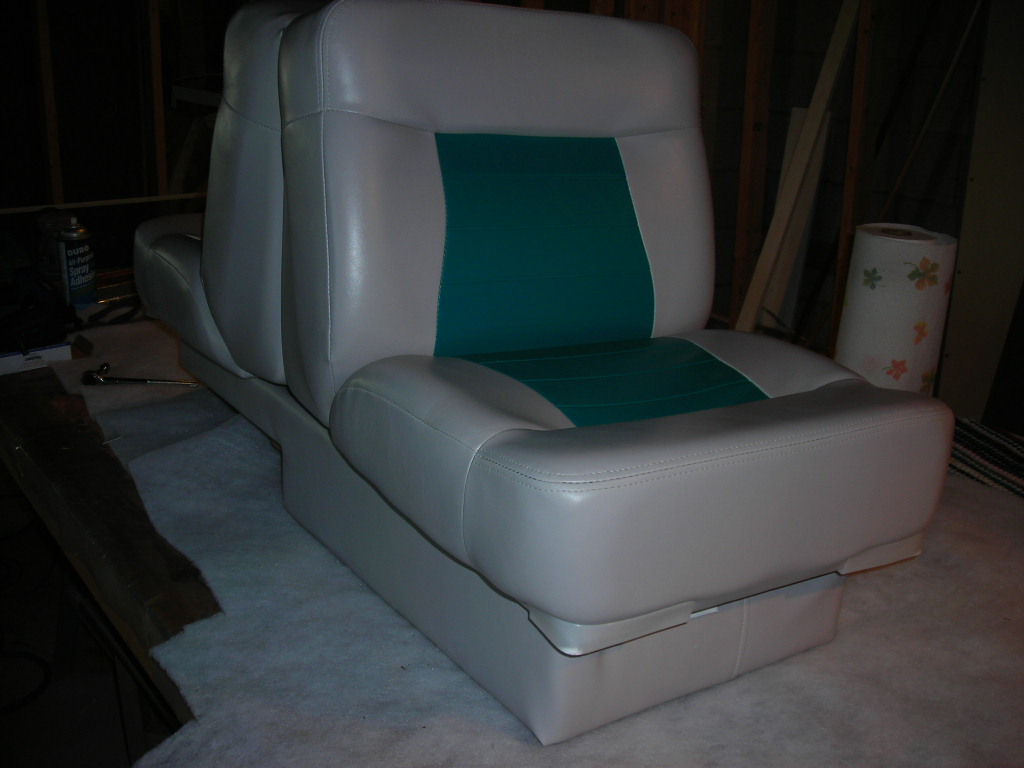

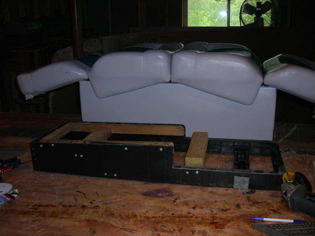

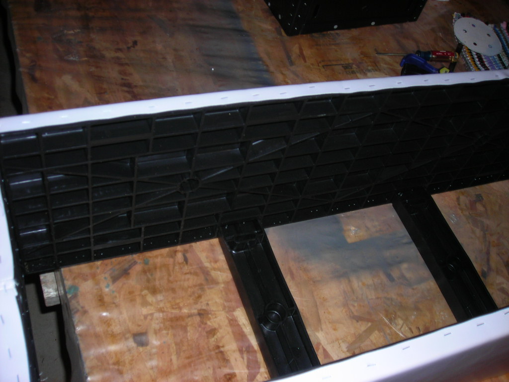

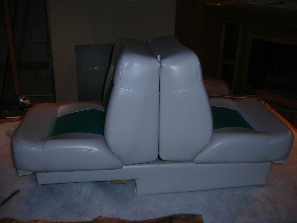

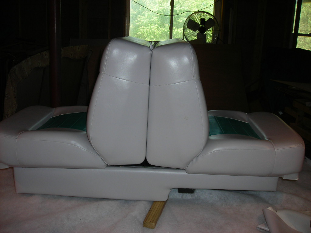

yes the seats we got for the sunray i had to cut down the bases,they were 10 inches high,i also had to cut them to go up over a step up platform,and to conform to the bottom of the boat,does you boat have a flat floor ?heres what i had to do to the bases,john heres a pic and in the background is how they came with 10 inch bases,in front is how i had to cut them down,(the black plastic,its upside down in the pic to show that i had to add wood supports. this is why it was a little tough to cut them down,the inside is kind of honey combed,but none of it is uniform. and heres the starbord side finished and reupholstered,the port side had to be cut down just the oppisite because of the floor not being flat,i hope these help out,john hopefuly in the last pic here,you can see why i had to cut out for this step up.john

John many thanks !!! Good work, on the seats. Yes this will help me in restoring my seats as well. Good advise. Yes those pictures sure did help.

Thanks once again. Your advise about those seats will help. Will check out several options. Will keep that brand name in mind.
Pics are very good.
