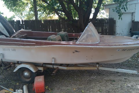

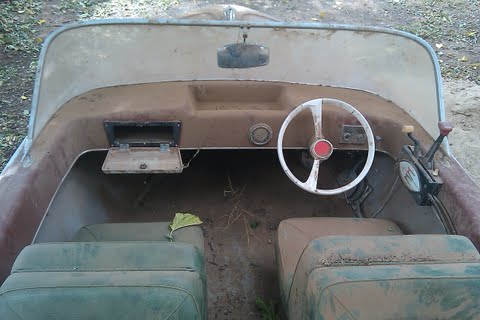

Im a young kid that has been wanting a boat for a long time. Well I found this one in a barn and I honestly dont know where to start on getting this thing ready for the water. Also I really cant find much info on the boat. The title says its a 1961 Glass Magic. Please help.

welcome young gun,i was just like you,i even tried to build a boat when i was very young,im glad you found one,do you have any pictures of it?that helps out alot.
there are alot of us here to help you go along with your new found project,john.opps sorry younggun,i didnt see the pics until now,im on dialup,thats a nice find,nice lines to it,the 1st thing you want to check is the transom(back of the boat)does it move ,if you pull up and down on the bottom of the motor,next tap it lightly with a hammer or your fist doe it sound like a thud,if it does it might be bad,or if you can see any of the wood try to push a screw driver into it,in a spot that cant be seen.
have you waked on the floor ?feel around for weak spots,hopefully with it being in a barn its all still good,good luck younggun,and most of all have fun,we are here when you need us,john

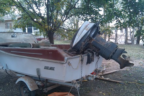

Thanks John I will defenitly try that tomorrow, and thanks Neil. Here is another pic.

Looks like a good starter boat. Give it a good cleaning, keeping eyes open for anything unusual that may need repair. Nice early 60's 40hp Evinrude Big Twin. Post the model and serial numbers on the little plate riveted to the clamp bracket and we can tell you the year. Use good quality 2 stroke oil at one quart to 6 gallons of gas (24:1 ratio). After sitting for who knows how long, definitely change the water pump impeller before you try running it. You can do this yourself, just get a shop manual and follow the instructions. Check for spark with a spark tester, plan on rebuilding the carb and fuel pump with kits (that manual helps again!) Any other issues can be solved with our help. Have fun, don't rush, you will be rewarded when that boat purrs across the water.

The cowl looks to be a 1961 Evinrude Lark but a model number would tell for sure.

Morning Chris! Great find. Your motor must be cared for. There are some basics we can all help you through. It looks like a 61 or 62. Look at the front engine hatch and see if it has a Lark IV on it, if it does it's a 62. I run a pair of them on my Power Cat.
First thing you want to do is take the cover of the motor. Back the spark plugs out. Disconnect the throttle and shift cables from the motor. By hand, put the motor in neutral and spin the prop. It should free wheel. Then put the motor in fwd, and try to spin the prop. It should lock up. Go back to neutral and then do the same in reverse and it should lock too. Next try taking the flywheel (the big round toothed piece of metal on the top of the motor) and with the motor in fwd try turning the flywheel clockwise by hand. If it does not turn at all your motor is locked up. We can help you try to unlock if it is, but that's not a good sign if it is. If it does turn you should be good. If it turns, see if the prop rotates while you do that. If things are rotating, while the plugs are out, pour a couple teaspoons of SAE30 into each plug hole and then rotate the flywheel to lubricate the pistons.
If you think you need a switch because you have no key, that is easily remedied. Look closely at the switch and you will see it is labeled "KF" and a number. Take that series to any OMC dealer and they can order a replacement key for $5. I've done it MANY times when I find these old Evinrudes.
Next thing to do, and this is critical, is a compression test on the motor. You should have 90 pounds or higher in each cylinder and both cylinders should have about the same compression. If the compression test is good, you'll have a runner. The rest is just normal servicing. If the numbers are low or mismatched it means the motor has serious problems.
