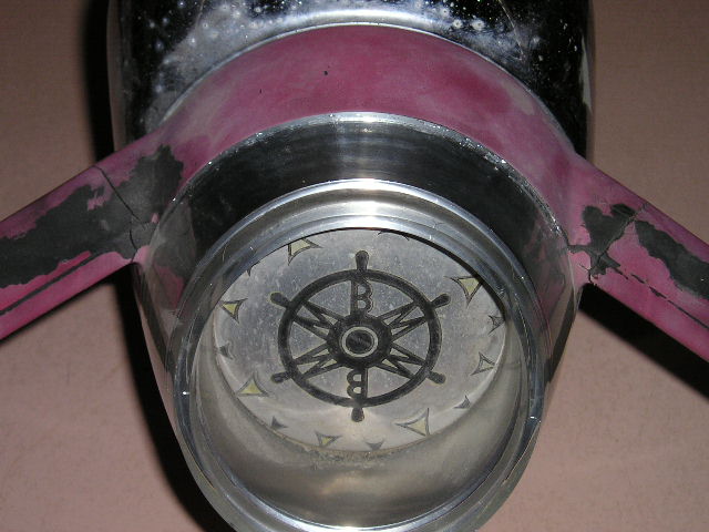

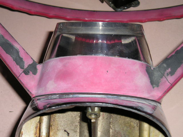

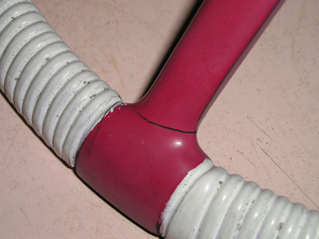

Good day
I am looking for some How Too info on restoring my steering wheel.
As you can see there are several cracks not to mention the faded color and ruff surface it has.
Any and all info/directions would be appreciated.

heck,thunder hawk thats not too bad,heres mine if i can get it off the boat im going to restore it too.

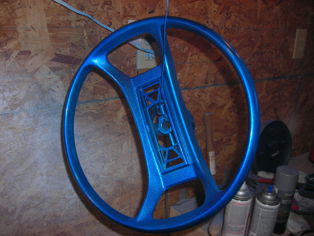

but as far as for yours ,take it apart ,all the chrome off,then lightly grind the cracks into a V or valley ,not too deep,then use high stregnth epoxy to fill that up,sand it to match the wheel,if you need more filler use resin jelly,it works just like bondo,after you get it all sanded ,if you like,before you start hit the rough spots gntly with a sand blaster to get into the cracks on the hand grips.then grind and epoxy and clean the whole wheel with a tack cloth and a light wipe with paint thinner.
then prime and paint.
or you can get duplicolor metal paint,and for primer use duplicolor adhesion promotor(clear primer),then duplicolor ground base ,it gives it a silver metalic look.
then use duplicolor top coat in these colors..

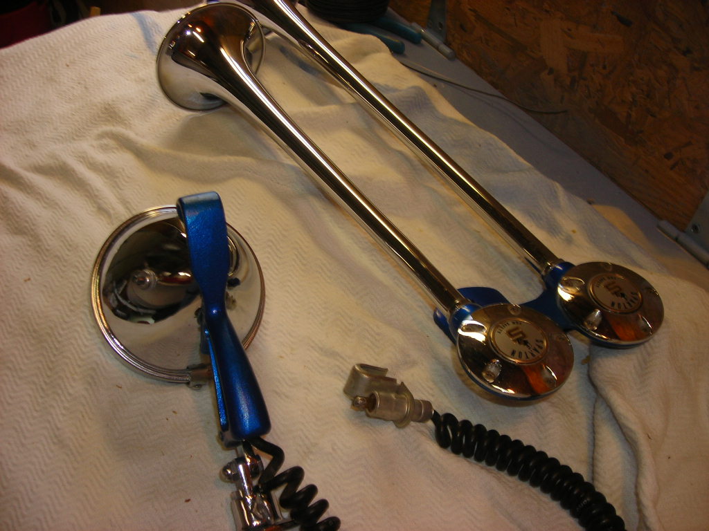

i did my spare sterring wheel and hardware ,air horns too with it in blue ,i think they look good

the cracks in my wheel were in the same place. i v-grooved them out and used jb weld to repair. they re-appeared after just 2 times out. i'll have to find a pro to do it. ron

I have used Eastwood's steering wheel repair kits in the past on many automotive wheels. They sell the 2 part epoxy for under $10.00.Very easy to do.

T Hawk - I'd strongly advise you to just live with them. That has to be one of the "better" used wheels I've yet to see. I personally wouldn't touch it. My experience in trying to repair cracks in hard rubber wheels is that it almost always fails. If you "V" out the crack and fill it with something, it may crack on both sides of the V, leaving the filler looking like a ring with cracks on either side. The filler can't adequately bond to the old rubber compound of the wheel, and heat & cold will make the rubber expand & contract at a different rate than the filler. Also, when you "torque" on the whel while boating the wheel frame flexes slightly, making the cracks re appear, or new ones forming. The only way to completely avoid steering wheel cracks is to have a Nylon wheel, or metal one. All hard rubber wheels will eventually crack, if they are in use on a boat.

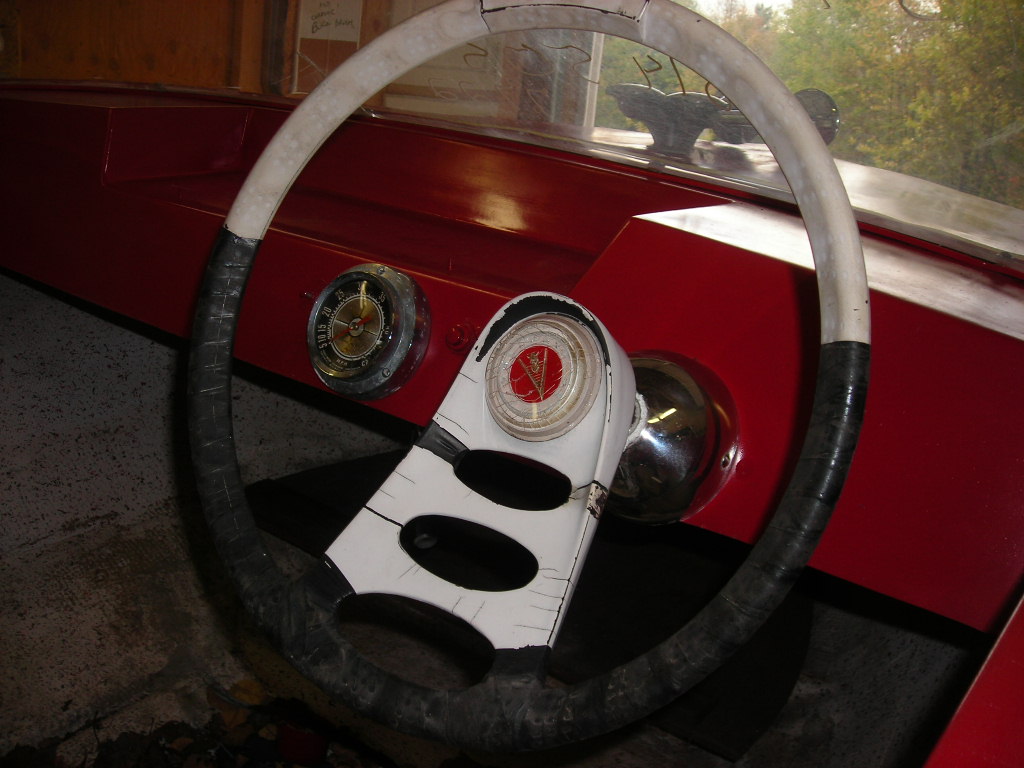

anyone know what my steering wheel is made of? 1960 customcraft.

On old cars, we always just used Bondo to fill in cracks, v the crack out a bit, fill it in, sand, prime, and paint.
I've also seen guys use windshield urethane to fill and fix cracks on some molded rubber wheels like those found on many old tractors.
Most boat wheels I've seen have been plastic over steel. As the oils leave the plastic, it shrinks and cracks.
On the car steering wheels I've done, I don't get too carried away grinding out a V in the crack, just enough to let me feather out the filler a bit. Don't make yourself more work than is needed.
When filling the crack, over fill it a bit and sand off the excess when it's dry, don't load it up all at once if you have a big gap to fill, a little at a time works best.
