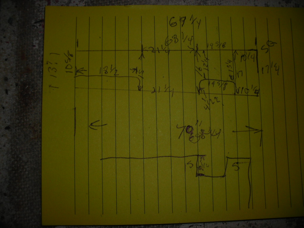

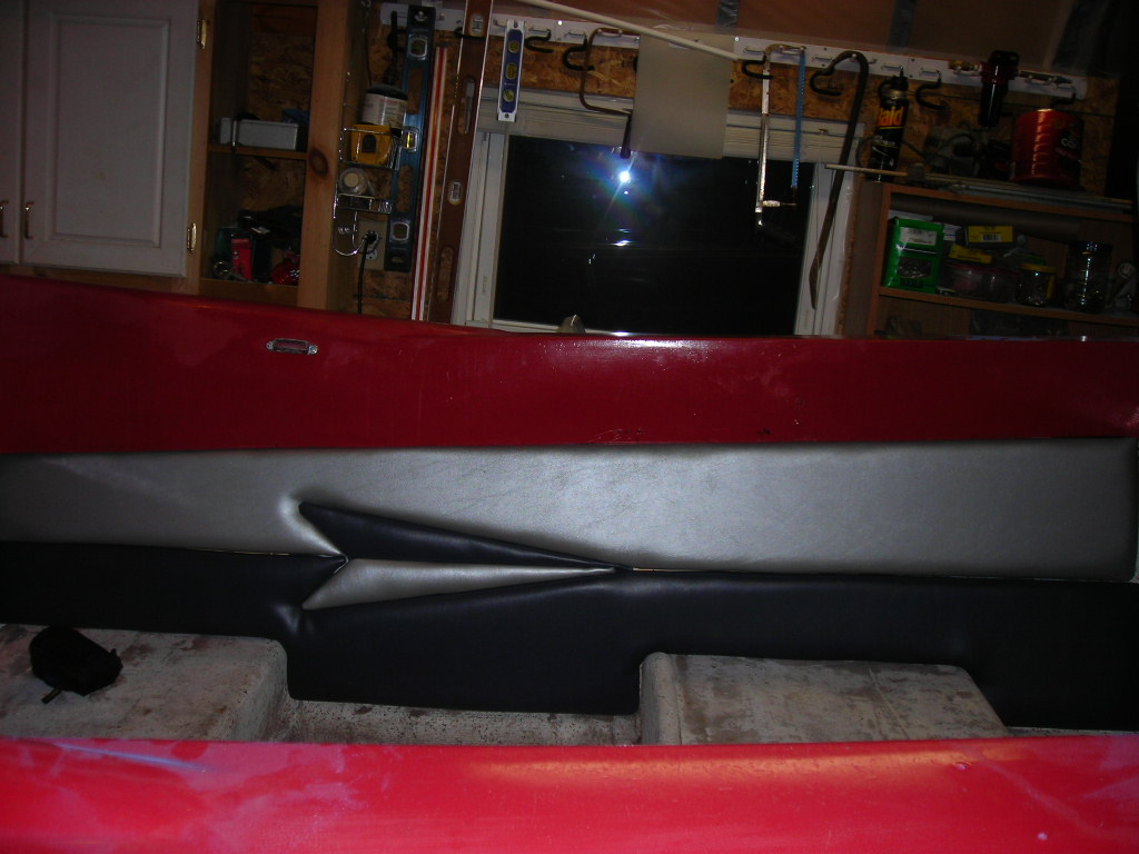

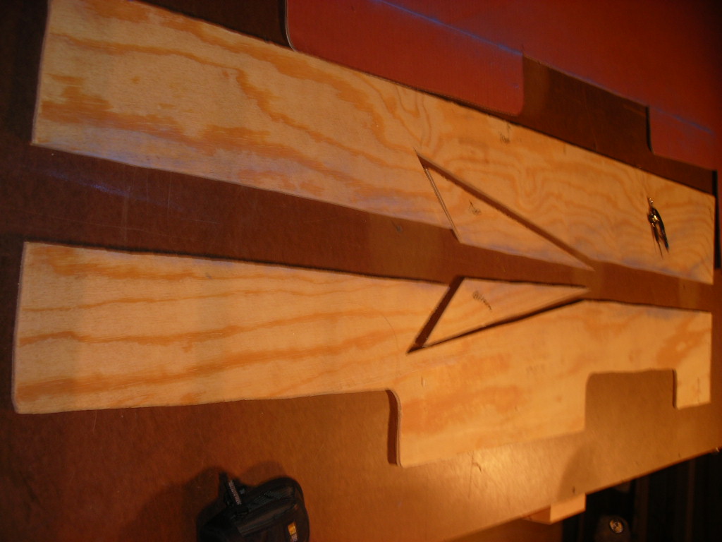

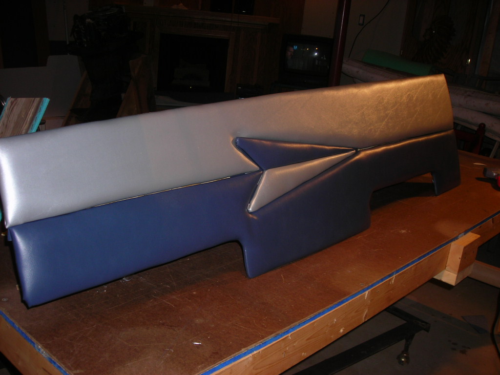

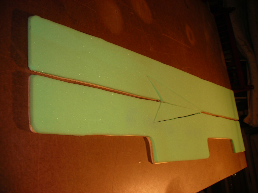

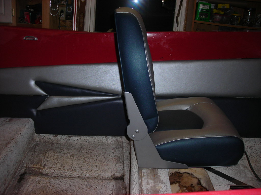

i finaly got started on the interior today,i have one side panel almost done,i tried to put the cutter emblem in it(arrow head),im doing it over the winter before i sand it down that way it doesnt get dirty,the 1st pic is it almost finished with the seat im trying to match,the rest are how i did it,1st with a cardbord templet,and a whole lot of measurements,lol.next was the plywood.
its going to take awhile to downlaod the pics,im on dial up,ill let you know when im done,john,by the way the boat is going to be painted a lighter blue metalic and silver metalic.

That arrow looks great, John!

That looks great. Its the little details that make such a big difference.

thanks jim,but dont look too close,lol.i still have some work to do on it.
i was hoping the other side would be a mirror image,but its not ,i have more figureing to do lol.

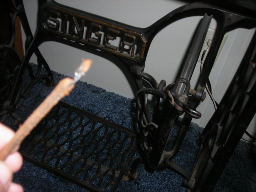

i think i may work on this old treadle sewing machine today,all it needs is a leather (round) belt,i might be able to put the broken one back together,i hope,because it would be nice to sew some of it.

John possibly a fan belt may work on that Singer

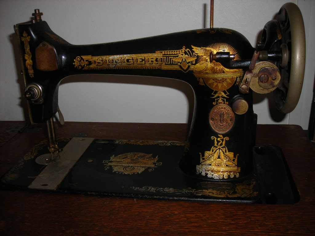

madprops,im not sure it will,but wow this is the 1st time i opened up the old machine since my grandmother died about 20 years ago,boy it is cool,it has an egyption design on it with spinxs(need spell check,lol)on it.
but i dont have a clue how to operate it,lol.ill have to look up a website for it,john

Nothing works Like a Treddle! if the belt is in good enough shape theres some good stretch in them. The Vinyl will just get cut if your stich isnt long enough, I did my Seats for my VW bus and My Wagemaker on a Treddle with Vinyl and they came out decent for an unskilled sticher... The regulat electric machine would not stich threw multiple layers.

Nice Singer! I have the same machine! without the cabinet its a cool patern mines from 1912. I would cut that belt down a little and carefully drill a hole in it to reuse the staple. then maby a dab of glue to help hold due to its age, A little Neatsfoot oil may help keep it suple... Make sure you oil that machine well and it will work great! there are oil holes across the top the cast table I think as some and under the two swinging doors, foot travel is controlled by the knob under the bobin winder. I think there are some linkages to oil under it also may be holes in the base to feed those... thats my ramble..

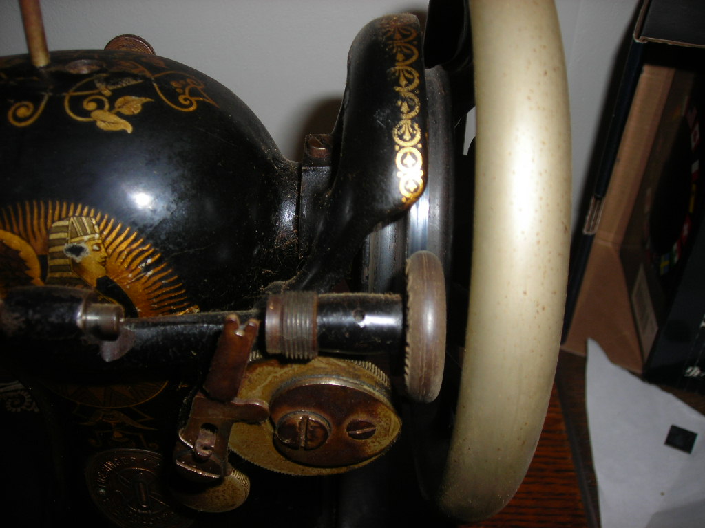

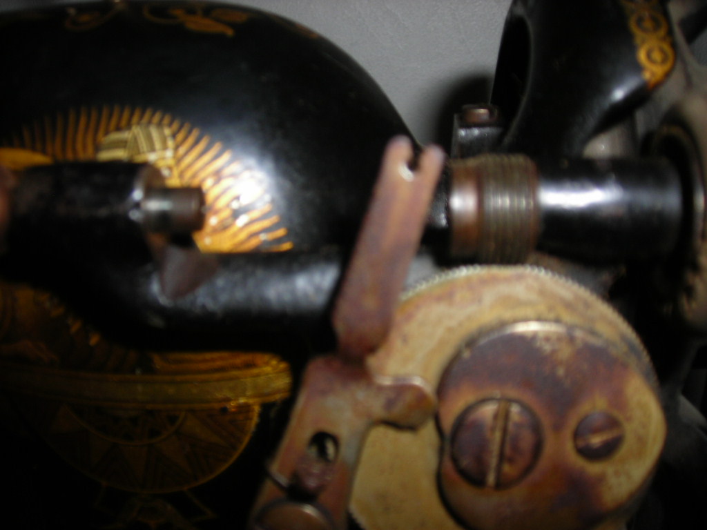

thanks stashm2,it looks like in the bottom pic that there are two places on the wheel to put the belt,im guessing that the larger one is for a longer slower stitch?

I have a Saddle machine that is a two speed like that, and yeah that will change the stich speed, I use a Cleveland for my main machine and I just pump faster lol. that knob will increase the foot travel so you dont cut the vinyl. and you may need ot turn the knob over the foot to lower the foot tension. Make sure to oil those also. Do you have all the Bobin parts?

never mind i took a closer look and the larger pully is to spin the small wheel on it,i just dont know what goes in the small wheel,lol.

The small wheel is to wind the Bobbin with thread you put the thin spindle in between the spring loaded pin and the bracket with the wheel and it goes back and forth to fill the spindle with threat dont go over the flange or it will bind in the bobbin mount... tension is importand on the bobbin winding if you have too much the arm that distributes the thread on the bobbin will be pulled away from the cam and not properly wind your bobbin... there should be diagrams on how to thread and operate that machine I have a manual for the cleveland thats almost identical to that if you need a coppy I can scan you one but am on Dialup at home also.

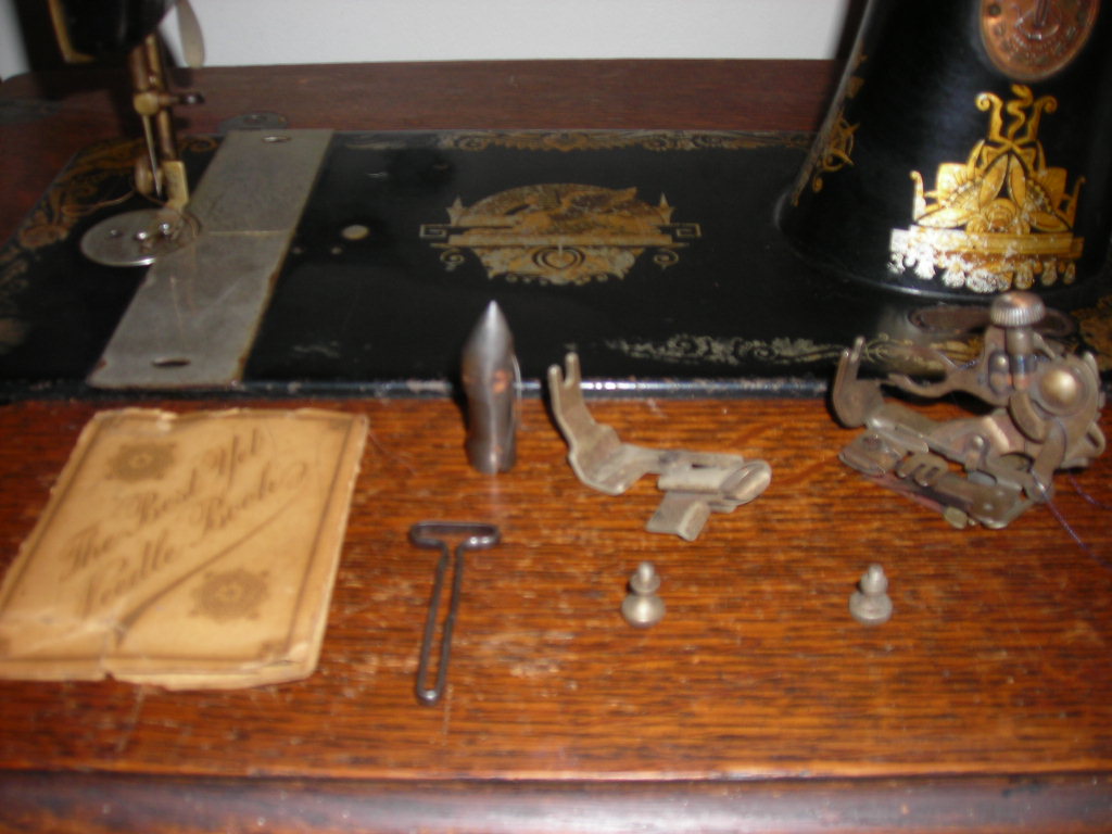

stahm2,here are all the old parts i found in the drawers,and in the 2nd pic what is missing?(where there are threads on a small shaft and a screw with the knob? boy i would really,really apreciate it if you would download instructions,john

it looks like you may be missing the bobbin... that sleek crome bullet looking thing is the bobin carrier and goes under the crome slide plate by the needle. there should be a brass thimble to go in it. I will scan it when I get home wont be till 6 PM or so Eastern the top pic is the bobin winder. the threads are what drive the cam for distributing the thread to the bobbin they are all driven off the little wheel. I will look for diagrams while I am here at work with Magical highspeed internet. Sorry to Hijack the thread. the Pannels look great also!

ok i just answered my own question,it holds the bobbin just like stashm2 said,i found the bobbin still in the macine.john

im going to figure it out yet,but i found out my leather(round)belt is rotted,i need to find another one.

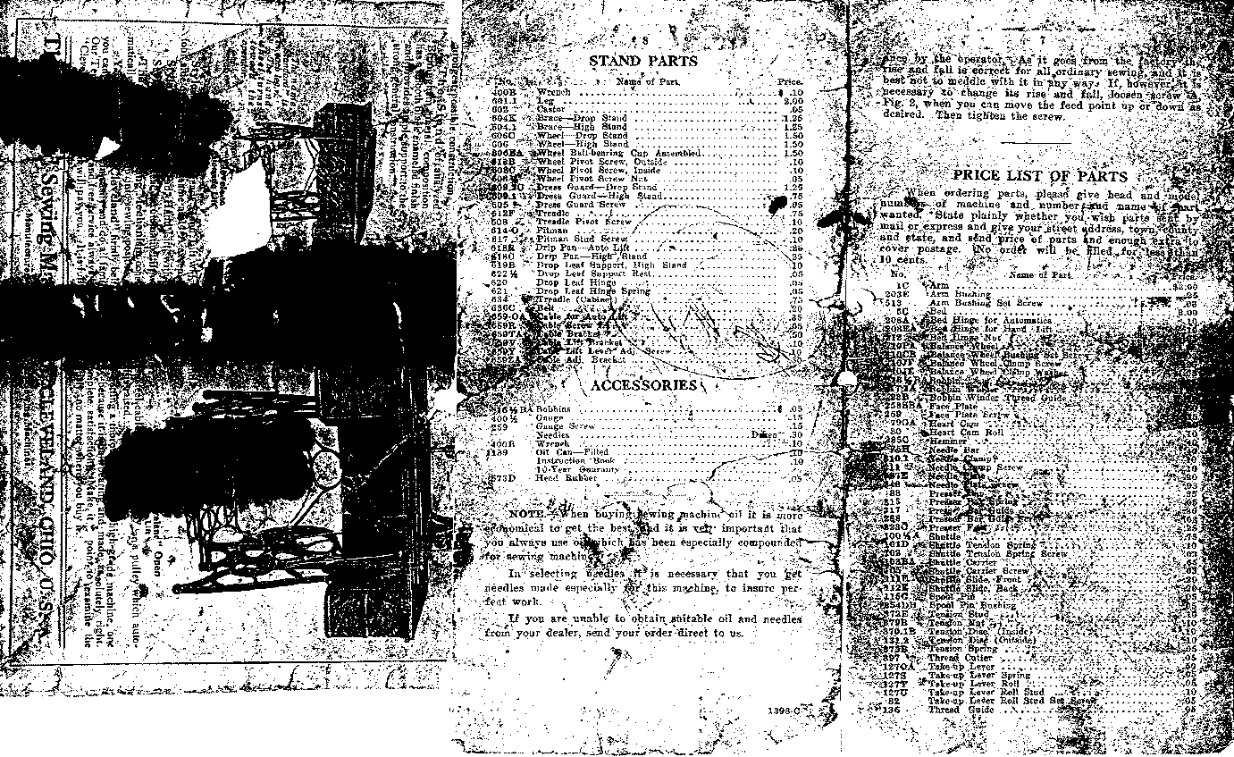

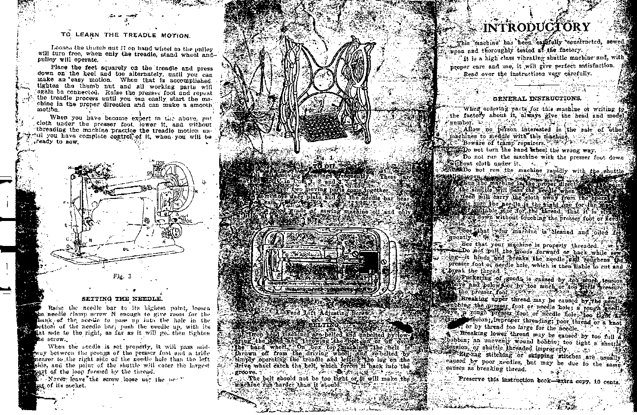

if this works this should be my Clevland manual. if not I will resize and post latter.
Ok Not great or even... Good quality but I think you can get the just of it from those scans... I was trying to keep the size down. and the original is in bad shape... Hope it helps

most sewing machine shops still sell that belt as I still have my 1911 singer here
