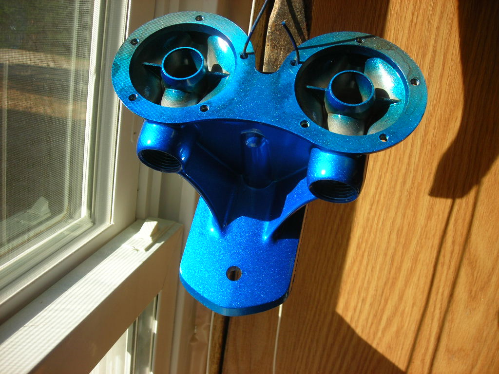

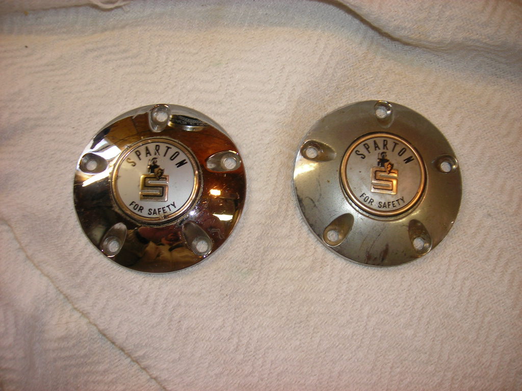

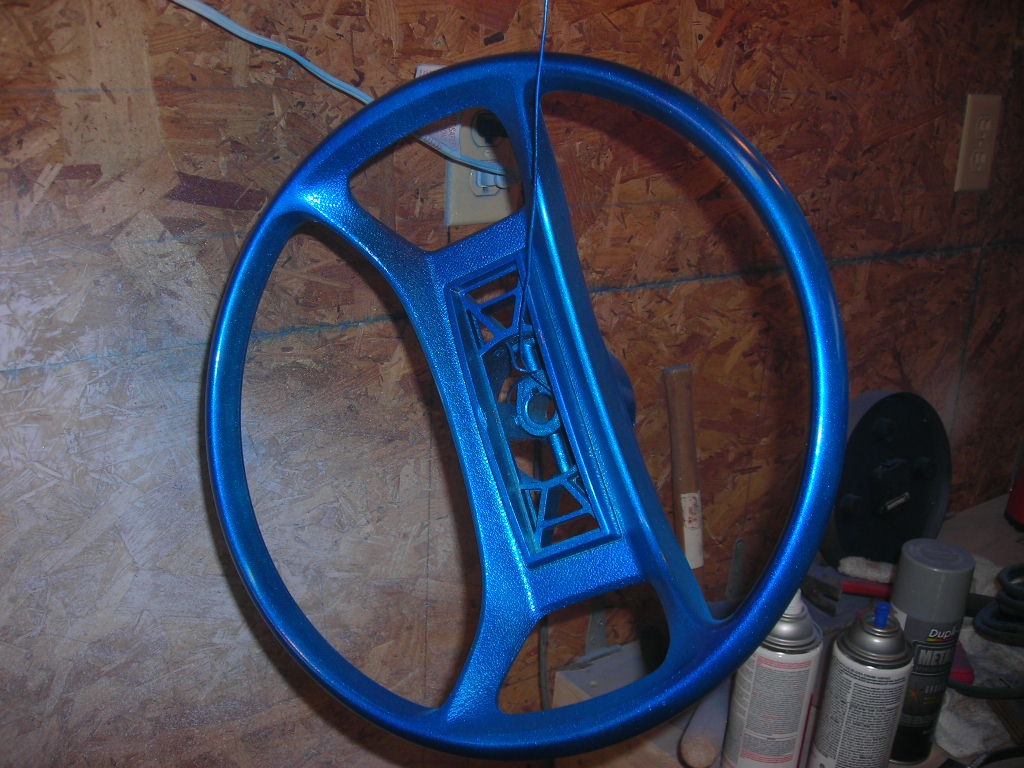

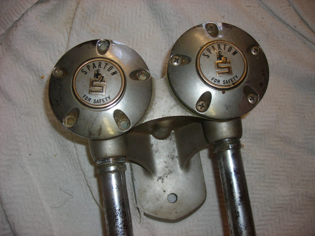

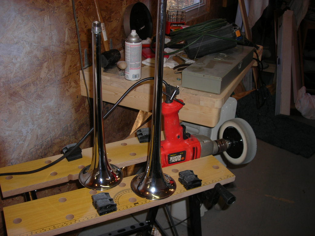

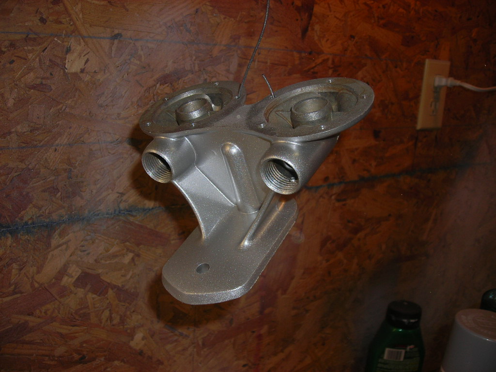

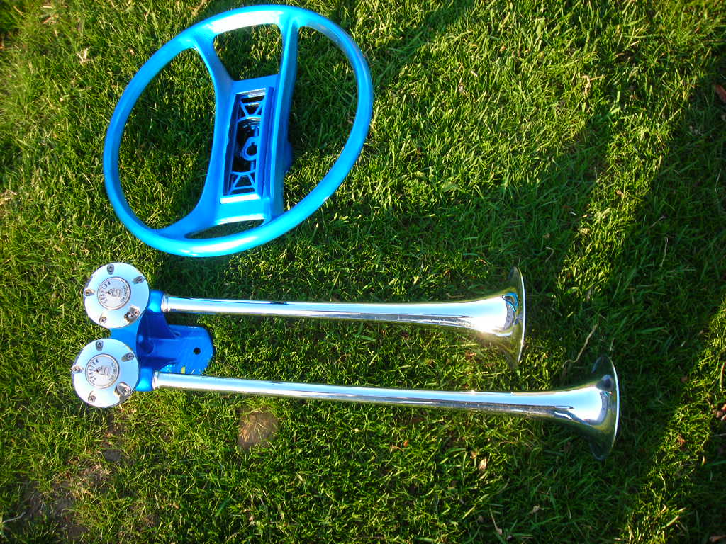

ok the pics are going to take me a long time to download,im on dial up.
i got these air horns for $10.50 and the steering wheel for 99 cents on ebay,it was black to begin with.
the air horns looked terrible when they came in today,but alot of chrome cleaner and rubbing compund,with a foam wheel on my drill,they came out ok,next i sand blasted the body of the air horns and the enitire steering wheel.

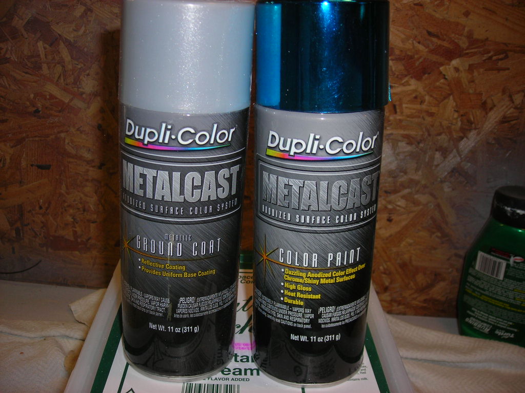

after that i used dupli-color metal ground coat,then the blue metal top coat,(close to the color im going to paint it along with silver)
i dont know how well the paint will last ,its the 1st time i have used it ,but they look good right now,lol,in about 3 hours i will put the horns back together ,and post those pics.but for now heres about ten pics ,when im done posting pics ill post it to let you know im done..john

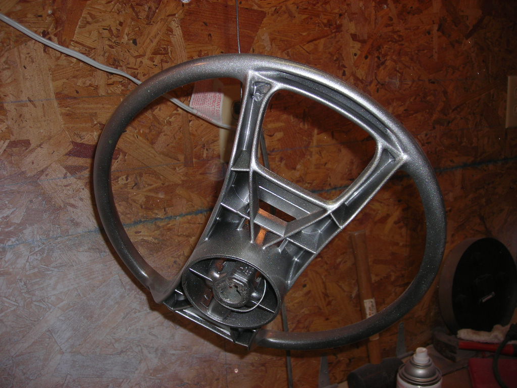

ok,thats all the pics until i post the finished horns.
im going to make the center for the steering wheel out of wood and the silver vinyl i got,i think lol.
im going to paint the 1959 cutter jet deville close to the color of these.

the chrome cleaned up very nice john. like the steering wheel color. do you know what the wheel came off of? ron

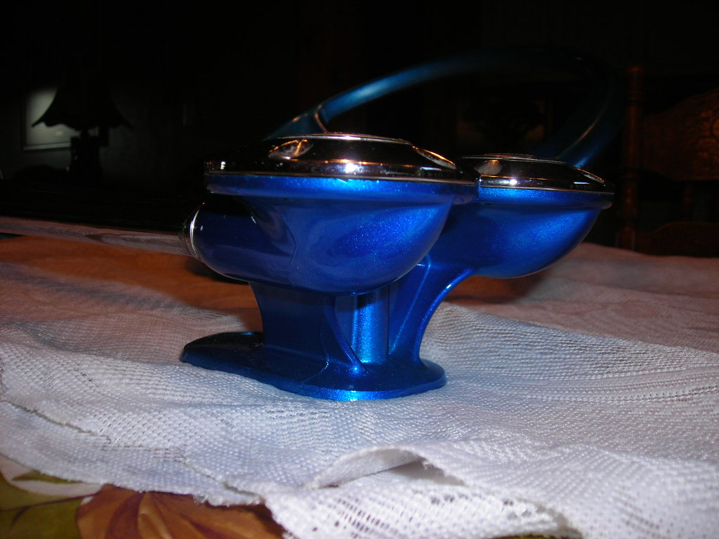

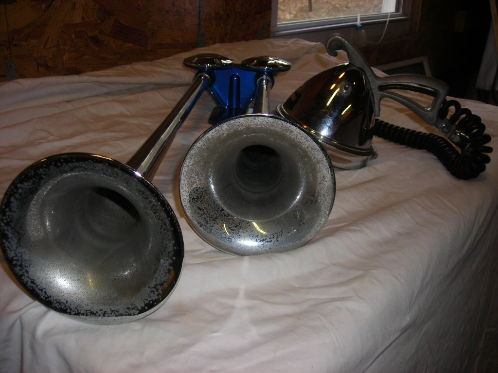

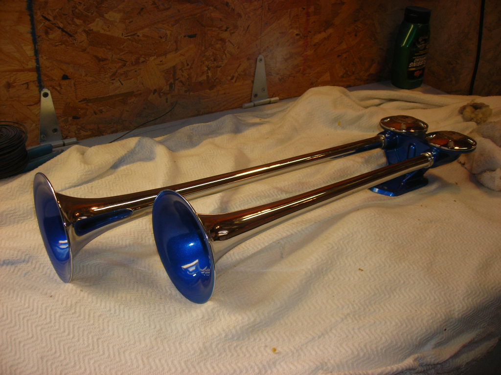

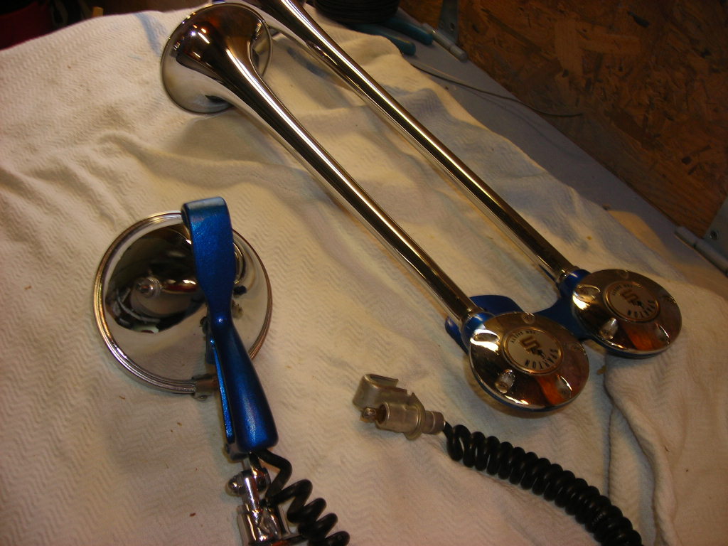

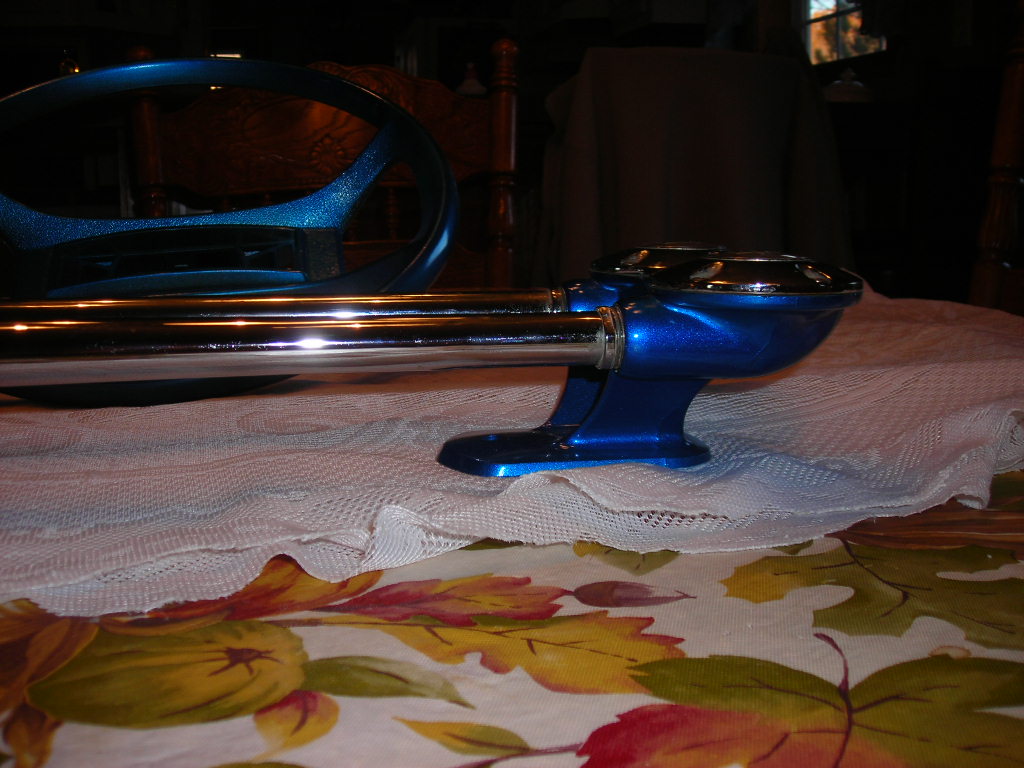

thanks ron,heres the finished pics of the horns,i have no idea what kind of boat the steering wheel came off of but it will fit my jet de ville,but this is a back up,im hoping to do the same to the vollrath wheel,its just i couldnt pass it up for 99 cents,lol.johnp.s.im going to paint the inside of the horns too,the blue looks more like metal in real life.

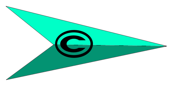

I'm thinking something like this- A quick 'sketch' I did in Photoshop... I 'borrowed' the cutter logo from the brochure.

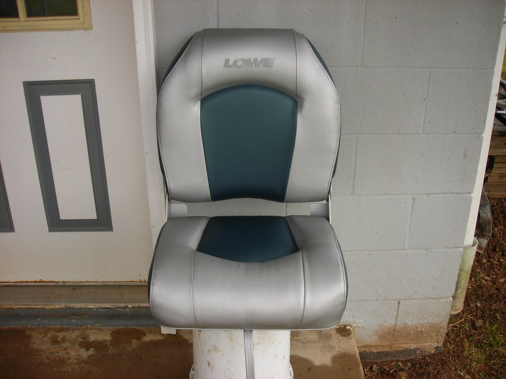

Is this the boat that has the logos on the seat that you need to cover? This might make a good cover for that, too... The wife is getting loads of practice in on the embroidery machine.

andrew yes ,thats the logo,and yes thats the boat,that would be great in silver backgraound and blue C.,when shes ready ill send the size i need to cover the old logo,ill just have to find a good glue to attach it to vinyl.john

Sounds good, John... We should be able to change the color to just about anything, once she figures the software out better. She's only had it a few days. It's fairly complex (It BETTER be- The software package was over $2k!) She's got something like 216 colors to work with.
I've got her 'testing' a Lake N Sea logo tonight.
I'll have to 'refine' that logo a bit more, As I mentioned it was a real quickie so it's a little rough. But, with some photoshop magic, We'll make it happen!

Those look awesome, great job there. I especially like the blue on the horns and the steering wheel. I think that's a great color for the boat by the way. I can't wait to see how it progresses.

andrew the logo im most concerned with is the logo on the back of the seat,its painted on and pretty big,ill get pics in the morning,the one you see in the above pic im not too worried about.

" FLEETWING" steering wheel . I have my spare in the garage. Name on the lift out center rectangle. Guess mine was from a smaller center console, aftermarket, my son got at his shop. Can let Andrew borrow to FAB inserts.? . Early remodel pic below. 16' Wide skiff.
.. Great metal polish (Cream), I got last year .Some can be expensive, but one day at thrist store lady talked me into trying quart size ,maybe $1 a bottle .A Steal "UNISOURCE" www.unisourcelink.com Norcross , Georgia , used in the Food Service industry. . Nice Horns John.

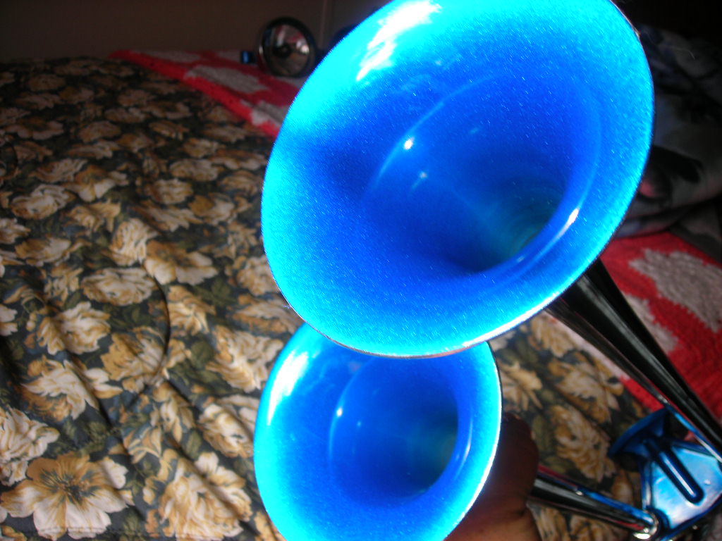

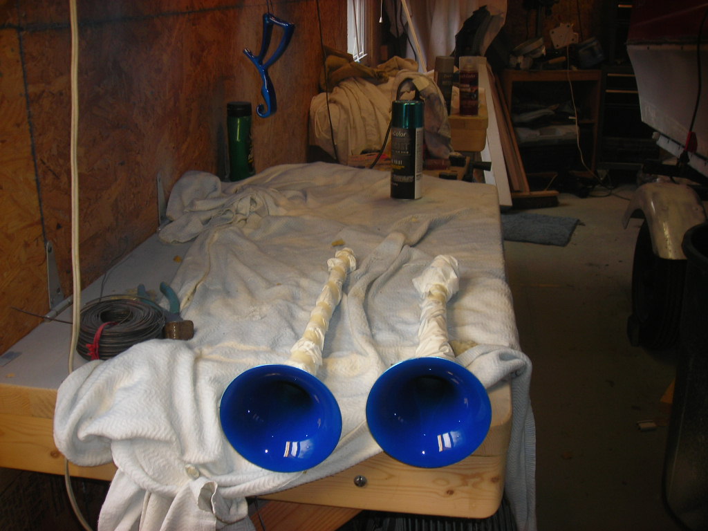

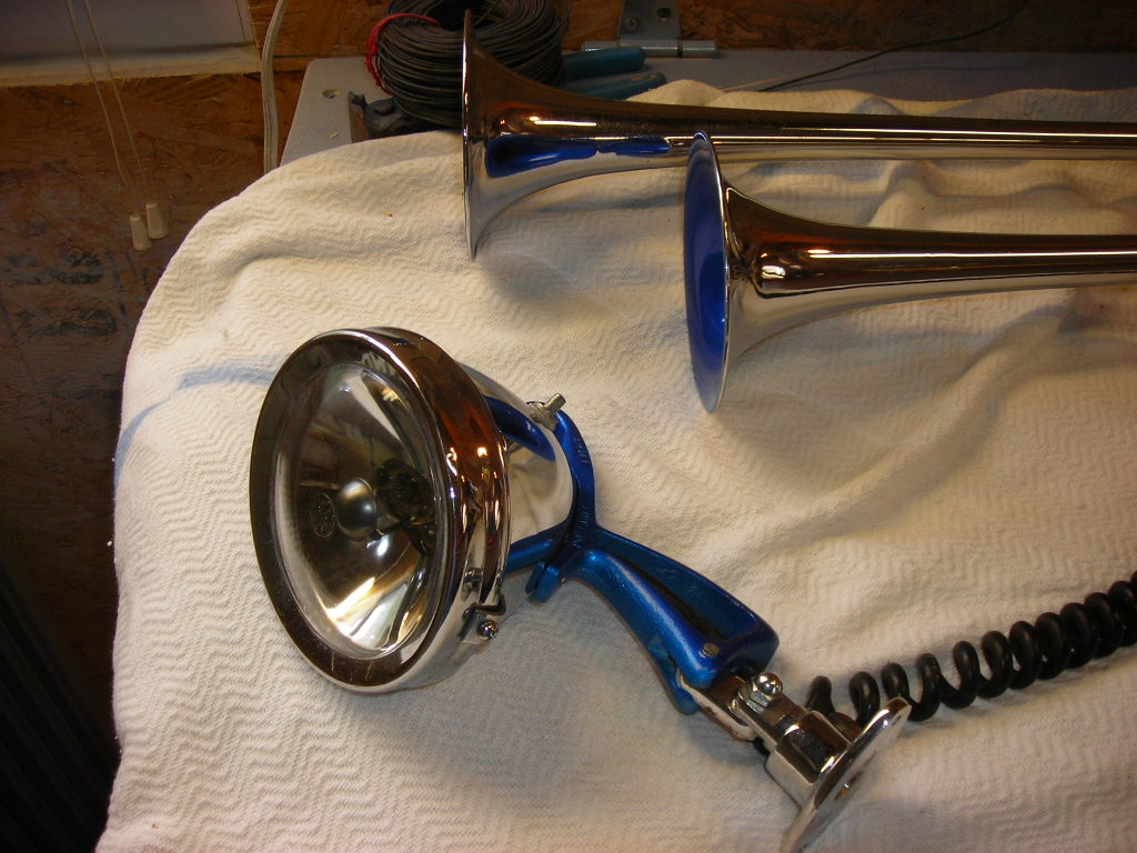

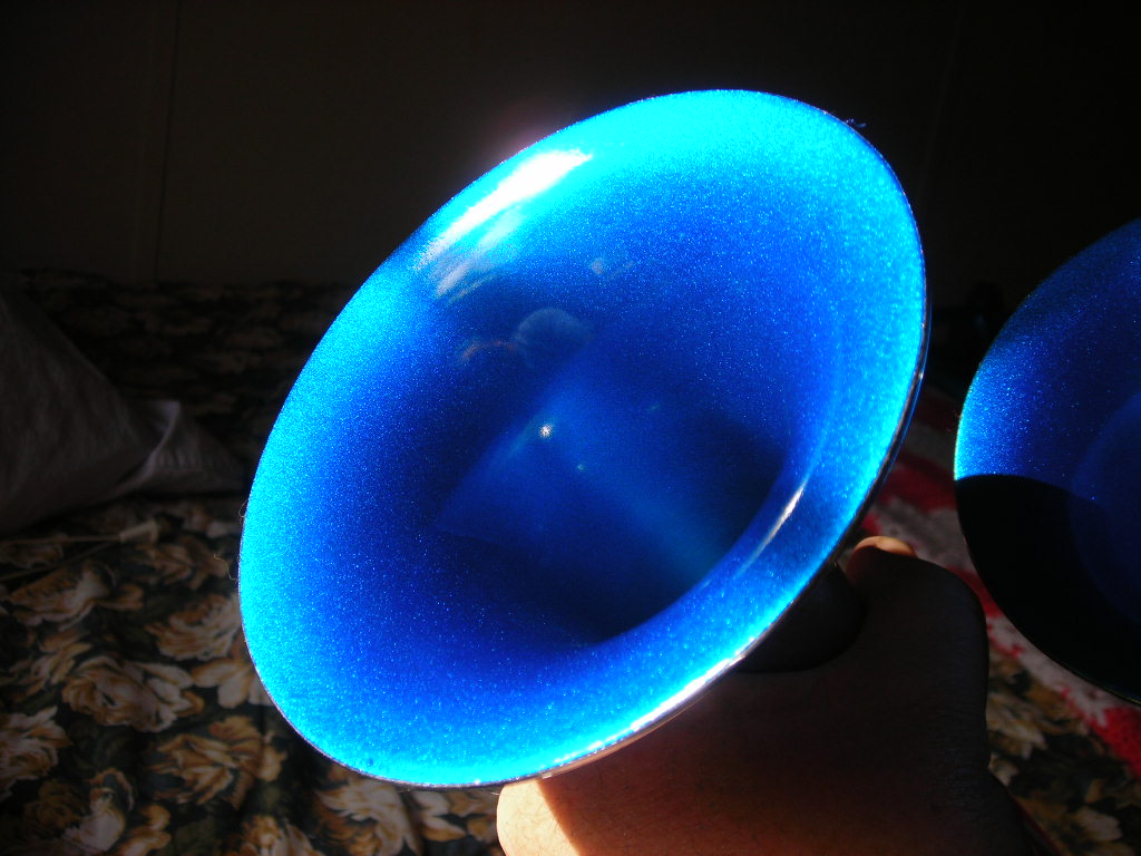

i had to paint the inside of the trumpets on the $10.50airhorns,and i also painted the new 15 dollar spotlight,i also got a cleat ,im still looking for the right bowlight,for the cutter jet de ville,with the hardware(horns spotlight etc.)i sand blasted them then used clear primer,then metal ground coat ,then metal blue topcoat,here are the before and after pics.john

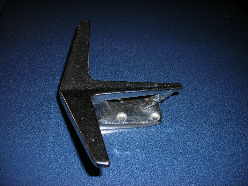

I got a bow cleat like that one. It came off an old Sea Maid runabout.

The horns came out GREAT! Good idea to paint the inside to match the back ends. Matching spotlight is awesome.

That bow cleat looks pretty close to the one on my boat.

thanks guys,yeah they work,and i have another set on the way im going to restore and then sell on ebay i need more money to put into the boat,the diaphram on these are thin copper plates.the horns on the sunray are some kind of plastic (mylar?)too.
the cleat was sent to me from matthew bennett from austraila,he wont even take the shipping money,so ill pay it forward someday,thanks matthew,i also got a stern light from ralph herda ,thats pretty close to the vollrath stuff im looking for,the cleat and stern light arent vollrath ,but they are close enough,thanks matt and ralph.
i still need 2 more cleats for the back.
its a shame but the pics of the paint dont show it good enough ,but the blue looks like blue chrome with metal flake,its really cool paint.
the spotlight also works.
oh and i didnt mention the fct that these horns are huge ,20 and 16 inch horns,lol.
the horns im getting i think i can make one complete set with the horns that ae already on the jet de ville and the ones on the way,they make this metal paint in blue,red and gold,i think ill paint the set ill sell red,john

i just id a little reasearch on this paint,it is an anodized enamel metal paint,which can handle high heat as well,here are the colors you can get..red,blue,yellow(looks like a light gold to me)green ,purple,orange and smoke,plus the primer and sometimes ground coat.

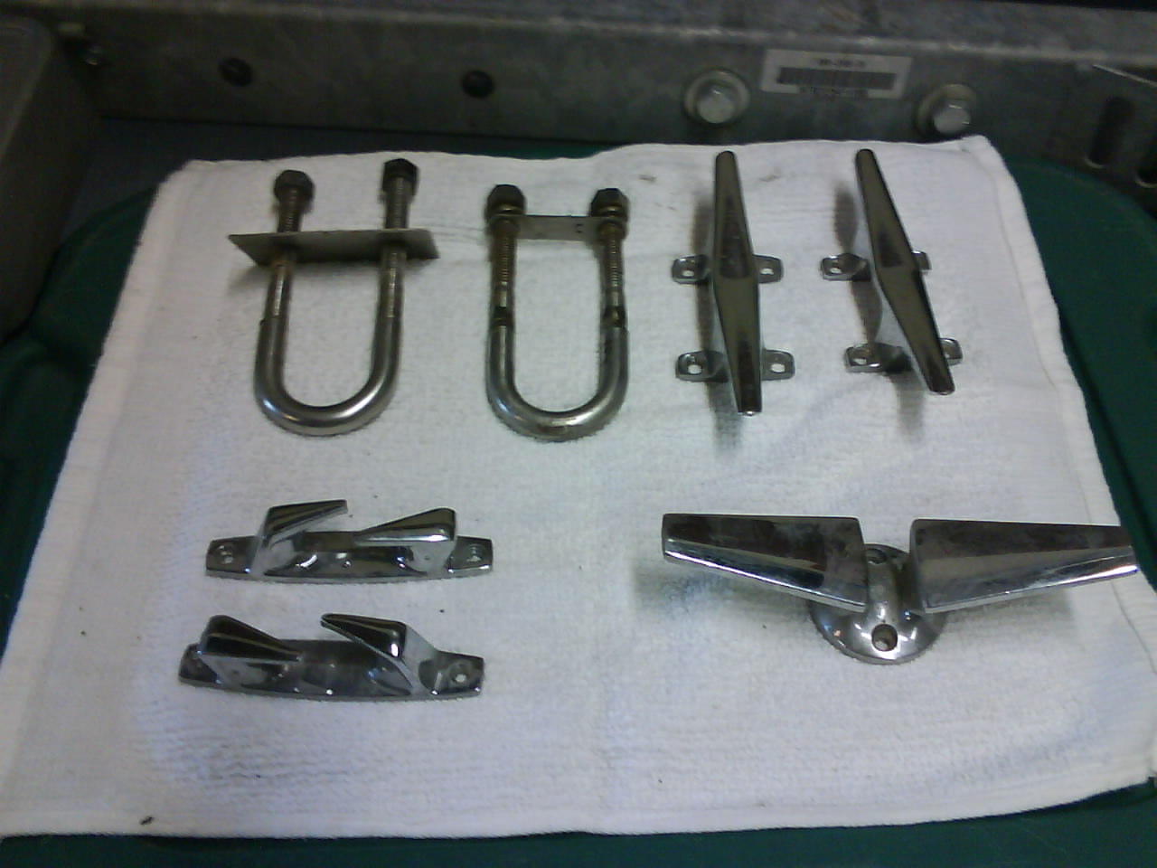

A fellow on CGOAMN has these fittings available, anything of interest to you?

yeah im interested in that big cleat on the bottom right,how much fot it mark?now that i looked them over im interested in the bunch the big cleat and chocks for my boat and the tiedowns and cleats for eds sunray,john

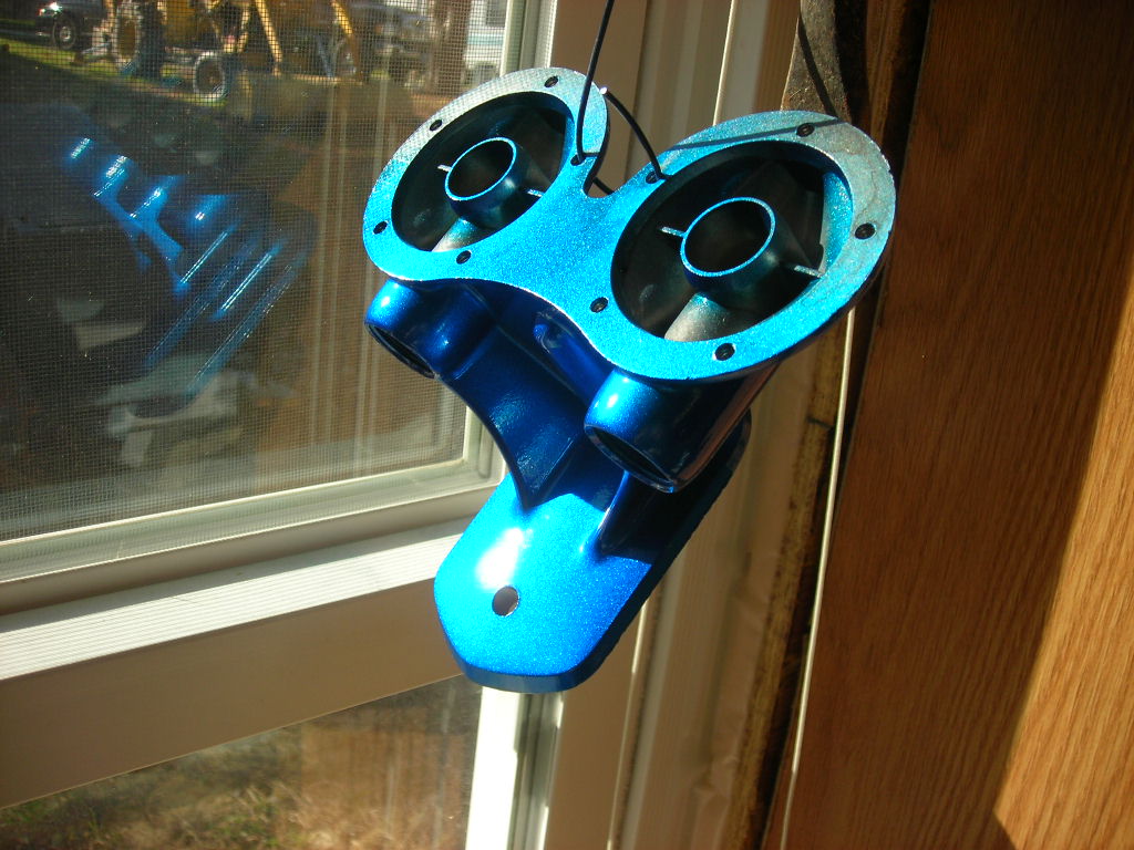

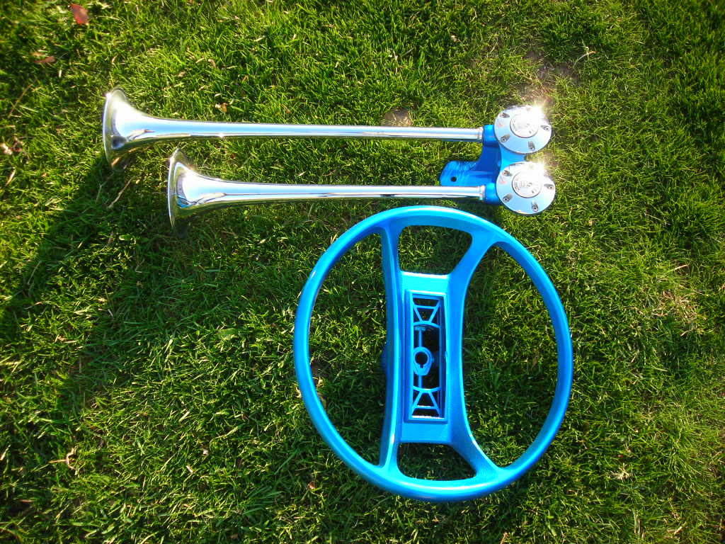

im hoping these pics show the true color and metal flake affect better,i finaly had some sunshine to put them in,john
I'll ask, they belong to one of the good folks on the Minnesota Glastron forum. Is it okay if I give him your email address?

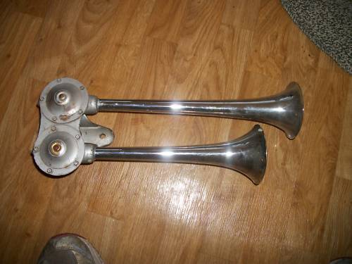

here is a pic of the set of horns i have coming,they dont have the chrome caps like mine do,and i thought i could use the ones from the jet deville but they are to far gone,so on this set the body,inside the trumpets AND the caps will have to be painted,is that ok with you,if not its ok.john p.s. if you want ill paint them when they get here and then post pics,then you can decide if you still want them.

Painted caps will be fine John, no problem with that.

Looks like the cleat (and anything else you need in the picture) is yours John! I'll ask him to shoot you an email so you two can work out the details on shipping, etc..
