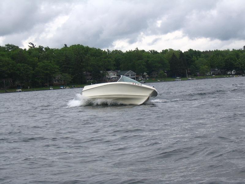

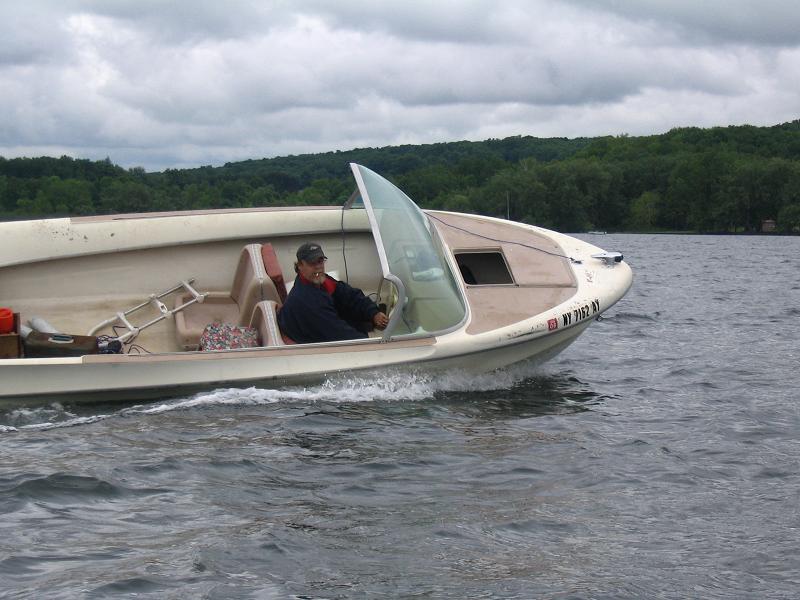

Boy Houston you know your Aristocraft ...L.O.L... Nice boat you had there by the way ..How many were Built ?? Sounds like tons ..I had mine given to me without a trailer . I pulled the Old V4 and put a 80HP Merc on her . With a 19 pitch she will run close to 40 .. Think a 17P might do better on her ..I like driving that boat ..It rides nice and does have bunchs of room in her ..Its great for teaching new drivers to . Very forgiving ..Thanks for the Info ..
Re:Why use wood at all? 15 years 8 months ago #19000
houston's funliner...and it could turn on a dime.
