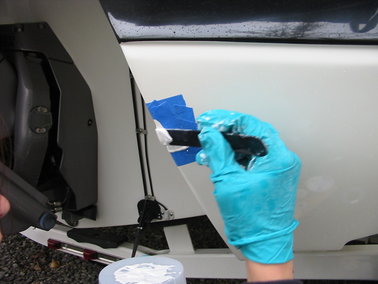

The following is a photo tutorial on gelcoat repair. All boats have nicks, dings, gouges, and other flaws in the surface. This procedure is the same for small repairs and large repairs. For more in depth information, you can check out the research/restoration tab in the top right corner of this screen.

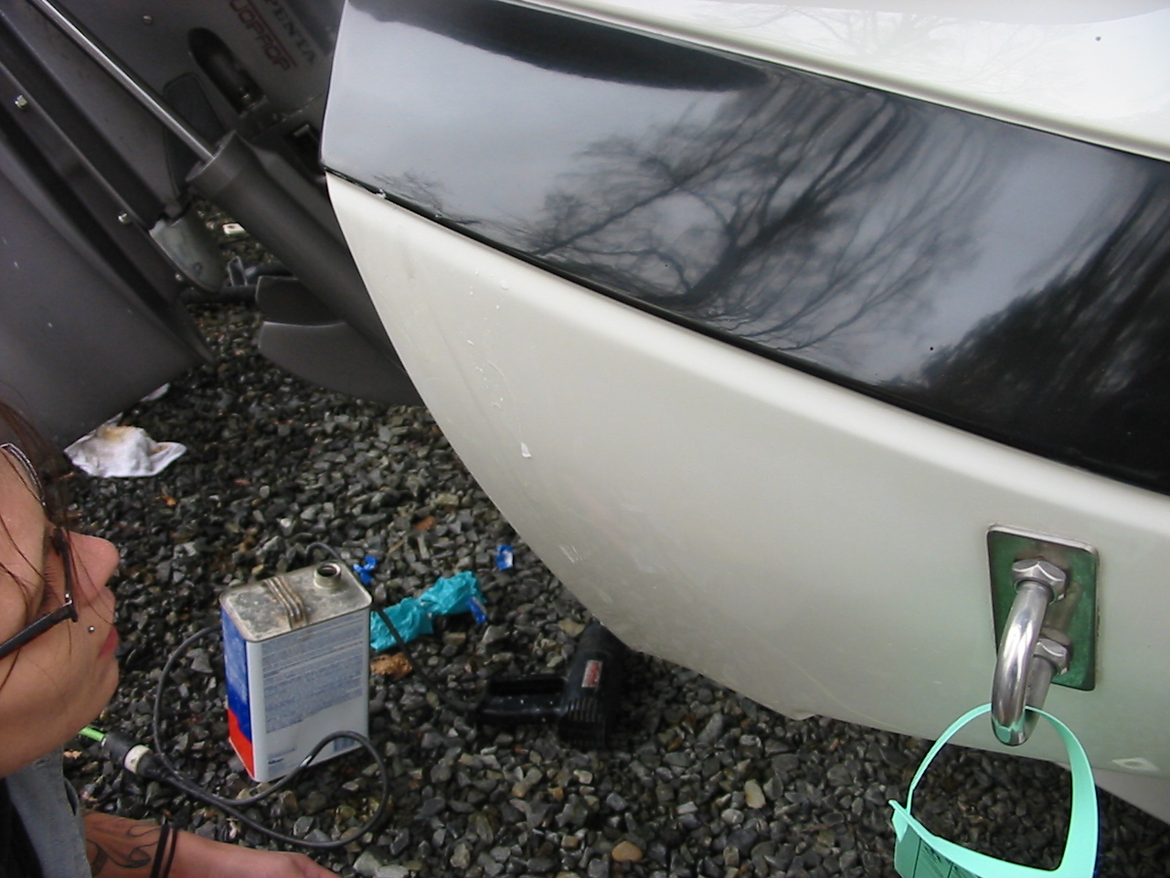

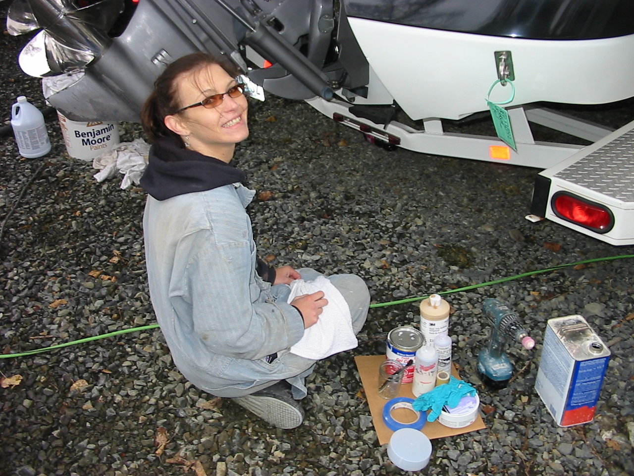

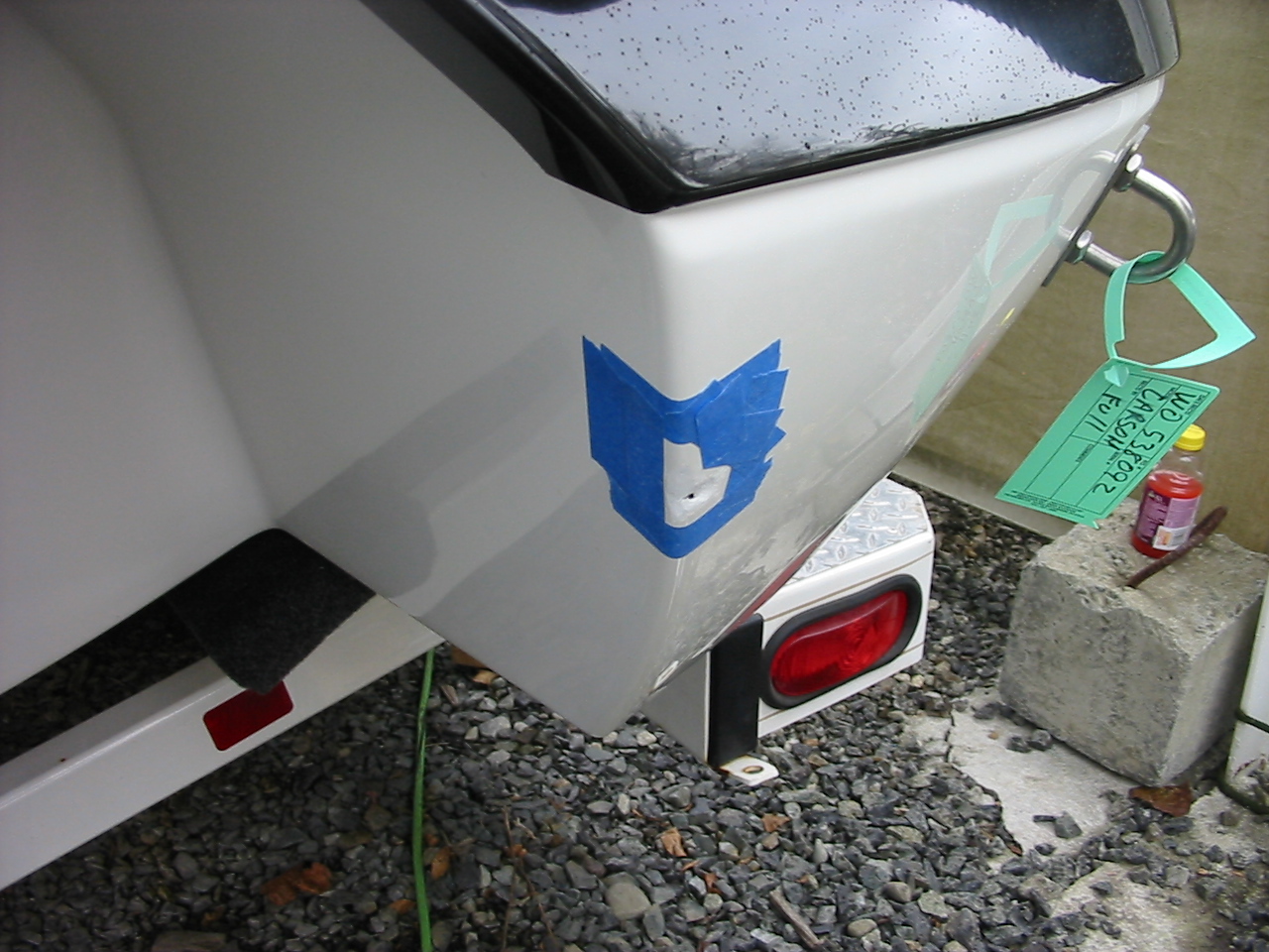

1. Courtney and the materials she'll be using.

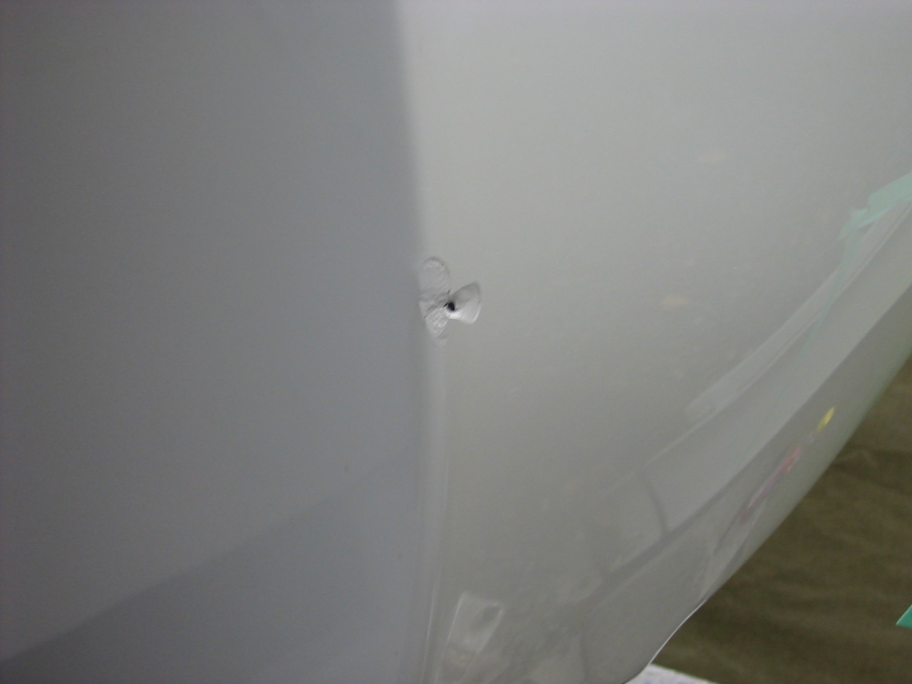

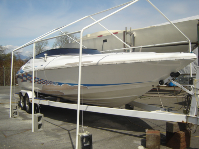

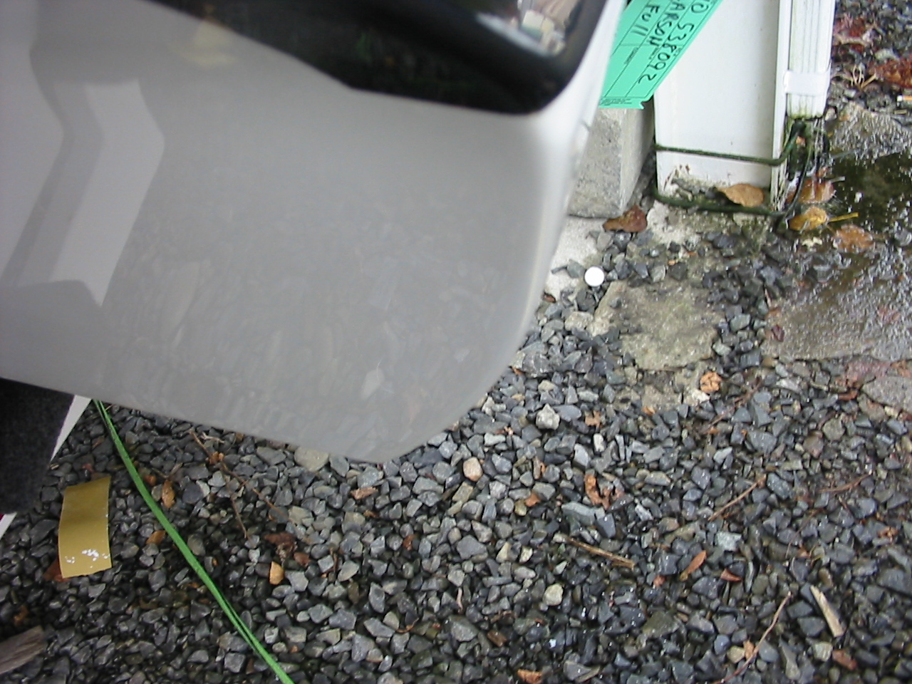

2. The damaged gelcoat.

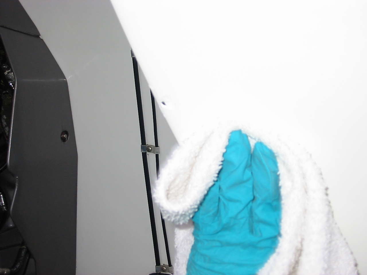

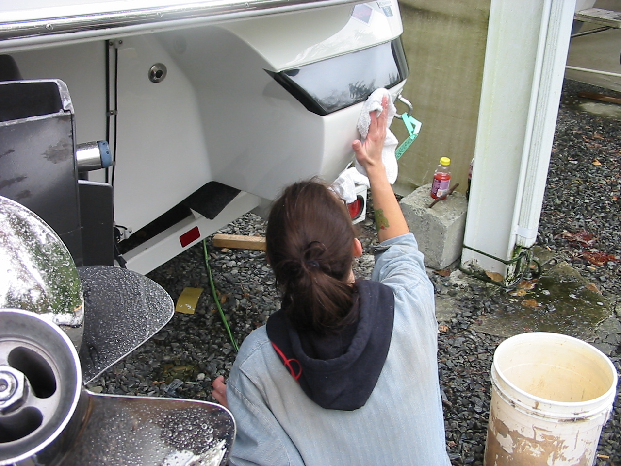

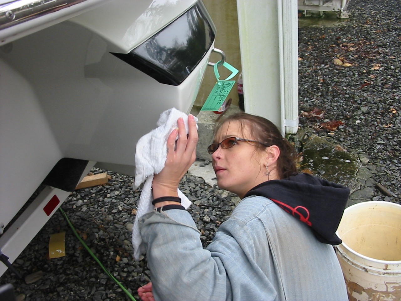

3. The first step is to clean the surface area with denatured alcohol.

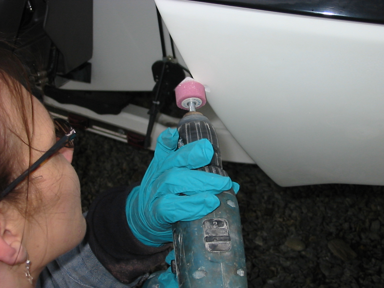

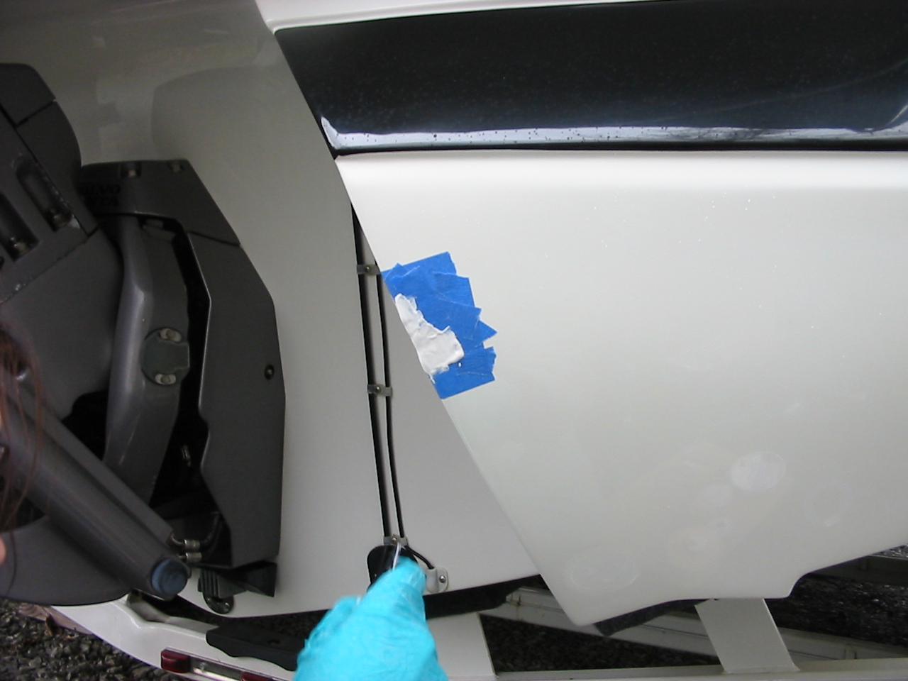

4. Using a grinding bit to smooth out the rough edges of the damaged area.

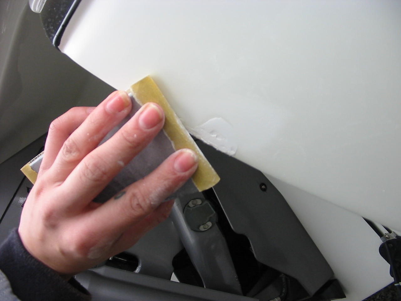

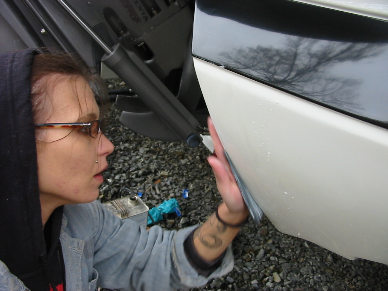

5. Inspecting the area to make sure the surface is good and smooth.
6. Tape protects the surrounding area.

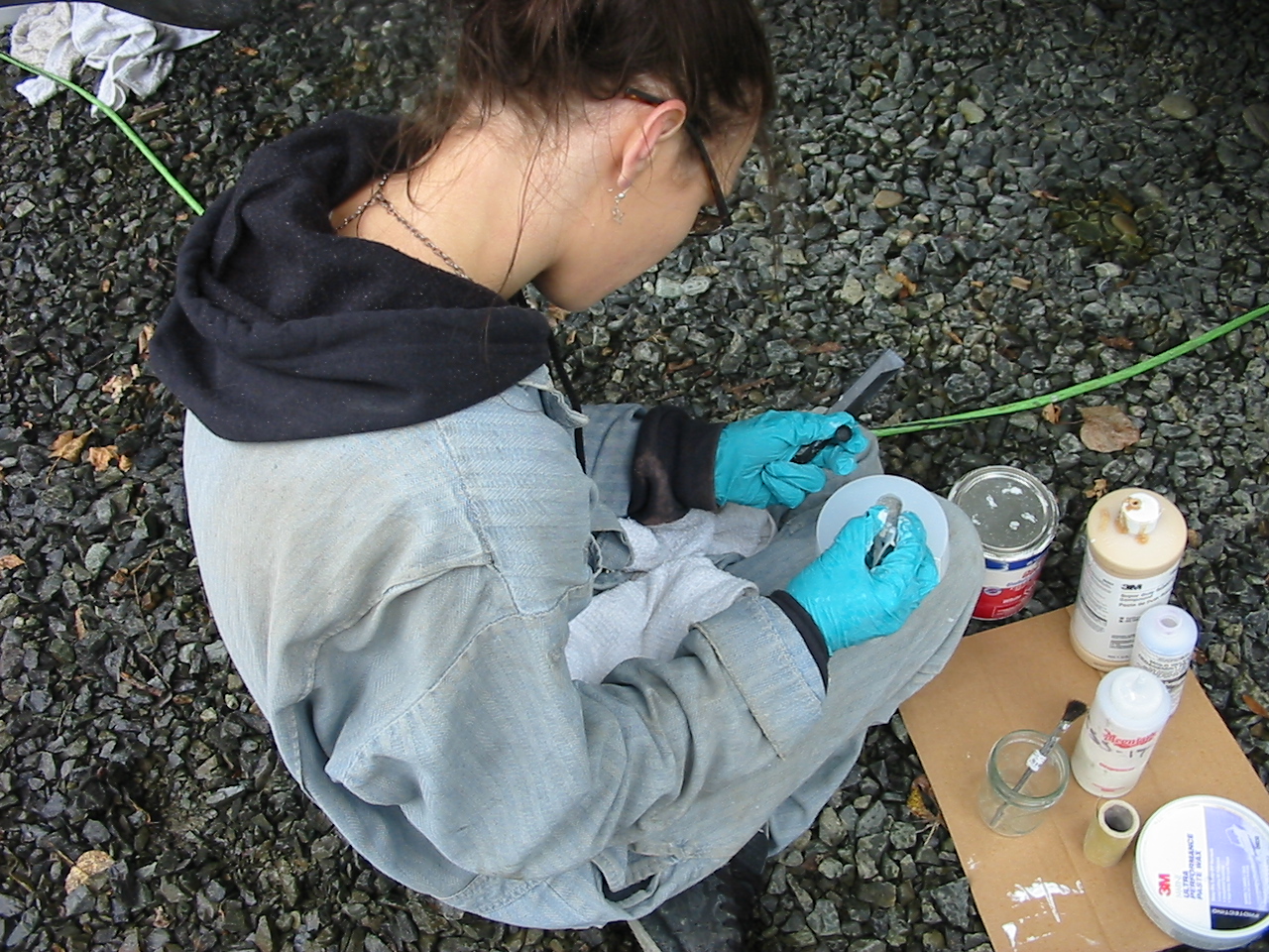

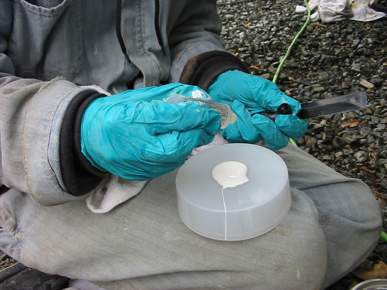

7. Mixing the gelcoat.
8. Catalyzing the gelcoat. In this case, because it was cold, she added three drops rather than two. This makes the gelcoat kick quicker.

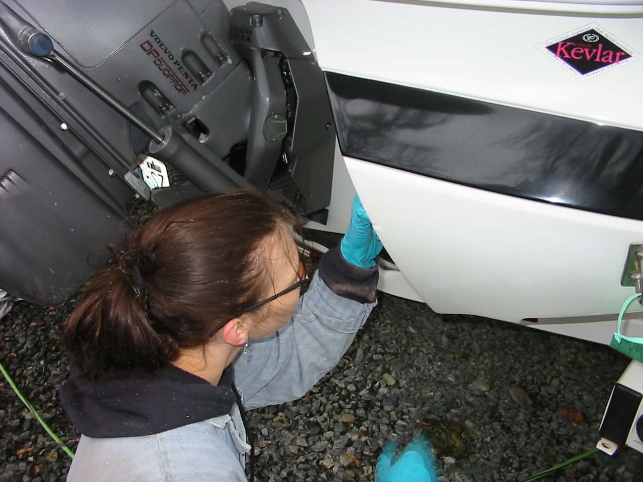

9. Applying the gelcoat to the repair.
10. Gelcoat

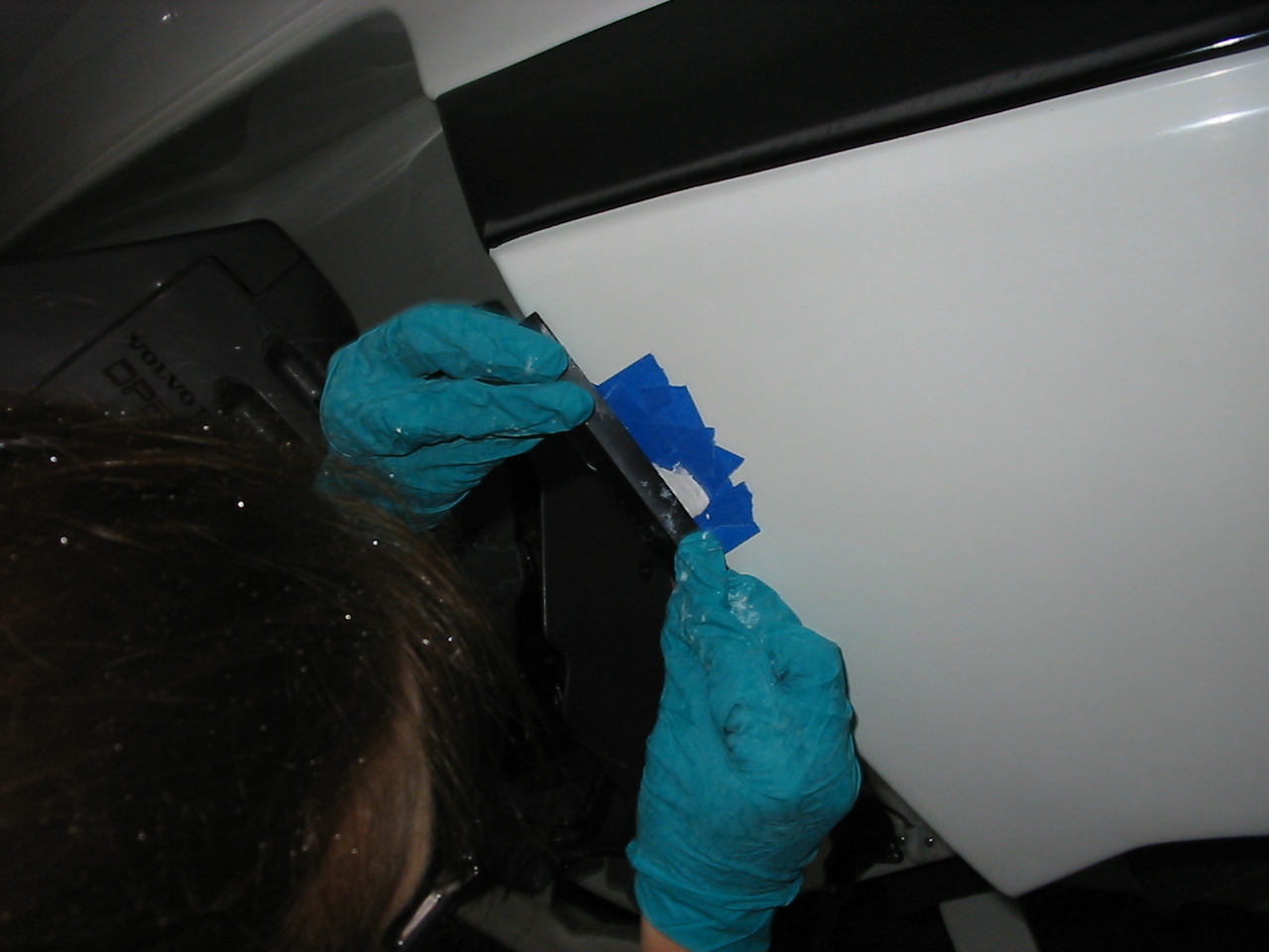

11. Using a non-porous spreader, Courtney ensures the repair is completely filled.

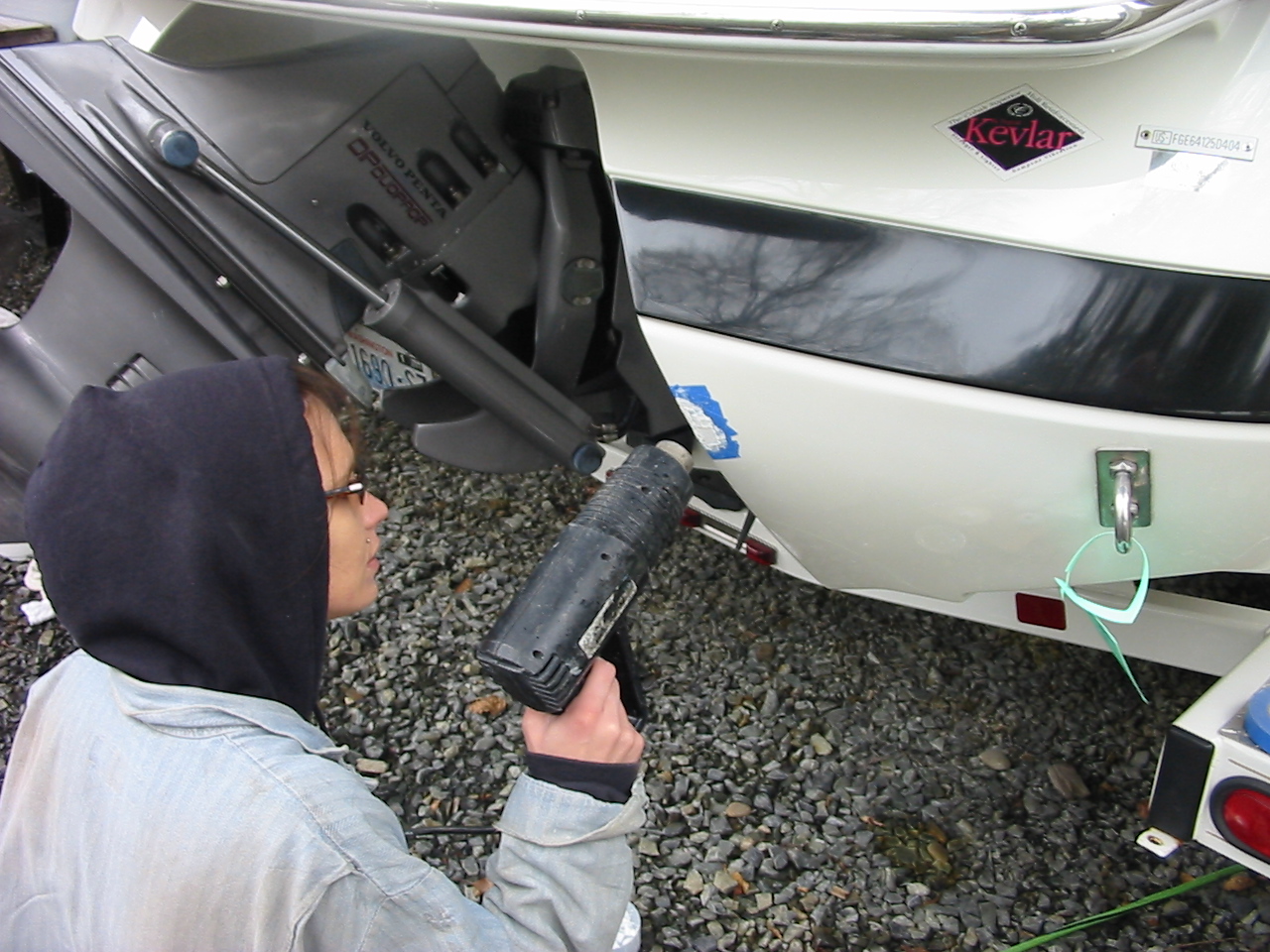

12. She uses a heat gun on the lowest setting to help get the gelcoat to kick.
13. Once the gelcoat has kicked (cured), she sands the area smooth with 220 grit sand paper and a firm sanding pad.

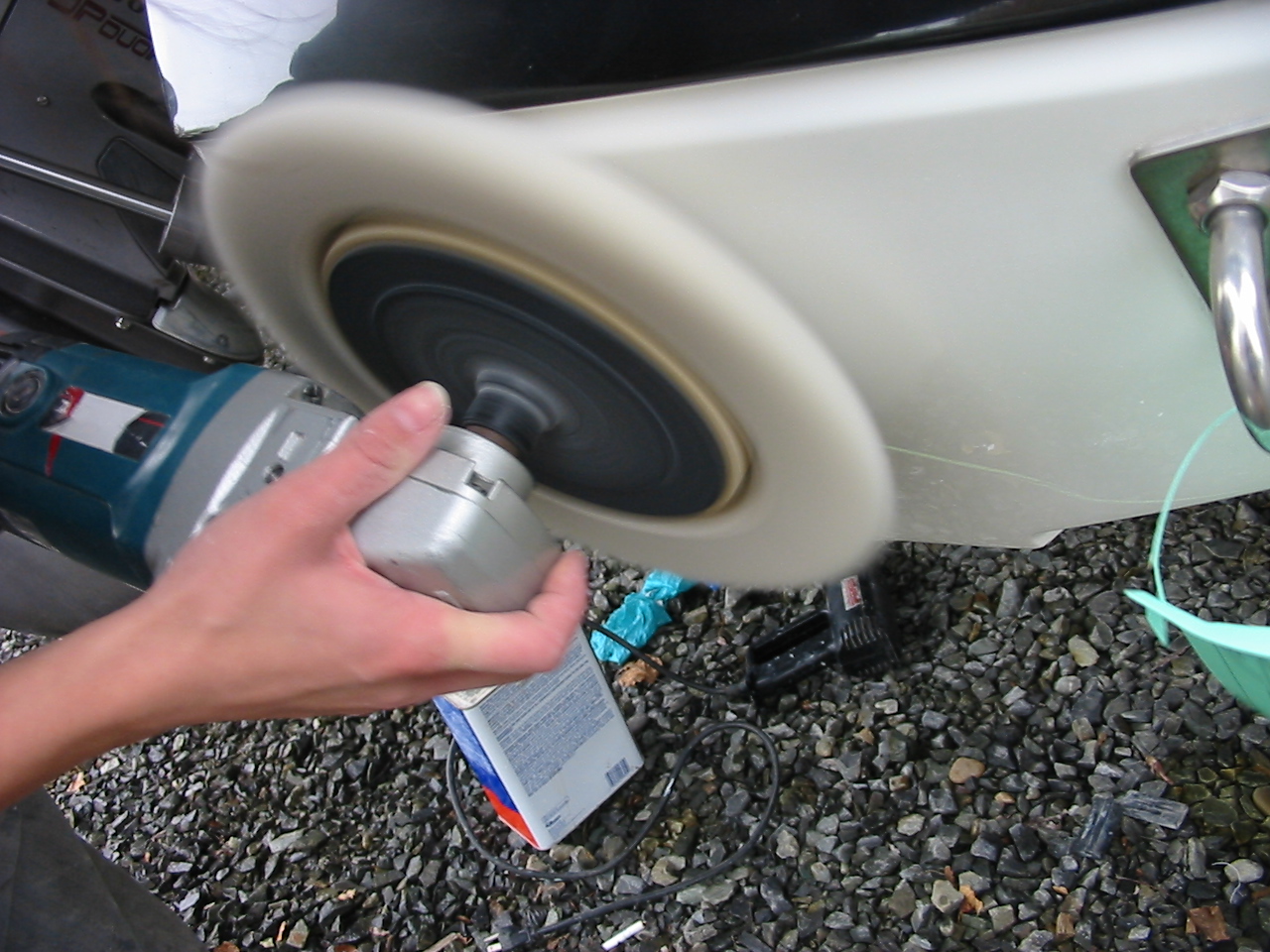

19. Buffing out the repair with rubbing compound.
20. The finished repair, polished and waxed, is now invisible.
