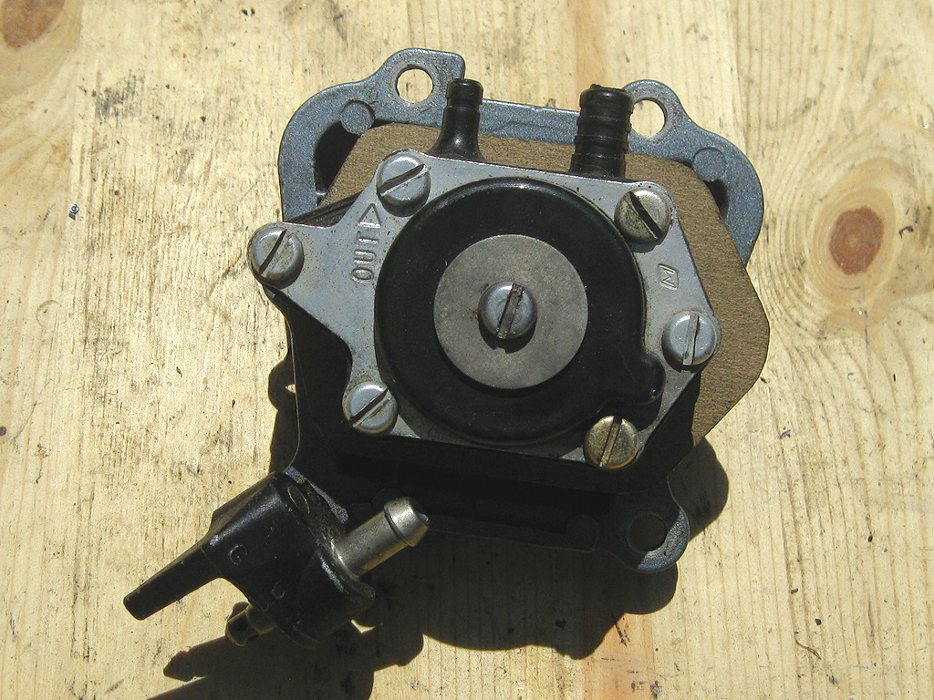

We have a 1957 Evinrude motor that was designed with a pressurized fuel system, which did not require a fuel pump. Is there a way to convert this engine to use a fuel pump?
Re:fuel pump info. 15 years 9 months ago #18329
Yep, you can add a later style fuel pump to the intake port cover. Also, you'd need to plug off the air line from the pressure system. I have a conversion kit available - let me know if interested...
