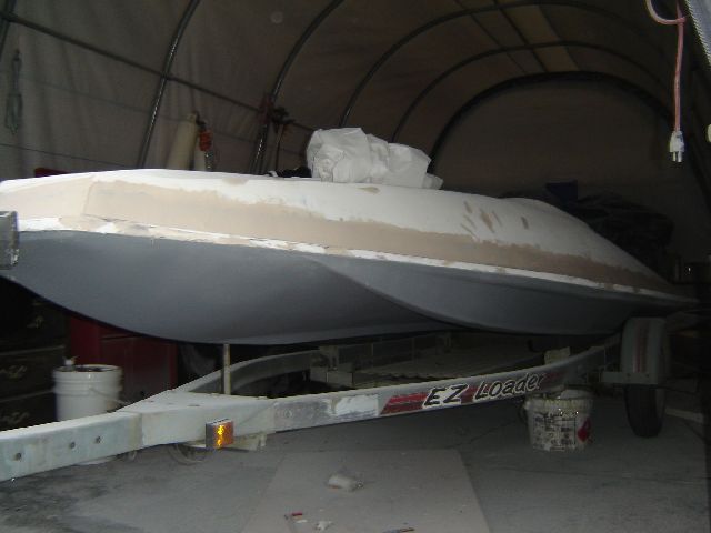

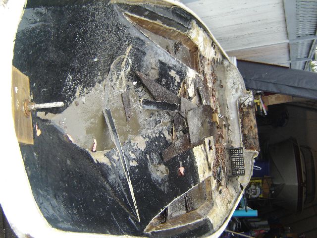

so far i get this much done on her this weekend,

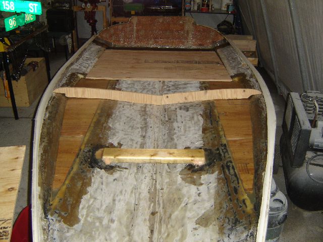

ya,just had to cut the deck out to get to the rotted wood not it is all remove and replace with new wood.

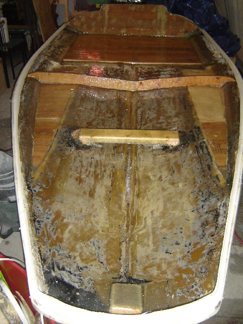

got all of the glass work done on the inside of the hull.i also flip her over to do the work on the underside.

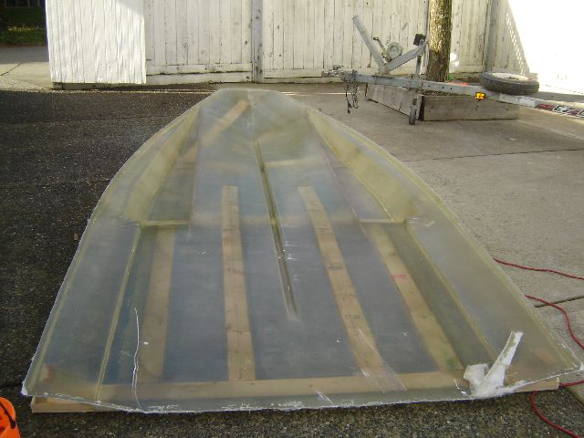

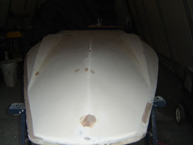

Got the temporary hull mold done,good enough to make a brand new 50th anniversary edition U-2 from then i will cut it up after that.The mold is just made from 3layer of 1/12 oz mat with no tooling gel.

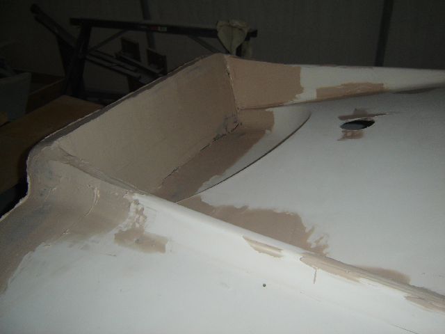

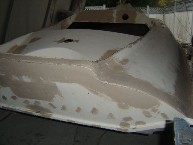

got the hull prime ,deck back on her,and throw some putty on to fair her out.should be all sand tomorrow so i can work on the mold of the deck.

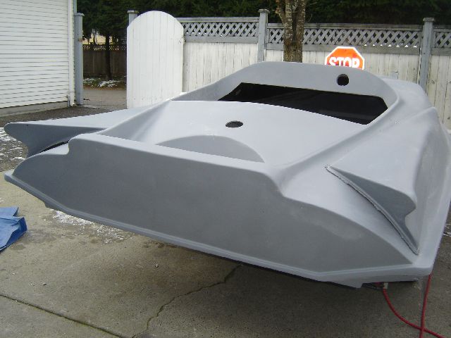

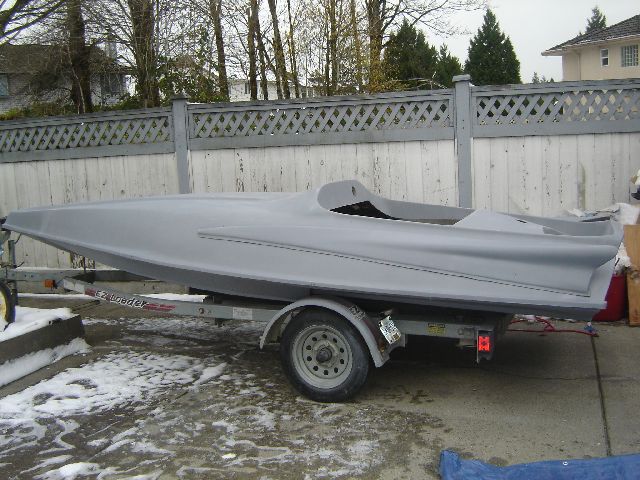

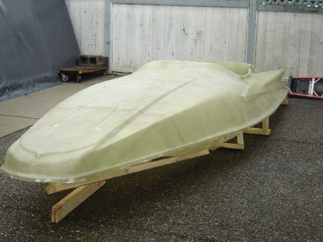

now the u-2 is all glass up,fair,and prime she is ready to store away for a long time as i have to find a nice shop to built a new u-2 for next year.
