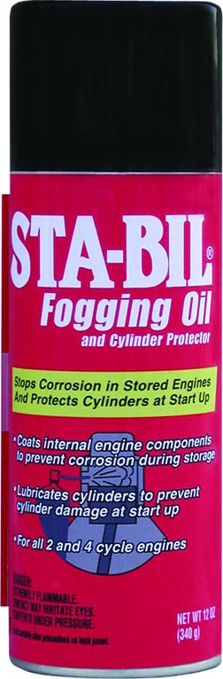

This may sound like a crazy question to you guys but for us new to boating ....... what is fogging oil?
Re:Proper Winterization - Outboard Motors 15 years 3 weeks ago #44844
It is available from any number of places. NAPA sells their own brand, but so does Sta-bil and many others. Just follow the directions on the can.
Frank
Re:Proper Winterization - Outboard Motors 15 years 3 weeks ago #44845
  • MarkS's Avatar Topic Author
Not crazy, it's an aerosol oil used to spray into carb throats and spark plug holes to protect the bare metal surfaces from corrosion in the off season during storage.
Edit: sorry for the repeat answer, Frank was posting while I was typing. :P
Re:Proper Winterization - Outboard Motors 15 years 3 weeks ago #44857
i spray in the carbs only.ron
