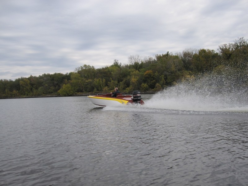

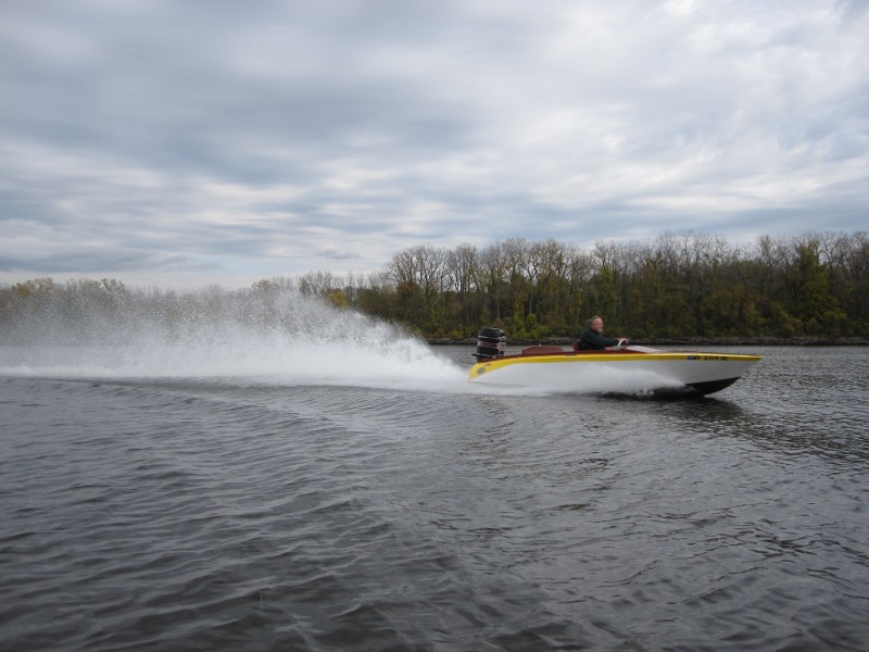

Brian moved to the second pin hole out on his merc1350, and I think he's got her dialed in. What do you guys think?
Little cool on the Hudson today, but men have to do what men have to do...
Re:Brian Lawson's Glen-L Missile 15 years 9 months ago #18199
Sweet! Quite a rooster tail too.
Re:Brian Lawson's Glen-L Missile 15 years 9 months ago #18204
Awesome, looks great. It was kind of cool on the Potomac today also, but hey, had to get some fresh gas run through the Fat Fifty after thrity years. Going out tomorrow on Patuxent, will take more pics and a movie, I hope.
Sorry to ramble! ;)
Frank Pics and movie are GREAT!
Brian She looks perfect!!!!!!!!!!!
Re:Brian Lawson's Glen-L Missile 15 years 9 months ago #18210
Looks great, that hull rides nice. Frank I think you're Brian's official photopgraher now..hehe
