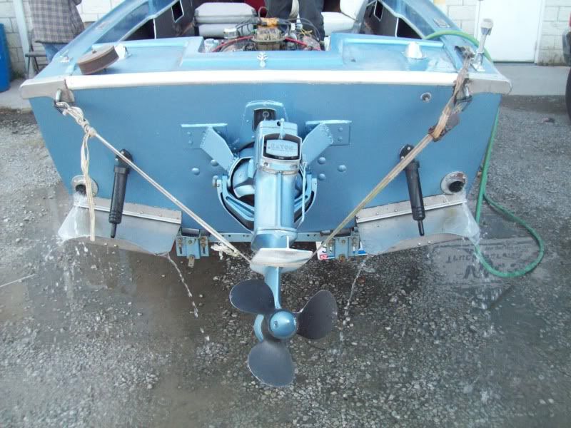

Does anyone have a photo of an Eaton Stern drive "series 14" or "Series 16"? or perhaps any information on either of the two units? Mine has the shifter cable that goes through the center of top cover and attaches to the shift lever in center of the unit and i just need to identify the series or model. The Eaton Powernaut and powernaut b apparently has the shifter lever attached to the side of the unit..among other differences. any help is appreciated.

Here are some pictures of mine series 16 let me know if you want a differnt view. Hope this helps.

Chris, thanks for sharing these photos. i was able to see them from my home system. your drive appears to be exactly what i have. i thought i had the powernaut drive but that was an earlier drive apparently. i really appreciate the help here. i noticed that you have some brackets welded to it...was wondering about that. also wondering how you like the drive unit in general? I bought a 64 dorsett about a month ago and it came with the Interceptor (221) and this outdrive unit. motor is good but the upper unit of the drive (where the shaft and posterior to the universal) seems ceased up - has been sitting for 25+ years. gears look clean though. hoping to lube it up and dismantle it to see if i can get it functioning again.

one other question, What is the top cable i see coming through the transom that is just above the red reverse shifter cable? mine is missing that cable and not sure what it is. thanks again

That's the lift-cable for the power tilt...

The CABLE is for an after market lift cylinder for tilt - trim. I'll see what pictures I can dig up. The most recent one is a background shot if you look up to the left of the clock you can see the outdrive on the shelf. The sabre craft to the left and my Lone Star waiting for paint. Wish the Sabre Craft had FINS I would of put it higher on the list.

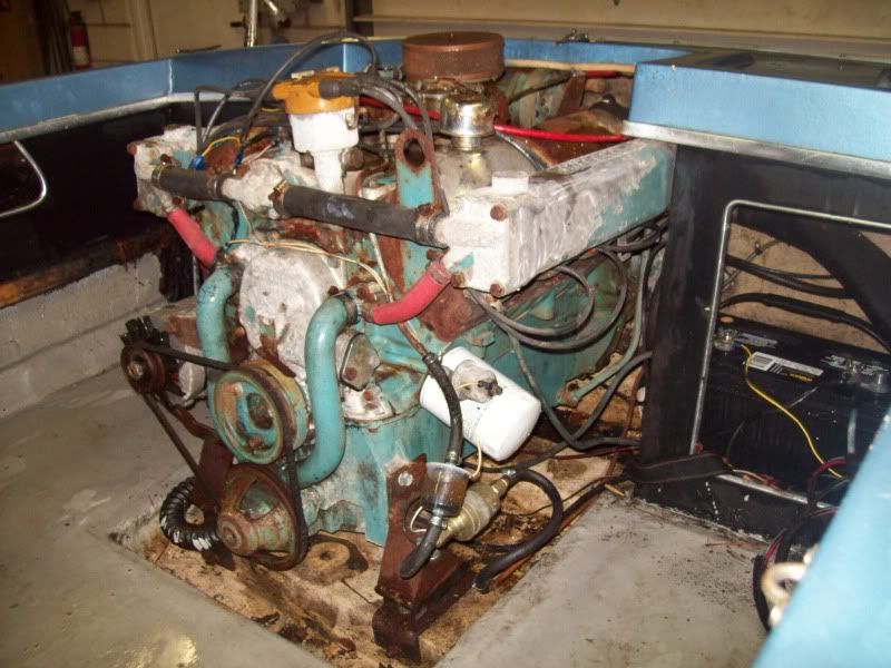

Chris,
Thanks, Im not a mechanic but it sure if fun to tinker around with this stuff. i find myself putsing around the thing for hours anticipating the thing out on the lake. I am really looking forward to hearing what it sounds like - wide open! No mufflers on it. This is the first boat i've engrossed myself in thanks to a friend that has a couple of them. just wondering what is your recommended step-by-step process to bring this 221 motor back to life? A few weeks ago i pulled the plugs and squirted a bunch of WD40 in each of the chambers and reinstalled the plugs. havent done a thing since but getting ready to. the only guage on the instrument panel is the Tach and the glass is cracked on that. all other guages are missing. Interesting in hearing your thoughts. Again, thanks sharing advice.
Steve
