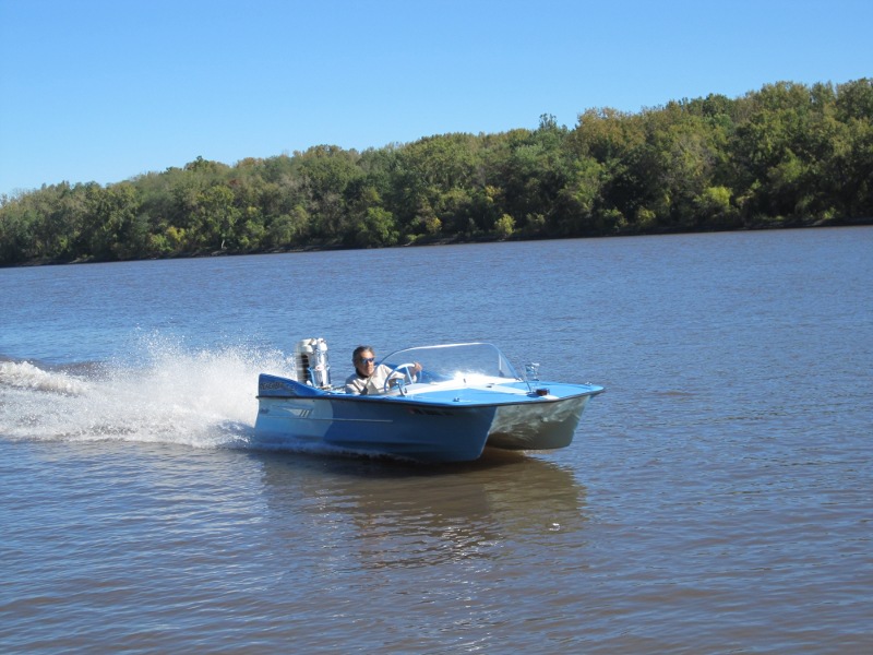

Ron - I'm glad you got the bouncing stopped. Why did you change hole to begin with? I'd still like to see you riding with the bow up more. The boat should be riding on the back of the sponson at speed, not the whole thing. You may not be able to do anything about that with the notch left in the transom though. At least you're not bouncing.

brian, i don't care what its riding on.lol... its smooth and handles great. i think i had it in the 2 hole when i first bought it because it didn't porpoise the first 2 years, then i started foolin around with it and never put it back to where it was. i will be getting the prop cupped and dropping it down a hole and see if that changes anything. ron
Re:mantaray finally at speed..no porpoising 15 years 11 months ago #17581
One thing at a time Ron. Have the prop cupped, and try that in the same pin hole. Then try different pin holes. Cupping will make a big difference by itself.

Re:mantaray finally at speed..no porpoising 15 years 11 months ago #17765
vuyosevich wrote:
not so much out of the water as some would like to see.lol maybe the cupped prop will help.
I have read this? I have never heard anyone recomend to run a hydro or multi-hull in that attitude before. It can result in a big splash!

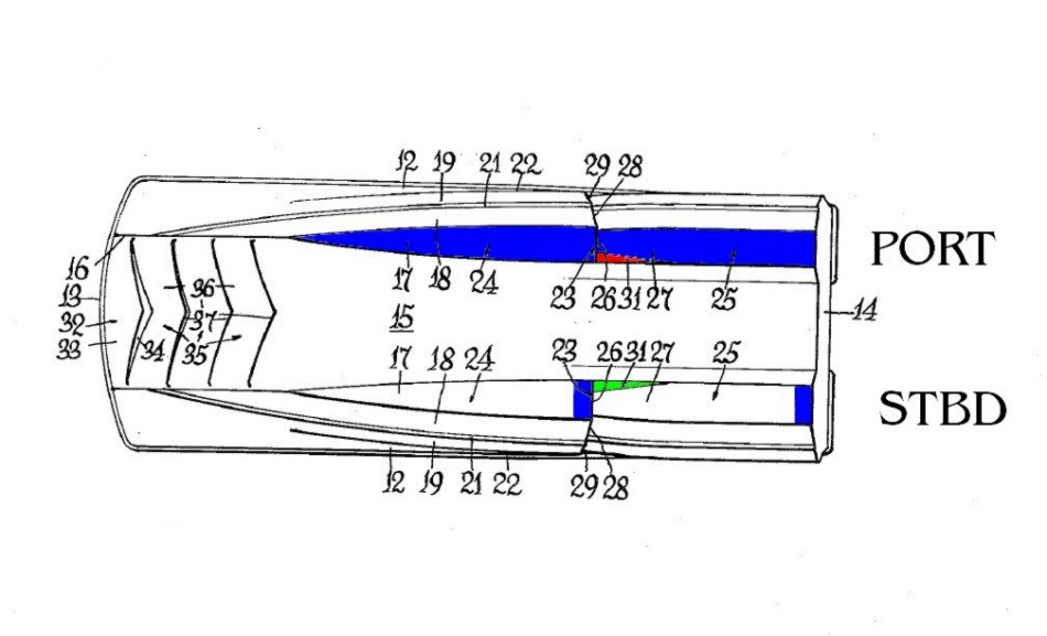

Mr. Canazzi outlined in detail the hulls functions in his patent #3051115 www.freepatentsonline.com/3051115.pdf The Manta Ray is a 4 point planing hull, meaning there are 4 planing surfaces the boat rides on.
With the bow in the air...handling, ride & safty are greatly comprimized. The anti tripping surfaces are not in play, meaning the boat will flip easy in corners at speed. A bump in the water can send you airborn...possable blowover or tumble. But it does look cool...until :ohmy:
In the picture below I used blue on the port side hull to show the wet area on minimum plane. The red area is a "fin" designed to seal the step an hold the pressure in under the hull at slower speed providing lift to get the hull on plane with less energy.
As the forward force is increased the wet area is reduced. The blue on the stbd side shows the reduced wet area on maximum plane. The green is the "fin" area that is now open the vent excess air maintaining a predetermand pressure under the hull for lift. This "fin" can be modified to adjust the amount of lift under the hull.
From your pics it looks to me that the motor needs to be trimed up, replace the splash(drag) with a roostertail. I'm very interested to hear how the cupped prop works for ya. I've been lookin' at Cleaver style props to trim higher into the dirty water coming out the tunnel.
Sorry for the long read Ron...but there is a pic :)

cat, that is the best described explanation of the manta tunnel hull that i have ever read. i'm embarassed that i didn't understand that. i know its called a 4 step tunnel hull, but have always been told that it should plane on the last few feet of the stern.
"the manta is a 4 step planing hull. meaning there are 4 planing surfaces that the boat rides on. With the bow in the air...handling, ride & safty are greatly comprimized. The anti tripping surfaces are not in play, meaning the boat will flip easy in corners at speed. A bump in the water can send you airborn...possable blowover or tumble." i hope others who have told me the opposite take notice. ron

after reading cat's explanation, the top pic is how a mantaray is suppose to ride. looks right on to me. ron
