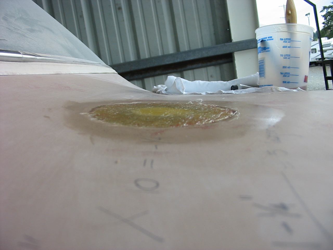

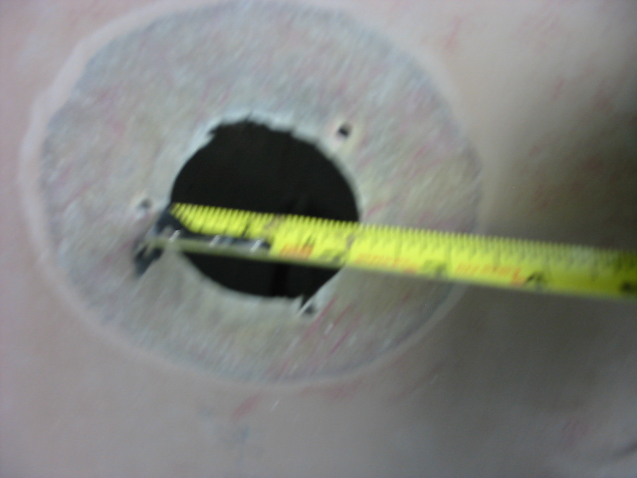

Here's a pictorial of the steps:

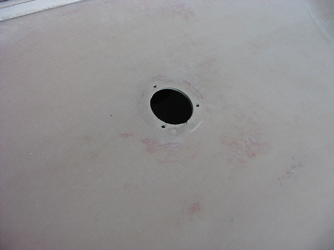

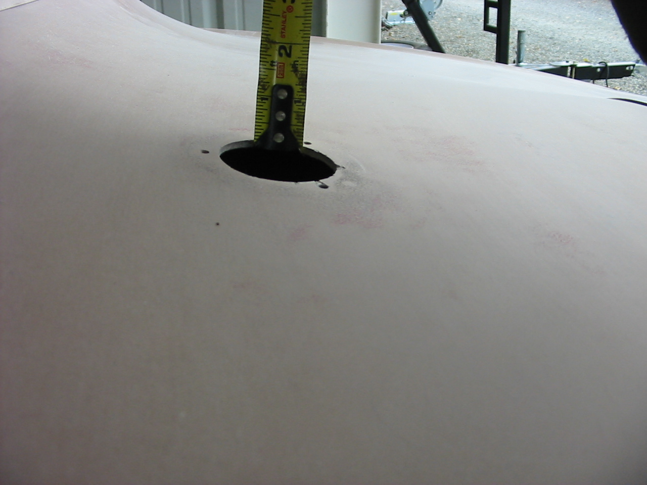

1. Someone installed a fuel fill right in the middle of the deck. My job is to make it disappear.

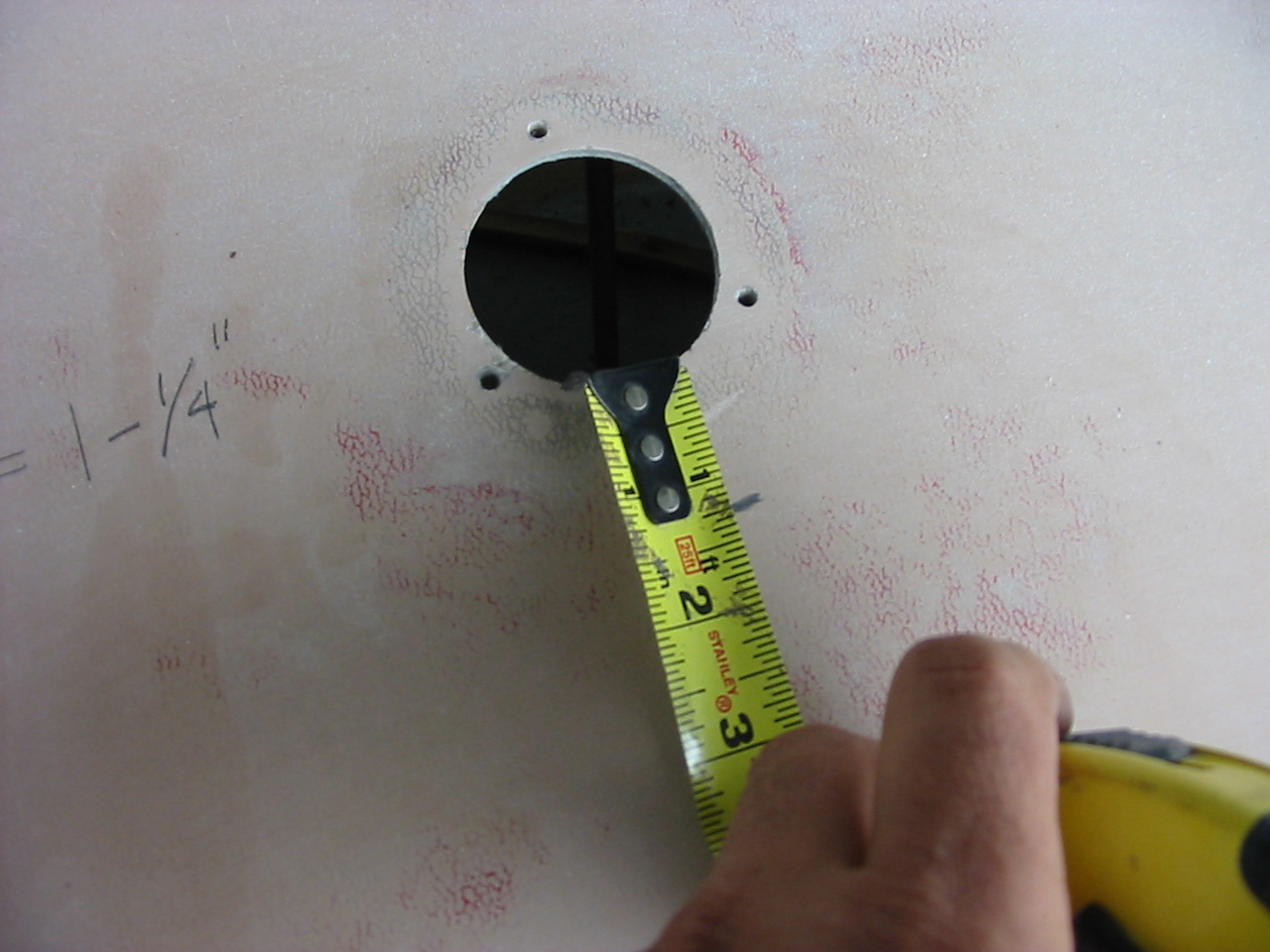

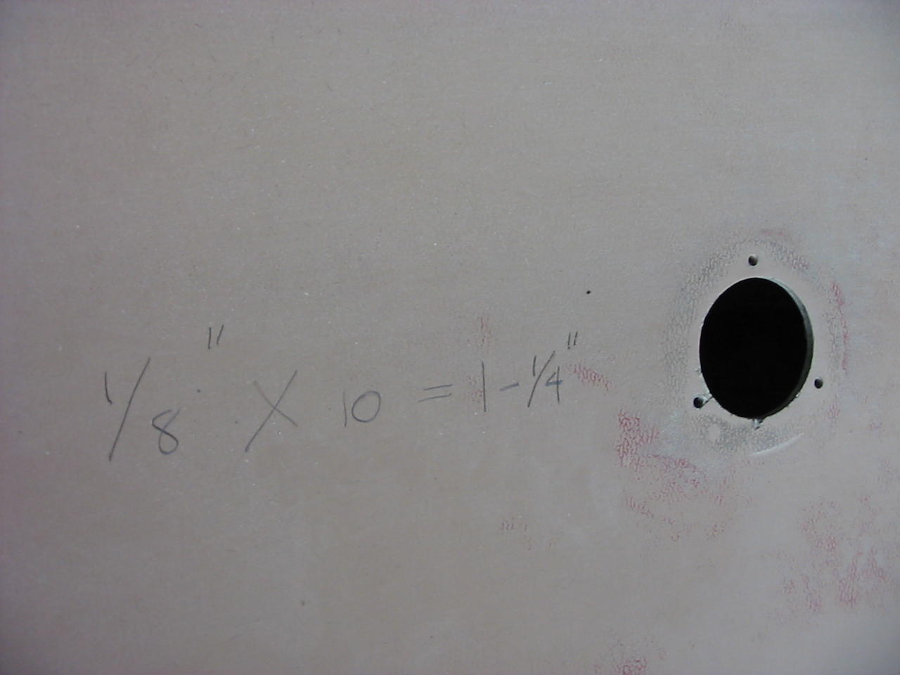

2. The first step is to measure the thickness of the existing fiberglass. In this case, it is 1/8" thick

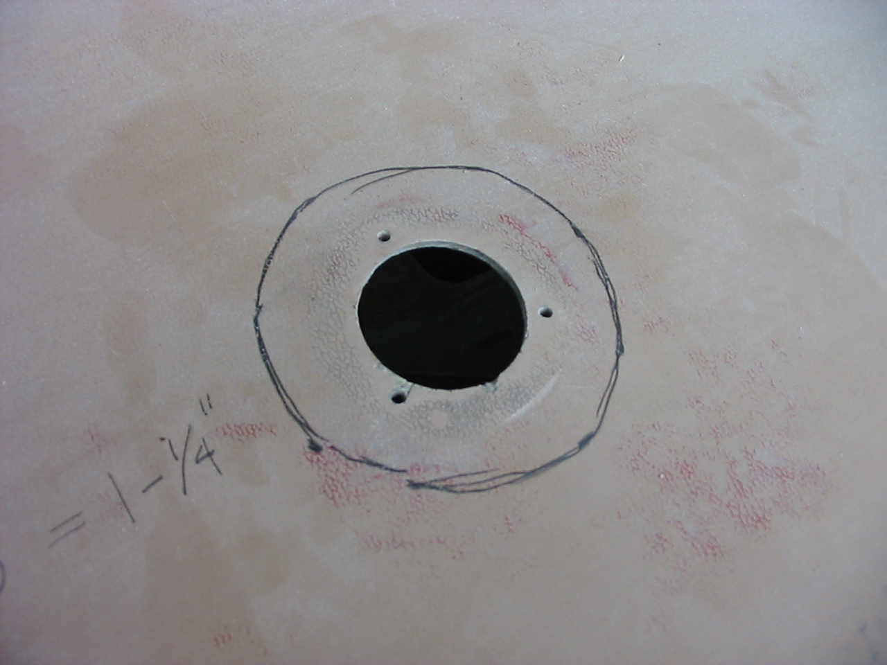

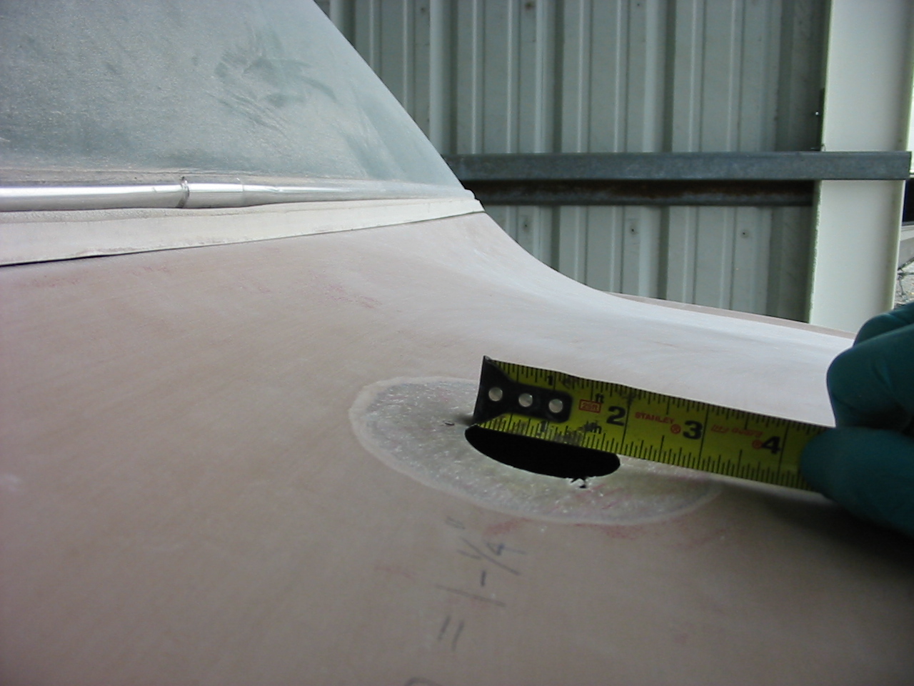

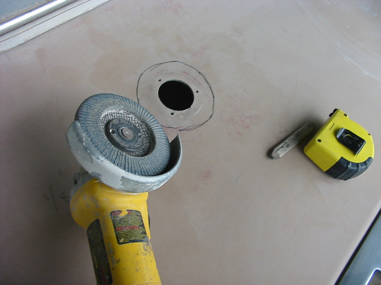

3. I want to grind back the fiberglass at a 10:1 ratio. This means I have to grind back 1-1/4" all the way around the hole.
4. Measuring 1-1/4" hash-marks.
5. Connecting the hash-marks.
6. An angle grinder with an 80 grit flap wheel will give me a nice smooth taper.
7. As always, protect yourself.

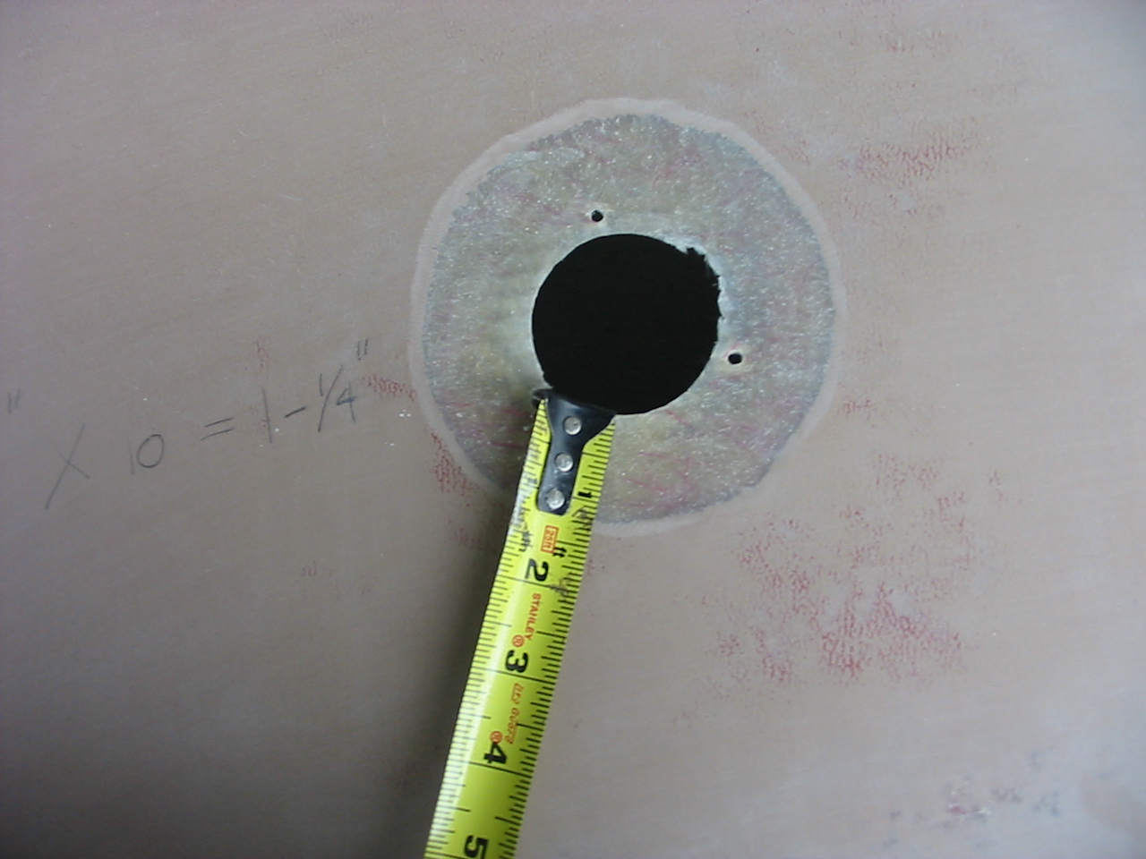

8. I can't grind and take photos at the same time, so here it is after grinding the 10:1 taper.

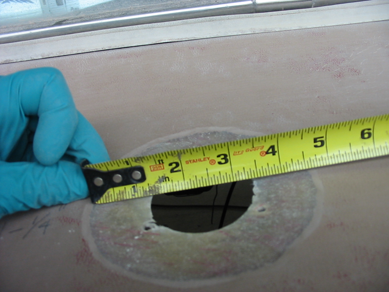

9. The diameter of the hole is 2"...
10. ...Which makes the total diameter 4-1/2"

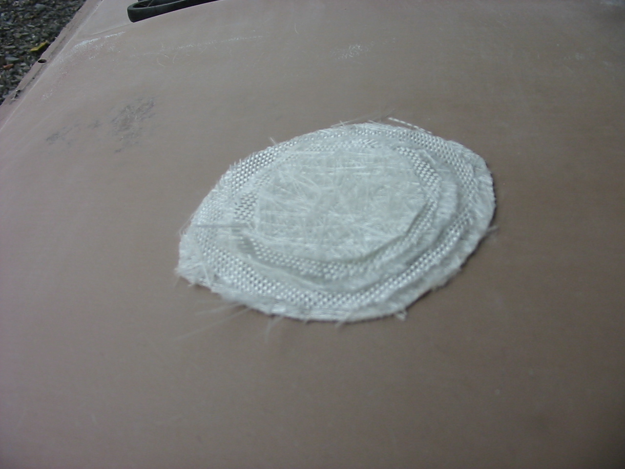

11. I want each layer of fiberglass to be 1/4" larger all around than the previous layer. This means I will use a total of five layers to fill the 1-1/4" taper.

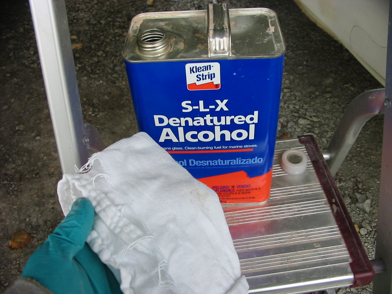

12. The lay up schedule.

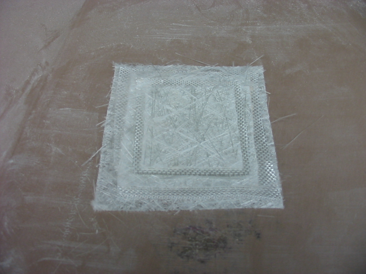

13. I cut each piece to a measured square...

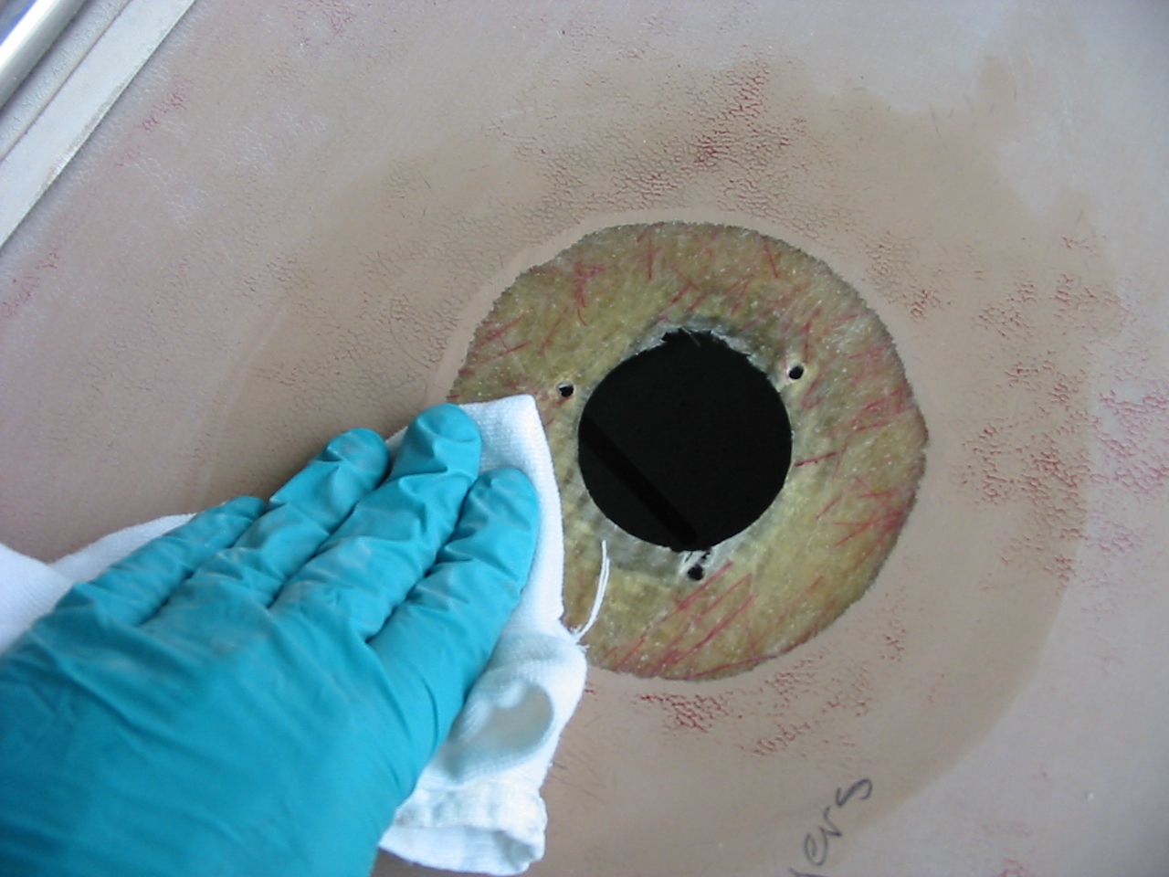

15. Denatured alcohol is used...

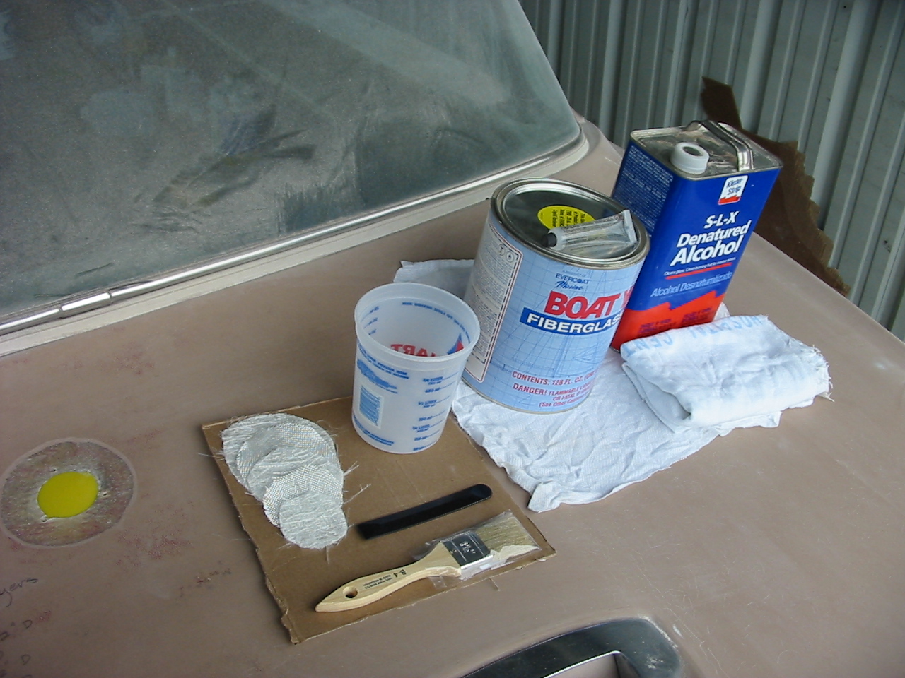

16. ...To clean the surface.

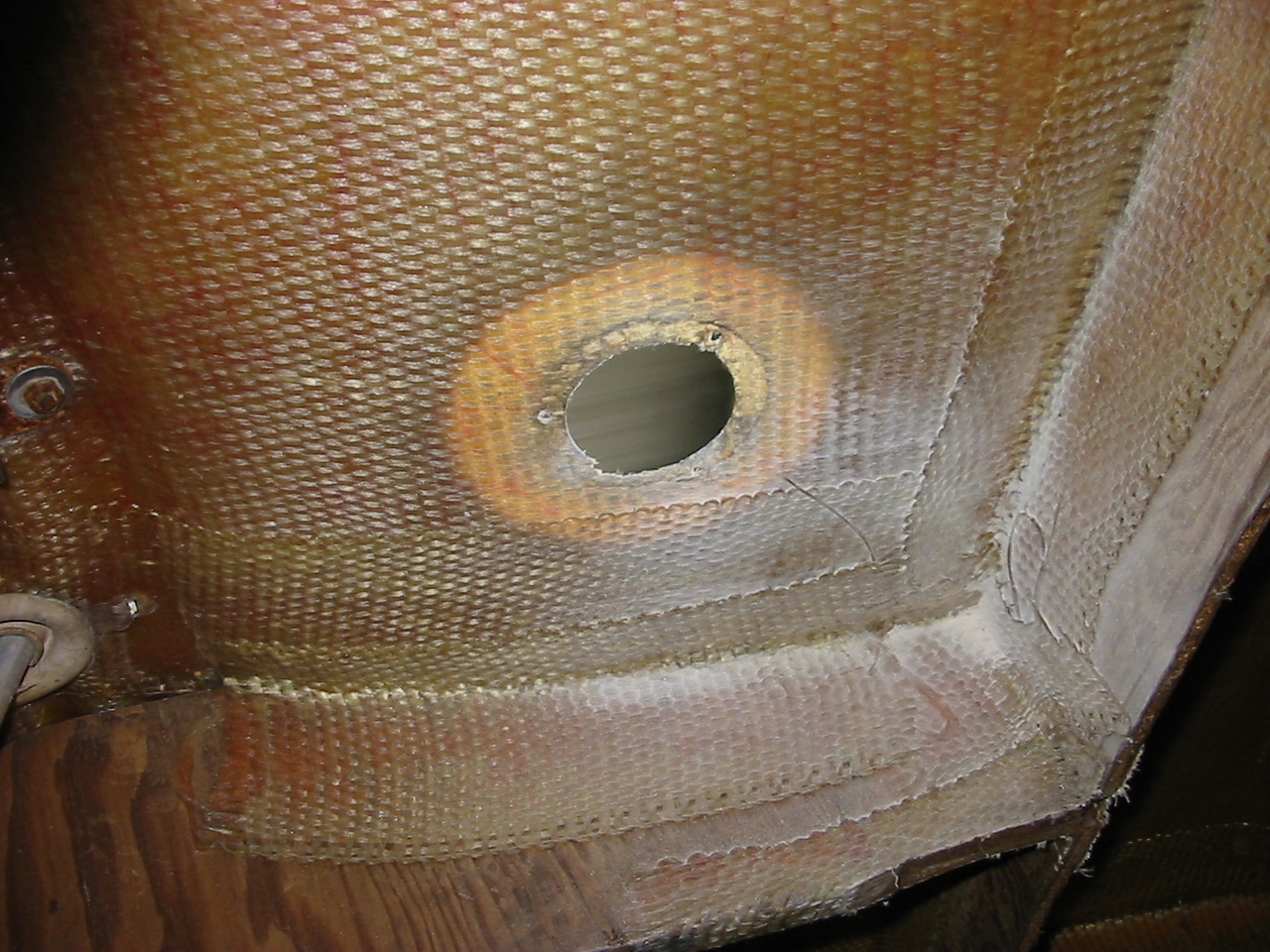

17. The hole will have to be supported from below in order to properly compress the layers of fiberglass.
18. A non-porous plastic spreader and a scrap piece of pipe do the trick nicely.

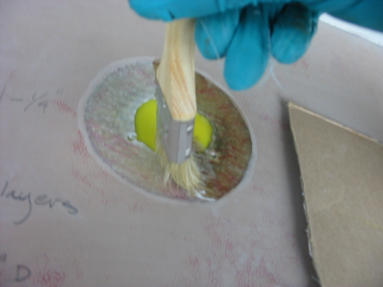

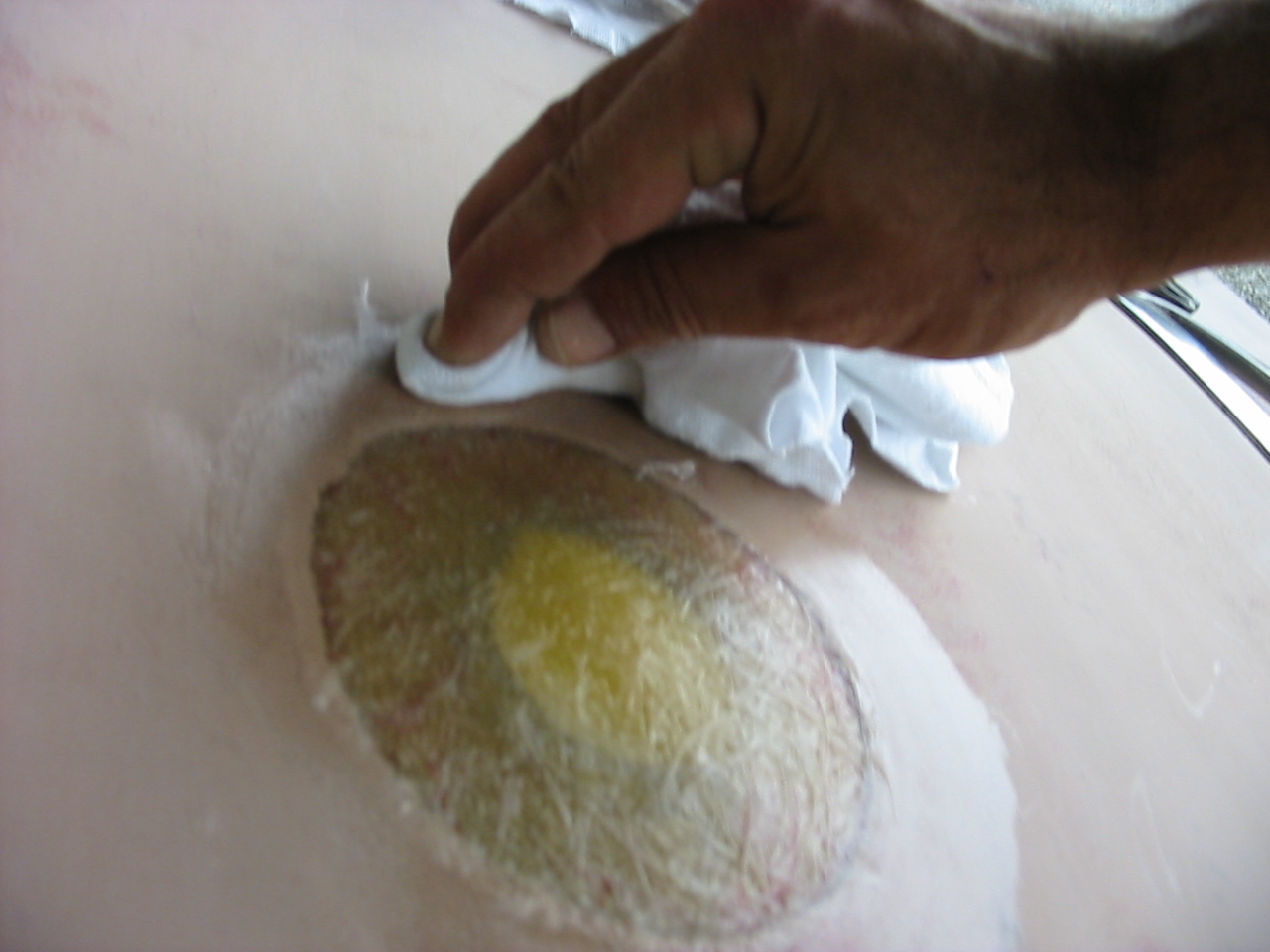

19. The materials I'll be using, (notice the extra rags and alcohol for clean up).

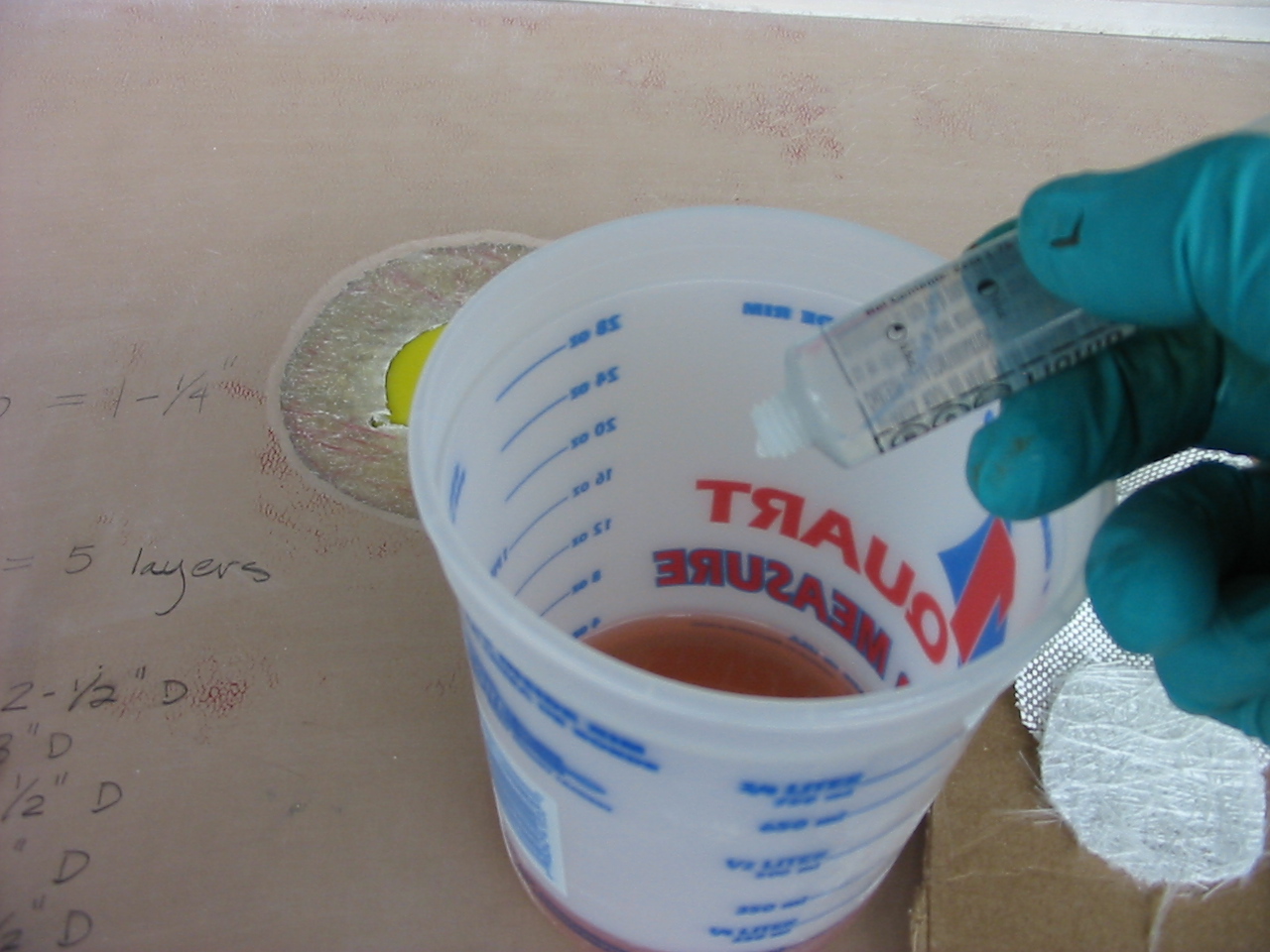

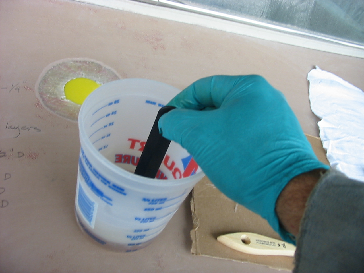

20. Adding the MEKP (hardener) to the resin at about 2% by volume.
21. Mix the resin and hardener thoroughly.

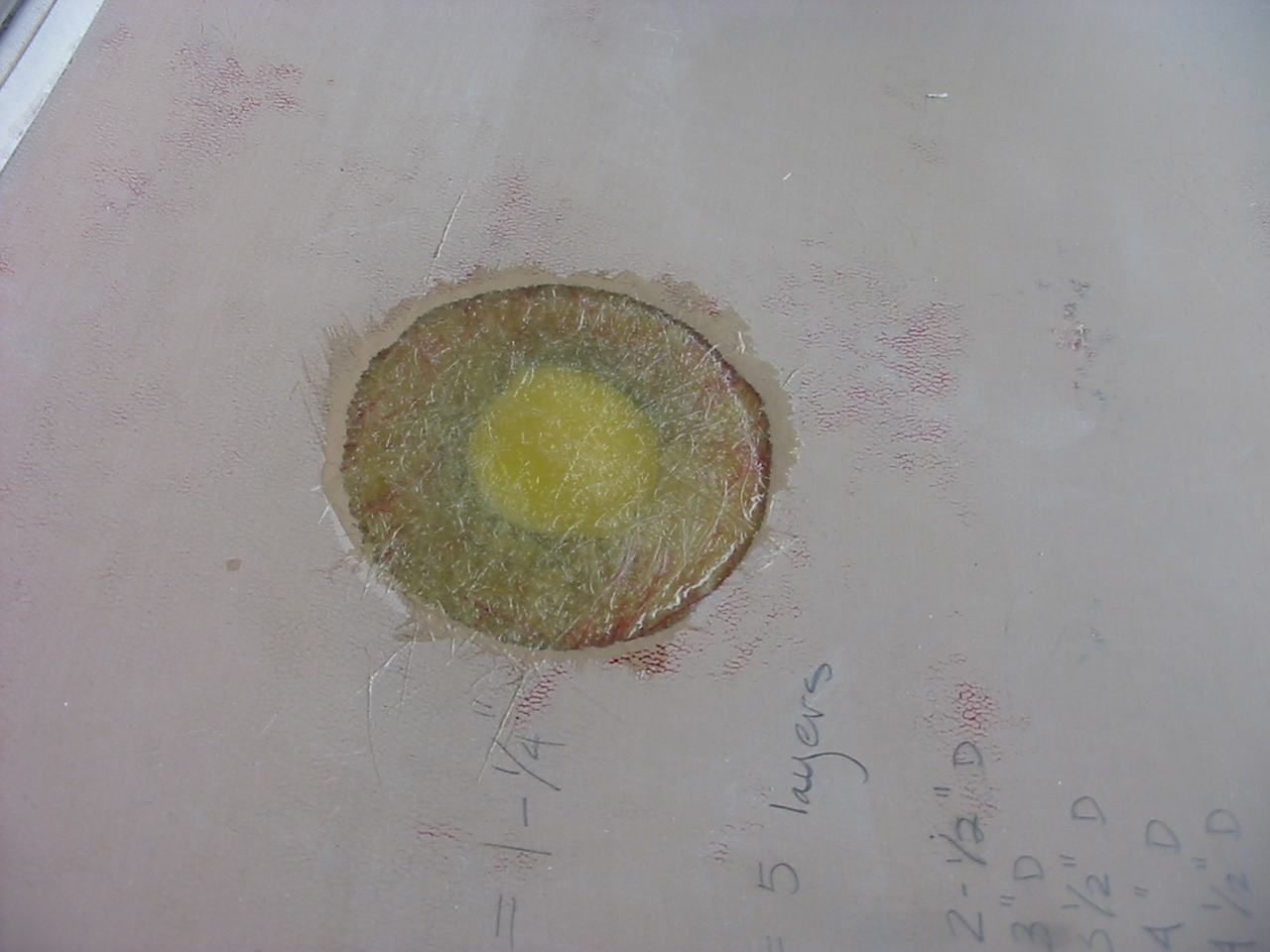

22. Wet the surface with catalyzed resin, then start wetting out the layers of fiberglass.
23. Starting with the smallest layer, build up the fiberglass until the tapered hole is filled. Using a stippling technique, ensure there are no voids or air pockets.

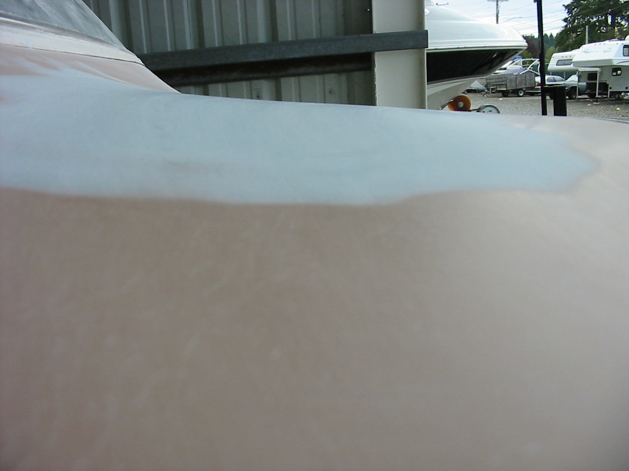

24. Excess resin can be cleaned up carefully with a rag dampened with Denatured Alcohol (or acetone, but wear gloves).
25. The surface should be close to fair when it's all finished.

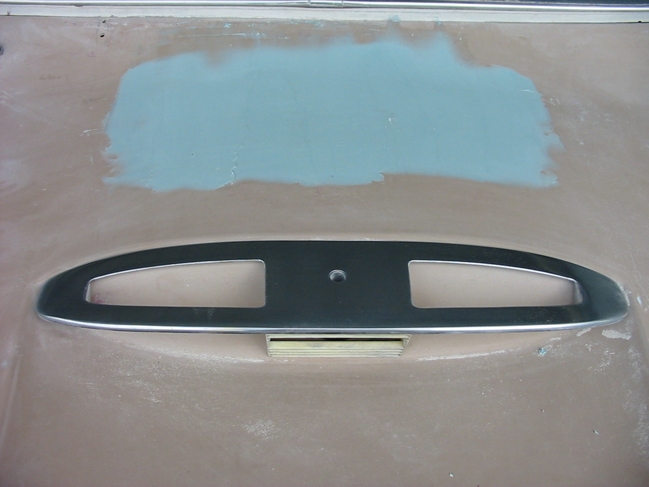

26. Fill the repair with surfacing compound.
Fair the surface and, Voila, no more hole.

All told, the repair took about 30 minutes and the filling and fairing took about an hour and a half (an hour of that was waiting for the surfacing compound to cure)
