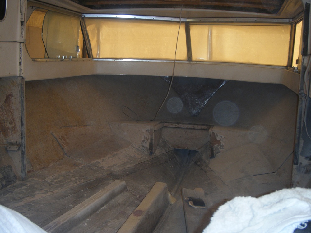

Re:1958 18 foot Sabercraft 15 years 7 months ago #22735
This is the best I have? This is the very dusty version!
Re:1958 18 foot Sabercraft 15 years 7 months ago #22736
It looks like it didn't load. So still trying to figure it out...

Re:1958 18 foot Sabercraft 15 years 6 months ago #22828
Second try...
Re:1958 18 foot Sabercraft 15 years 6 months ago #23522
Nice. Do you have any more pics?
Re:1958 18 foot Sabercraft 15 years 6 months ago #23749
Not of the floor out, sorry. We put a new floor in, but were in Colorado and when fall came it got pretty cold to work out there, so we are kind of stalled at this point. Need warmer weather for the next steps. Just bought another boat Friday, 1980 Galaxie (of Texas) so we were out there at 8:30 this morning (at a nice balmy 30 degrees +/-) tearing that thing apart. Will post some more pictures of the Commander though. I need to get someware to shrink them before I put them on.
