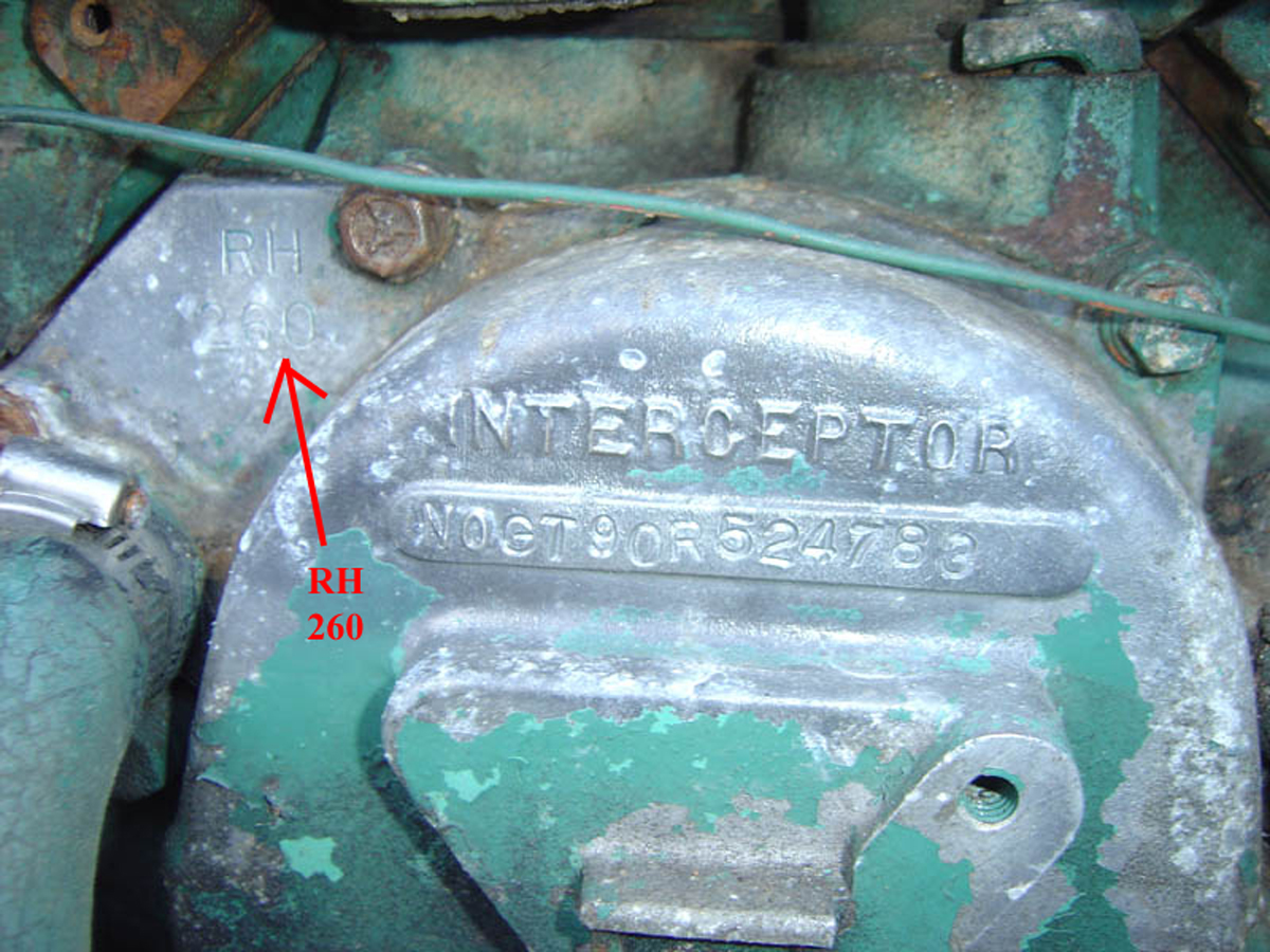

Thanks folks. I found out this past weekend that my engine is a 1963 221cu in. Thanks Fabuglas for the image that showed me exactly where to look. also, on friday my tech manuals arrived which assisted me with identifying the other numbers that comprise the Serial #. if anyone needs any help identifying the exact specs on their 221, 260, or 289 interceptor, let me know.

Ray,
Looking at your (most of which you got already) Ser# GT90R524783
G = Type of Carburetion (G is a 2 Barrel, Downdraft, Aluminum Intake Manifold) they made 2 and 4 barrel in both aluminium and cast iron
T = Displacement (260 CuIn) There were 3 displacement codes R=221, T=260, W=289
90 = Type of Reverse Gear (there were several reverse gears, 90=IO, 84-85=Bobtail (Jet Boat), 1-4=Eaton Inboard Gear, 94=Vee Drive, and 21-40=Warner Gear)
R=Rotation R-Right Hand Rotation (looking from the flywheet over the engine - also stamped on the motor as RH w/CuIn just below) (L=Left Hand Rotation)
524783=Sequence Ser #
Your 260 had a bore stroke of either 3.80"/2.87" and Compression of 8.7
The 221,260, 289-2bl and 289-4bl were all grouped in the same family.

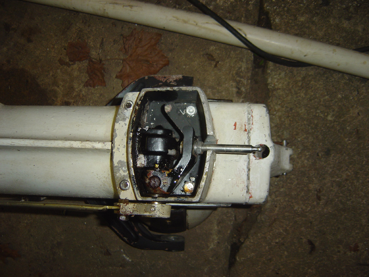

Does your Eaton unit have the shifter lever square in the middle of the unit that moves through a slotted opening in the housing? if it does, i found out that those units are series fourteen and sixteen drive units. i still need the manual for these. i ordered a powernaut manual and it turned out to be the wrong manual unit from the ono i have. The eaton unit i have has the shifter in the rear-midline where the shifter cable goes through the top housing cover and has a swivel clip on the other side to hold the cable in place.
Steve

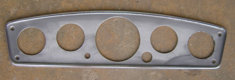

Here's mine...

Ray,
cool. That looks exactly like mine. Do you know if it a Series 14 or 16? I ordered the Eaton Powernaut manual (not the Powernaut B) which is what i thought was the correct manual, but turns out the manual i got must be for an older Eaton. I'm seeing small bits of information on the net were there was a Series 14 or Series 16 outdrive that was fitted to the Interceptor motors around 1963-65. i think one of these series may be what we have. Mine appears to be in decent shape. I just need to be patient to free up some of the gear bearings. i have it soaking now in penetrating oil, only has 140 hrs on the tach, but has been sitting for nearly 30 years and began taking it apart this past weekend. Are you selling your outdrive? would be nice to have a spare. thanks again for all the help.
Steve
Re:HELP TO IDENTIFY MY INTERCEPTOR MOTOR SIZE 14 years 8 months ago #18028
Steve,
Thanks for the serial number info...
Yes, the entire unit is for sale.. I have everything from the boat including the steering wheel, shifter, cables, etc..

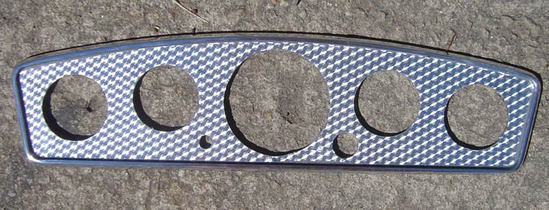

I have sold the Tach and fuel gauges, but still have the gauge panel. It's been polished and I added "engine-turned" aluminum vinyl to it.
E-me direct and we'll discuss it..
Ray
Re:HELP TO IDENTIFY MY INTERCEPTOR MOTOR SIZE 14 years 8 months ago #18375
Ray,
That guage panel looks sweet. Are you selling your stuff as a unit or will you part it out? thanks.
