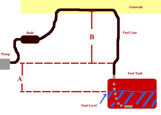

flyingfish wrote:
The tank has the pickup in the top. I thought I would run the hose under the gunwale to the splashwell and then to the bulb and motor. It never will be much lower than the motor except inside the tank itself. The floor is wide open in this boat so I think it would be in the way if I ran it down low.?????
That's why it won't be any problem.. the fuel pump doesn't have to pull the fuel a great height. The bulb will get it started, and the pump and siphon action will keep it flowing.
Even if you run the hose 100' in the air... and drop it down to the engine, the fuel pump only needs enough suction to compensate for the difference in elevation between the level of gas in the tank and the fuel pump.
See Drawing:
A= Difference in Gas level and Fuel Pump Height, As gas is spent, this level changes, but the effect is minimal.
B= Siphon-action remains neutral over this distance, The fuel pump does not have to move the fuel here.
***NOTE: if the tank is located ABOVE the level of the fuel pump, you wouldn't even need the pump- as gravity would do the work. You don't really want this in a boat (or vehicle).. because of safety. If something went wrong- fuel would continue to flow, posing a serious danger.
Re:Relocation of gas tank in Herters 15 years 6 months ago #16747
Excellent writeup w/illustration. The only time the pump would be required to pump the height of A plus B is when the line has run dry, and has to be pumped ovhe height of the gunwale.

Re:Relocation of gas tank in Herters 15 years 6 months ago #16794
Fantastic information, thanks a lot. The drawing is great.
