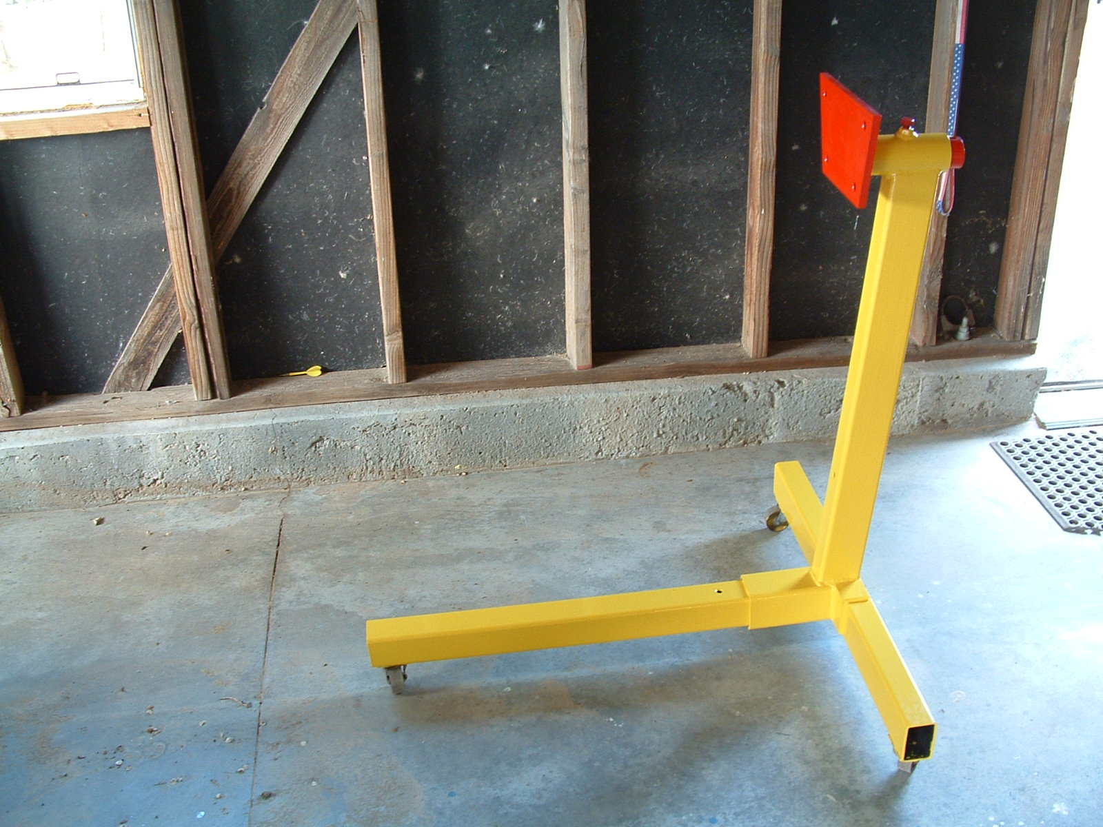

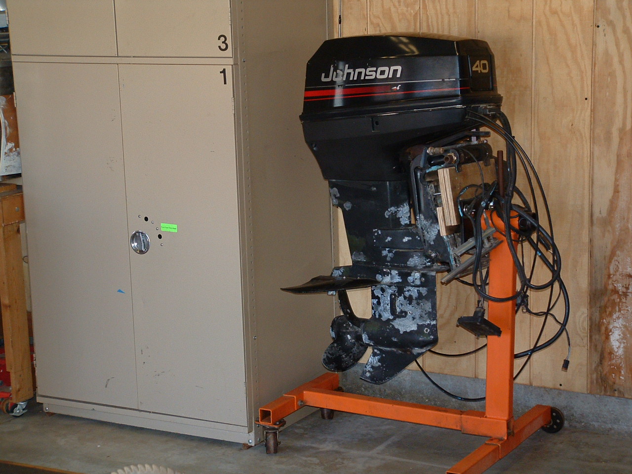

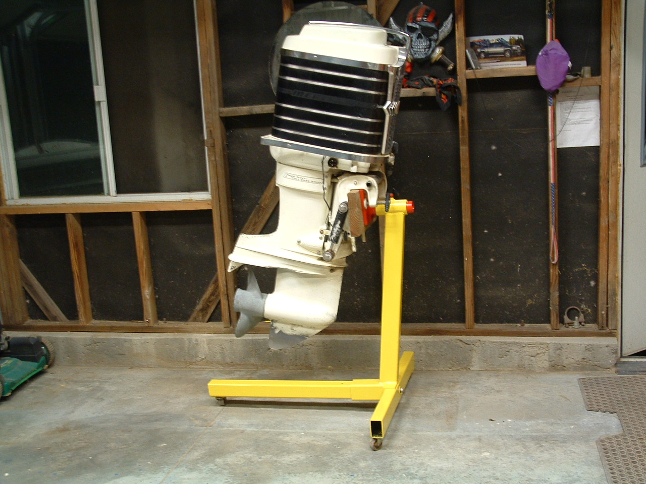

I did it last month with the yellow one that I painted. I think a 20" motor would fit on this one expecially if the motor was lilted up a little. The orange stand has to be built up for the 15" motor since it's short. Lastly the wood stand is way over kill and big but it works for out door use, Mike
15" shaft

The orange stand looks just like mine! I can make it work.
