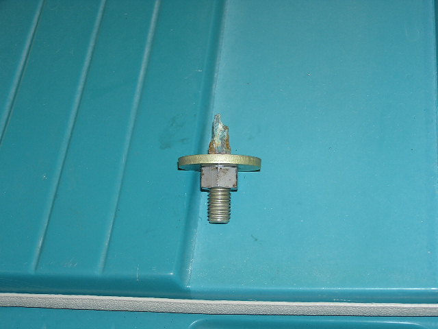

This one was quite a supprise. I noticed the top right engine flange had pulled back from the transom about 3/8 of an inch. When I tried to tighten the top right bolt, with no effort at all, the bolt broke in to. This was a factory instalation, in 1964.
The transom is sound. They used some kind of aluminum alloy bolts and electrolisus(?) ate them up.
These bolts were holding a 90hp Johnson V-4 on a Glasspar Super G.
I guess we had better take closer looks at those old "factory" installs.

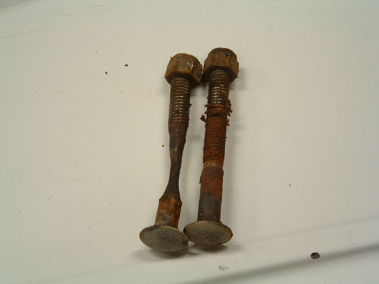

These were the transom through bolts that held a 1962 70hp Merc on to a 1961 g3. Also original, Mike

The thing that got me the most, was the top bolts were the worst. The bolts, nuts, and the washers were all of the same type of alloy.

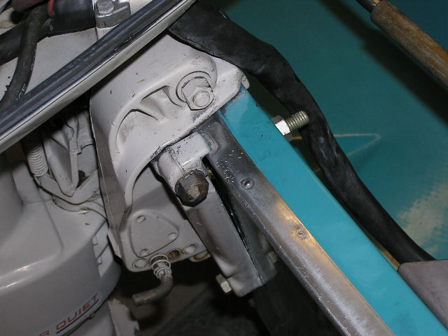

If you look close at the picture you can see that the front lip of engine mount is keeping the engine from going back any farther. The top right bolt didn't break it was oxidized all the way through. If that engine had been mounted up off the transom 1/2" or more?
They have been replaced with stainless and sealed.
