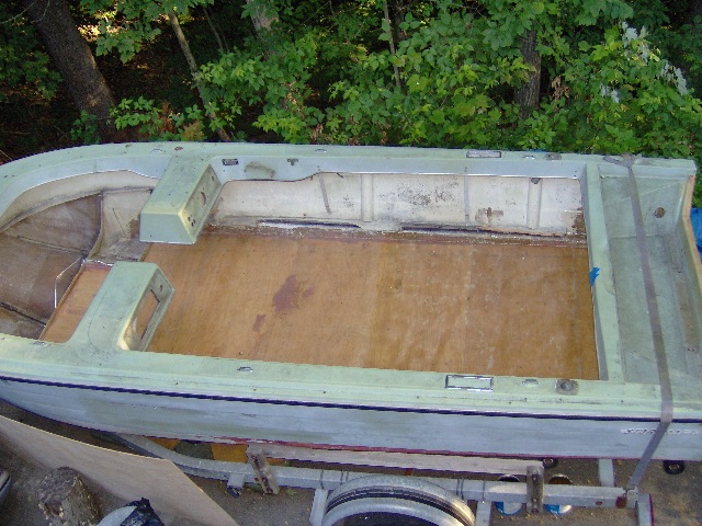

This is what I started with...

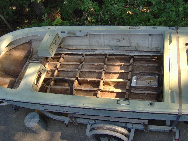

Heres what I've got it to now...

OK here goes.
1 Before pic even though it is an outboard and a Starcraft.
2 Remove entire floor.
3 Build new pieces and water proof the underside and glass it to the hull on top.
4 My bow seats rebuilt, but you may be able to stop at the helm and not replace the bow seats.

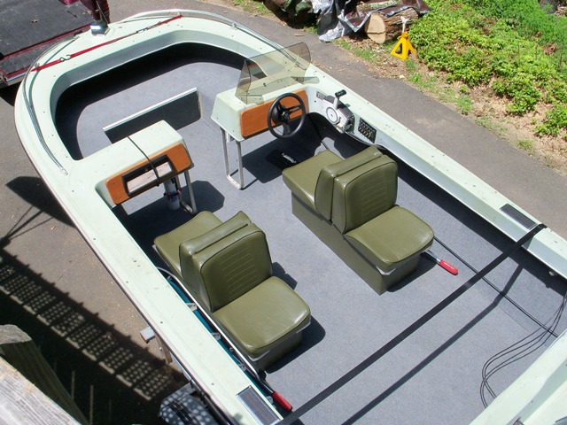

5 Recarpet after glassing the entire top surface.
6 Carpet up the sides and reinstall the seats.
A lot depends on the framing underneath. I did not replace the wood in mine. I simply went over the old forms with a second layer of 1.5 oz. woven roving.
I used the same thickness plywood, good exterior grade.
I screwed and glued the new floor down with stainless #8 flat heads, and poly resin.
Re:New member intro 16 years 1 week ago #15136
well, it's worse than I had originally expected.
Not only is the entire port side half of the deck completely dry rotted, but also, the port side half of the transom, and approximately the aft 4' of the port side hull stringer.
I now find myself in need of questioning if it is going to be worth trying to save.
For now,I will continue to remove the rotted wood, consider the practicality of attempting to splice in replacement structure, and try to determine the potential of restoring structural integrity.
Here are some pics of the progressive removal.
Please feel free to share your thoughts.
Re:New member intro 16 years 1 week ago #15141
Whoa stop removing that inner fiberglass skin. You will need that if you go with Seacast or the other one, Nidabond I think.
Is there a way you can grind the cap of the transom and remove all the wood. For removing all the wood, the more rotted the better. Removing decent wood I found difficult, and I actually cut the back of my boat off.
Check out the Seacast website. The have specific instructions for I/O motors.
Re:New member intro 16 years 1 week ago #15212
actually, there is no inner fiberglass skin on the transom. Yes, it was glassed in around the perimeter, but it was never completely covered/encapsulated with glass cloth/resin. kind of strange they did it that way.
