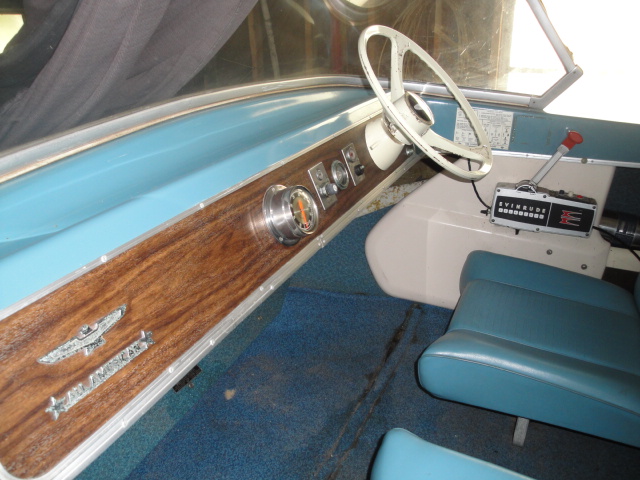

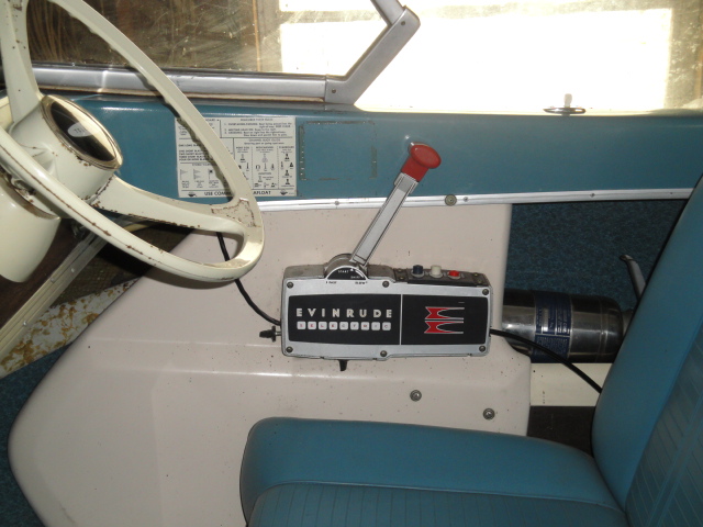

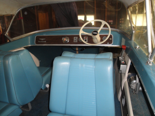

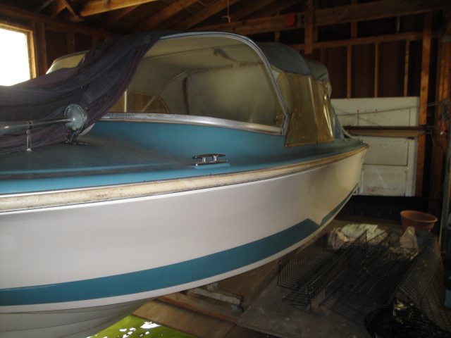

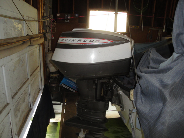

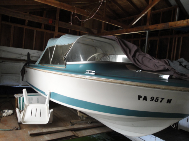

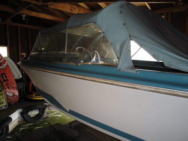

My Grandfather gave me this boat and I would like to put it back into the water. It is a 1966 All American Larson, 1959 (??) 90 HP Envirude on the back. It has been sitting up in the boathouse for well over 15 years. I would like to get it fix but do not even know the first thing about how to get this thing running. I imagine all of the lines, hoses, etc.. are dry rotted and I remember the boat was put away not working so I don't think the engine would even work. The boat is located in Northeastern PA. Any info would help

Wow! that looks really great! You've definitely found THE best source on the 'net for help. There may not be as much to do as you think but you will have some things to attend to. It's not that hard and many if not all of the parts can still be found. I know others will respond with recommendations and sources, etc!

Obviously kept in a garage this whole time! Lucky you!

Getting the "Boat" ready- appears to be a non-issue. It appears in great condition. I would look over the bottom of the hull for cracks or impact damage. Then I would inspect the transom. Grab the motor leg and push and pull on it- to see if the transom twists or is solid. It's hard to tell someone how to do the "rap-test" and listen to tell if the transom is solid.. It's a pretty subjective sound. But you can use a rubber mallet. A good transom will "bounce" the mallet , while a rotten transom will not recoil much and you'll only hear a dull thump.

The motor is definitely newer than 59. My guess would be it's about the same age as the boat.
Re: 66 Larson Help 15 years 10 months ago #14177
Yes, It is a 1966 100-S with electric shift.
www.old-omc.de/e_1966/seite_04_05.jpg
