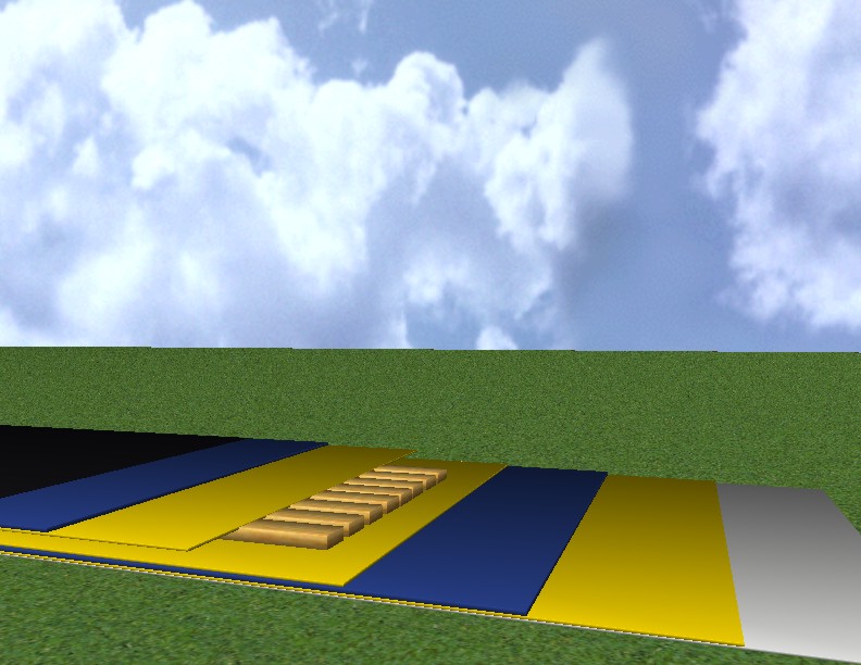

Thru this together showing the layers of the tunnel top.
BLACK; the black resin coating the interior.
YELLOW; a layer of matt
BLUE; a layer of heavy cloth
WHITE; color coat
WOOD; 1/4" x 3 1/4" plywood slats

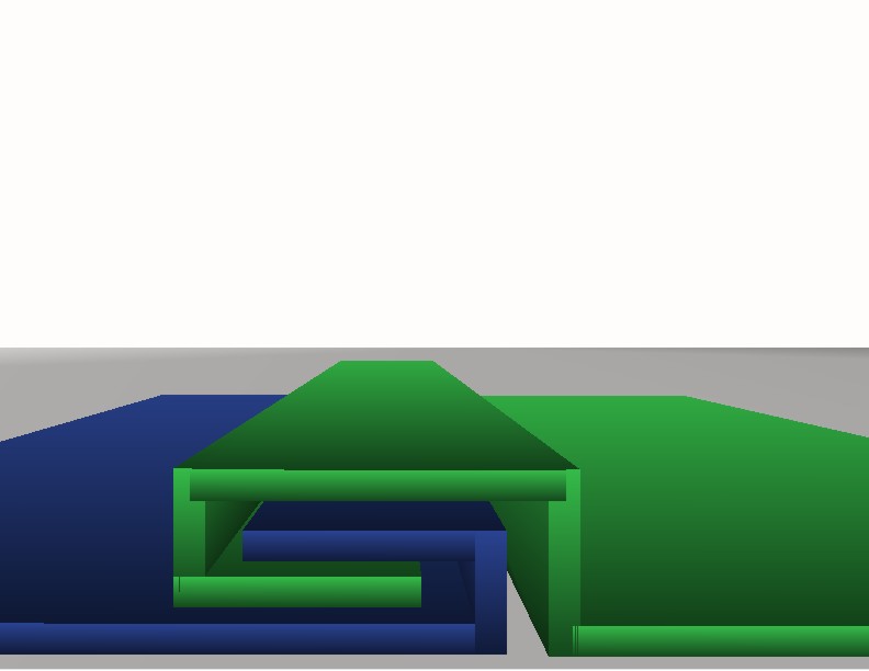

This shows how the heavy cloth layer (below plywood) is seamed down the center.
