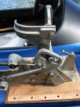

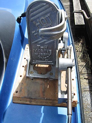

MadProps, do you have any pictures of your foot throttle setup?
Those are way cool little boats! ;)
Re:what motor do i need? 16 years 3 weeks ago #14065
I will take some tomorrow for you

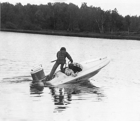

Re:what motor do i need? 16 years 3 weeks ago #14079
Cody that inline 6 will sink the boat....long shaft motor are not the way to go ....you will need a jackplate to raise the long shaft motor high enough to operate correctly, not only will that cost another $100 or more but the boat will be top heavy & off balance

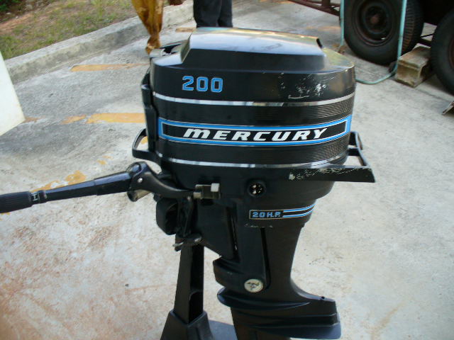

Re:what motor do i need? 16 years 3 weeks ago #14116
Depending on where you live the merc 500 in a short shaft isnt to hard to find, I just sold 2 last month (Indiana) Kmarty in StLouis has atleast 3, I find them on ebay all the time, match it up with a 2 blade 11x15 and your having fun!

JerrfyLube
here is what Im using T&H marine Hot Foot throttle works with Merc & OMC standard cables

Thanks for the pics!
Ive been eyeballing those hot foot setups...would be nice to free my throttle hand up while driving.

Re:what motor do i need? 16 years 3 weeks ago #14129
atcrider1 wrote:
ponyboy, i live in the small town of Montrose Michigan, got any more?
www.iboats.com/T-H-Marine-Hot-Foot-Throttle/dm/cart_id.138102417--session_id.553859023--view_id.40112

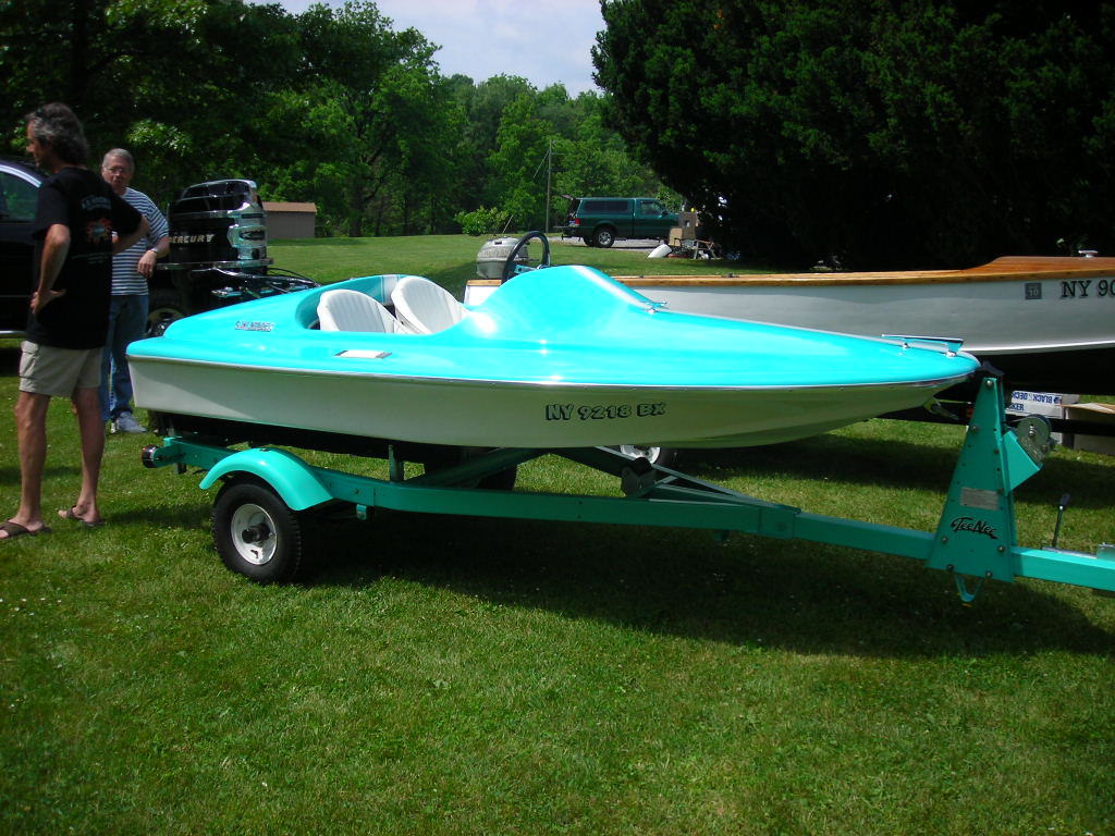

Re:what motor do i need? 16 years 3 weeks ago #14155
here is a gw invader that was at the silver lake,ny meet,im sorry i forgot his name and what motor he was running,maybe after the picture posts illbe able to tell.
whatever it was this little boat screamed accross the water,
if cc100(dave albertson),or frank alguire (pc1000),or ron vuyosevich sees this,they may remember.
Re:what motor do i need? 16 years 3 weeks ago #14183
That is a 1965 merc 500
Re:what motor do i need? 16 years 3 weeks ago #14186
thanks pontboy,that guy ripped up the water with it,it was fast,john

Re:what motor do i need? 16 years 1 week ago #15046
you asked about an old Merc inline 6..I said it would sink you GW Invader..I just ran across this pic ....apparently I was wrong, it almost sinks it :lol:
Re:what motor do i need? 16 years 1 week ago #15048
I think If I was that guy, my friend would be riding on the bow.
