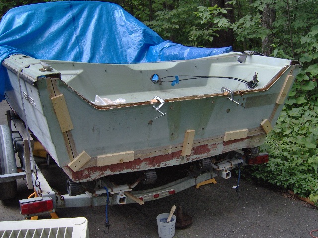

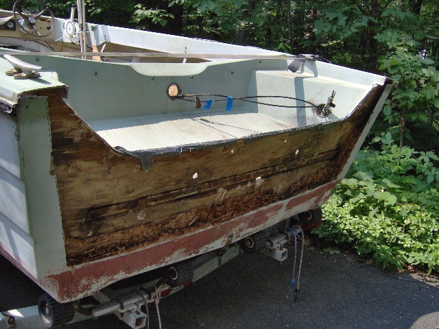

I have made up a photo gallery and descriptions of how I replaced the transom of my 1967 MFG Westfield. I chose this route- because the MFG Transom is curved. Trying to fit plywood would have been somewhat problematic.
The procedure was very easy.. and only took 2-days start to finish. Now that I know what I'm doing. I could do it in one day pretty easily.
The price of the Nidabond was about $250 for 10-gallons shipped. My transom required 8-gallons. The hardener was another $25 as it had to be purchased from a different company (hazardous material). I will try to look up that information and post it on the webpages when I have more time.

Nothing is needed. The Seacast/Nidabond are much stronger. They have outstanding compression resistance (10x plywood), so you can't even over-tighten your bolts and clamps.
Nidabond does not have fibers in it. It's polyester with ceramic beads (kinda feels like sand).
It's plenty strong without fibers... so I believe they thought "why add it if it's not needed?" . It might make it stronger... but it doesn't "need" to be that strong.
Figure it this way.. if a 1 1/2" transom is strong enough... why go to the extra expense, and added weight to build one 3" thick?
