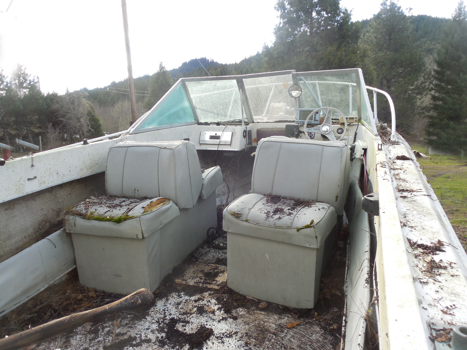

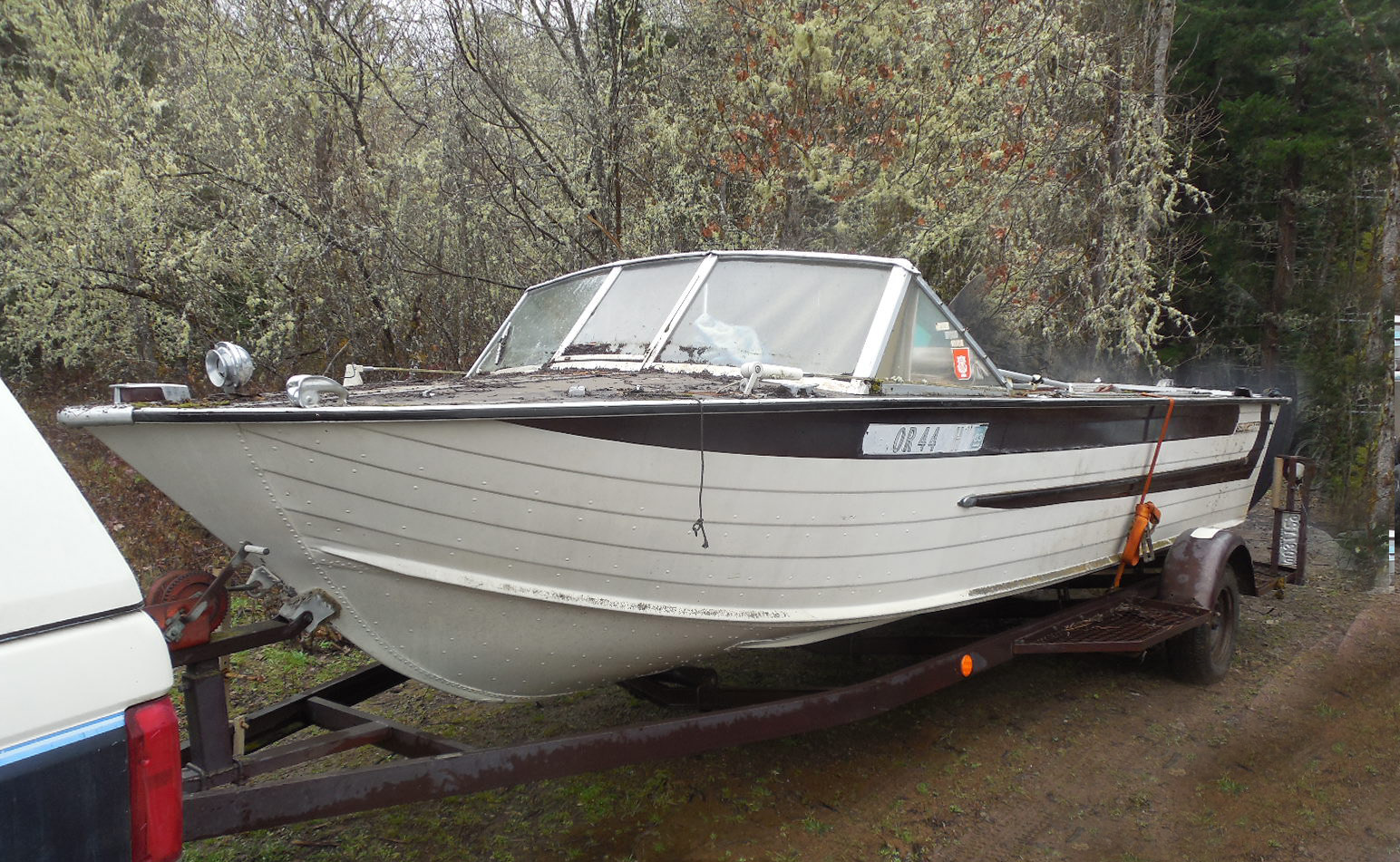

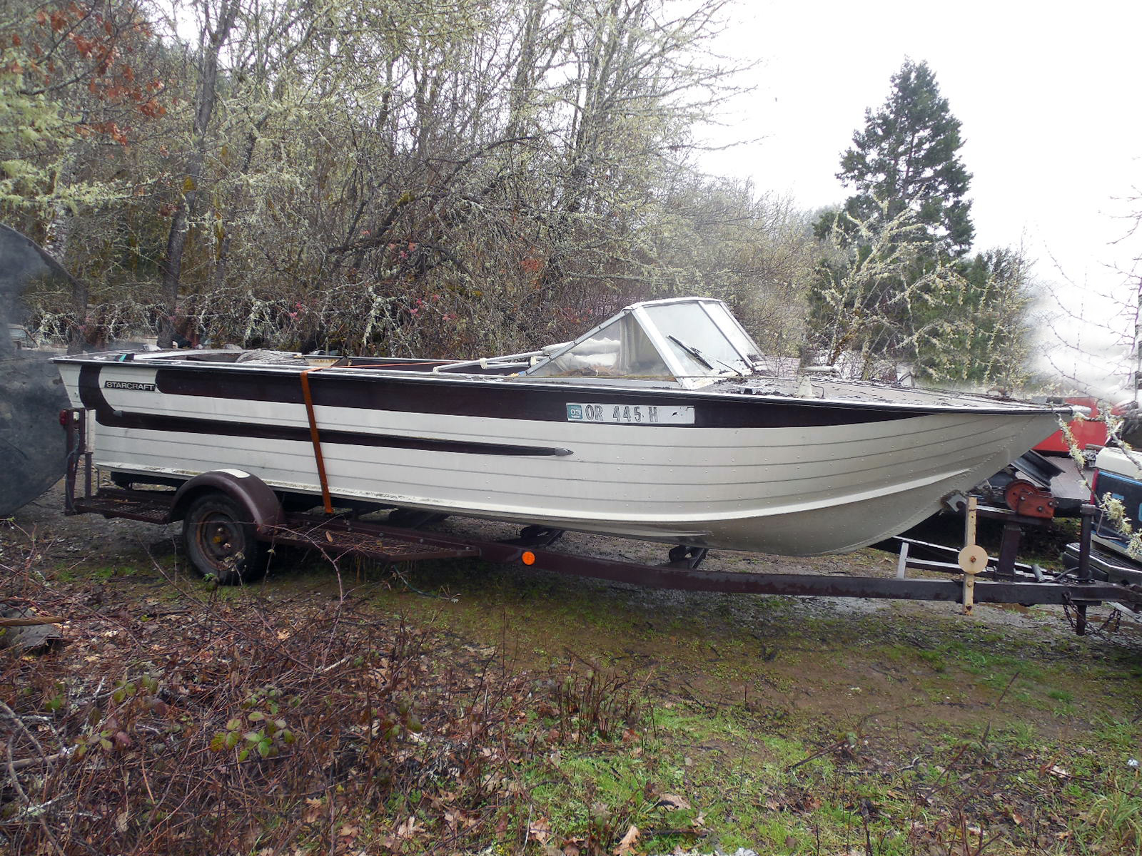

I recently acquired what I think is a really cool boat, it's a 1972 Starcraft Holiday 21' with a 140 HP I/O. It's a beautiful boat but it's been sitting outside in the Oregon weather for years and there are soft spots in the deck. I have never worked on an aluminum boat of this size and am not familiar with what might be under what appears to be an aluminum skin for a deck or floor, perhaps some sort of foam? Does anyone have any experience replacing a deck on one of these boats that could offer an amateur some advice?

Now your question about the deck. You mention deck & floor in your post. I assume you are referring to the floor. I'd assume it's 1/2 plywood screwed to stringers. Rotten plywood covering saturated foam. If it's a salt water boat then heavy corrosion is possible too.

Again you say "deck" without clarification. Are you talking about the floor or the cabin roof (the area forward if the windshield)?
It is (was) built for recreational boaters. Like I said prior, most likely 1/2" plywood. I don't know that as a fact. I have never torn one apart.

You were correct, the deck appears to be 1/2" plywood with a vinyl covering (I thought it was aluminum). I still need to determine what supports the plywood, whether it is thick foam or aluminum ribs. I guess I'll have to tear into it as the hull is really nice and aluminum boats seem to have much more value then fiberglass ones.

I'm sure the floor is screwed down to aluminum stringers. (But periodically they do get riveted).
The foam is most likely poured in & expanded type. Probably poured in before the floor was installed & any high spots trimmed to flush before floor was installed.
In recreational boating the floor is also a cockpit floor, rarely a deck. Deck is the upper surfaces, typically the entire structure above the rub rail as a simple runabout boat is assembled in 2 pieces, a hull & a deck. Assembled at the rub rail.
