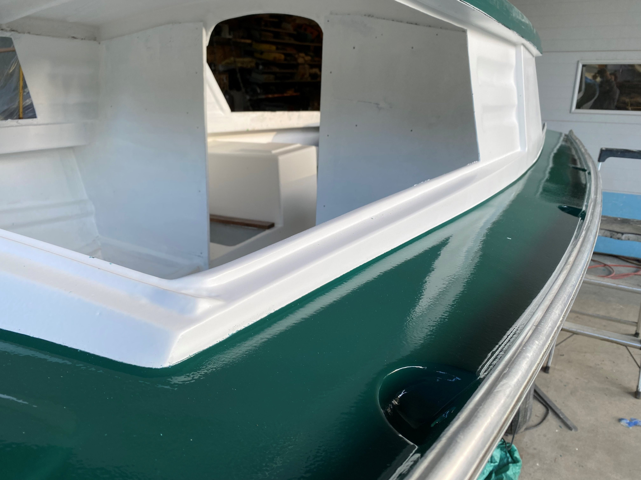

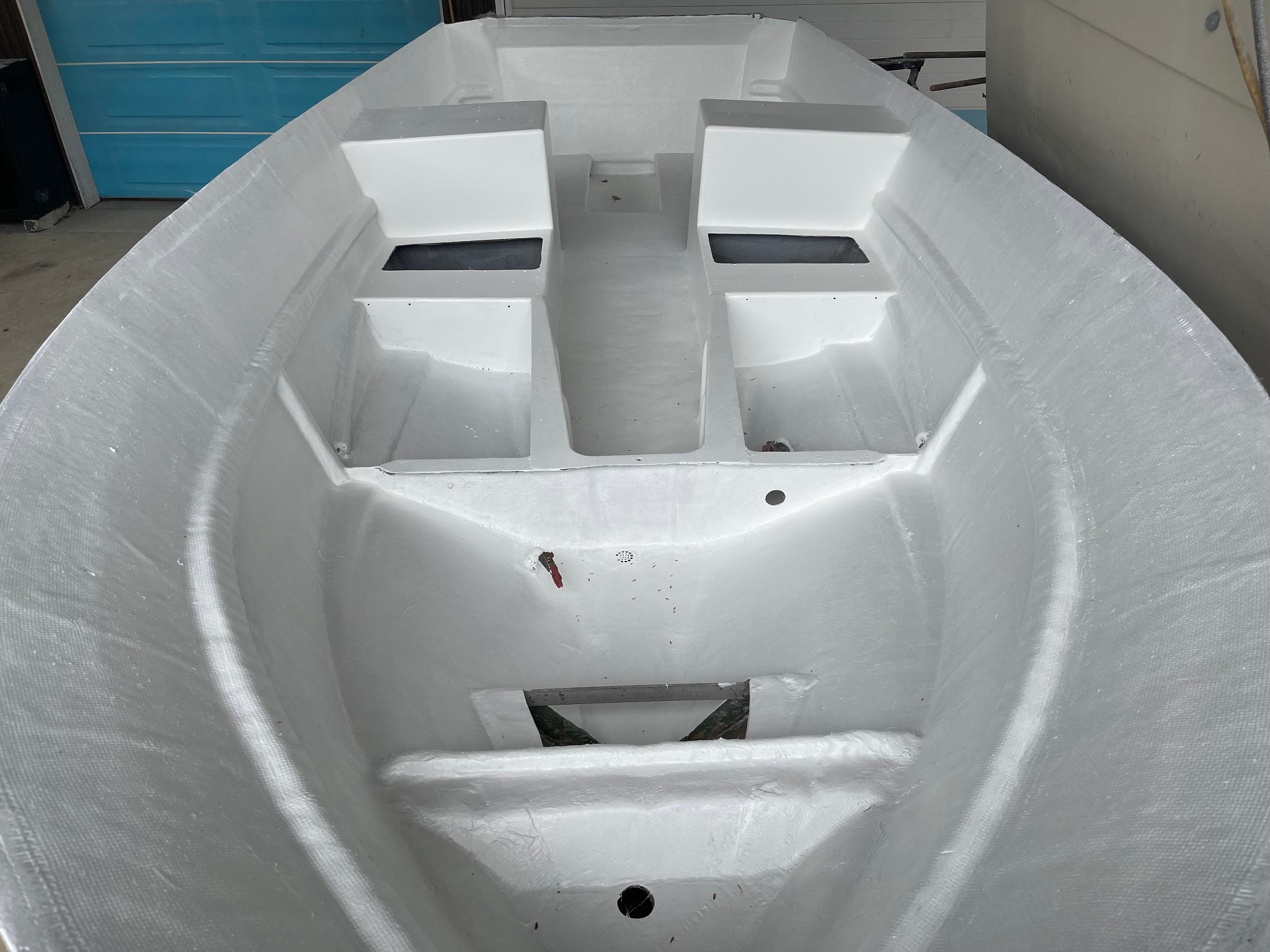

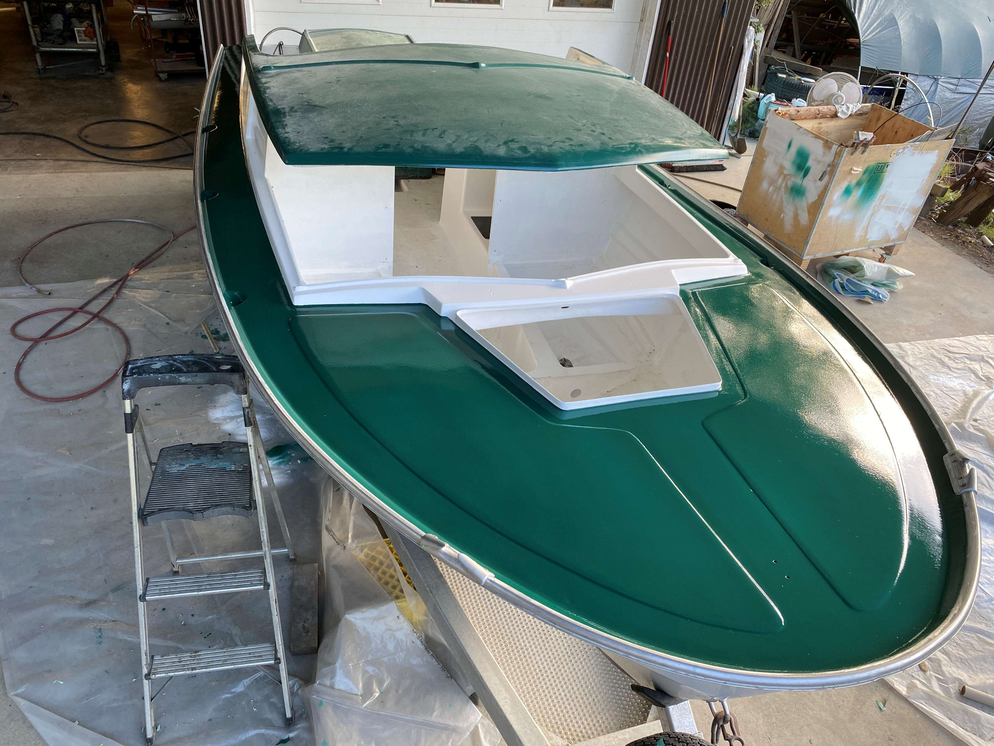

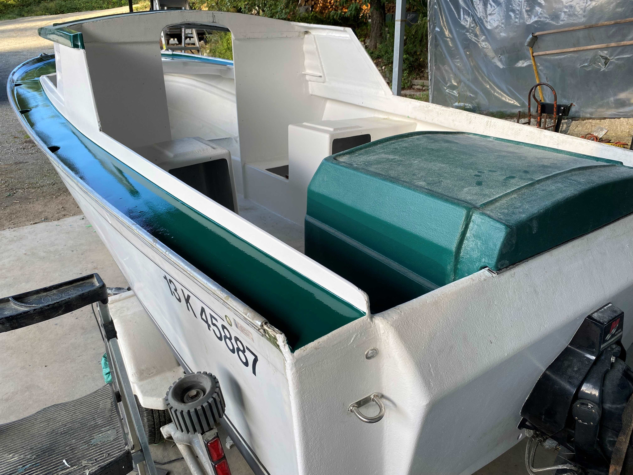

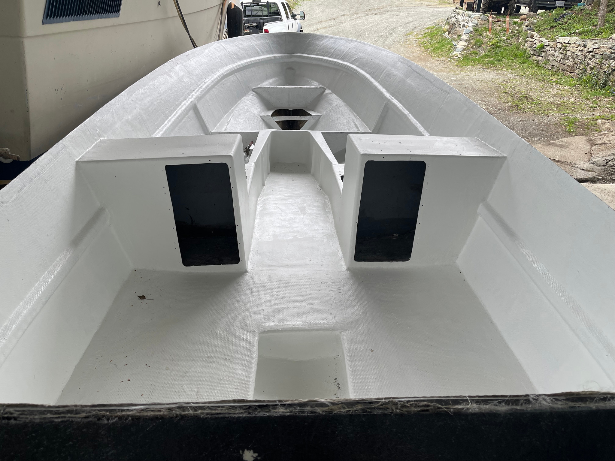

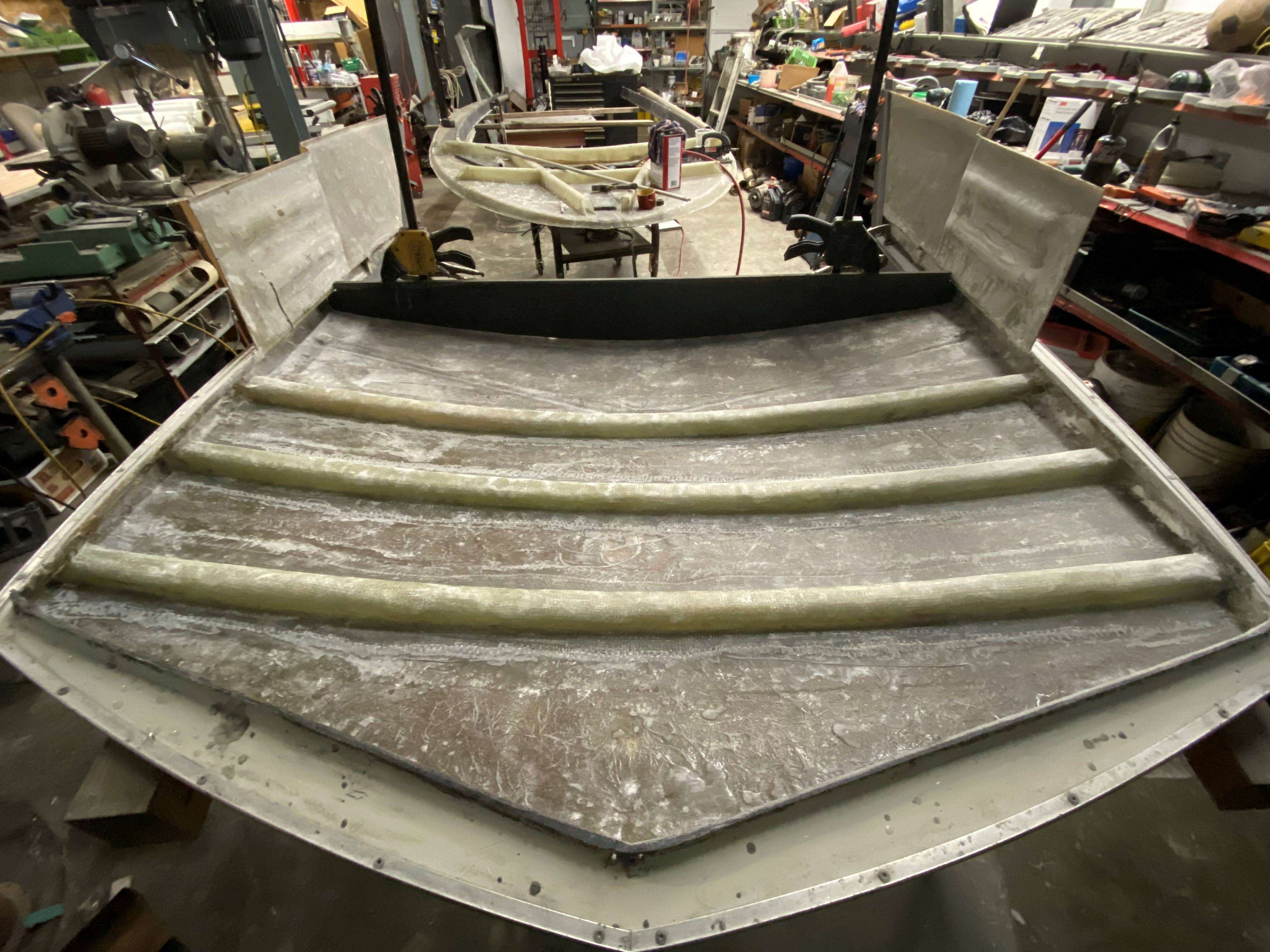

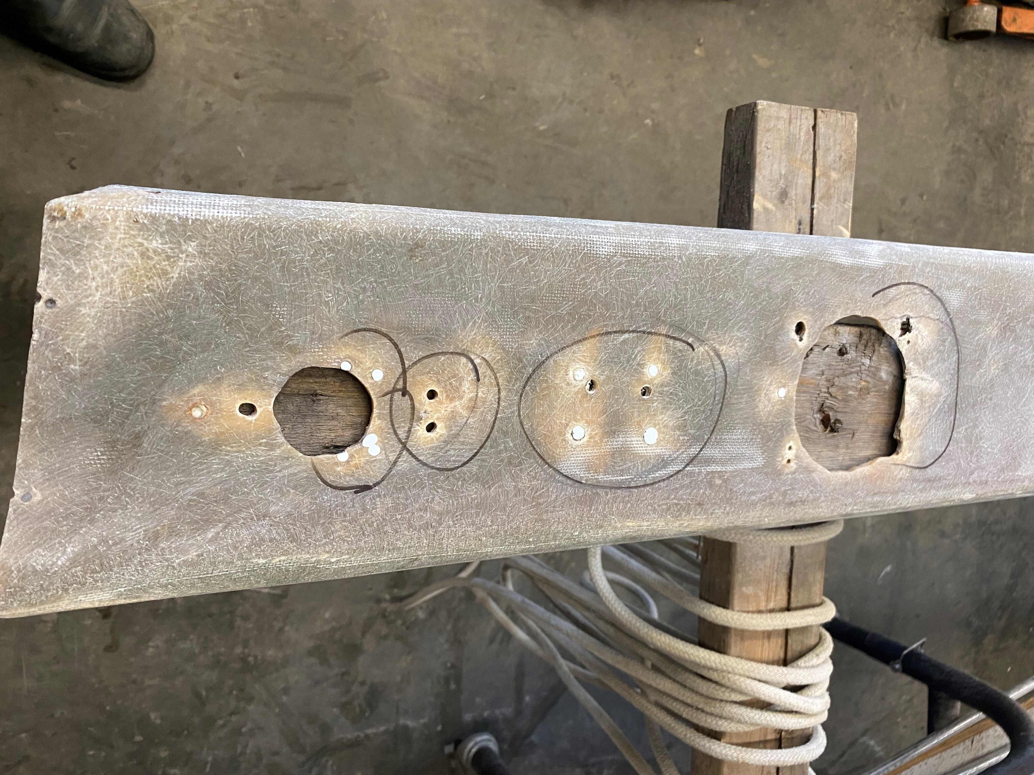

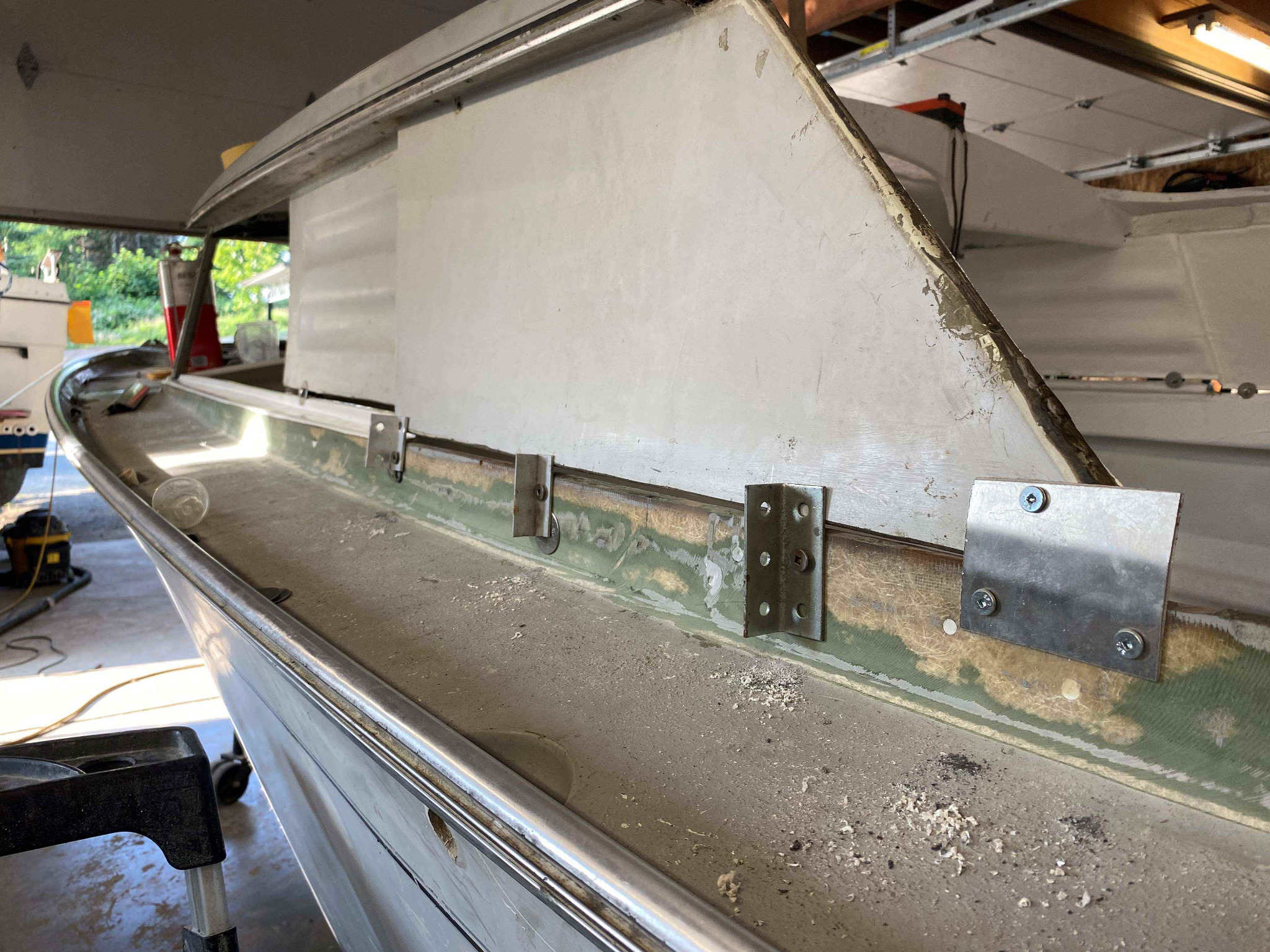

This is where the project started: A full teardown, but without the need to cut open the floor. The top deck did have to be removed to properly repair the catwalks and foredeck. After repairing dozens of holes and cracks we added fiberglass hollow beams for strength. Similar supports were added to the cabin roof. Any coring was done with Coosaboard.

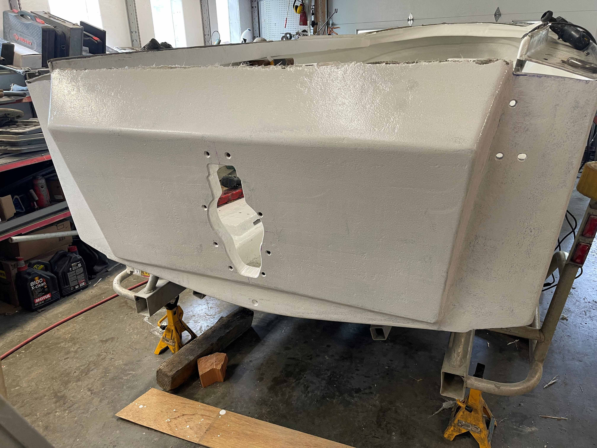

The transom was stripped down to the bare skin again, then rebuilt with three layers of 1/2" Coosaboard, plus joining layers of fiberglass in between. The transom height was increased to accommodate the Mercruiser outdrive. Final finishing was done with with a thinned gelcoat applied with HVLP spray. It turned out well, but will need a polish once all the work is done.
Mercruiser outdrive? Yes, that's what we decided on. It turns out Mercruiser offered a 1.7L turbo diesel, starting in the early 2000s. In north America, these were typically installed in the smaller bayliner 2052 trophy boats. They have mixed reviews because many end up overloaded and resulted in early failures from high EGT's (fastest way to kill a diesel). The trophies are rated at only 31 MPH top speed but they are also 3500lbs empty. Glasspar Sedans are about half that weight. I think you can see where I'm going with this. The total drive system tips the scales at 653lbs (engine and leg) empty. about twice the weight of the V4 it replaces. But with the weight shifted forward of the transom, the distribution isn't too bad.

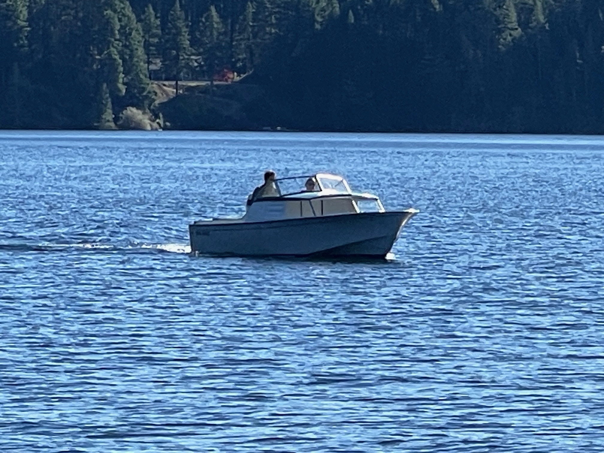

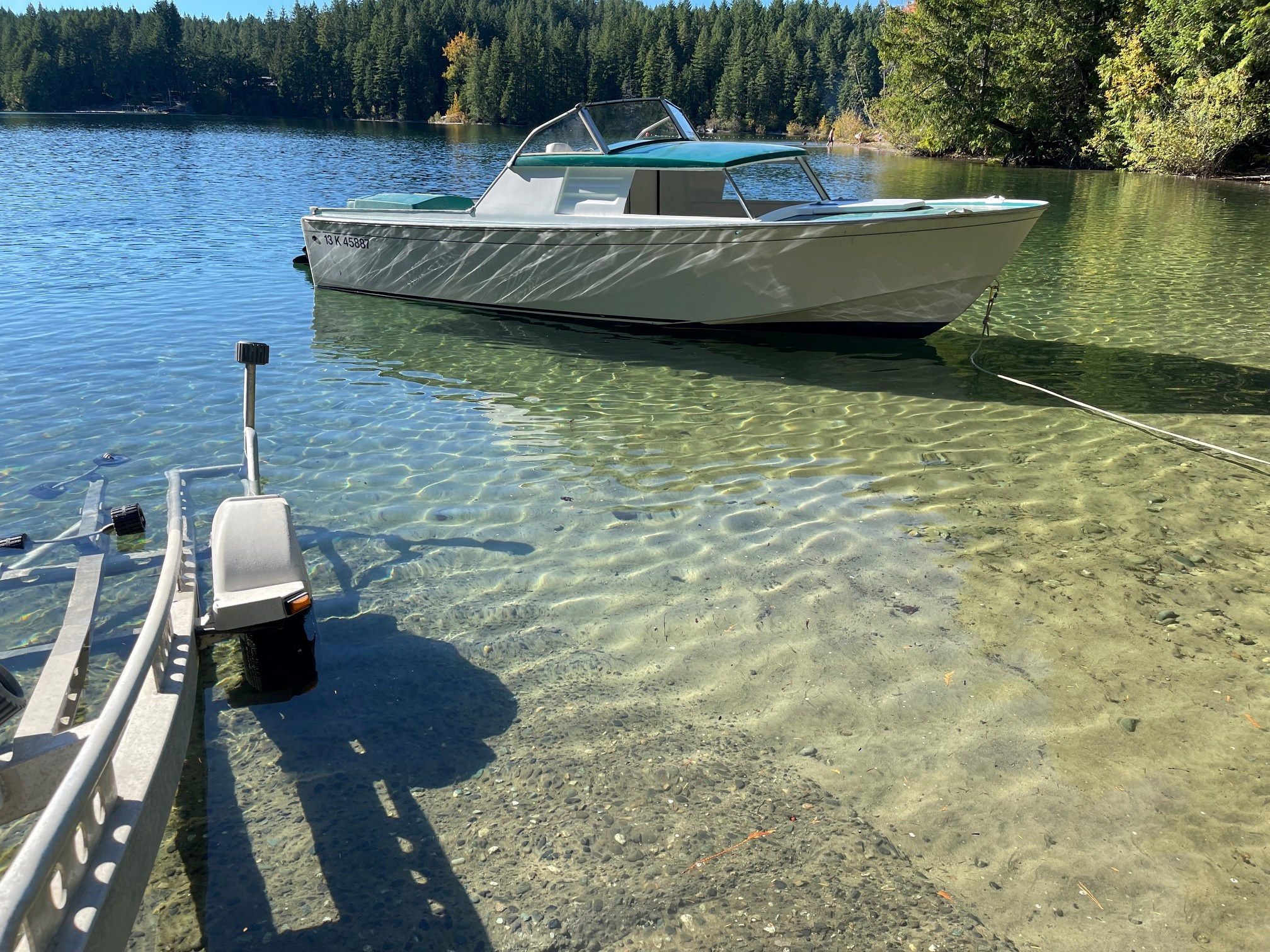

The boat isn't finished yet, but its close enough to start some shakedown runs. She's a bit tailheavy compared to before, but that was expected. The new fuel tank will going in the front to help balance things out. For now, we're running out of a jerry can.
Tried with, and without a wing on the leg. Seemed to make almost no difference. Top speed settled at 33mph without the wing. Not terrible, but not great. I was hoping for 40 MPH, based on all the research I did before going with this engine. 33 mph is the same top speed as with the Evinrude V4 2-stroke 90Hp.
Fast forward a couple days and I swapped the propeller from 15 x 17 to 14.25 x 19. Top speed increased to 37 MPH. Not too shabby but not quite 40.
Porpoising starts at anywhere other than the full bow down tilt position, so we might be looking for some trim tabs. The max engine speed is also still going above the peak HP RPM of 4400, even with more propeller pitch. So I'll be trying even more pitch on the prop. Pretty sure I can get the boat up to 40 MPH once everything is dialed in. The real goal is being able to plane below 3000 RPM for best fuel burn and range.

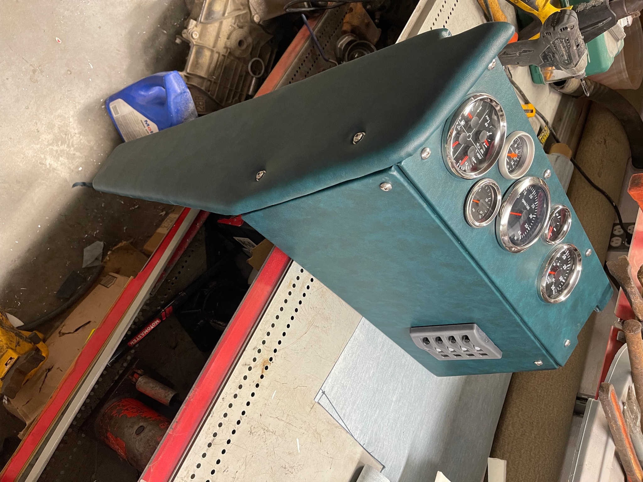

I have to be careful because over-propping and overloading killed many of these in the smaller bayliner trophy boats. This is why I monitor Exhaust Gas Temperature, and turbo boost pressure. Similar idea to the diesel truck tuners.

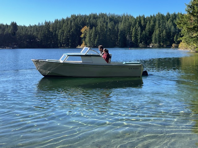

Glasspar Seafair Sedan rebuild (with diesel) 1 month 3 weeks ago #149543

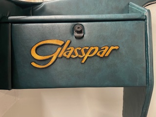

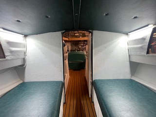

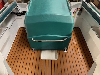

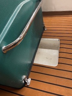

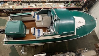

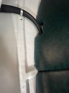

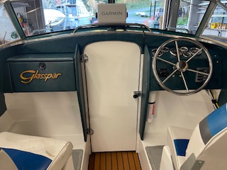

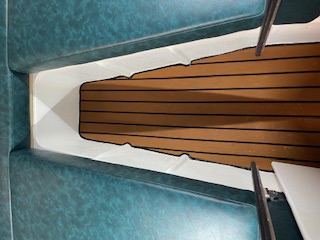

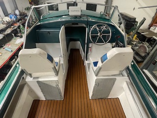

Late update, but here she is. Still some finishing touches to complete, but this boat is ready for summer. The front mounted fuel tank balanced everything nicely. Roughly 80L of diesel capacity with a range that might exceed 200 miles, based on what I'm seeing so far. Top seed was 39MPH with the biggest prop, but I've since put a lower pitch prop back on, to get better overall performance.

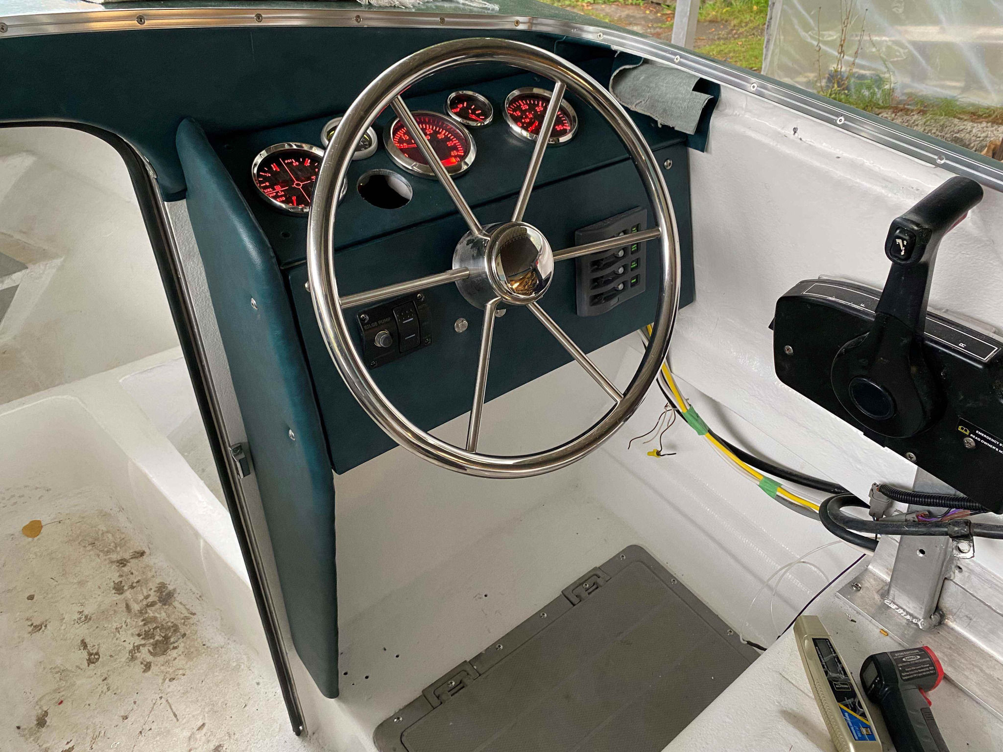

New interior bed, new nav system, and a reproduction badge I found online.
