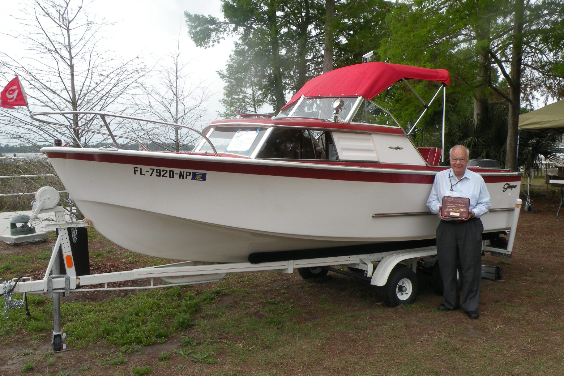

She may be my Mama Mia! long lost sister. Also a 59 Sedan survivor and is on original Mabley trailer from Maben MS which are common with Nashville Glasspars.

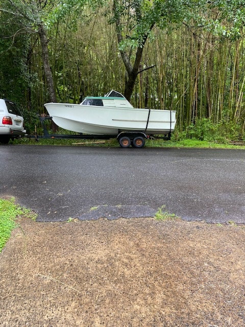

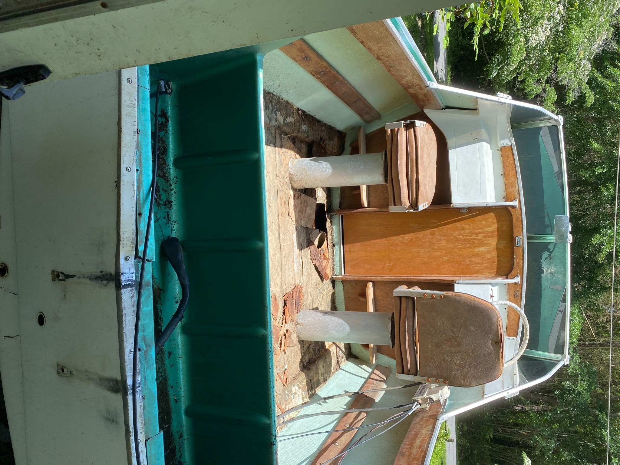

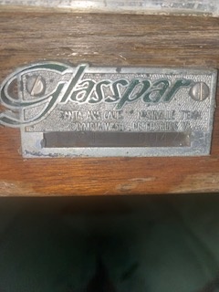

1959 Glasspar Seafair 6 months 4 weeks ago #149267
Terry, thank you for the warm welcome! I should've introduced myself better in my first post, my name is Christopher! Trust me, I'm very familiar with Mama Mia! and have spent more time than I'd like to admit looking at many threads and forums with pictures of it as a clue as to what goes where and also as a guiding inspiration. I might be mistaken, but I seem to recall your boat is a lower serial number than mine, so if anything I suppose they're cousins. My boat is hull #47. I have plenty more pictures, but they're going to start getting ugly quick as they dive deeper and deeper into the demolition and rebuilding of this thing thus far. I'm nearing the point where I'm ready to start the stringer replacement and have some questions regarding some of the stringer layout (mine are so rotted to the point that they've literally evaporated), but I'll make a separate post on this thread (and the many other small details that'll need going over).
Here's the data plate

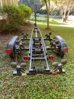

Another picture of the trailer

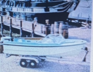

The ad with the near identical trailer

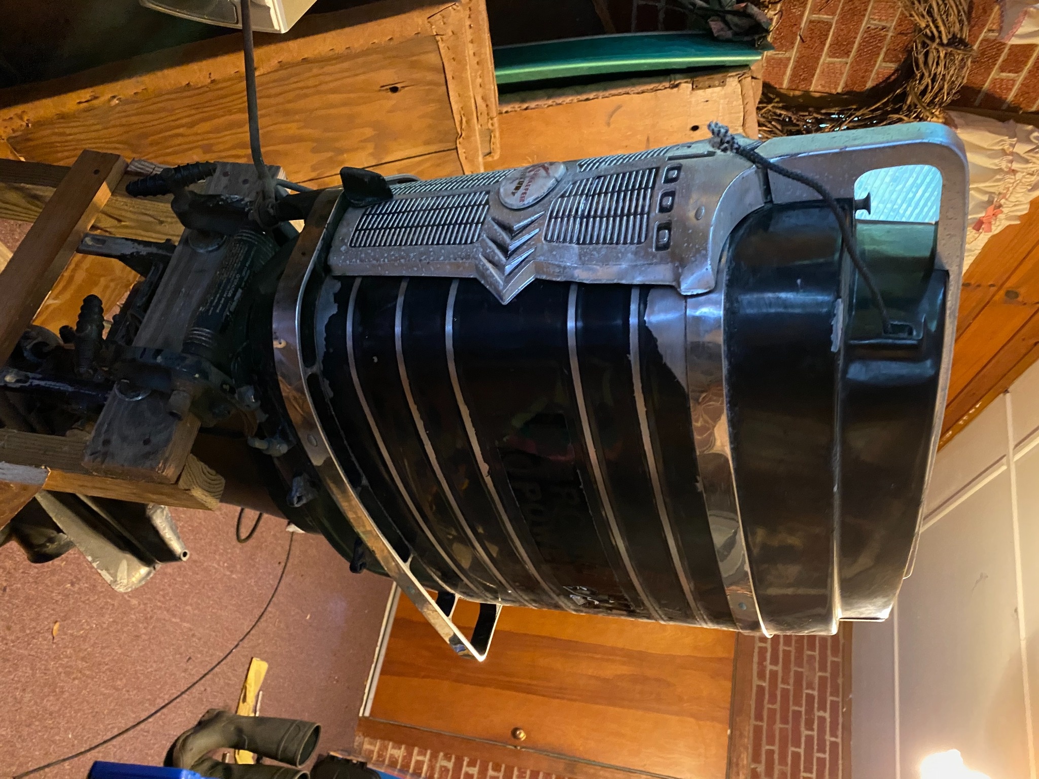

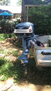

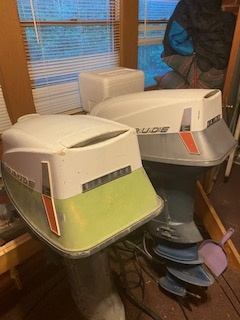

The replacement power for the Merc. I don't mean to offend any Merc fans here, I'm a big OMC fan (as my name would imply). Dual matching '63 40hp big twins that cost me very little. They'll get the standard works (impellers, carb kits, ignition, etc) and some fresh paint.

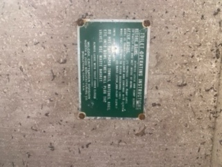

Wilcox instructions plate
Wilcox ports, but no head. If it had one on it at any point, its been gone for a rather long time. They need to be removed to replace the wood shims they're bolted through to, but I may just glass them up. The jury is out on that one until I get opinions back.

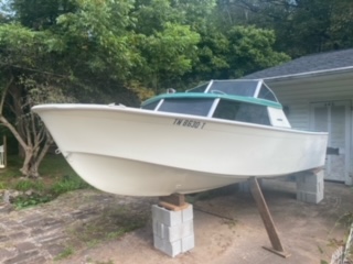

The boat on blocks leveled out.

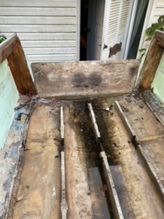

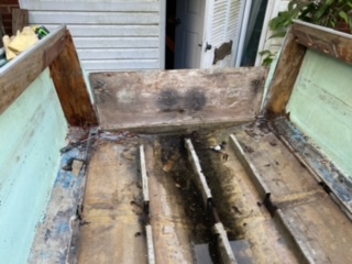

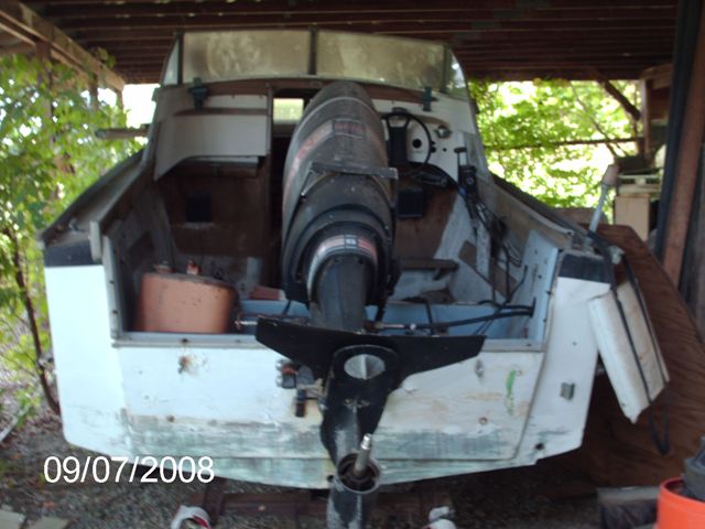

The gutting job so far
As you can tell this is certainly quite the project. The sad thing about it is you can tell that the boat was at one point a prized lake/river queen, and either through mechanical failure (the mercs lower was seized when I first removed it; pretty standard for these it seems like) or through health issues/lack of care, it was just parked to rot under a tarp and tree. Sad but that seems typical sometimes, several friends have had relatives/friends and neighbors who've left several classic boats and cars (Karmann Ghia, GTO, Chris Crafts, etc) to rot into the ground. The locker hatch and under seat areas were full of waxes, polishes, varnishes, accessories, flags, ski ropes, manuals, outboard parts, safety equipment. Also, sorry for any sideways photo's, I haven't yet figured out how to correct that here, but I will!

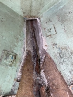

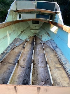

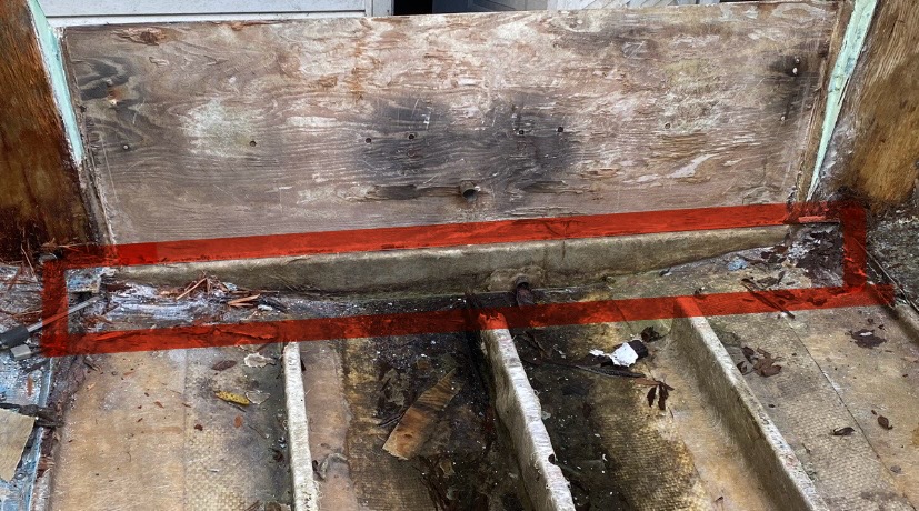

I had an opportunity to work briefly on the boat today. Using an oscillating tool I finished removing the core of the transom, particularly the smaller pieces that take up the port and starboard side outside of the cantilevered portion of the transom. I've seen rebuilds on various forums and resources where just the thick, cantilevered/main outboard bearing part of the transom on these boats is replaced, but these side pieces (only about 1/4 thick plywood by my measurements) were just as rotted and seem to be just as critical for structural integrity. I also finished cutting out the deck finally exposing the full length of the main stringer so that opens up my next steps which will include lots of grinding. I have seen on some claims before that the keel stringer only goes slightly beyond the cabin door threshold (which seemed odd to me that it wouldn't be longer), but it does in fact extend much further beyond the door.
I do have a few questions regarding in the replacement of the stringers though, or rather how they were originally laid out and how I should proceed. The stringers (as I'm sure most of you familiar with these boats knows) were just held in with thick chopped mat at intervals with the wood remaining un-glassed in between. In these sections void of fiberglass, several of them were square-notched with fairly small slats of wood spanning between the outer stringers and the main keel stringers, and it didn't appear that these slats were held in with nails or any glass.
My question is this: should I put the stringer system back in as near to factory as I can with these notches and cross sections, or should I just run the full length of the stringers without the notches and slats? I've seen one build with no slats, one build where the slats were put back in, and one build where the stringers were built using more modern methods using proper bulkheads, which is something I'm also considering, but I'd like to get a feel for what everyone thinks is the best move. My second question regarding the stringers is also somewhat related to the transom. I've seen several photos where, at the end of the stringers at the transom, there is a piece of dimensional lumber that spans the width of the bilge, with the bilge drain plug pipe going through this wood. On my boat, this piece of wood had either totally rotted away or never existed to begin with. There was a small square piece of wood with the drain pipe going through it, but again I can't say to whether or not that square of wood was all that was there originally, or the rotted remnants of a full board. If indeed a full board is supposed to be present no evidence of any fiberglassing exists either, which leads me to believe that if it was there, it was just sat down into the hull in between the stringers and transom in a similar fashion to the slats that span the stringers. Can anyone tell me if indeed this is supposed to be a full board just laid into the hull without any glass work, or if maybe the small square was all the was originally there on some of these boats?
I look forward to hearing some replies, progress on the boat is going to be stalled for a little while due to the deteriorating weather here in NC and other focuses, but I hope to have the rotted stringers (mostly just dirt at this point) cut out shortly which will be the next update!

Maybe an ill fated attempt at a transom knee? Are you planning on putting a tank in the floor? If not I'd personally keep the same layout and plywood construction, just to be easy. You may also be planning this already, but I'd remove and tab in the outer and inner stringers separately to maintain a bit more rigidity in the hull.

Thanks for pics but most are too tiny. Can be up to 1meg.
Never saw a Glasspar on that type trailer you have.
From first pic thought it could be a Mobley double axle.

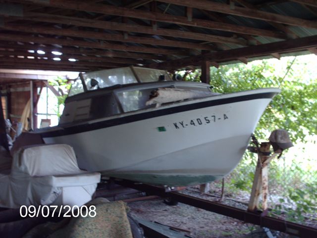

Another Nashville Sedan I saw at Lake Dora down in FL.

The presence of thru-hulls for seacocks and the plaque would suggest you definitely had a head at one point. Some guy on ebay has one of those toilet operating plaques for sale in terrible shape and he's asking like $500 for it LOL.

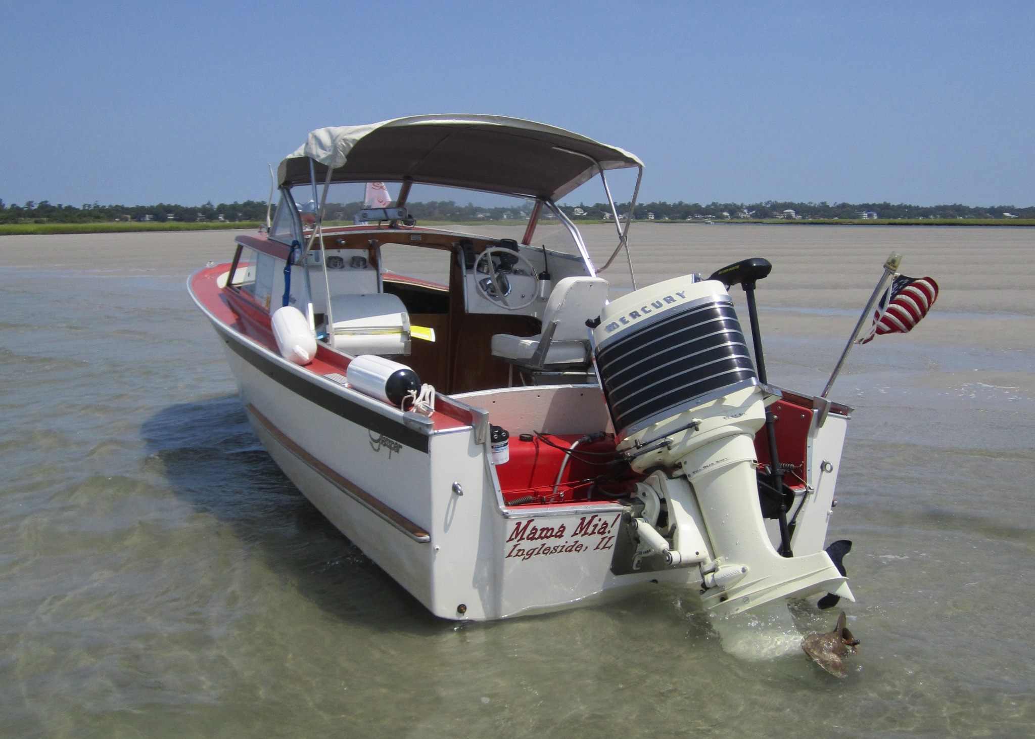

1959 Glasspar Seafair 5 months 3 weeks ago #149373
Hey Eric,

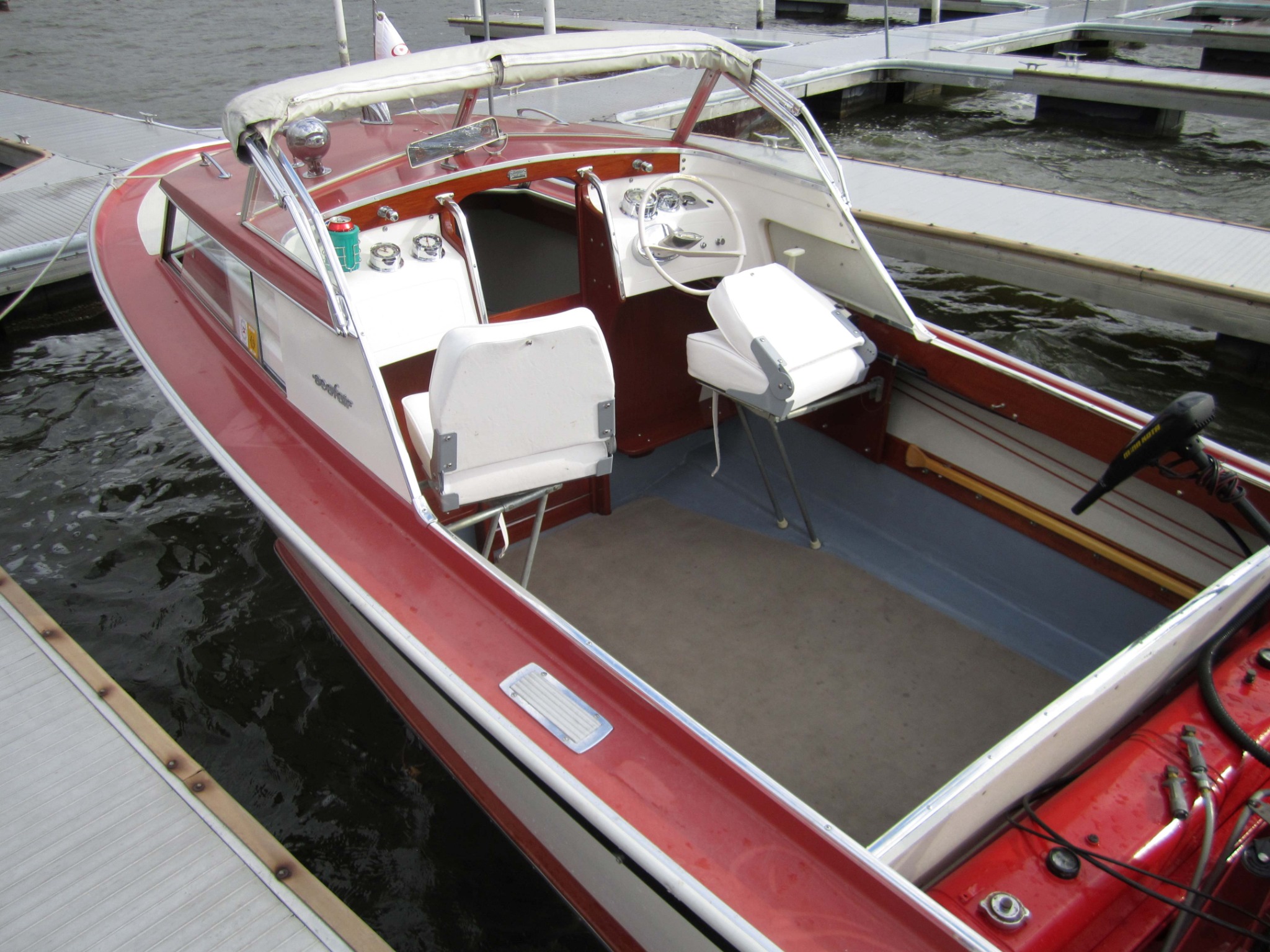

From FG library
I too noticed Chris’s Sedan had the Jervis Bow handle which was also used on the earlier Del Mars.
Notice the prototype here has the more common sectional handle.
Could be Nashville couldn’t get the part from the CA plant or they had a surplus of the Jervis handle.

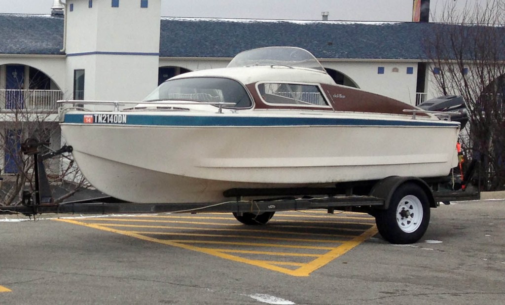

Mama Mia! on the Cumberland at Dover TN.
I was in Tennessee on the Cumberland River when I met a local who told me about Sedan tucked away in a barn.
Was able to find it and sure enough was a 59 outa Nashville.
Hard to see here but it also had the Jervis handles.
Thanks,
Terry

I don't want to start another thread about this so I'll just ask here...is there anyone who has the specific dimensions of the three stringers? I found an old thread where someone was putting in new stringers and a user Morris was able to send him the exact dinensions, but sadly neither Morris nor the original poster ever posted the measurements to the site which would have been a huge assist for all future early seafair owners!
Morris appears to be last active 7 years ago, so while I hope he merely fell out of the hobby, with many Fiberglassics owners getting on in years it makes me worry...
So does anyone have the measurements?

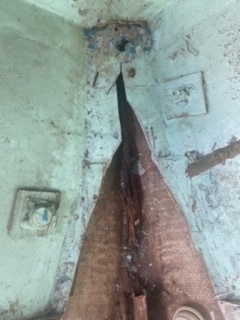

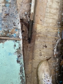

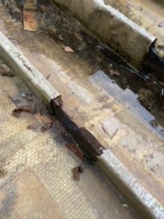

Again sorry for any delay in responding to this thread, the past few months have been challenging to say the least. My father unexpectedly passed away about a week before Christmas and I've had so much to do that the Glasspar has been so far back on the backburner I haven't even so much as looked at it hardly. What little free time I've had has been spent doing home projects for my mom when I've been in town, and I also inherited his MGB which has taken all of my spare money. At any rate, hopefully it'll warm up more in NC over the next few weeks to allow some additional work on the boat to commence. Until then I'll leave y'all with the much awaited stringer measurements and details.
I want to preface this by saying my stringers were/are totally rotted and these measurements and observations are more akin to an educated guess rather than scientific. My stringers seemed to be made out of fairly rough sawn douglas fir about an inch in width, similar to pallet material. The stringers were glassed to the hull using THICK matting only and only at varying intervals along the lengths of the stringers. I have seen several forums were people leave the cabin bulkhead/wall and the fiberglass tub that creates a footwell in the cabin in place to change the stringers out; in my boat that was not possible and the keel stringer goes FAR beyond the threshold/tub. In fact, as seen in previously posted photos, the keel stringer goes so far forward that I had to use a combination of tools (oscillating tool, dremel cut off wheels, etc) to cut the thick molded fiberglass at the front of the cabin just to get all of it out. Ironically, I forgot to grab my notes on the length of this stringer, but it is somewhere in the 12-13 foot length (I'll post an update with the exact length I measured when I get my notes). Starting at the STERN of the boat, I measured the height of the stringer where possible (IE rot hadn't taken all of the stringer); be warned Glasspar layed the resin on super thick in my boat, like they just dumped it in. I'm adding 1/4 inch or so to these measurements to give myself some adjusting room to account for this/the rot on the new stringers. 1FT: 4 7/8 inch; 2FT: 4 7/8 inch; 3FT: N/A; 4FT: 5 5/8 inch; 5FT: N/A; 6FT: 5 7/8 inch; 7FT: 6 inch; 8FT: 5 1/8 inch; 9FT: 4 3/4; 10FT: 3 3/4 inch; 11FT: 2 1/2 inch. From the 11ft mark forward the stringer was either A: so rotted it couldn't be measured AT ALL or B: the hull shape wouldn't allow for any tape or ruler to fit low enough on the stringer for it to matter. However, it follows a linear decrease from this point forward until it's about 1/2 inch thick.
The port and starboard stringers were close enough in measurement that it really is a negligible amount. I estimate them to be somewhere around 6-7 feet in length, however passed by cabin bulkhead they were rotted so bad that they literally had disappeared. I did note though that the port stringer was obviously a bit longer than the starboard stringer from the stain left behind, however, no stringer (including the keel stringer) had any structural glass beyond the cabin bulkhead, so I suppose in practice it really wouldn't matter. Also, I measured these stringers from the taller side (closer to the keel) of the stringer. Again starting from the stern going forward every foot the stringers measure as follows: 1FT: 3 1/4 inch; 2FT: 3 1/8 inch; 3FT: 3 inch; 4FT: 3 inch; 5FT: N/A; 6FT: 2 1/4 inch. Again, from this point forward it looks like it follows a fairly linear regression until it tapers off to probably around half an inch or so.
There are also two ADDITIONAL port and starboard stringers that I don't hardly ever see mentioned anywhere on any forum concerning the rot repair of these things. They are extremely, and I mean extremely small and poorly made and run right along the step in the hull where the floor attaches to the boat along its edges. In fact, that's really what these are is a floor support along the edges. They're encapsulated in fiberglass and are no more than an inch high and run from nearish the stern to about where the plywood floor starts to V in heading toward the cabin.
Lastly, there are some floor and transom supports that exist. If you read in previous posts in this thread you'll see me mention if any baseboard existed at the foot of the transom; I believe now one did, but it wasn't glassed in AT ALL. It was just a piece of lumber, probably scrap stringer material, jammed between the stringers and the transom. I've come to this conclusion based on some photos I was presented and researched of some very nice original stringers, but this board had nearly disintegrated because it sits at the lowest point of the hull, with zero protection, with the drain plug running through it. The other floor supports are really nothing special; they're absolutely not as integral to strength as modern practices and design are and consist of square grooves chiseled into the stringers with slats spanning them in two (or maybe three places). I say maybe three places because I have seen SOME photos where one of these slots were chiseled at the very back of all three stringers right where the transom baseboard is at; I do not know if my boat was like this because it's all rotted away. However, the other two slots for sure existed on mine, and are located 31 inches from the stern going forward, and again at 93 inches going from stern to bow. These slots are 2 1/2 inches wide and appear to me to have been chiseled in AFTER the stringers were glassed down. Again, these slots were bridged with poorly fitting wood slats, nailed down to all three main stringers with framing nails. One slat was covered in fiberglass resin and matting, the other was totally bare. These slat boards actually survived fairly well and were very roughly sawn and very loose fitting.
In short, your boat will probably vary wildly from my measurements. These stringers, the way that they were cut, measured, attached, etc, etc, in a way that very much reminds me of my parents house that was build in the 1950s; rough sawn lumber, heavy doug fir/pine, and compared to modern techniques a little looser in tolerances. Let me know if anyone else has any measurements or comments about the one's I've made!

Thank you so much for your notes on the stringers....the measurements will no doubt come in handy when the time comes. Yes, it is surprising to see how slipshod some of the work was originally on these boats. My floor is removed and what little stringer remains that isn't rotted away also has those massive matting tabs in a few areas holding the stringers in. They aren't even lined up straight. But as far as the thickness of the glass and resin, I've read that these early fiberglass hulls are a good deal thicker than they need to be as the builders weren't quite sure yet just how much of this newfangled product they needed to use. They tended to err on the side of caution and overbuild them. I'll take it.
There is this phenomenal youtuber Fishbumptv IIRC who is an absolute master of all things fiberglass boat building and he has thorough, in depth videos on just about everything...laying out stringers, bedding, fileting, glassing in, pouring and shaping flotation foam (this is important and something I will certainly be adding) it's truly a blessing for any of us that this guy gives this education away so freely. Highly suggest checking him out.
