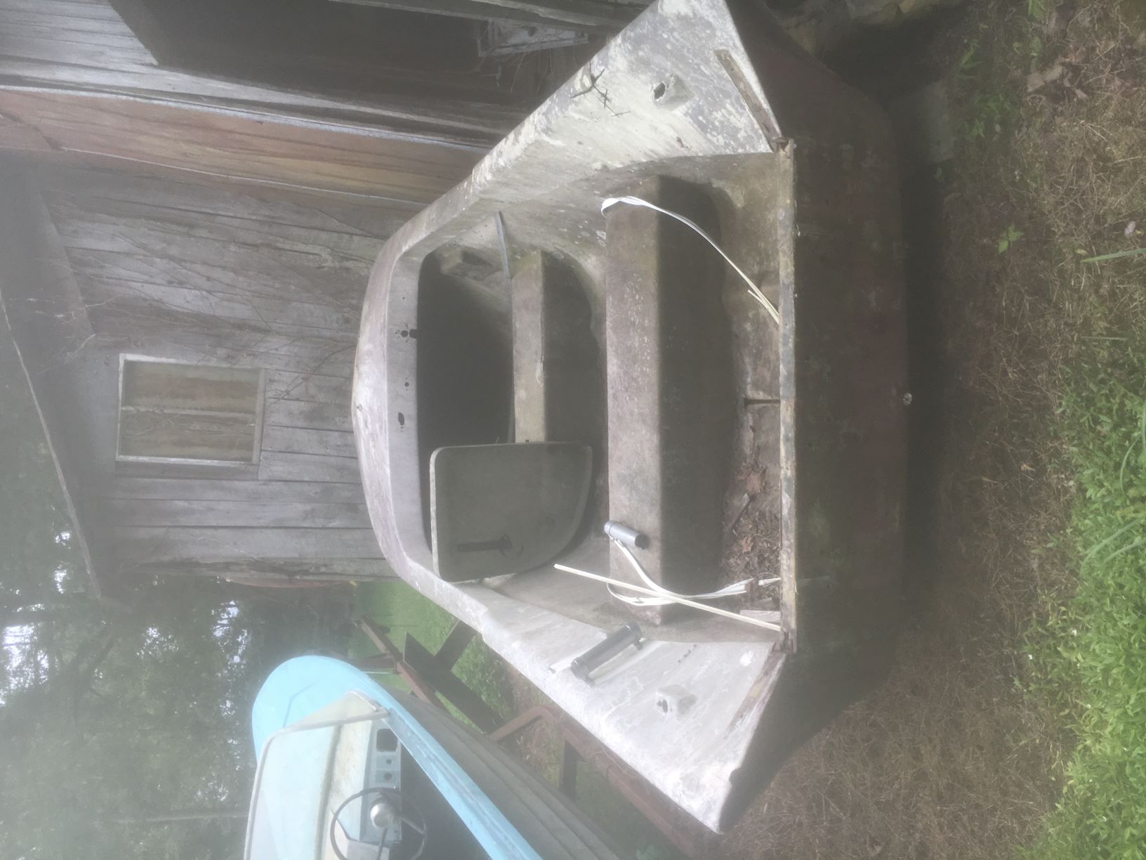

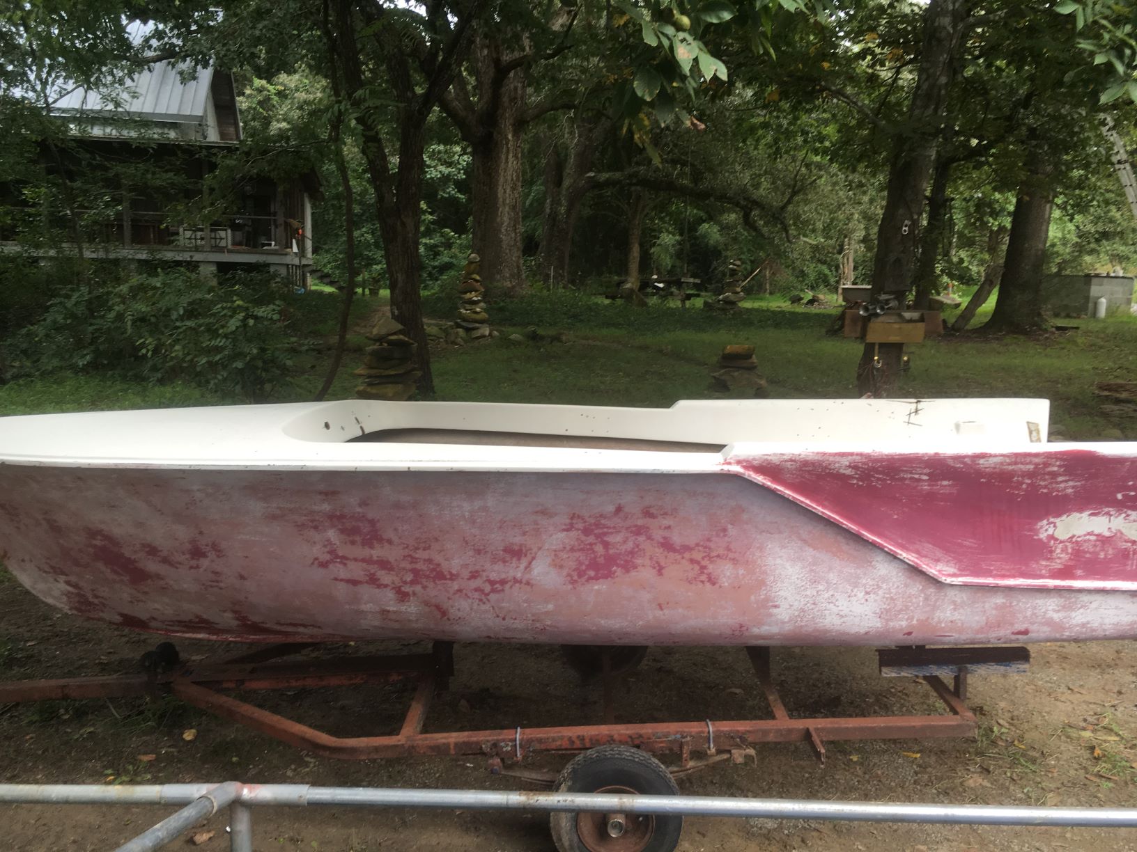

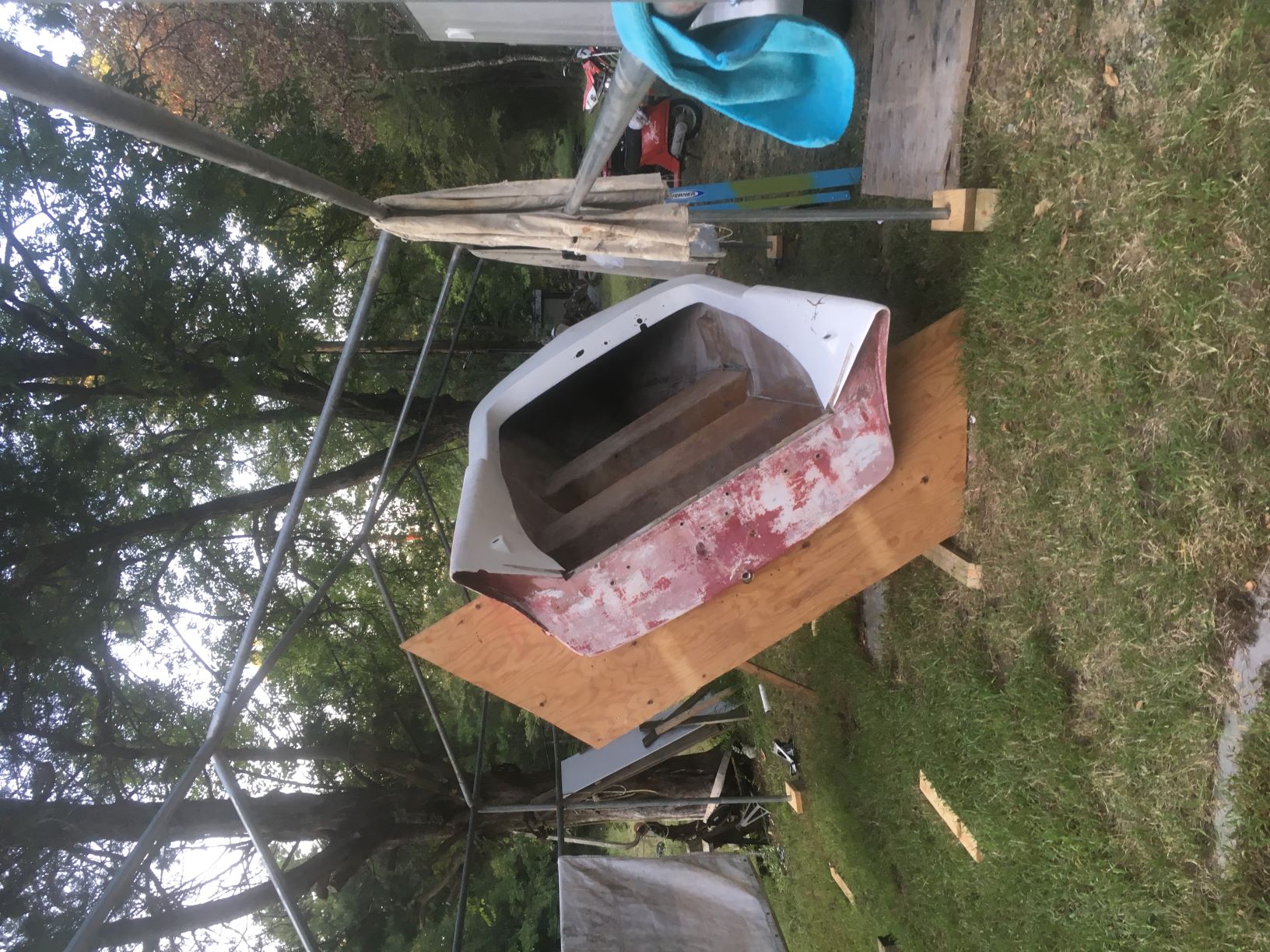

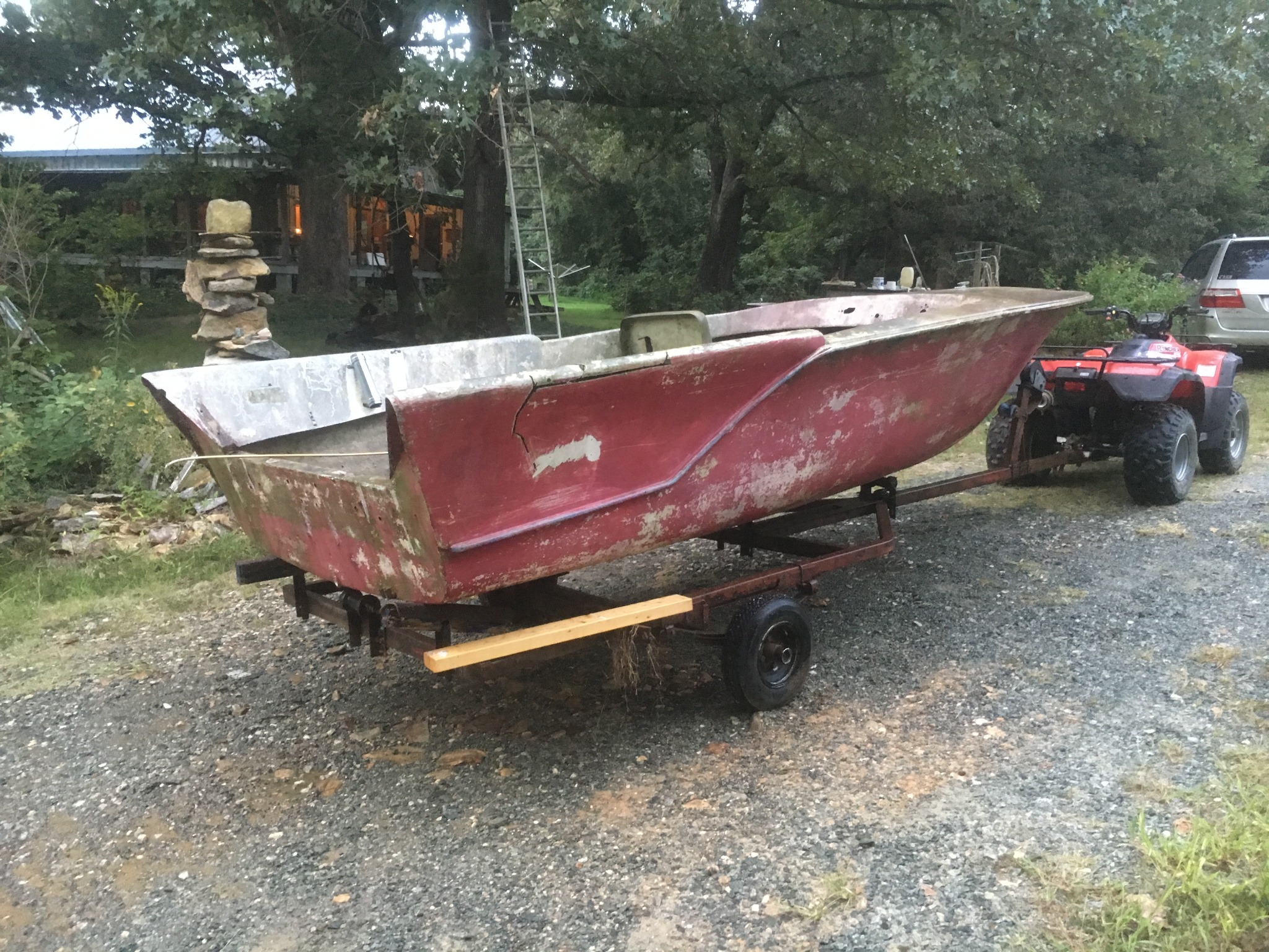

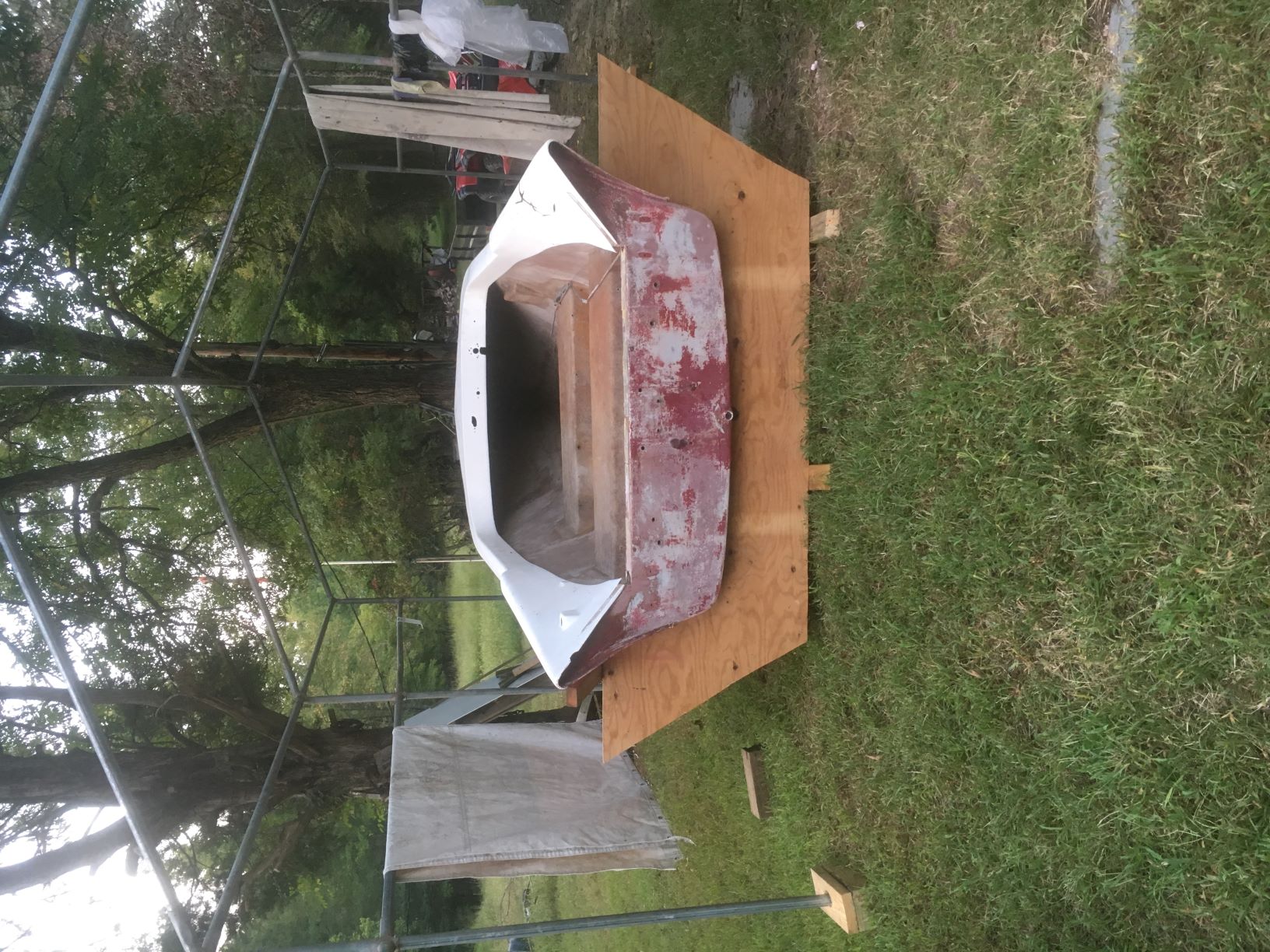

1957 Tomahawk resto 7 years 10 months ago #137760

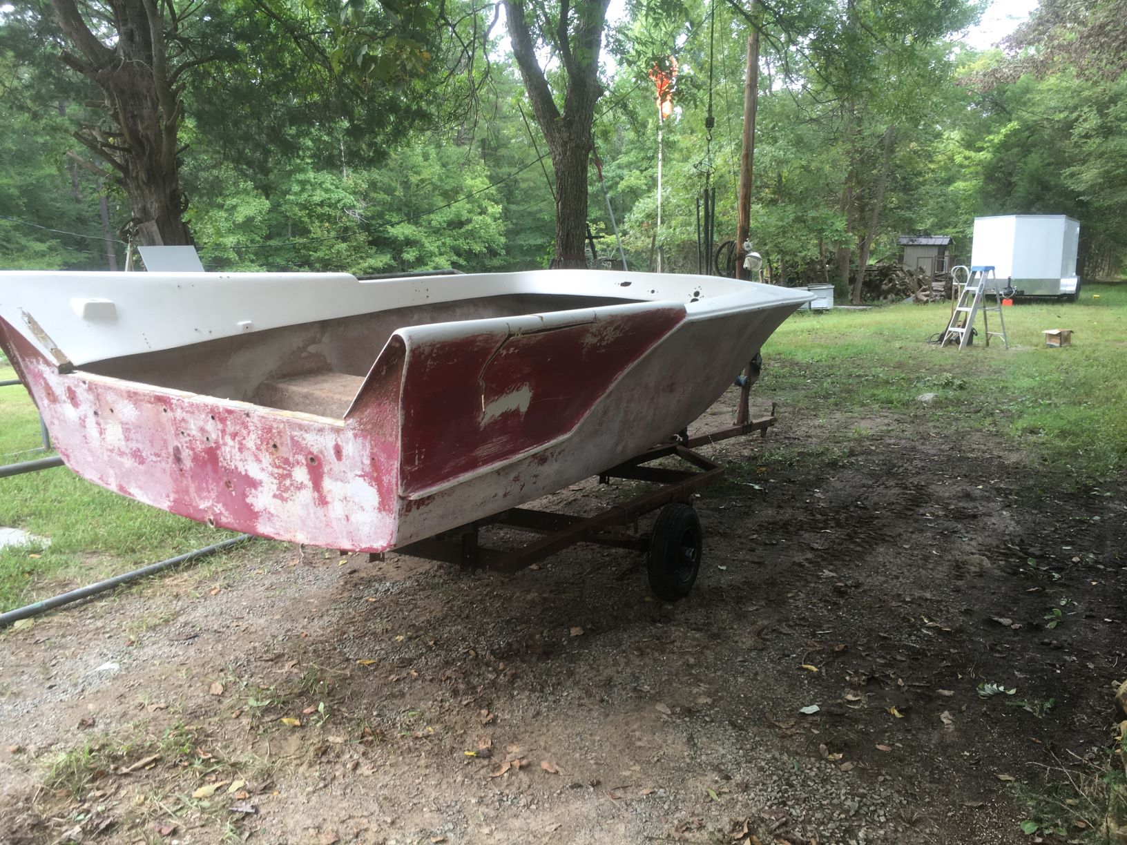

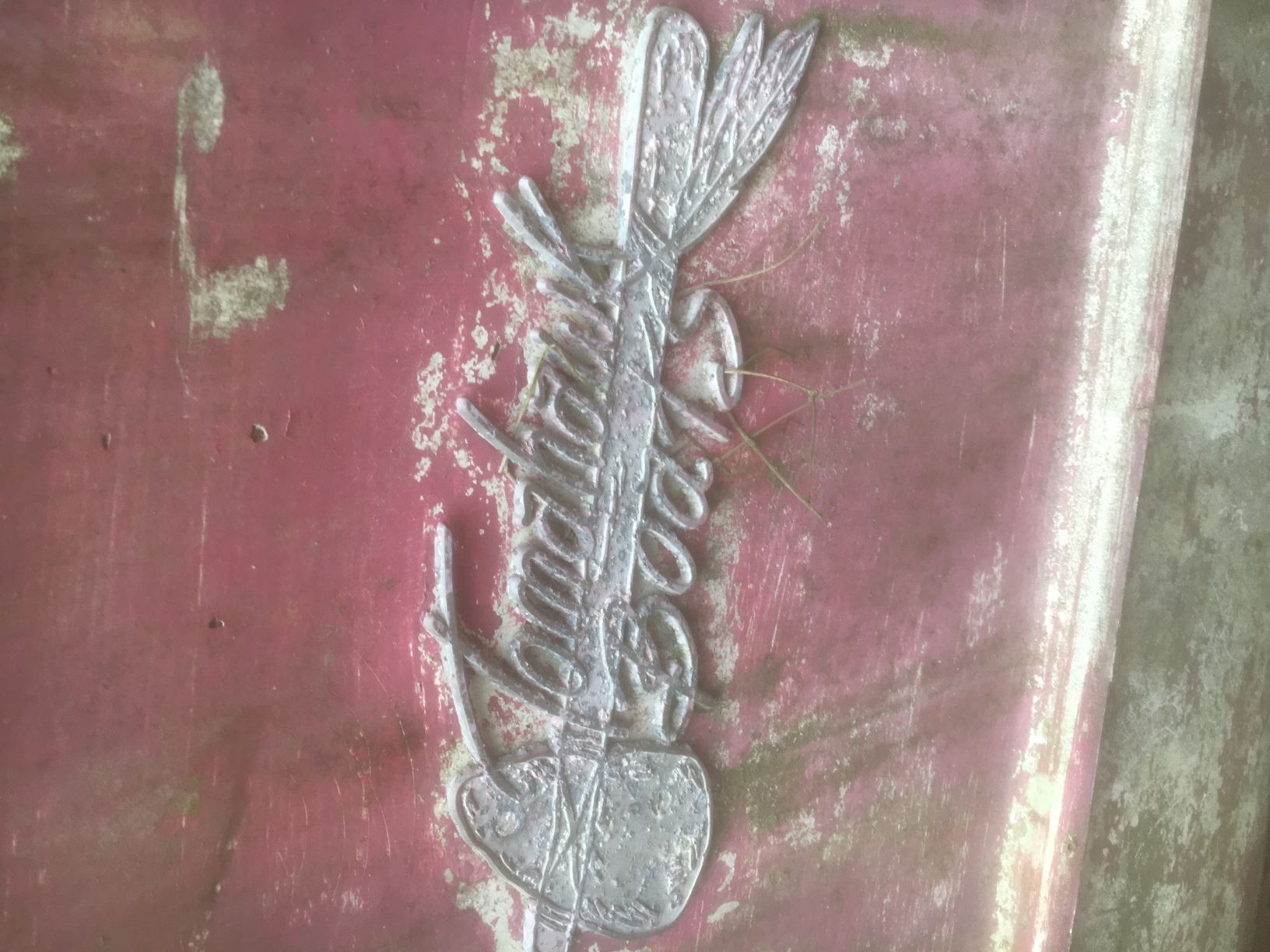

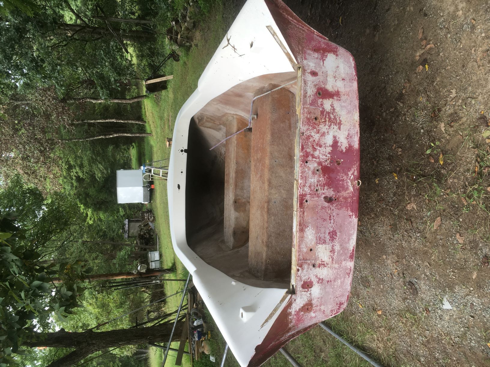

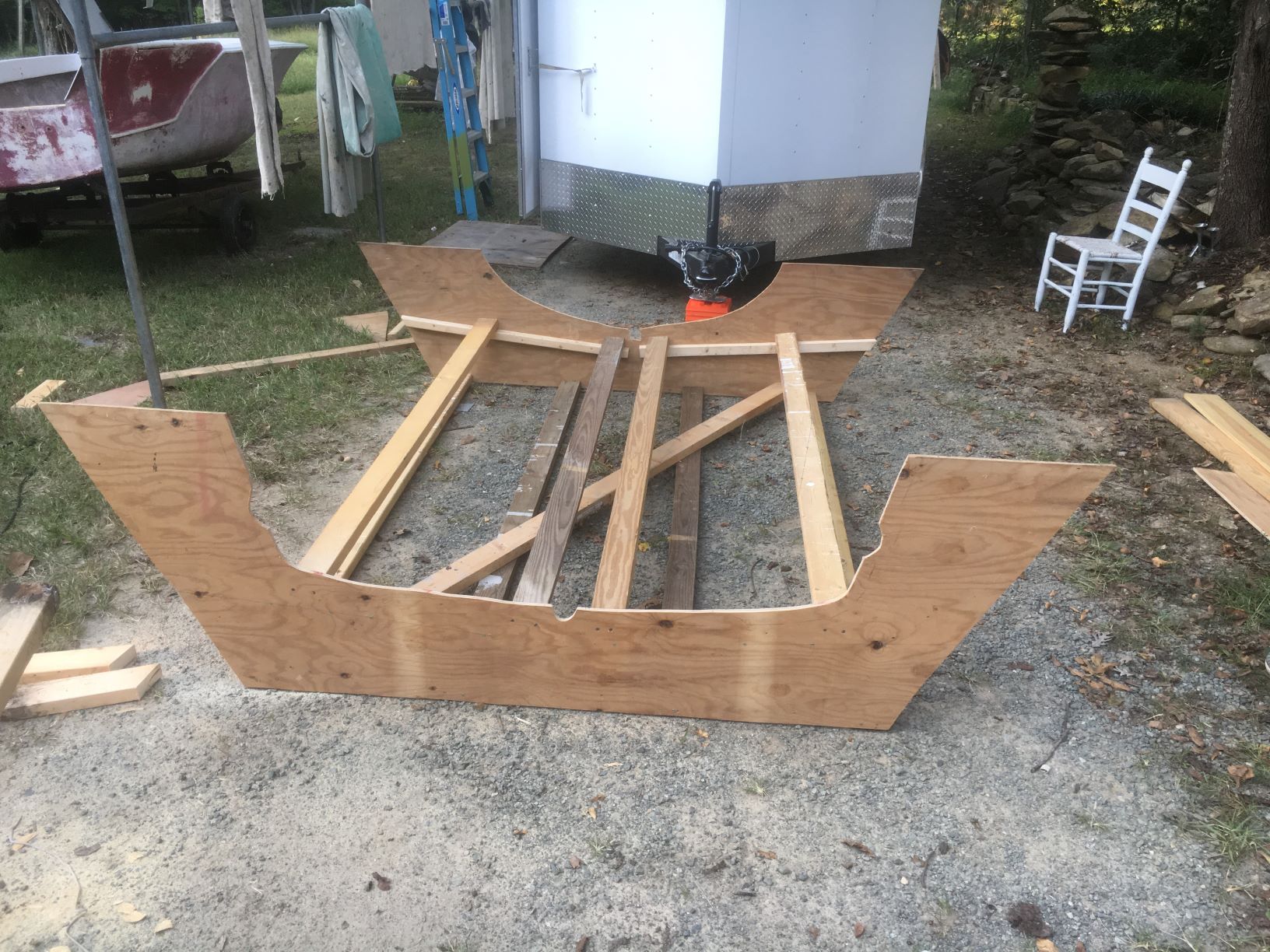

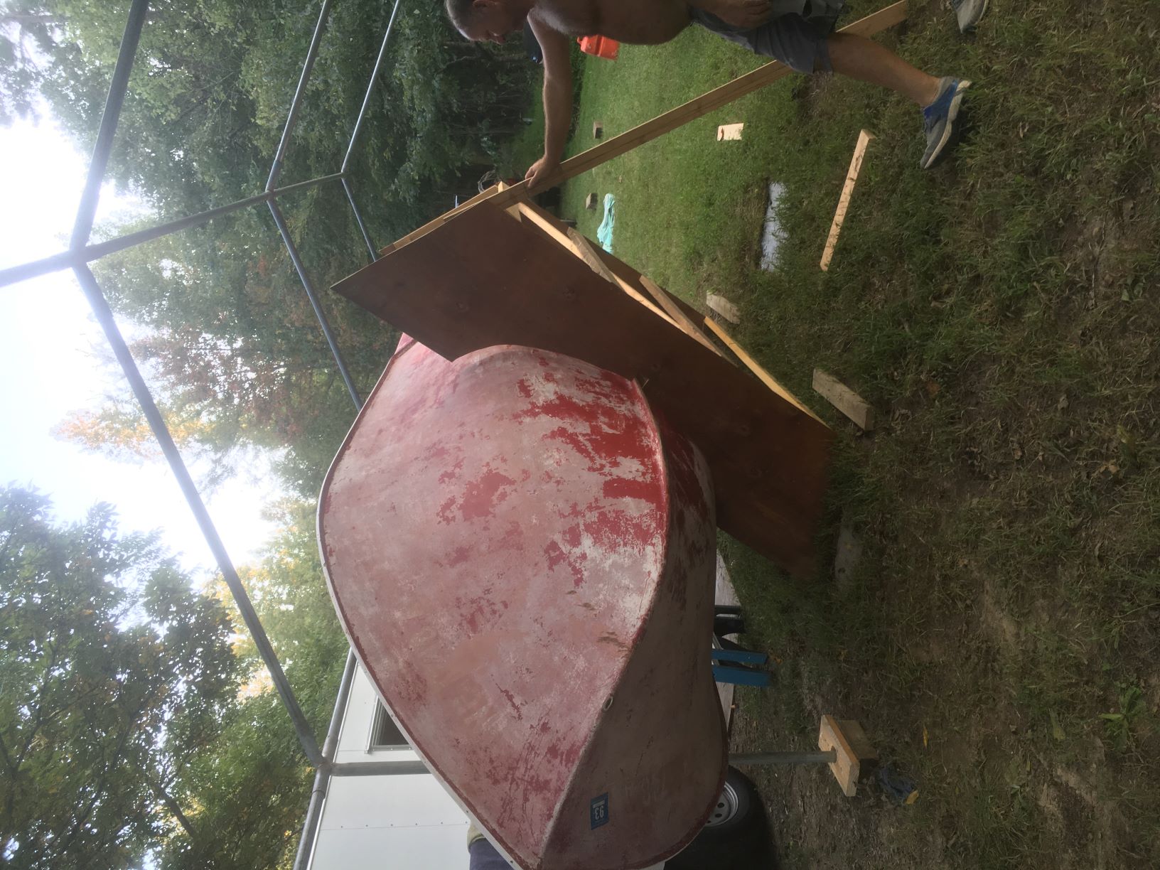

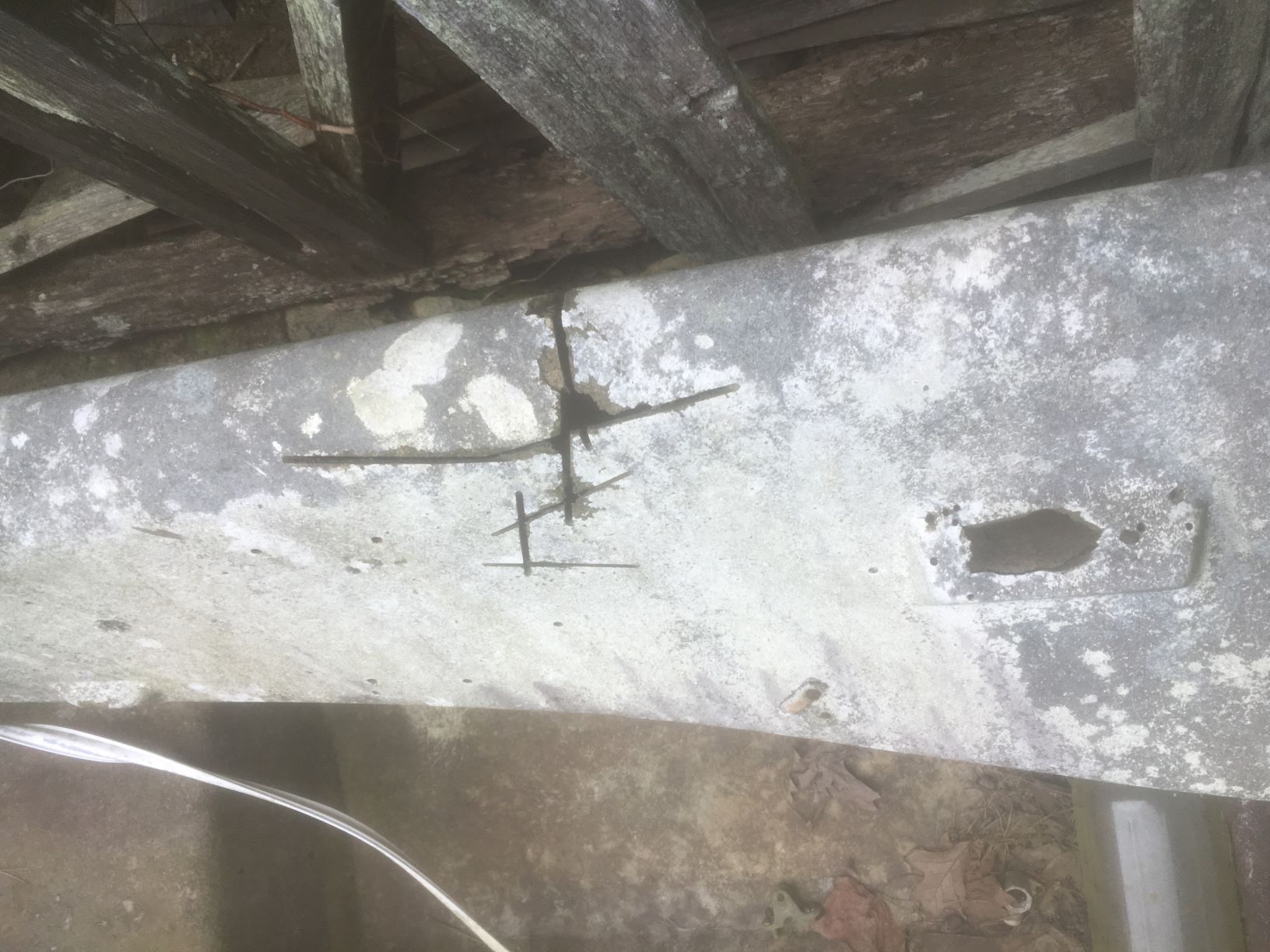

Just a few images of the process...
1957 Tomahawk resto 7 years 10 months ago #137761
time to clean her up
1957 Tomahawk resto 7 years 10 months ago #137764
sorry guys trying to figure out how to upload more than one image....
1957 Tomahawk resto 7 years 10 months ago #137777
more to come

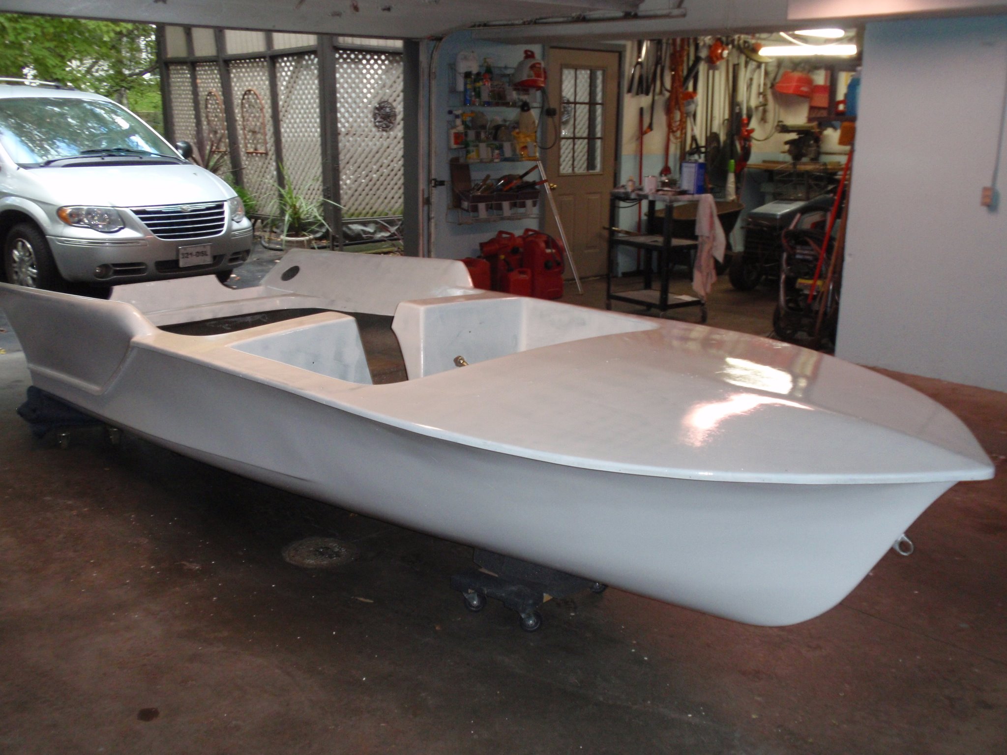

1957 Tomahawk resto 7 years 9 months ago #137823
Hooooo boy. You got yourself a project for sure.
I'm in the process of restoring my second Tomahawk. The first one was a "58. What do you have in mind for front seats?
I had to fabricate some using 3/4" galvanized conduit and a pipe bender. See the pictures. If you need to know how to, just ask,
The one I'm working on now is a '60 that has the nice front seat backs molded in.
PS. That's a 135hp Evinrude hanging on the back of the '58. Should see the looks on the new guys when I would blow by them with a 60yr old boat :evil:
Dr Go is in the background with his Admiral polishing the chrome, I'm standing on the dock watching :) B)

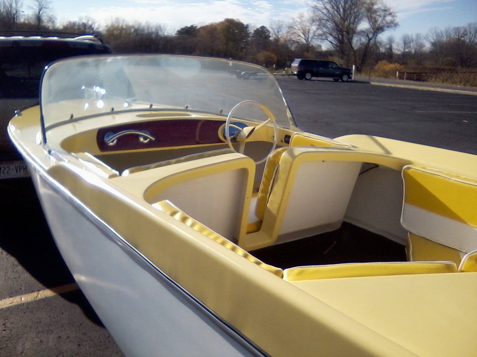

For the coral colored one I used a black stick on rub rail that is used in the auto body shops. Once it's on it does not come off! The company that it came from is called Trimco, based in Canada but sells to auto supply stores. I got mine through a local auto supplies store that sells paint and accessories.
I've used the moldings on several other boats. The chrome stuff is really great. I'll toss a picture of the chrome on my shell lake rocket. Here's a link to the company.
If you go to your local auto store they could probably order it for you. Goes for about $1 a foot, comes in 50 or 100 ft. rolls.
www.trimco.info/about-us/
You can use a heat gun on low setting to make it quite pliable to make the curves.
I also just purchased a 50ft. roll of chrome edge molding to go around the windshield and tail finn ends. It fits a 14" width perfect for those two applications.

The boat is set for a short shaft motor. If you plan on using an older motor you should be good otherwise you'll have to raise the transom about 5". If you look at my pics you can see that I did just that. Ancient Chinese secret how to do that and make it strong enough to handle some serious weight and HP.
Pay no attention to the steel rebar that is drilled over 6" through the new addition and another 6" into the old transom ;)
