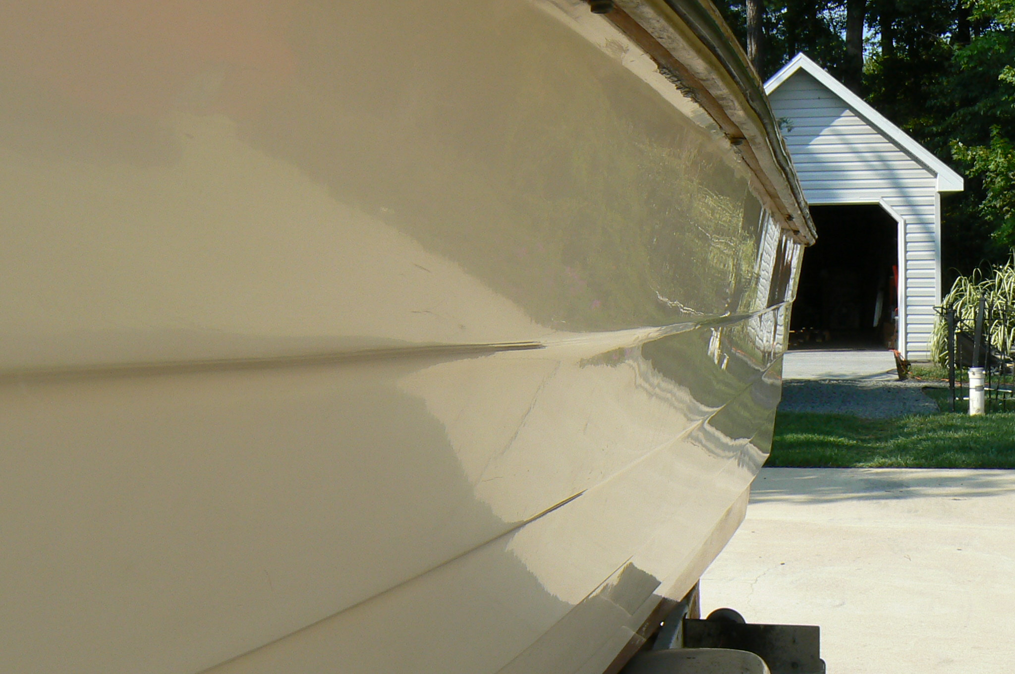

Well not to burst anyones bible but you can try all the different solvents you want but they are really only temp fixes, more or less. Yes I am of the old school elf grease method. My '60 Wagemaker was extremely oxidized and I did the wet sand method starting at 400 but I had pretty thick gel coat. Worked up to 2000 grit, then rubbing compound then polishing compound and a good wax job. Been that way for over 6 years now. Here is a before and after.

Thanks for all the tips and suggestions. There probably is no short cut for the old fashion elbow grease method, which I am running out of! Maybe I can find some at napa along with a can of some napa know how. I might try and tackle it this winter and see how it goes. As far as the "old guy" moniker goes it just came to me when I registered without much thinking, funny thing though a friend of mine calls me old man even though he is 4 years older than me.
