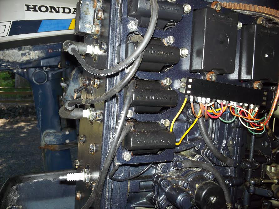

Got the same things one my Harleys. This the one here if off my 125 force, holds the electrical panel power packs, 4 coils on the block. Replacing #3 bad coil. One of 4. I'm thinking polish it up, as the block. Then what adhesive? JB weld? 2 parts epoxy" Thanks.. pic..

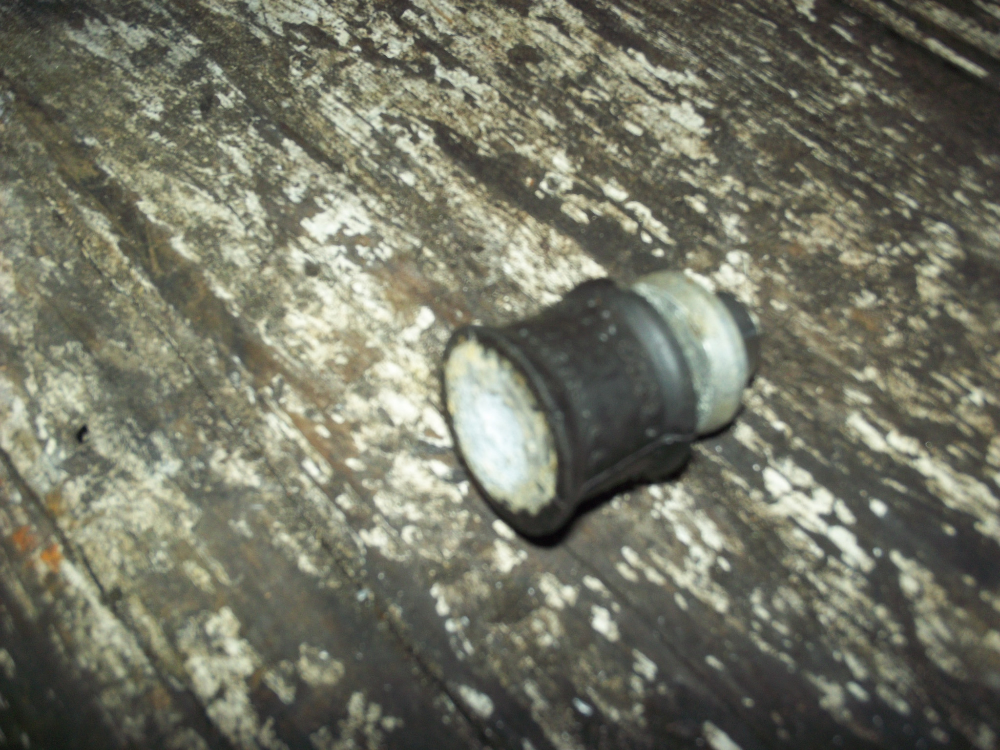

Should have been more clear on this. What happened is salt corrosion. The plate still attached the rubber, but the bolt broke off in the tab the head. I cleaned up the rubber plate shiny (rough it up next), next clean up the head tab. After replacing a bad coil, I'll put in back on the plate (2 more the plate) then do JB (metal to metal) and slam it home and hope. About all I can do.

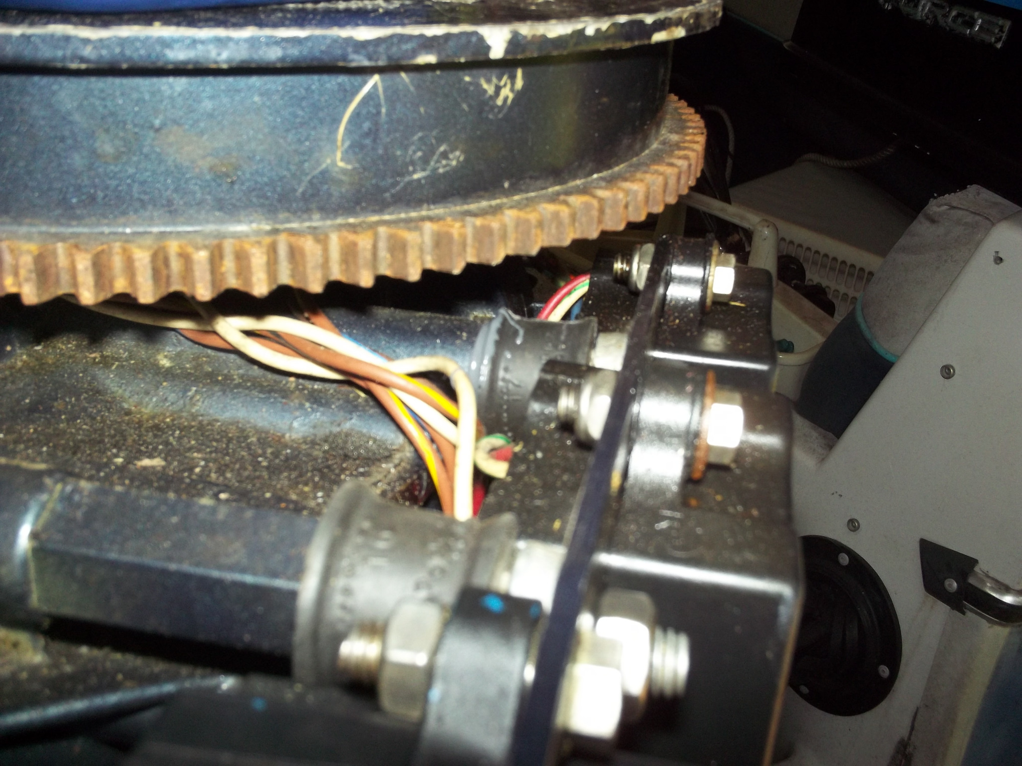

I did the new coil yesterday (well, used as parts getting NLA now). Put JB on the rubber plate, on the tab, and slammed it home. Bungee over it and let cure. I'll know today if held (it was after holding it on 10 minutes) and take some pix it if visible as under the flywheel kinda.

Oh, heres some pic of the plate. You can see the kicker with salt and aluminum. On the plate, the 2 nutted studs right of the top 2 coils are the other 2 rubber mounts. The broke one is above the power pack on the far right.

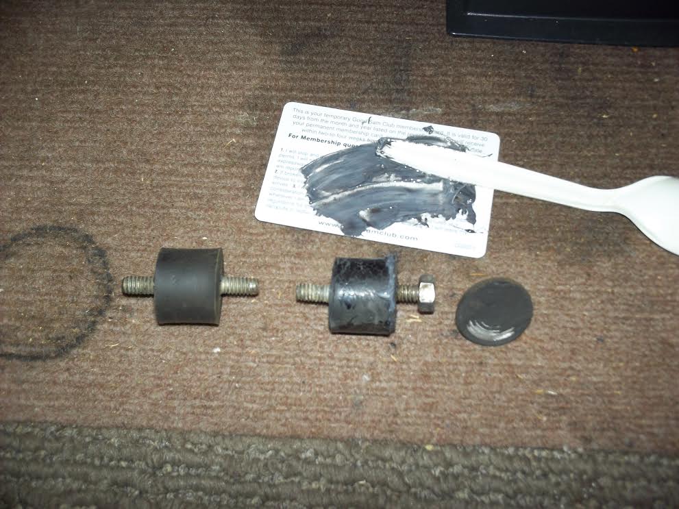

Well, its like a rock attached today, zero problem!. What done is in the the first pic. Just above the white wire. The next pic..(I'm a mad scientist) always experimenting what will work. These are off the HD, I (keep everything) had one good (left) and one middle that just JB'ed. What I did is one that separated with plate the rubber far right. In the vise to cure, so try and break it apart tomorrow.
Well, JB wont break off when try to separate in a vise. Holds fine and the rubber part pops out the vise so its works fine for this.
