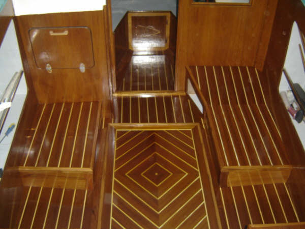

More San Juan pics, Commander on here did the resto, I just repowered her with a new Opti Max.
63 Farallon - too much? 9 years 1 week ago #131315
Beautiful boat! That floor is awesome! I would rather have a Catalina or San Juan anyway. Just tough to find one in Michigan that isn't a ground up resto.
