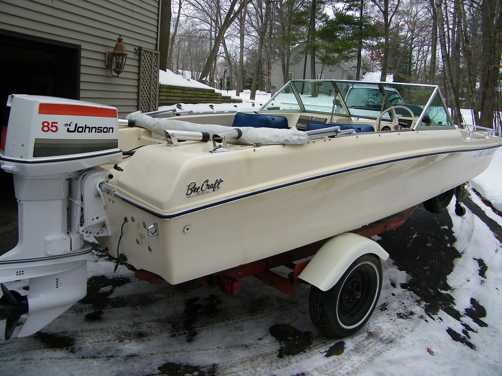

My Chaparral is basically a cathedral hull, and the factory trailer is pretty standard. It's a 15' boat with an 85HP 'Rude, and the trailer uses a small 2000lb rated axle with a 5 lug, 14" wheel. The older trailer design is pretty light weight and the boat loads with the outer chines over the wheels. It's got cheap keel rollers on frame-mounted brackets with 2 sets of 4' bunks - one wide at the rear and one narrower toward the front that I added. The only thing I'd watch for is clearance on the front of the bow-keel transition as the boat transitions on/off the trailer. Because the cathedral part hangs down further it might drag on trailers with rear cross bars that didn't have a roller.
