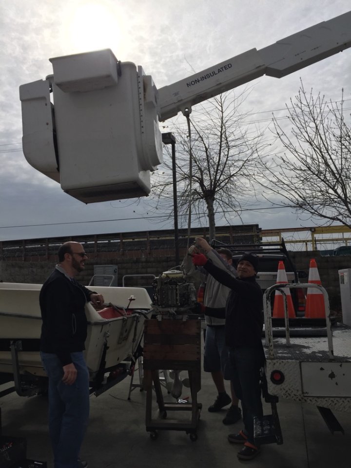

Thank you everyone for taking the time. Incidentally, here is the creative way we took off the old motor.
