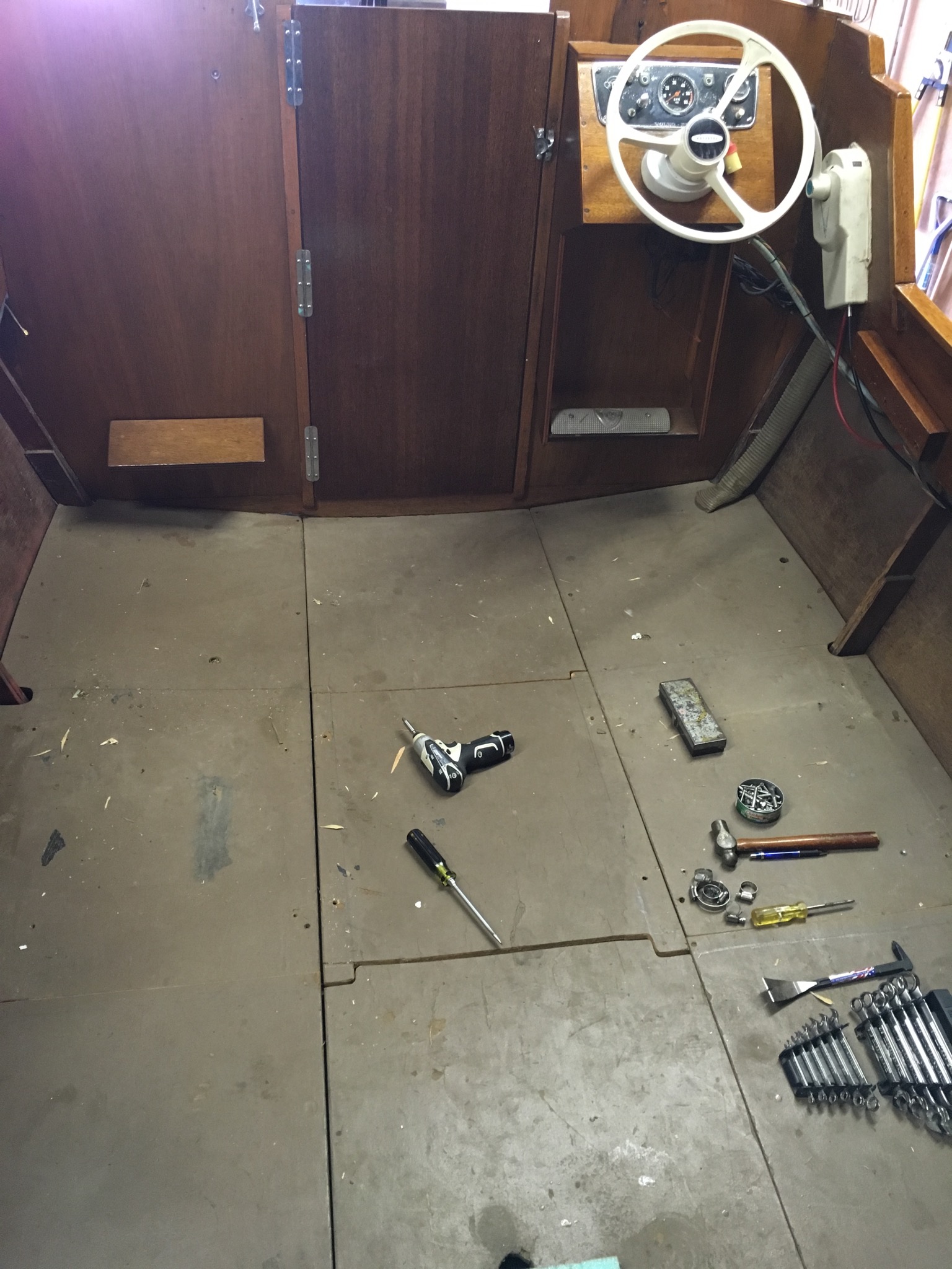

Who has experience with folding runabout seats? I have an older plywood cabin cruiser/runabout that has no seats, so I'm looking to add drivers and passengers seats. The remants of the old seat installation indicate the original design folded out of the way. There is a hole in the floorboard to receive a support post and a cleat where the hinge was located. It appears the seat flipped up inward (athwartships) and the outboard edge of the seat landed on the cleat, so the hinge wasn't bearing the weight of the seat. I'm guessing the support post flipped down from the bottom of the seat into the socket in the floorboard, while the backrest flipped up and was hinged along the bottom edge. There is a triangular block on the side deck coaming that I think the backrest must have rested against...maybe the inboard side had a chain or webbing to the seat bottom?
Are these type of seats too flimsy? Are they uncomfortable? I can't recall seeing too many seats set up this way, but it would be nice to have them fold out of the way when not in use. I'd love to see some pics of wooden runabout seats, I'm looking for ideas and options. I'd like to avoid using those aluminum seat posts that have a flanged mount to the floorboards.

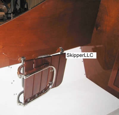

I found a few pictures of something similar...pretty cool seats.
20.5' 1966 ClipperCraft, 18' 1978 Olympic, and a 12' 1959 Elgin Car Top.

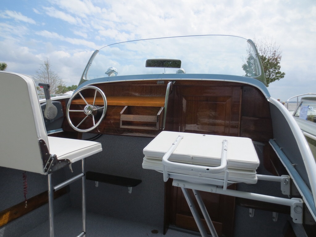

Hello Skagit,
Garelick has helmsman seats that are close to what was original on many early cruisers. I believe a swivel is also available.
www.garelick.com/Helmsman-Seating
Terry

Cool! That's kind of what I was thinking of. I hadn't considered the angle support but I think for rougher water I would be better served with a straight leg support.
In small boats like this where space is at a premium folding seats seem like a good idea, as long as they are functional and comfortable when in use.

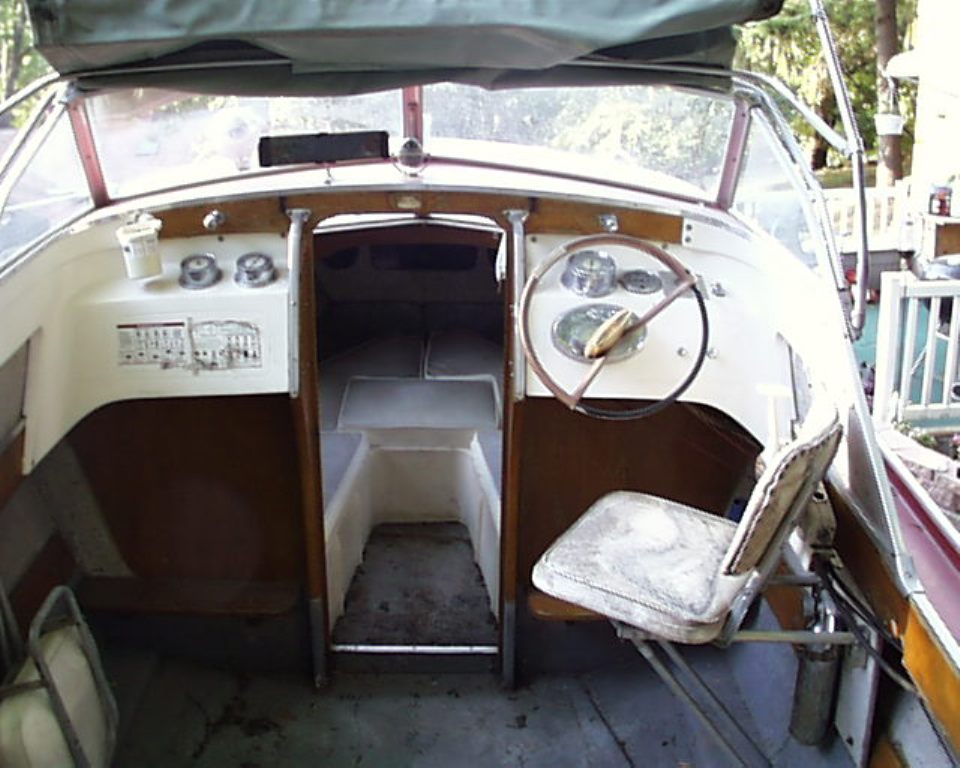

Here is a factory original helm seat in a 1959 Thompson Bros. 19 ft. Off-Shore Cabin Cruiser. The seat was made by Nelson A Taylor Co. of New York according to Pete Thompson
Garelick from St. Paul Park, MN makes several styles of helm seats
Andreas

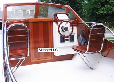

Here is a pretty sexy looking helm chair.
Probably not what you are looking for, but I'm keeping my eyes open for you.

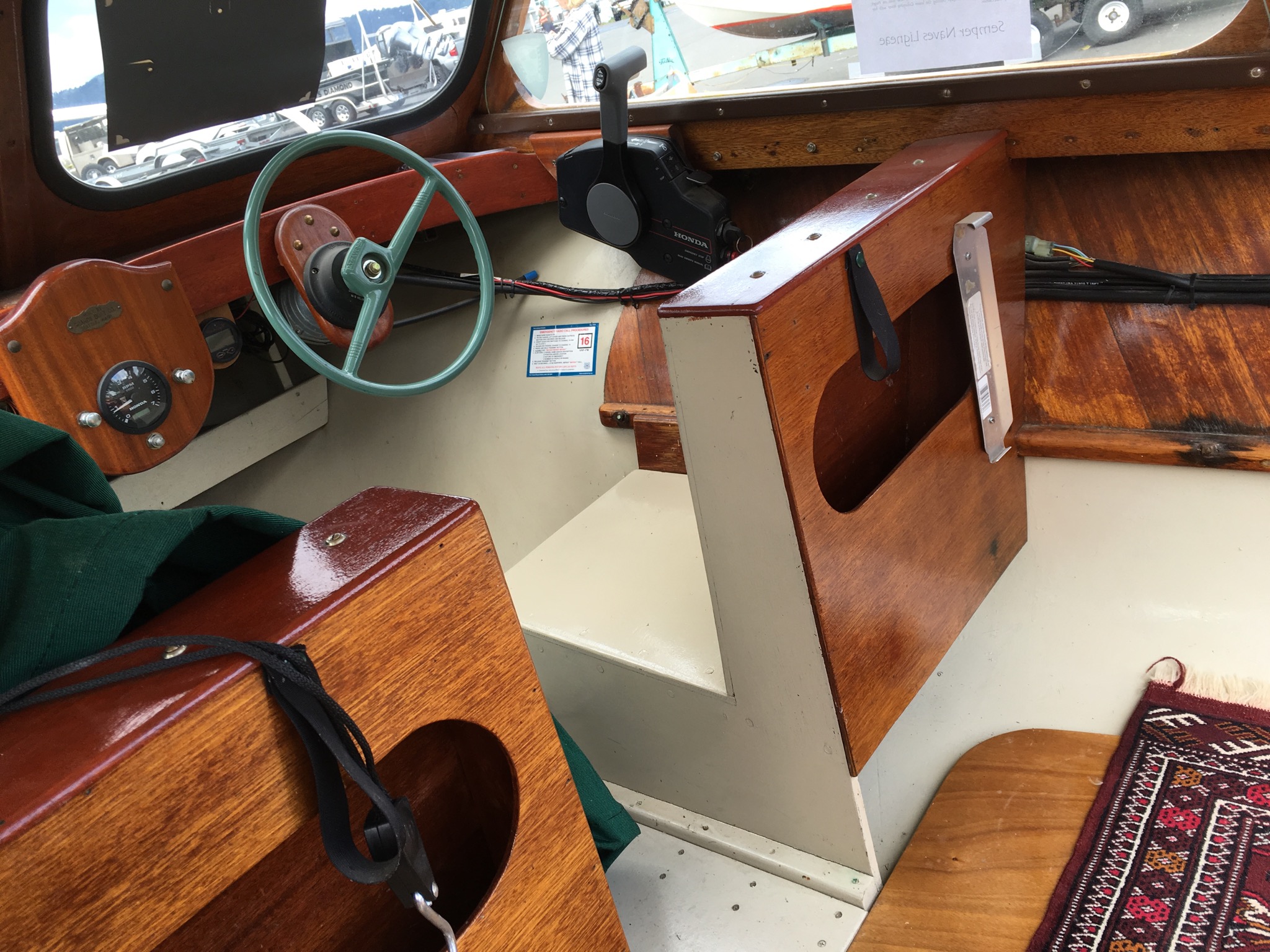

Thanks for posting! Awesome...I was thinking there would be more wooden seats but maybe wooden seats weren't very prevalent.
I'll be mocking up some seats but I may opt for those classic Garelick folders. Most of the wooden seats I see are of the permanent walk through style like this one.
