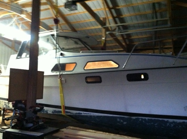

I found this Bayliner in Harlowton Mt last summer. It had been sitting in a barn for 6 years, previously owned in Portland Oregon. A survey was out of the question due to the location, so I tap tested the transom and the engine stringers, looked it over and decided it was worth a shot. It is a 26 ft long, single diesel, wieghs about 6000 lbs.
Since then I worked over the trailer, sanded the hull above and below the waterline and sprayed one coat of catylized polyurethane (as a primer), straightened out the bootstripe and got one coat of black on that before the snow hit.

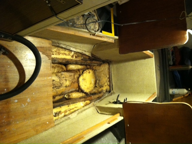

I have it inside the shop (see photo) and started working on the soft floor. A core drill showed rot and sure enough it is. (see photo) the floor is made up of a top 1/4" layer of oak veneer, a 1/4" layer of fiberglass layup and then 5/8" plywood. The plywood sits on two stringers for and aft and then flotation foam was installed in the space between the hull and the floor.

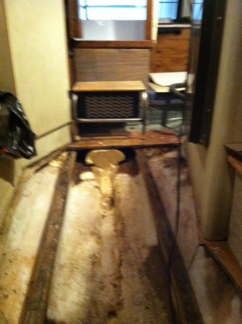

I have removed most of the plywood, still in work, and most of the foam. The foam was not waterloged, but felt heavy and had trapped moisture in all the cracks and seams. I wonder if the foam was structural or just flotation?

I could only attach one photo for the first post(my ignorance?) So here is an attempt at some more photos.

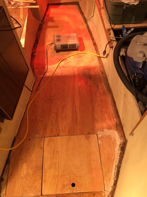

I removed the old rotten floor made from plywood covered with a fiberglass overlay. This old floor was over a poured in foam. I cut the floor back leaving about 1.5 inch "tab" around all sides and removed the foam.
Cleaned the exposed hull and coated with resin. Also filled in some of the inner keel areas with epoxy filler to move water aft. I also put drain tubes in the stringers so a galley leak or water tank leak would drain aft into the new bilge pump area.

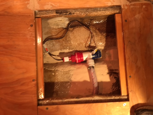

I used West System epoxy and coated all surfaces of the 5/8 marine plywood pieces, fit them under the tabs and over the stringers by grinding and trying to allow the plywood deck to reach under the tab to the hull. I built an access in the aft deck and installed a bilge pump.

Thanks, I had a brain fade when I wrote of the "standard resin", yes, it is polyester resin. I am using West System Epoxy, and will continue to use that to attach the floor deck to the tabs I left when I removed the rotten floor. Thanks for answering my question.
photo of the installed floor deck and showing the tabs.
