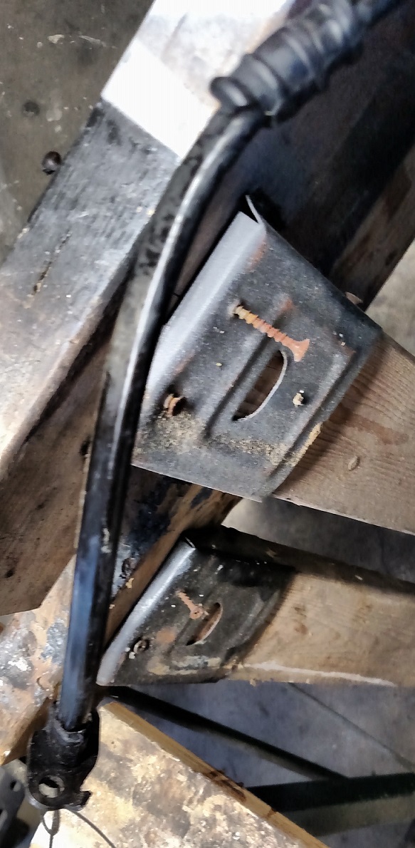

Hey guys, thanks for the responses. It is the lower unit shift interface cable as noted above. This is a single cable BUT has two steel wire cables encased in it. One pushes, the other pulls, and runs from the shift controller on the engine through the transom and into the lower unit. I have attached a picture that shows the separation at the sheath. I really appfeciate all the responses and the help. Thanks, guys!
Mike "Broken Roads II"

Hey guys, thanks for the responses. It is the lower unit shift interface cable as noted above. This is a single cable BUT has two steel wire cables encased in it. One pushes, the other pulls, and runs from the shift controller on the engine through the transom and into the lower unit. I have attached a picture that shows the separation at the sheath. I really appreciate all the responses and the help. Thanks, guys!
