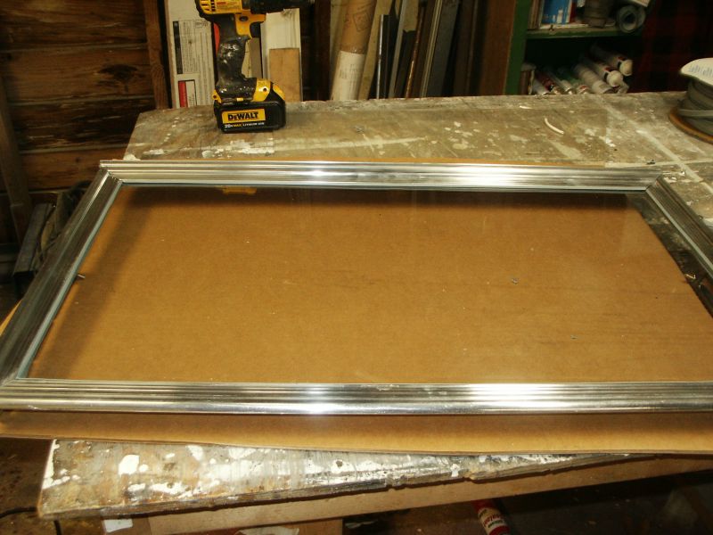

Hi can anyone give me advise on what caulking to use on installing glass windows into a aluminum window frame (these are the two front window)in my 16 foot bellboy they are abot 2x3 feet in size im getting close to installing them as Im polishing the aluminum
the glass will be sandwished between the aluminum frames . I dont want to use the wrong product. Thanks for any advise.

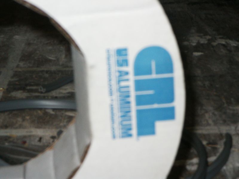

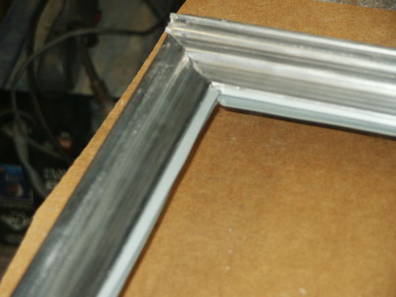

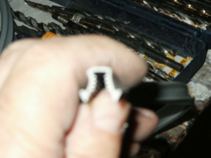

are these one piece frames ???? i bought the replacement rubber insert for mine my had hardened over 50 years ... i tried the silicone didnt like it i was on the C R Lawrence website looking for the stuff it has the lip for the frame edges and the ribs to keep the glass in the frame. 100 foot rolls but cheap. mine were channels with tiny roll pins holding the frames together .. it is in the auto section and doors and windows section .. if i need to i can send you the cut sheet on it. i did one and it was the exact same as the old stuff ... i screwed up the other glass with the silicone so i am waiting on another piece of lexan.

ok how i can screw up silicone with the windows .. i polished my frames, came out real good. my original windows were 3/16" . i cant find anyone using 3/16' lexan so i got the windows cut to the same size as the old ones. first mistake , the windows sat in the frame with the insert so not big as the frame itself. so i got my silicone and filled the frame in the bottom wasn't going to fill it all the way up just enough to secure the glass. well the window was smaller without the rubber insert and when i slid the glass in it moved from side to side front to back and as i tried to center it i realized this wasn't going to work. i dont think taping would help my problem. but i did find the rubber insert the other piece i had was the right size with the insert and worked fine . i probably could recut the glass bigger to fill the frame up and then the silicone would work but i didn't since i had the insert. i may wind up taking the curved windows back out and using the insert with those too i just cut the old inserts up and laid the glass in to those. im not saying silicone wont work i just had the problem of using smaller glass without the insert it was cut for, C R Laurence is a good outlet for a lot of the items you could use for rebuilding the boat, another great outlet is McMaster Carr cheap stainless but bulk, 100 or 50 of the smaller stuff but you will use it. i am still learning.
