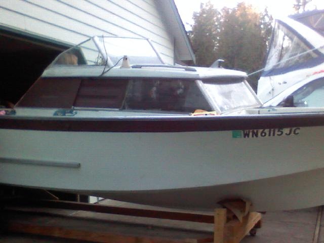

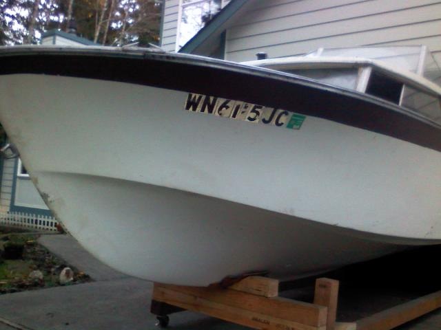

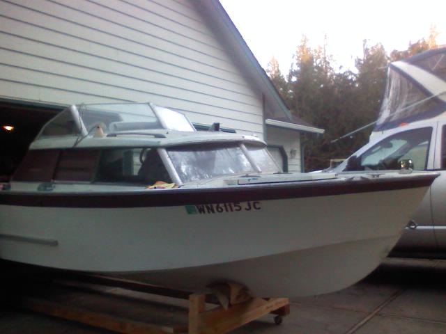

OK... I apologize for starting a secong thread on this, but some of my previous posts were a bit confusing, even to myself! I have a 1965 Seafair sedan. It is verified by registration as a 1965 Glasspar Seafair. It is REGISTERED as 19' ft. I am HIGHLY confused by this, as the Glasspar was supposedly only sold at 17' ft. It also has an I/O motor, and the steering is lefthand side! I have had one response explaining SOME of this, but nothing definitive to explain what this boat might actually be. I am very curious about the history of this boat, and would LOVE if someone could direct me where to go to find out the original info on this boat, as I am restoring it, and would like to keep as original as possible! Thanks for any help.

I saw your pic of your boat and it does appear to be a Seafair, but from what I could tell it is not a 1965. Registration's are notorious for being totally incorrect. You need to rely on hull ID. The more pics you take of the actual boat and not the engine would help others to ID the year and type of Seafair you have.

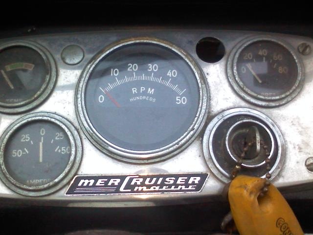

I am going to the boat this afternoon to work on it more. I will take pictures of the hull, and look at the brass plate listing the actual serial numbers. Also, how important in restoration is it keep original gagues? They LOOK ok, but will have to see how they work!

OK... here is the official number direct from the brass plate over the cabin. It lists 4 cities, Santa Ana, CA, Nashville, Tn Olympia, WA, and Petersburg, VA. Serial#17XW9 0053, and it also says Glasspar. This was ALL on the brass plate! Anyone have any info to share based on this new info from me?? I will post a link to the new FB album witht hull pictures. (for some reason I can't upload here) Any help is greatly appreciated.

Based on the hull ID tag: Seafair Sedan, built in Olympia, Washington in 1969, hull number 53 off the line.
By then Larson owned Glasspar. They could have stretched the hull to 19 feet for the inboards (and definetly used wood stringers to support the motor).
Would like to see more pics, but can't get the new link to your album to work.
