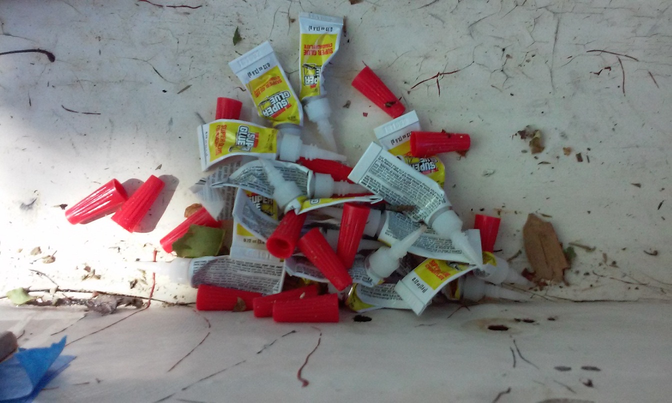

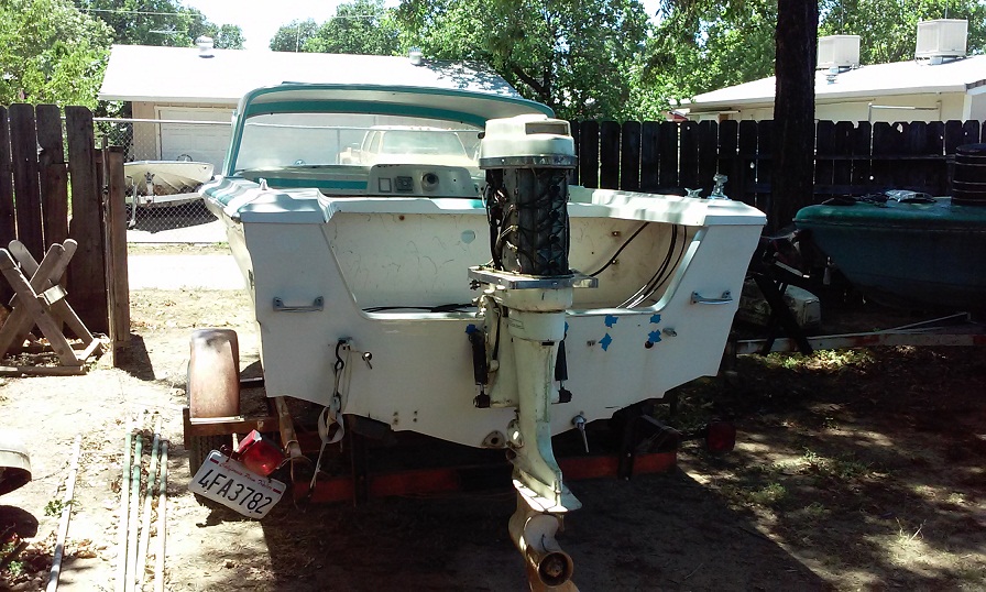

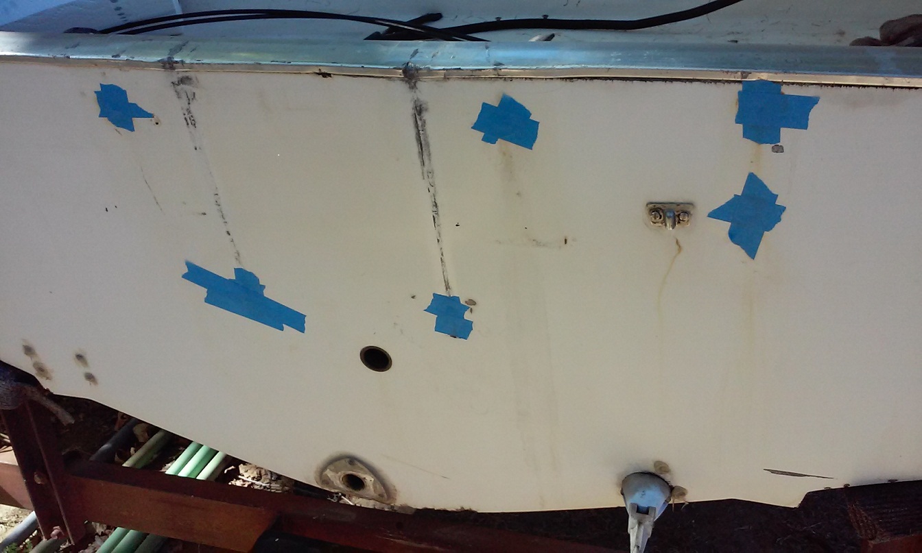

Back in May, I used super glue from the Dollar Store, to seal and reinforce the transom through - holes on my recently acquired Hydrowsift. This is before I bought the large 16 ounce bottle. I used blue Painter's tape to cover the transom bolt holes for the engine (bolts and motor removed) then
I poked a hole in one side of the tape with a finishing nail. I squirted the glue into the empty holes until they were full. waited a few minutes, then added more. Repeated this process as long as each hole would accept more super glue. I left the tape on for a few days so all the glue would be hard. The glue turned rock hard in a day or two. Had to drill out the holes to put the bolts back in. The wood had become soft about 3/8" beyond the holes - but after the application of the glue - the surrounding wood is hard as rock. The glue wicked into the punky wood and "plasticized" it. It does the same thin with new end grain - and I believe it is better than Smith's for this application.

Here is what I did with the Hydroswift transom holes to seal them. This before I purchased the 16 Ounce bottle of thin glue. Anyone that wants to do this - go to your nearest dollar store and see if they have crazy glue for cheap. Our Dollar Store here in Redding had a 3 pack of the little .1 ounce tubes for a buck. I believe i used twenty tubes to seal the holes on the Hydroswift. I can't overstate how well it worked to seal and strengthen the wood around the holes. The transom was otherwise solid feeling - no flex - even when hammering on the big old Merc 700 hanging off the back of it. This will not fix a bad transom - but it will help a good transom from getting wrecked.
